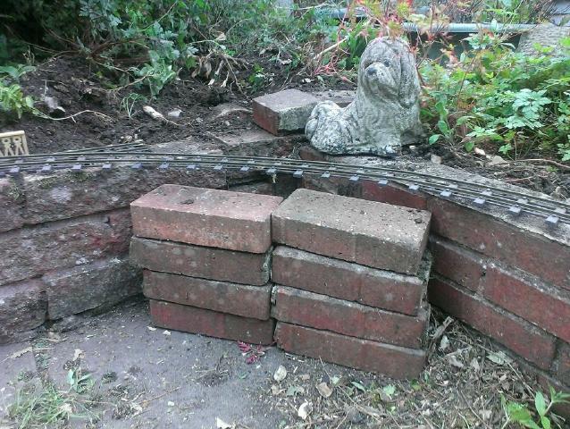

TRACK HAS BEEN LAID
4.5 yards of track has been laid on the RVLR (temporarily) and a train has been run!!!
I'm putting in an order for a further six yards of track and also need to utilise the little grey cells how to make what is U shaped line an oval.
It feels like a proper railway now, rather than a loop of track on the patio. And so so so much easier on the back!
Pics to follow
Pics to follow
SapperAnt
SapperAnt
This is my plan. Either have the track running onto the wall as it is now, or have a free standing curved timber bridge......
My wood working skills are minimal, hence asking for advice :-)
By the by what would members preferred method of securing the track be? Im thinking mortar with coarse sand in it....

Looking really good. In the corner with the paving bricks underneath I'd see about moving the wall outwards or building a new small wall to support this stretch. The other corner (single brick holding track up) does look like a bridge may be indicated.SapperAnt:86394 wrote:This is my plan. Either have the track running onto the wall as it is now, or have a free standing curved timber bridge......
What I found in a similar situation was that you will need to be very careful of cross-levels where the bridge joins the wall on the right - at least, I did, since my bridge is removable. I ended up cutting back the track on both sides and having a short removable section of track that drops into place once the bridge is in position. This removable section has a reinforcing length of rail soldered across the rails underneath, joiners soldered on at one end, and joiners fitted with short handles of brass rod at the other end to facilitate fitting and removal.

So I need to really iron out some of the gradients. It doesnt look that steep with a clinometre and a spirit level, but the way my Ragelth struggles (even with the safety blowing off) to draw just one WD bogey wagon, they must be!
I thought Id had cured most of the worst gradients....but obviously not.
I think I will plod on, secure the track and see if the engine can do a complete circuit at a moderate speed....and take it from there.......
Learning curve is vertical!

Yeah......
The flower bed walls the track is on, on the right hand side is failry straight and true, but on the left, due to root and frost action has....sunk by about an inch or two and is leaning at an angle of a few degrees (1 or 2). I am tempted to use some marine ply to level up that side even more than I have with mortar fillets.....
Watch and wait with baited breath.
