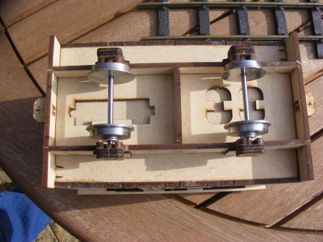

........... which arrived in the post yesterday. Got built, too (apart from the door hinges and latch on one side - that's today's job, together with painting).
I LIKE the way the axlebox bearings are held in place - there's no need for glue to get ANYWHERE near them! There are one or two places where a fraction more could do with being taken out of the lasered tabs / slots - I had to assemble the underframe with gentle taps from a small hammer, and don't even mention the buffers - I had to take a file to the holes in the buffer beam!
The roof (something I always have problems with) went on like a dream - the lasered "planks" made it bend quite nicely, there are a good number of cross-ribs to glue it to and a couple of large elastic bands helsd all in place.
Photos later today...................
The only additions (standard for all MDLR builds) are the lamp brackets and document clip.
View of the underside - the axle bearings sit behind the "ears" and are held in place by the 3-ply axlebox covers which are glued to the solebars: an elegant solution to the "problems" of axle alignment and glue in the bearings - no glue ever gets NEAR the bearings!
Good news - it's Flagg Fluorspar compliant! (ie it goes round the corners and goes through the arch!)

Looks good Brian. Was it very humid where you assembled the kit or did you apply the glue and then wait a while before assembling the parts? Humidity makes MDF swell a bit. I assembled the kit used for the instructions from the same batch and had no problems with the parts fit. I don't put glue into any of the slots or onto the tabs normally (perhaps worht mentioning in the instructions?)
