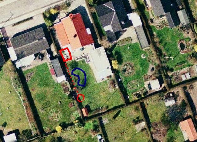

Here is a google map sketch of my garden, The red square is where i will start my garden railway for now and the dotted lines are possible extensions on the future. The blue bean shaped area will be a 8000 litre koi pond. There will be at least half a meter between the pond and the proposed track line.

if i zoom out a bit more there are numerous other red/brown ones too, it is just concidental that the roofing tile colour immediately around me are black/grey.Keith&Joanna:66408 wrote:Any reason why your house is red and the others are dark grey?
The problem is that under the area with the red square is an old oil tank from the 70s for the former oil heating system. This was decommisioned in the 80s when the heating system was changed to gas and the old oil tank was filled up with sand according to the papers we have on the house . Hence i will rather avoiding digging up the decomissioned old tank.Keith&Joanna:66408 wrote: I would be tempted to put the Koi Pond near the house (where you have indicated in red the railway square) and run the railway up one side of the lawn, you can then slowly extend as you wish either in width or continue round the perimeter of the garden as time and money allows. You mentioned originally you were building at ground level, but you seem to be building higher than ground level now?
I have decided to elevate the railway because the clearance under my robot lawn mower is only 2.5 cm so i think i should play safe.
