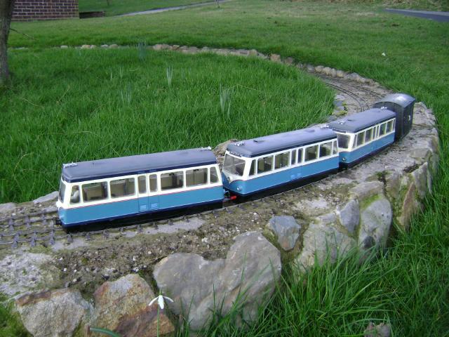

I've managed to collect three of these over the years that are now formed in to a "set". They all run on ex-Lima Class 33 bogies. Only one car is powered but batteries are under all three cars and connected together by jumper cables. Very basic foward-off-reverse radio control is provided by the innards of a model car bought from Lidl.
Tony Willmore

TonyW:64725 wrote:I've managed to collect three of these over the years that are now formed in to a "set". They all run on ex-Lima Class 33 bogies.
Oh wow, I do like that setup Tony, they look great together as well. Some proper MU action there. As for the Lima 33 bogies, now that sounds like a good plan & one I may have to follow. Do they have metal wheels? The faller unit does seem rather crude & very noisy so will certainly be replaced in time. Was quite surprised that the worm gear was actually brass/ brass type though! Only problem I can see for me is the voltage, I presume the Lima 33 was 12v? As I am only running it as a single I guess I would struggle to fit enough batteries in for it?

Pendo Pilot:64728 wrote:As for the Lima 33 bogies, now that sounds like a good plan & one I may have to follow. Do they have metal wheels?
They have metal tyres, with plastic centres. The same bogies were used on the SNCF Bo-Bo diesel that Lima did. This and the Class 33s crop up on ebay from time to time (example 200697273981).
Pendo Pilot:64728 wrote:Only problem I can see for me is the voltage, I presume the Lima 33 was 12v? As I am only running it as a single I guess I would struggle to fit enough batteries in for it?
Yes, 12v two-rail. You need to bend the pickups away from the wheels if you go to battery power. I have never run one as a single car, but there is room for 8 x AA batteries underneath each car by using two of these:
I wonder if that would be enough? Alternatively, perhaps 10 x AAA batteries might fit? (High-power AAA batteries were not available when I did my conversion)
Tony Willmore
