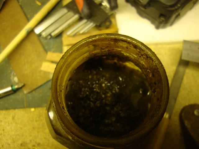

First thing to do is make some 'soup', I use an old coffee jar into which I have placed a few rusty nails and a wodge of wire wool, this is then filled with white vinegar and left with it's lid on for a few days.....

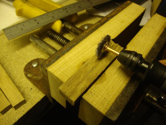

Remember that you only need to treat the areas that will be seen. Next take a drill mounted wire brush and attack the wood - in the pic I'm using a small brush in a dremel but I often use a larger 'DIY shop bargain bin' one in a standard cordless drill.

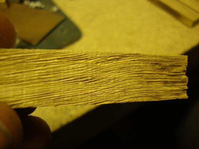

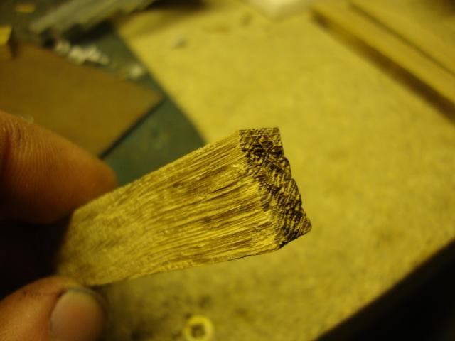

Turn the piece over and do all visible sides, it's easy to vary the amount of decay you put in. You should end up with something like this.

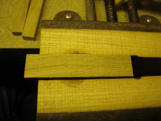

Now it's time to brush on the 'soup'. Use a largish brush and paint on a generous amount - don't expect any instant results, although depending on the type of wood and the strength of your 'soup' you may see some quick changes. In this case the 'soup' has been maturing for a few months and reacted almost straightaway with the oak (which has very high levels of tanin) but the mahogony just looked wet.

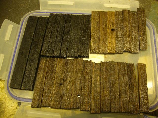

Now the fun bit - leave the wet wood on a tray and go have a drink, check the forum and go to bed! Next morning the magic should have happened........
Easy as that, and cheap
