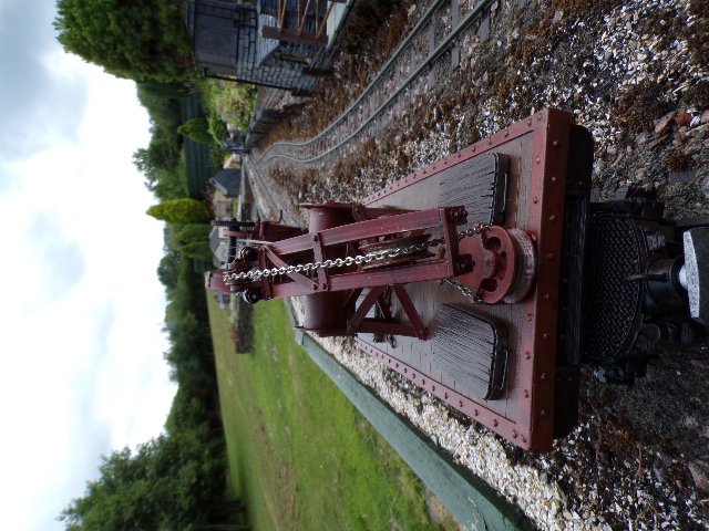

Let me just remind you of what happened to my L&B, 3D printed crane after taking it to a garden railway meeting in hot weather...
Fortunately, the crane part was replaced FOC, but although I asked at the time, I was not told what material was used.
