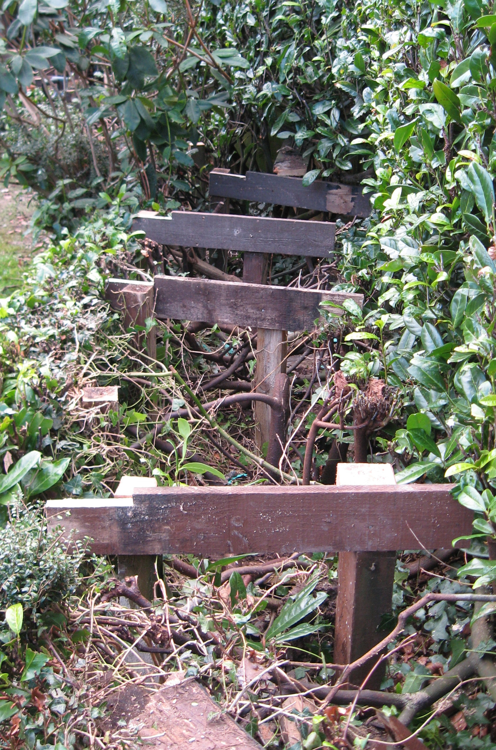

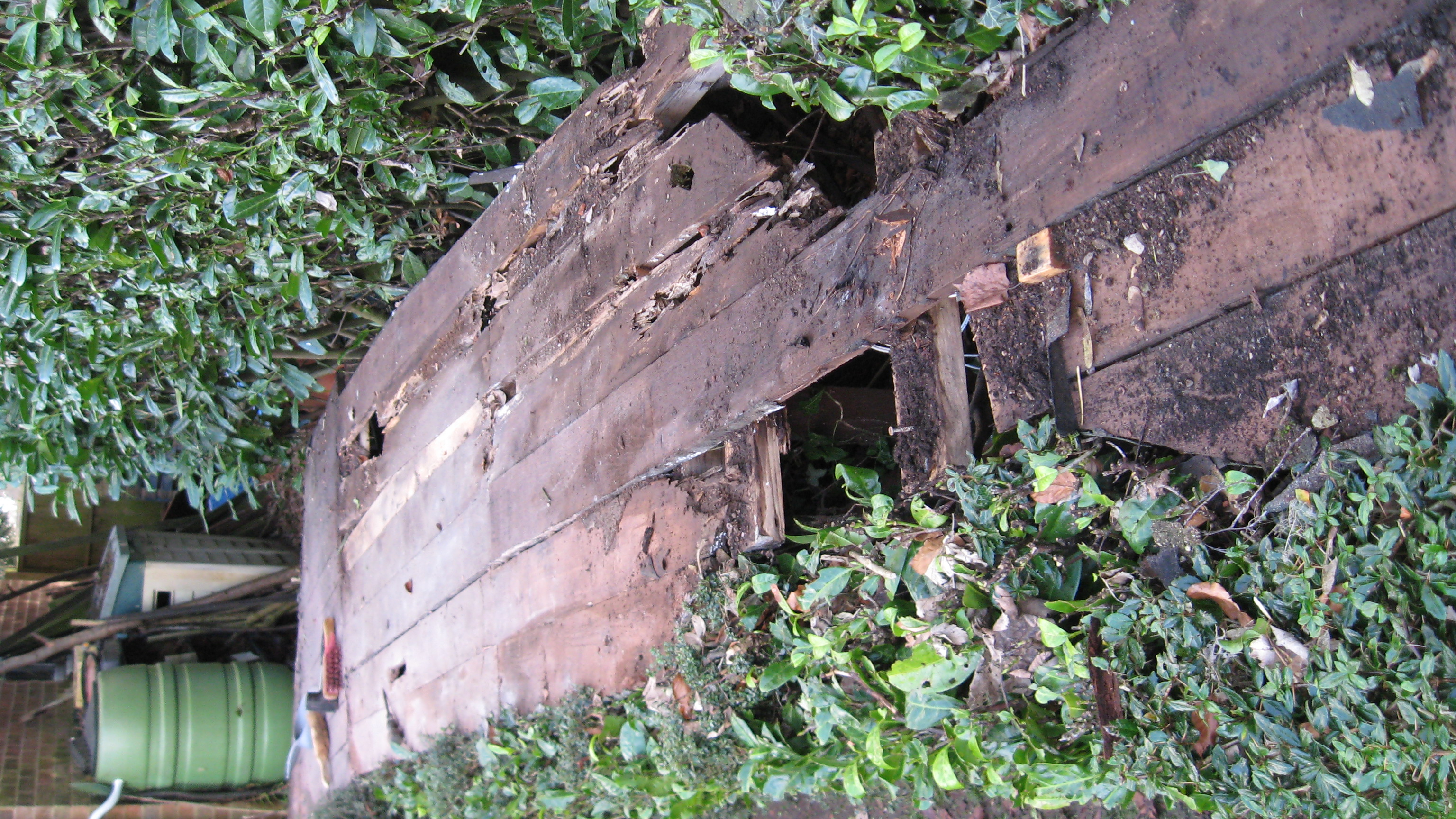

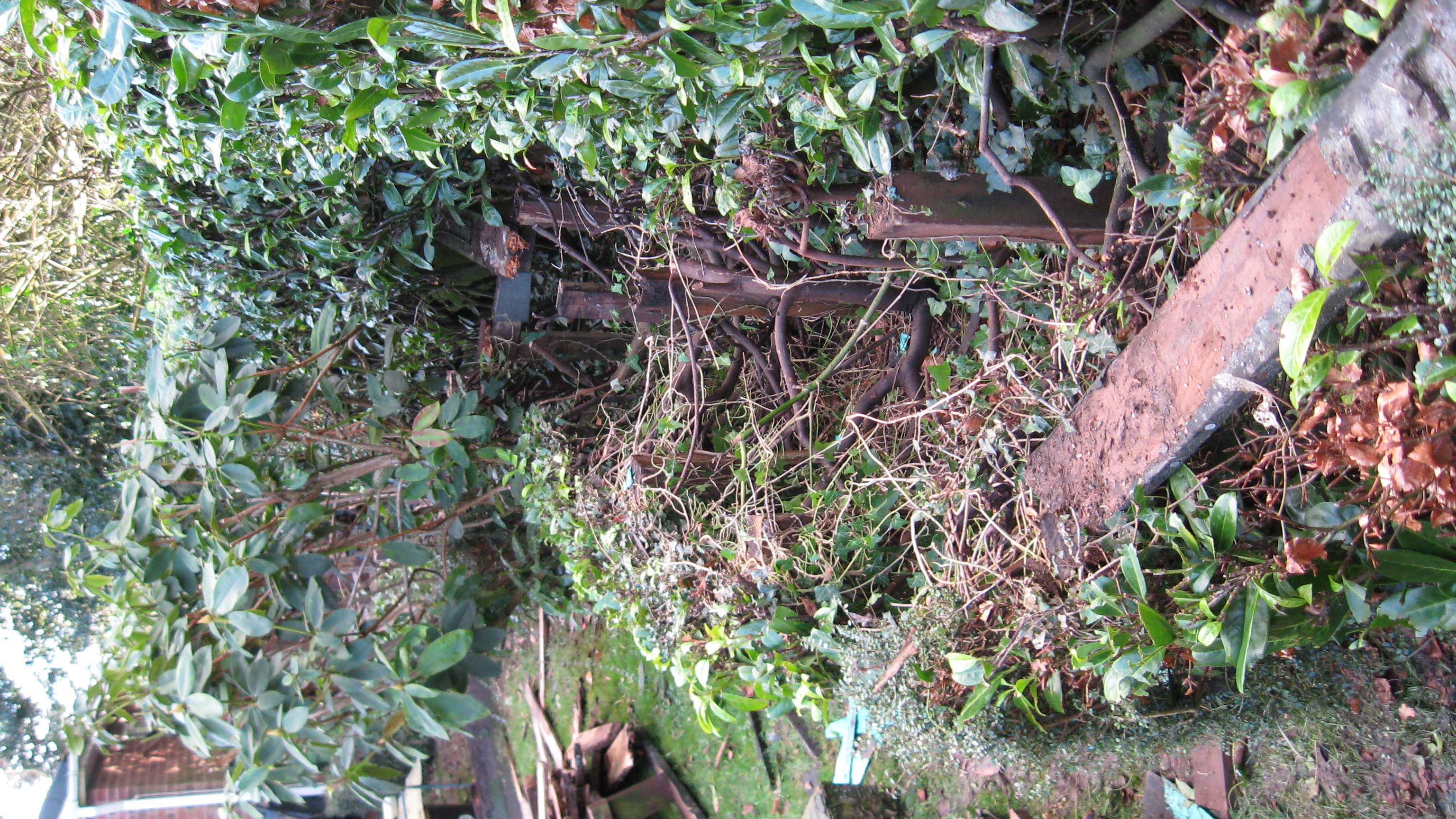

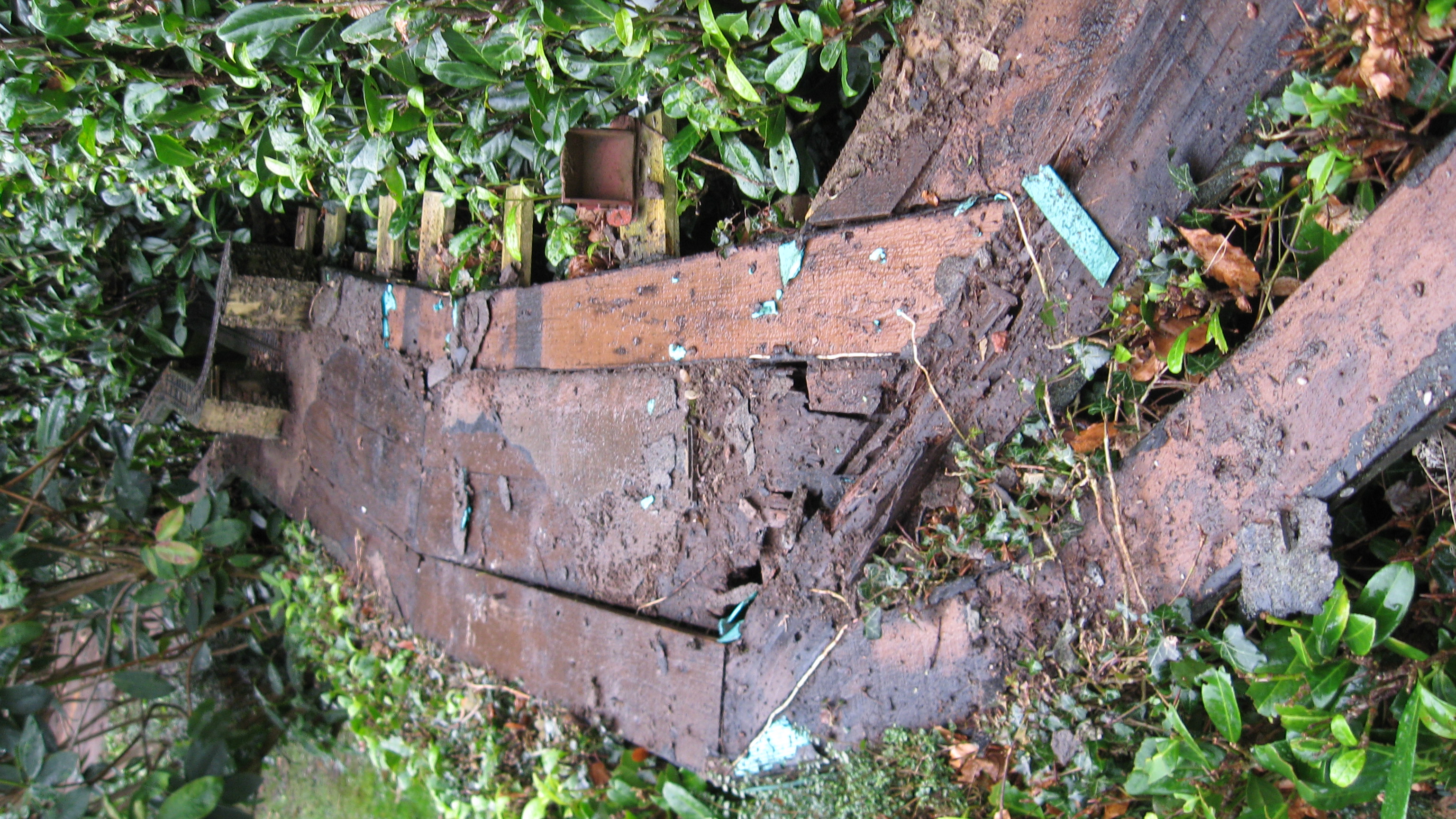

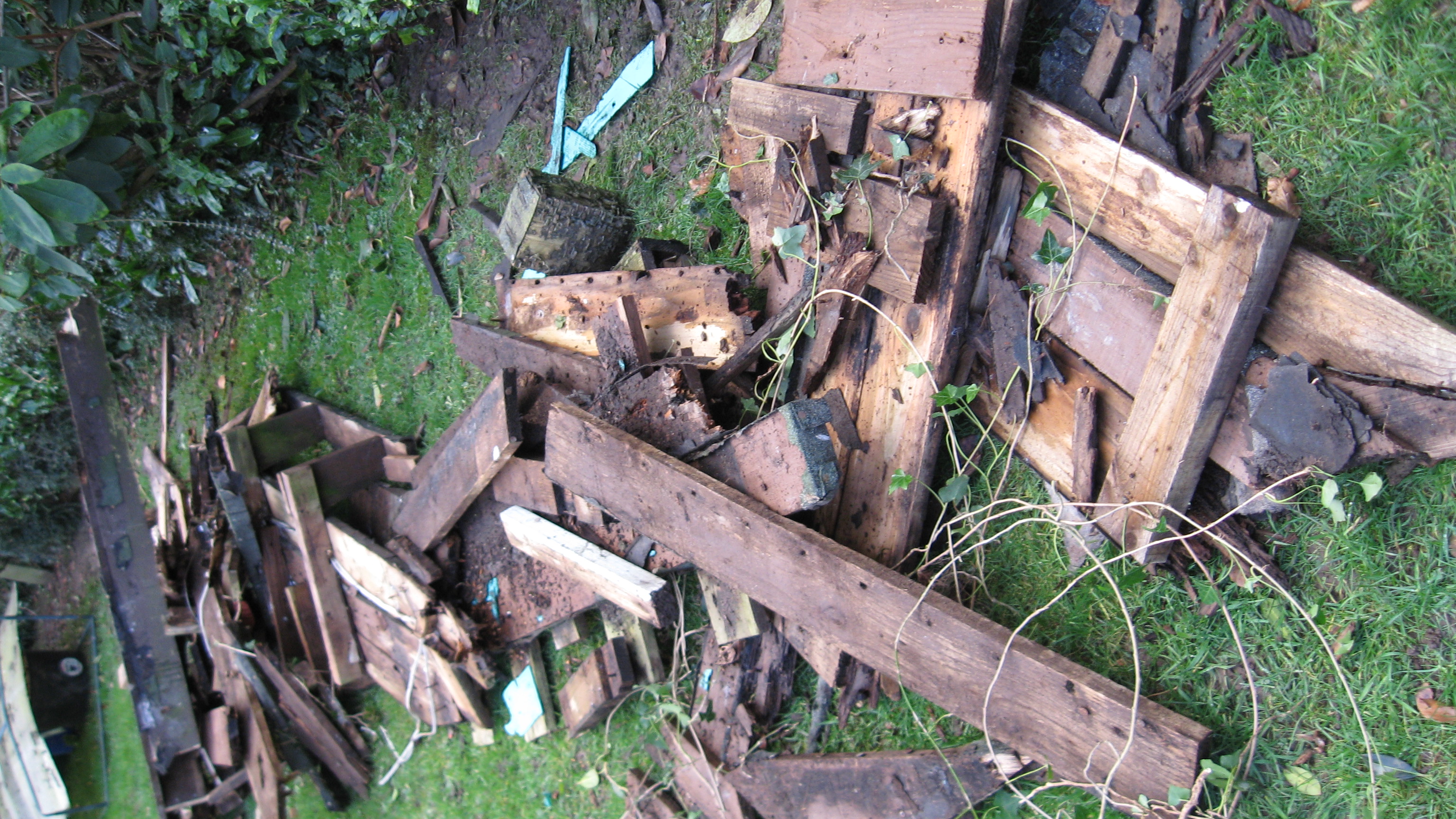

For a couple of years, I've been trying to patch-up some of the rotting boards under the station. It reached the point where I decided enough was enough! My own fault. Although I used pressure-treated fence rails for most of the baseboard, I did some patchwork with old recycled fence rails and even some untreated timber from pallets. A false economy.
However, on closer inspection, some of the ex-pallet wood is fine and some of the treated fence rails have rotted at the ends.
Next stage is to rip everything out and start again - this time with nothing but treated fence rails.

Re: Beeston Market is no more .......
Posted: Tue Feb 25, 2025 5:19 pm

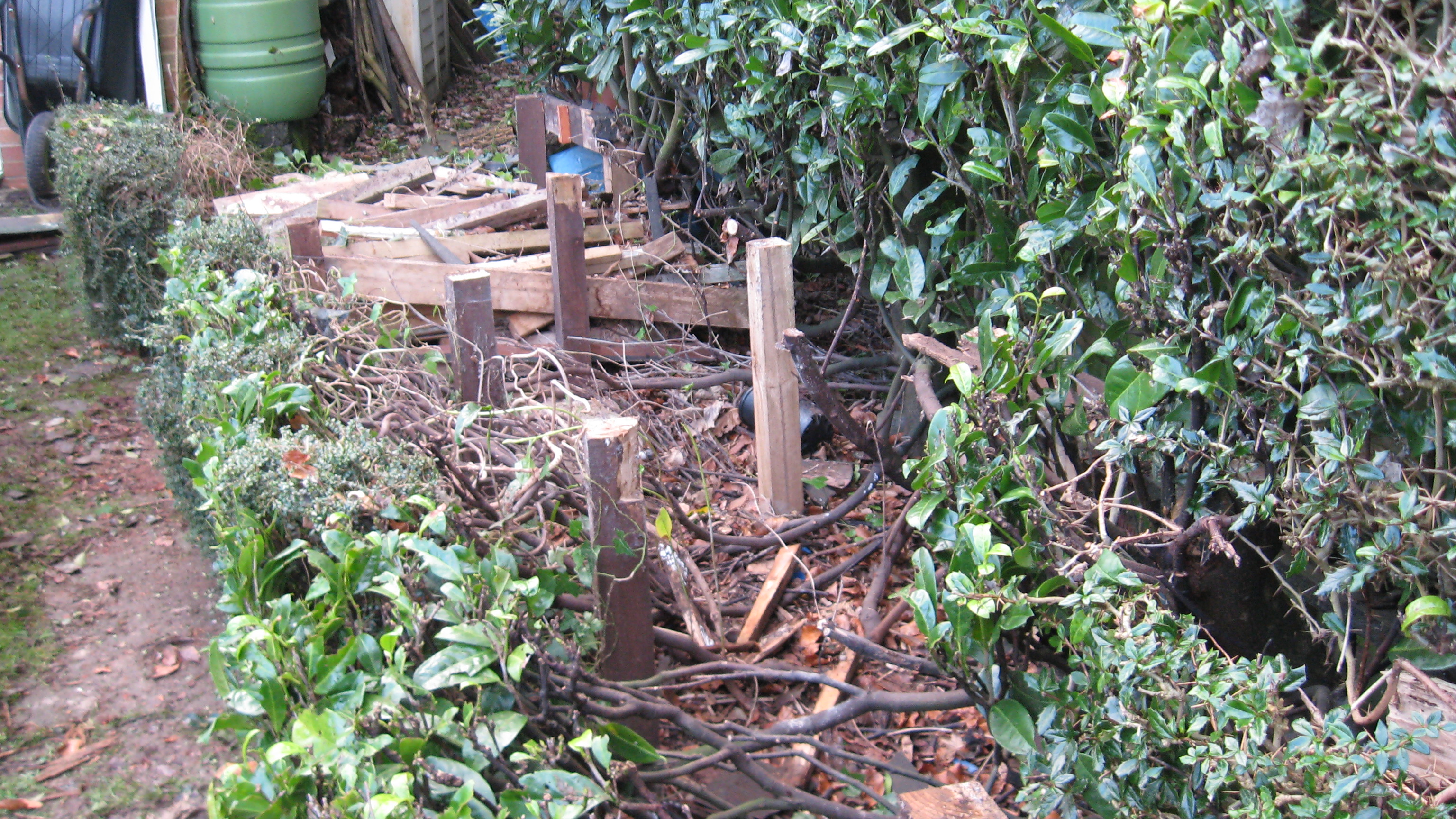

Now cleared out all the old timber. A few of the fence rails are still very sound but I will probably use those as support trusses rather than decking. Pleased to find only one post has rotted at the base while, curiously, a couple have rotted at the top. I might put a few extra posts in as I have to stand on the boards to cut the hedge behind.

I knew I had a few saggy, soft spots but it wasn't until I lifted the track and saw what was underneath that I realised how rotten some of the planks were.
I've now taken all the rotten timbers to the tip in my trailer. Some good came from it. I used some of the more intact boards to strengthen the floor of the trailer which was originally delaminating plywood.

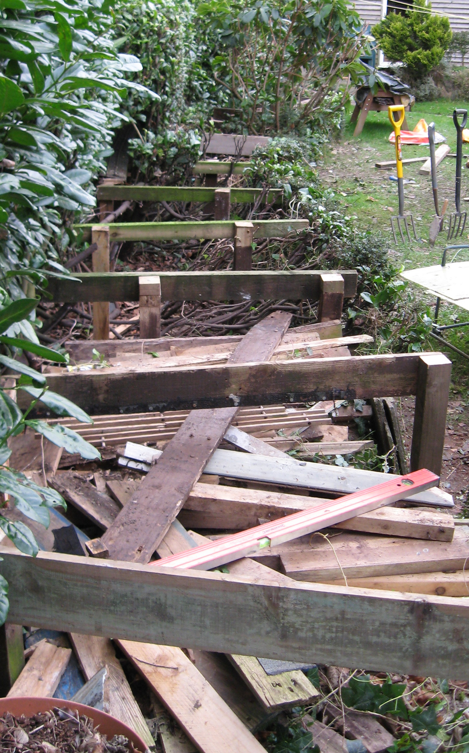

Replaced rotten posts and added a couple of extras - then fixed in place a few cross members.
I've decided the copper mine will be an inch higher than the adjacent main line
The lumber pile in the foreground is where I store my 'useful' offcuts from various sources. Normally, it's under the cover of the baseboard.
