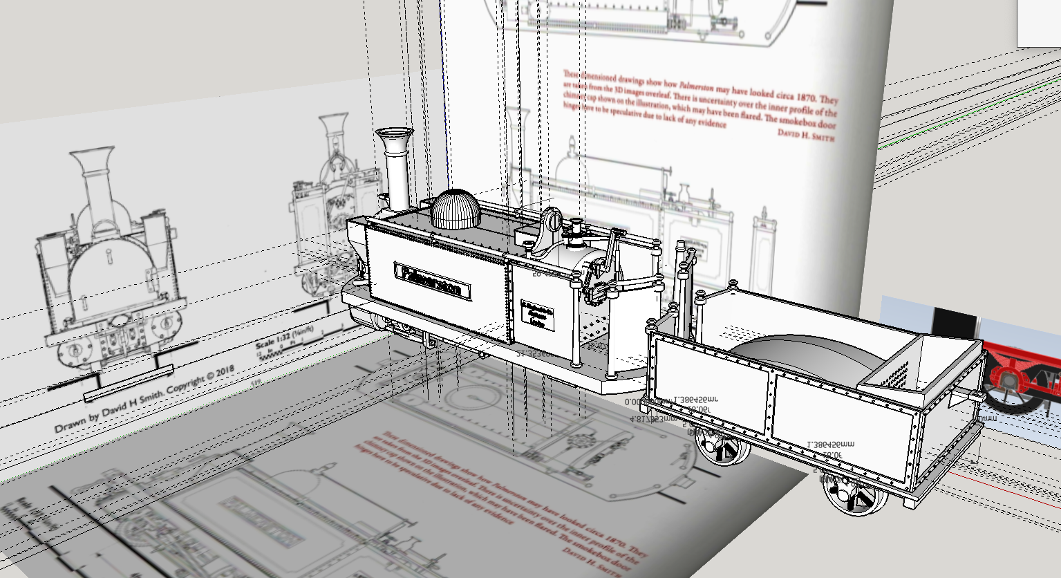

There are drawings of the early Ffestiniog locomotives in th e16mm Association special edition covering the early Ffestiniog railway. As usual I have scanned the drawings and imported them into Sketchup. I have moved them around and orientated them so that they form a grid from which to draw the locomotive. I can then draw guide lines so that their intersections show the outline of each component as I create it. Each component is saved as a "component", partly so that subsequent drawing does not alter the component already drawn, and partly so that I can identify the sub-assemblies I am going to try to print as one piece on the printer. Here is the drawing:
Screenshot 2023-11-27 at 12.49.25.png (736.8 KiB) Viewed 189574 times
This is my first attempt to use bigger build area of my Anycubuc Mono X2 resin printer to create a locomotive. The plan is to print as much of the loco as a single piece as I can - to avoid gluing things together.
So the first main component, the chassis complete with the mounts for holding the motor (or motors if one is not powerful enough):

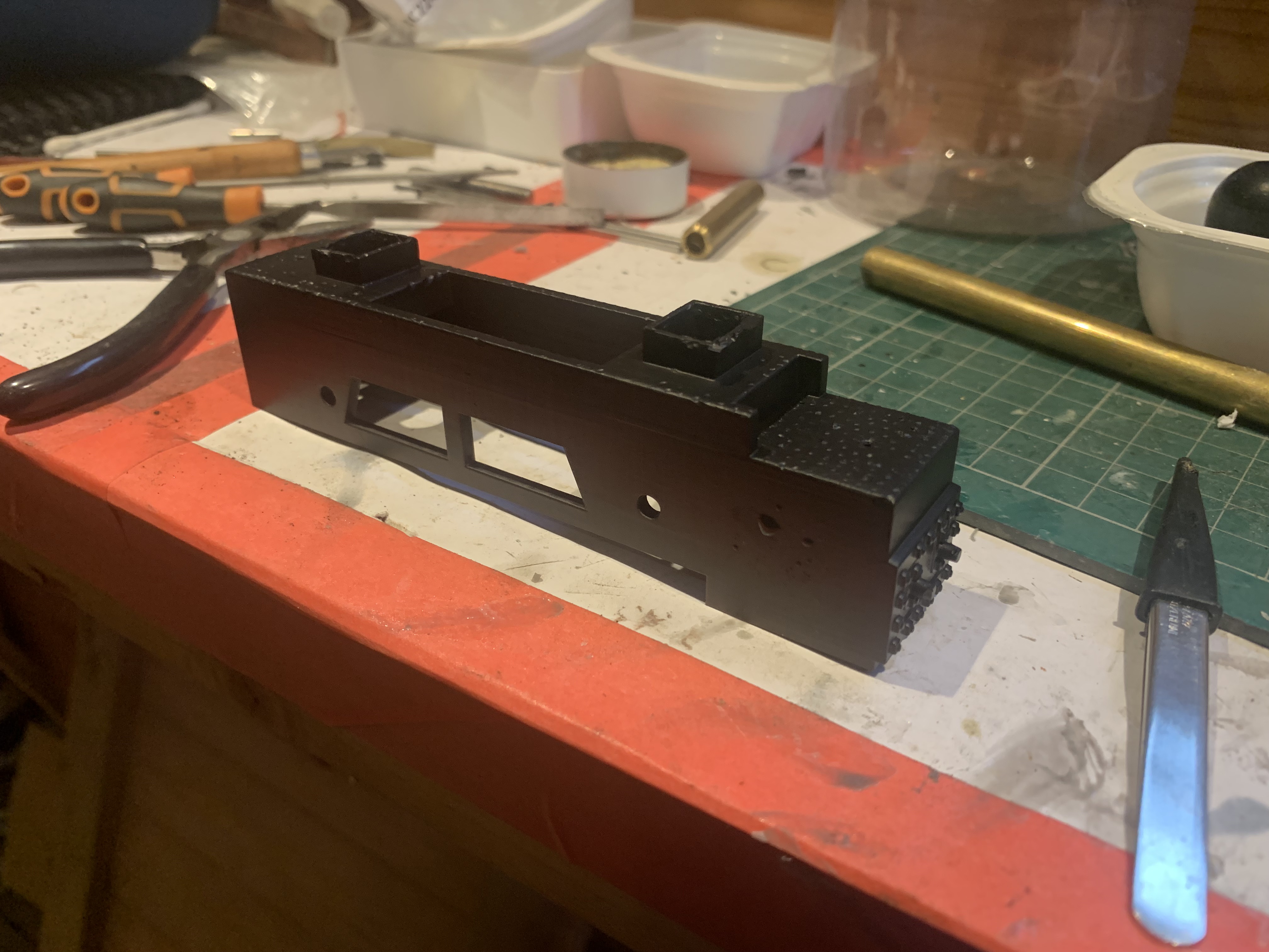

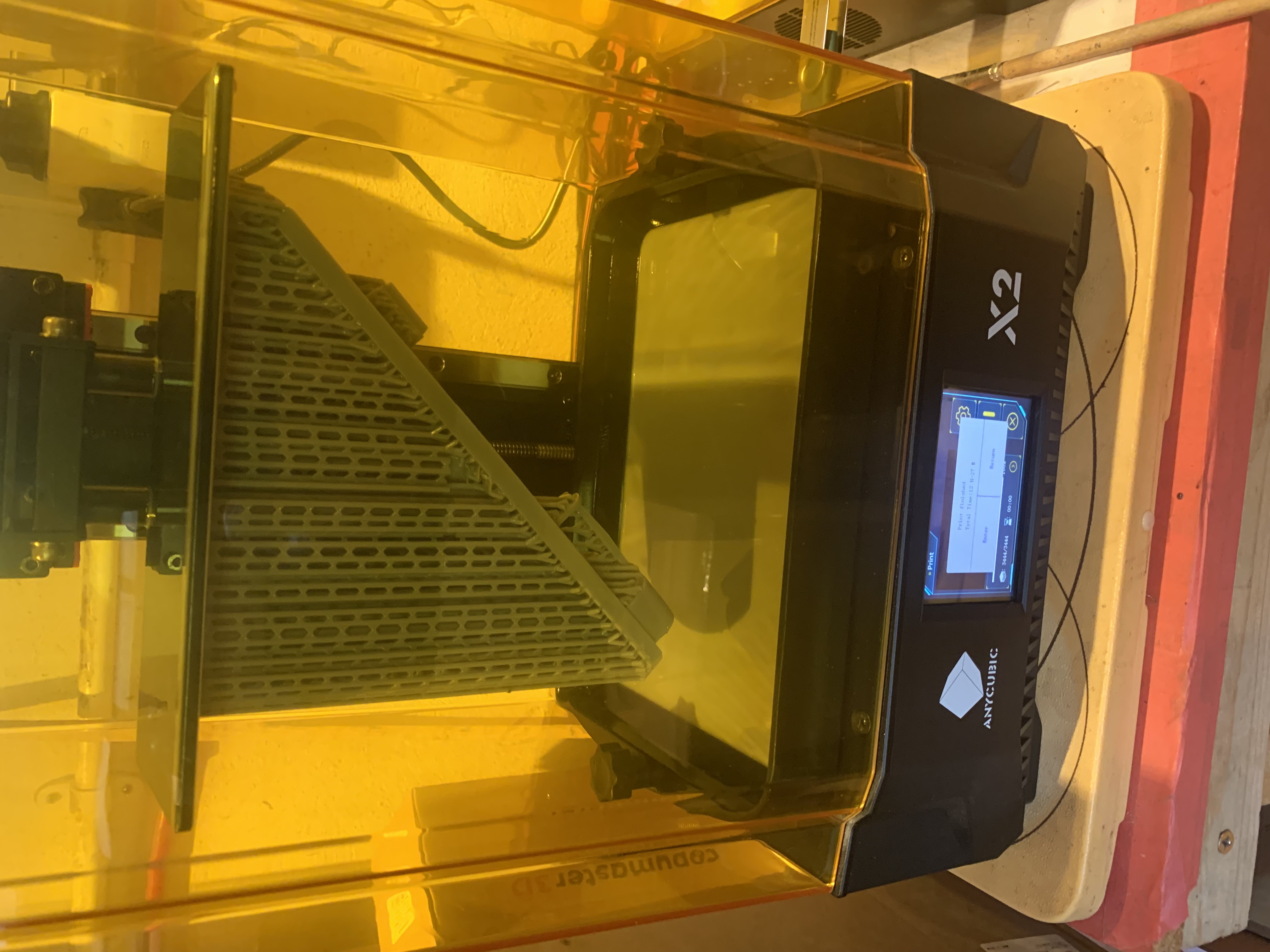

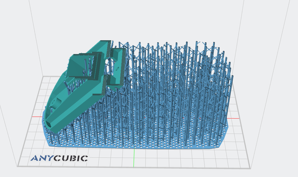

I have found the large resin printer a challenge - in some ways. Firstly each attempt at a component uses a lot of resin - and there is always something which could be better if I made it again.
My first attempt at the chassis had the motor mounts integrated into the chassis but at an angle. I also used the mounting holes in the end plate of the motor to fix it to the chassis. Both were in error. Using thew screws means that the gear has to be removed before the motor could be attached or removed. Unfortunately the small nylon MOD 0.5 bevel gears were press fit - so not easily removable. Secondly I couldn't actually get the motors into the holders - one went in but the first was in the way when fitting the second.
So I have modified the motor mount by making the hole in its lower end big enough for the gear to go through. Now the gear can be bonded to the shaft and then the motor fitted. I have just secured the motor with a dab of LockTight. Hopefully it will come free if necessary - and hopefully it won't come free unless I want it to.
Organising the orientation for printing larger components, and getting the supports right, is a separate issue. For this chassis I printed it parallel to the bed, upside down, using "medium" supports. That leaves the remains of the supports on the top of the chassis which will be out of sight:

I was a bit concerned that the print might pull off the supports but if I look at the area that the printer is going to print at a single moment it looks like this:
Screenshot 2023-11-27 at 16.30.27.png (18.61 KiB) Viewed 189552 times
and this is the layer that it would be printing at that time:
Screenshot 2023-11-27 at 16.30.11.png (137.73 KiB) Viewed 189552 times
I hoped that would not be enough to make it stick to the bottom of the tank - and pull off the supports.

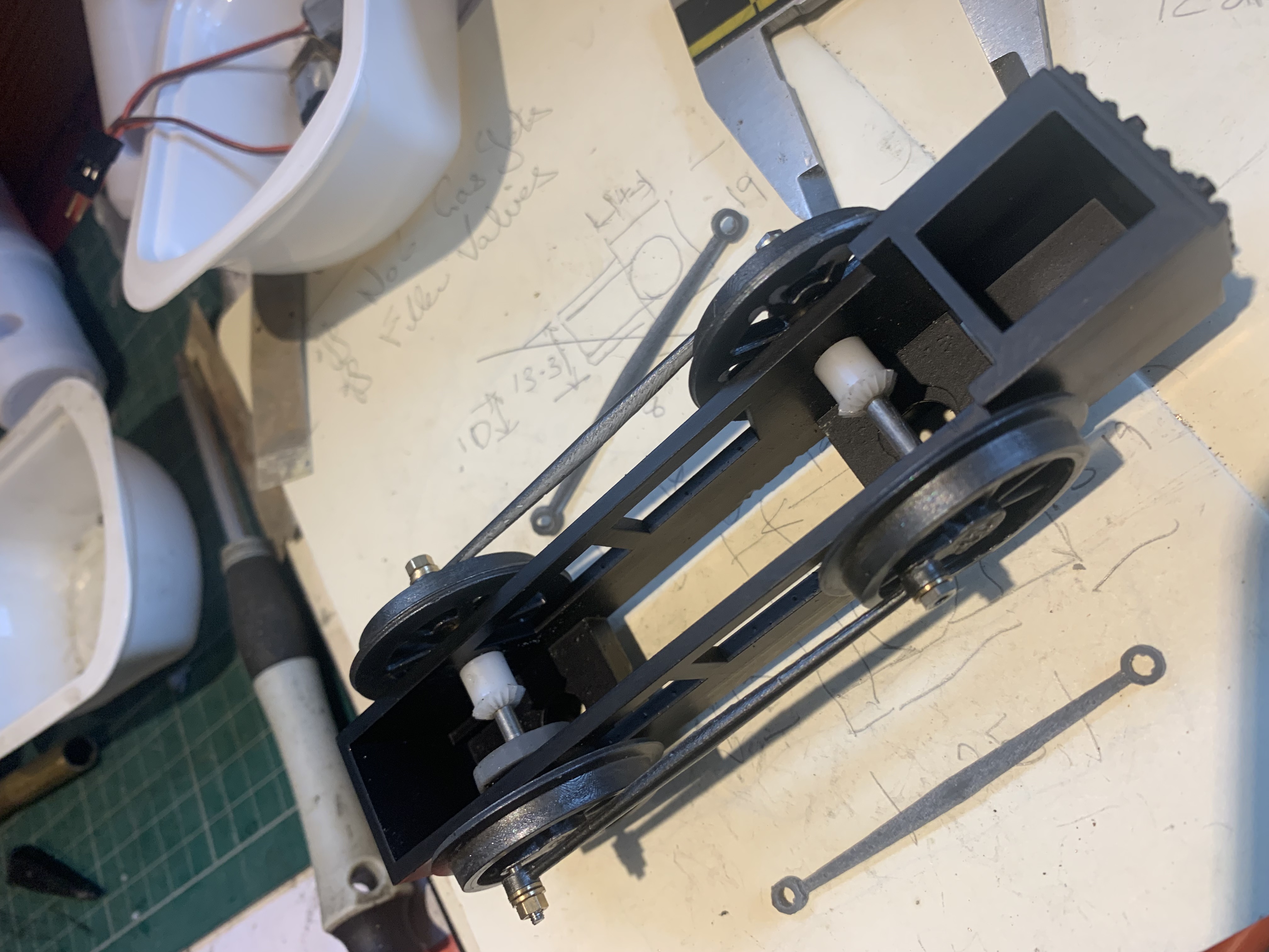

I printed coupling rods, wheels, and connecting rods on the smaller printer which I have. The coupling and connecting rods had holes for bushes - trying to make a more "professional" job of it. I have bored and tapped the wheels to take stainless crankpins. So the chassis assembled:
I have made the crank and connecting rods the correct round tapered profile - I think its an important feature of this loco - I just hope they are strong enough.
You can see the coupling rods fitted , and the motion turns reasonably freely - I think it just needs running in. The coupling rods are lying alongside in one of the photos ready to fit when the footplate is printed. The thickness of the coupling rods is taken up on the rear wheels by washers for now. You can also see the grey "wheel" on one axle which carries 4 magnets which will trigger the sound card (eventually).
The footplate raises issues which I will describe in the next post!

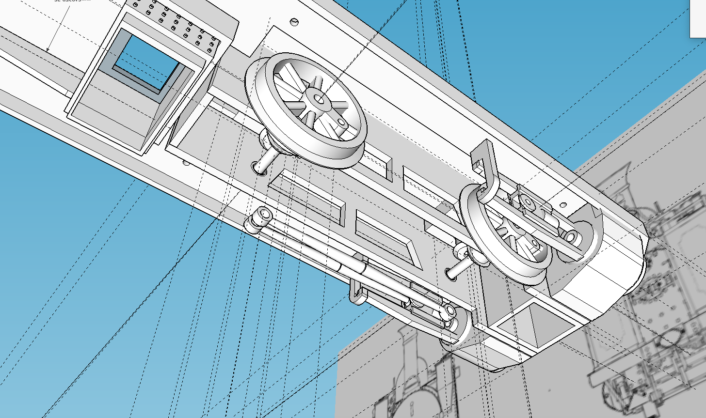

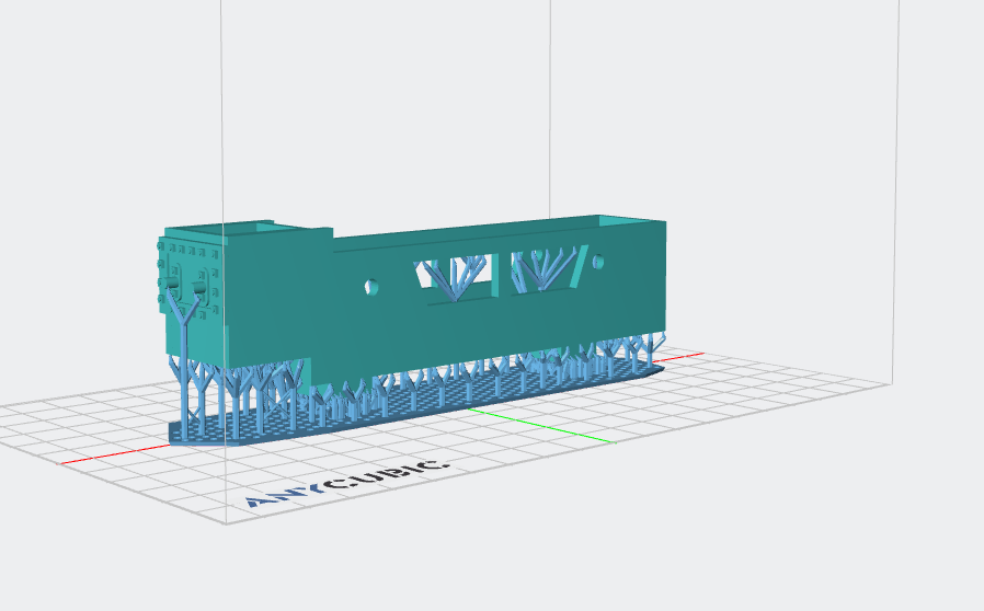

To give an idea of how I plan for the chassis, footplate and motion to fit together a screen shot:
Screenshot 2023-11-27 at 19.12.26.png (314.7 KiB) Viewed 189539 times
The chassis fits into a slot in the footplate and is secured at each end with bolts and brass bushes bonded into the footplate. The cylinders and slide bars are separate subassemblies which are printed as part of the footplate. I don't want to have to glue them on. The crossheads are printed as separate items and slide freely when everything has been cleaned up with a needle file. My first attempt at the footplate:
Bear in mind that I thought the motors would sit inside the chassis and not protrude into the body - where I want the batteries to go.The chassis did actually fit in there after some judicious filing but I had difficulty getting the wheels and coupling rods and nuts to clear inside the crossheads. Everything was just too wide. So in the re-design I moved the cylinder assemblies 1mm further apart. Also I made holes for the motor mounts to protrude through.
I have in the past had to make my models in a number of parts - for example the side of a coach might have been in 4 sections. I was keen to try to make this footplate in one piece. The only way this would fit into my printer was like this:

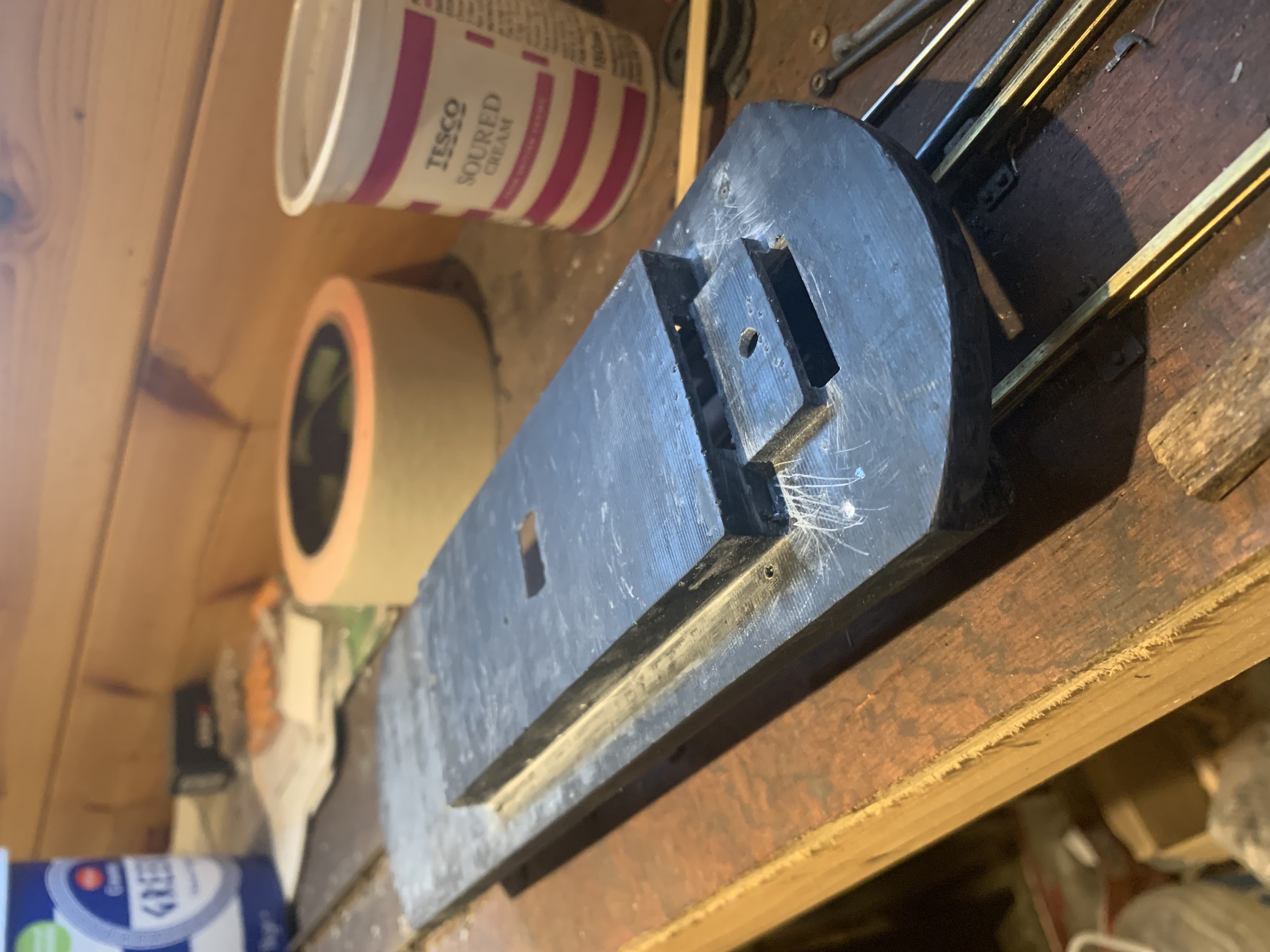

In preparing to re-print this footplate I added "heavy" supports rather than "medium" supports and in retrospect I think that was unnecessary because at an angle like this there is not a large area being printed at any one moment:
Screenshot 2023-11-27 at 21.13.12.png (310.68 KiB) Viewed 189526 times
Partly because this printed unit only just fits into my washing tank, and partly because of the heavy supports the end of the footplate closest to the raft was particularly hard to remove. This resulted in some chips missing from the end edge of the footplate. I also failed to notice that some of the supports were actually touching the model in places - that resulted in the stays on one side of the firebox being lost, because I had to file the supports off. A pitty but not worth the expense of reprinting it. Getting all those stays free from the footplate also took ages.

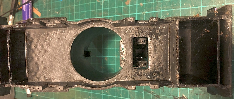

I'm particularly impressed by the finish on the top of the footplate. If I'm seeing things correctly, the top of the footplate is the underside of the print and has the supports? There appears to be very minimal dimpling from the supports and relatively few visible layer lines - or is that simply because you've sanded it all out?
I find that I need quite large support connections and lots of them, and I still get all sorts of sagging and bulging. When printing things that big I wouldn't dare to print without heavy supports.

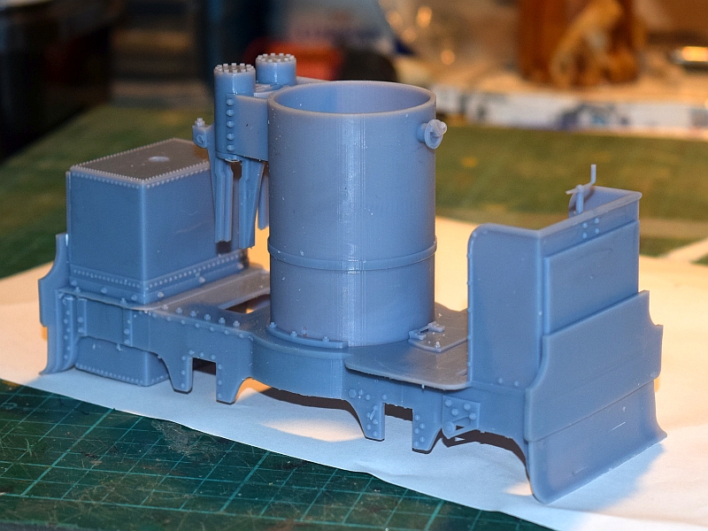

Simon, my picture above is of one of the prints I did in my DeWinton build. I can't speak for Trevor, but my reasoning was the ability (potentially) to produce all of the detail in one go without having to put all the fine detail on individually. This is a one piece print but the underside looks like the previous picture!:
Re: Palmerston - Small England Loco as built
Posted: Tue Nov 28, 2023 10:38 am
Philip, that DeWinton is most impressive. I have always been critical of the striations left from filament printing but your resin print is superb.

philipy wrote: Tue Nov 28, 2023 6:17 am I'm particularly impressed by the finish on the top of the footplate. If I'm seeing things correctly, the top of the footplate is the underside of the print and has the supports? There appears to be very minimal dimpling from the supports and relatively few visible layer lines - or is that simply because you've sanded it all out?
Yes the top of the footplate has the supports - well most of them.
There is as you say almost no sign of dimpling. The ball shaped remains of the supports need filing away but it is otherwise not a bad finish. Not perfect but usable. I think the key to printing large flat areas is to print them at an angle. More to add on this shortly.

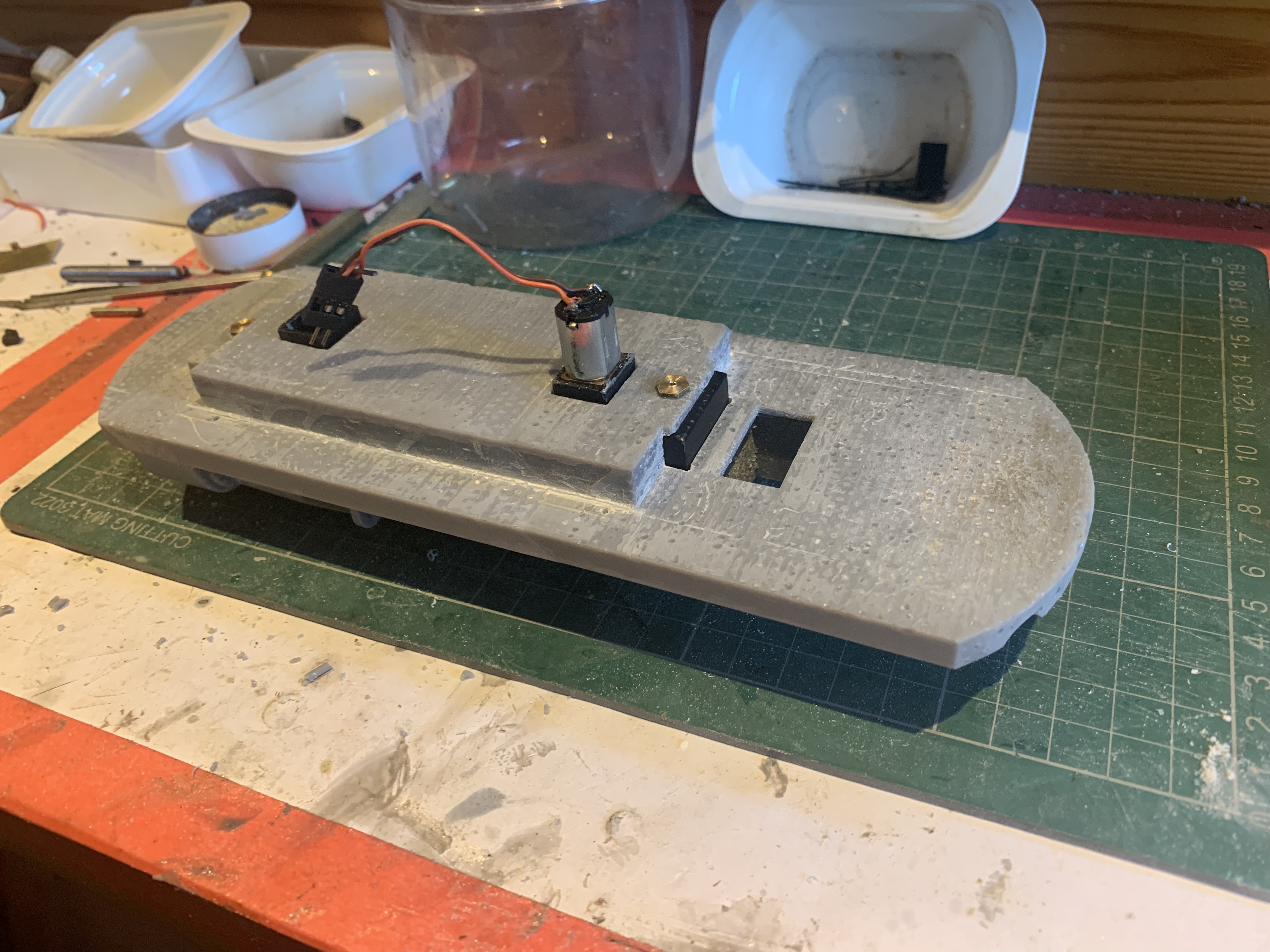

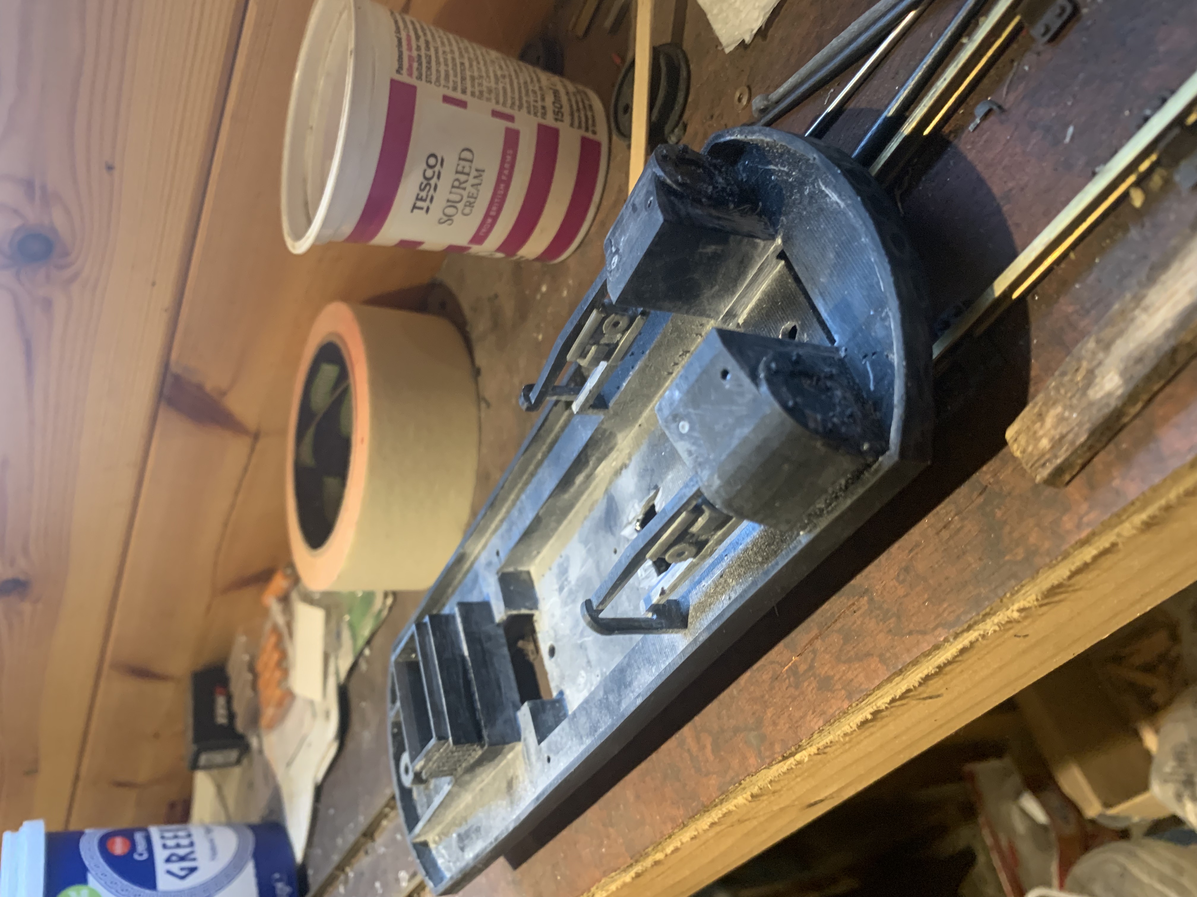

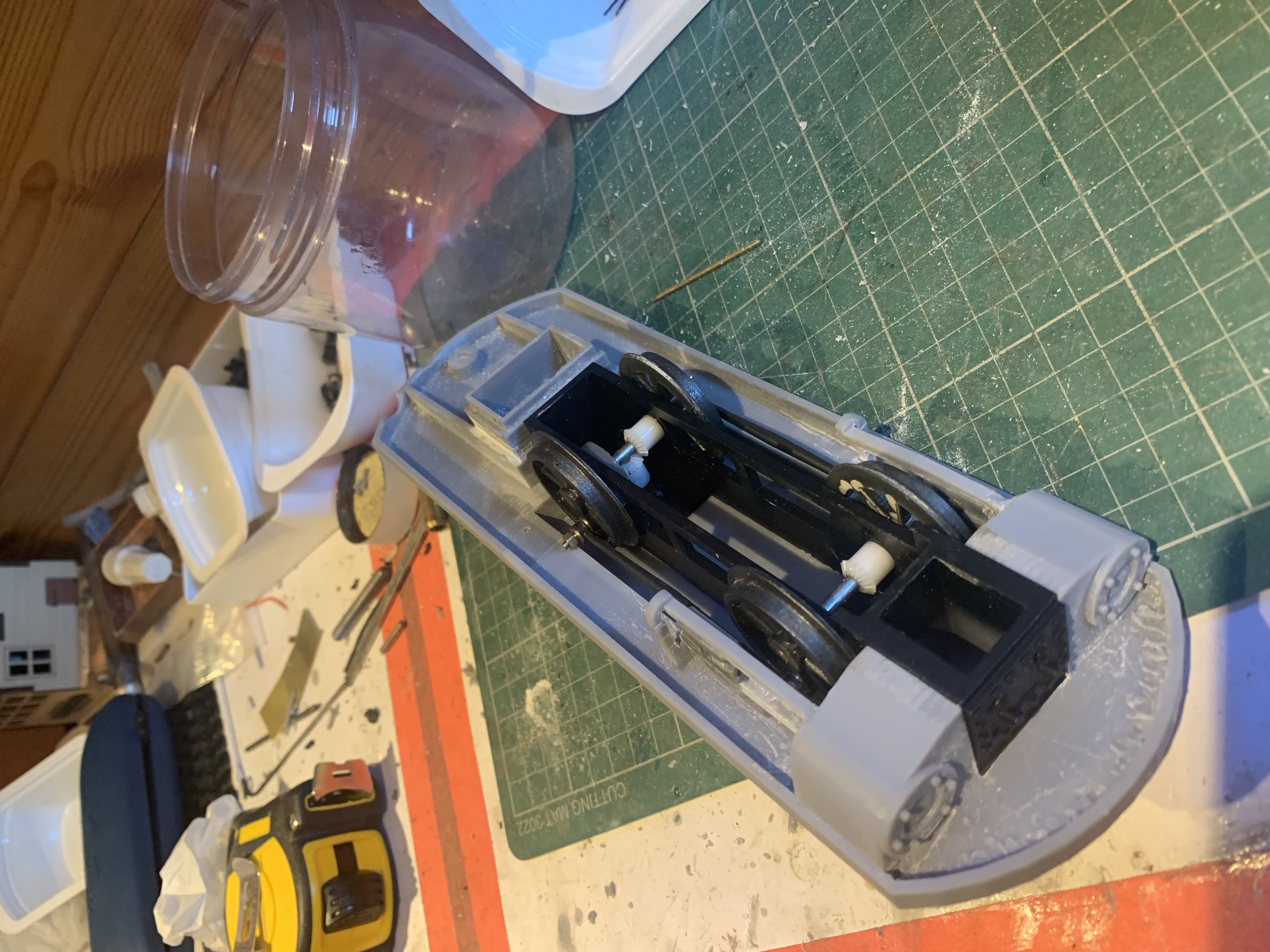

I now have the footplate reprinted, cleaned up and connected to the chassis:
I am using one of those geared motors, which seem to be very powerful for their size - and of course have a second standing by in case it isn't powerful enough.
The top of the footplate has been filed to clean up the remains of the supports. The bushes are fitted and the chassis is bolted to the footplate. I have by the way been running it up and down the test track - so it works so far.
The connecting rods need bushes, and fitting. The crossheads also need holes and mock piston rods fitted. So that is the next job.
You can see where the rear footplate was damaged removing the supports. I have yet to repair that. Also at the front there are the remains of supports which were added automatically to support the front lip of the footplate. I am not convinced that it actually needs supports in that area. Both surfaces were at 45 degrees to the bed - so surely supports were unnecessary there? I have been removing supports and I will experiment further with that.

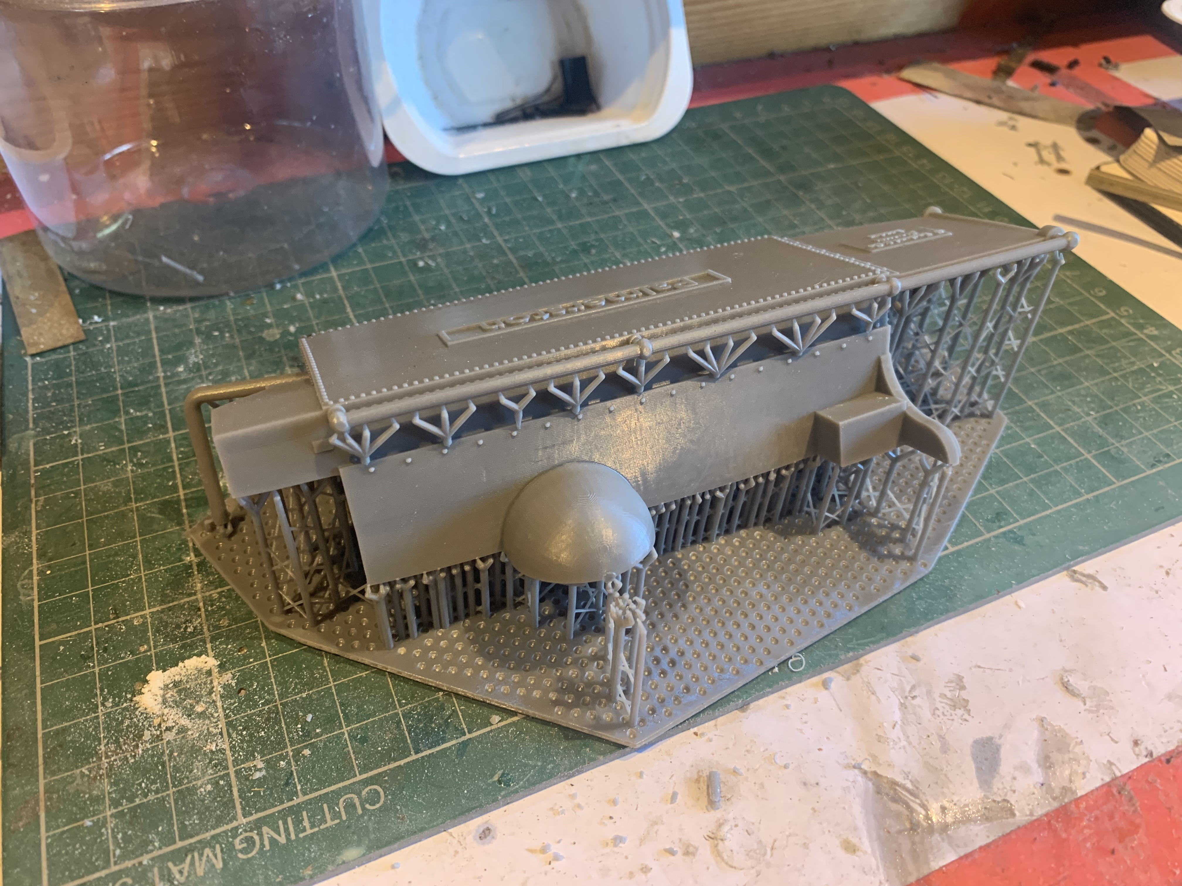

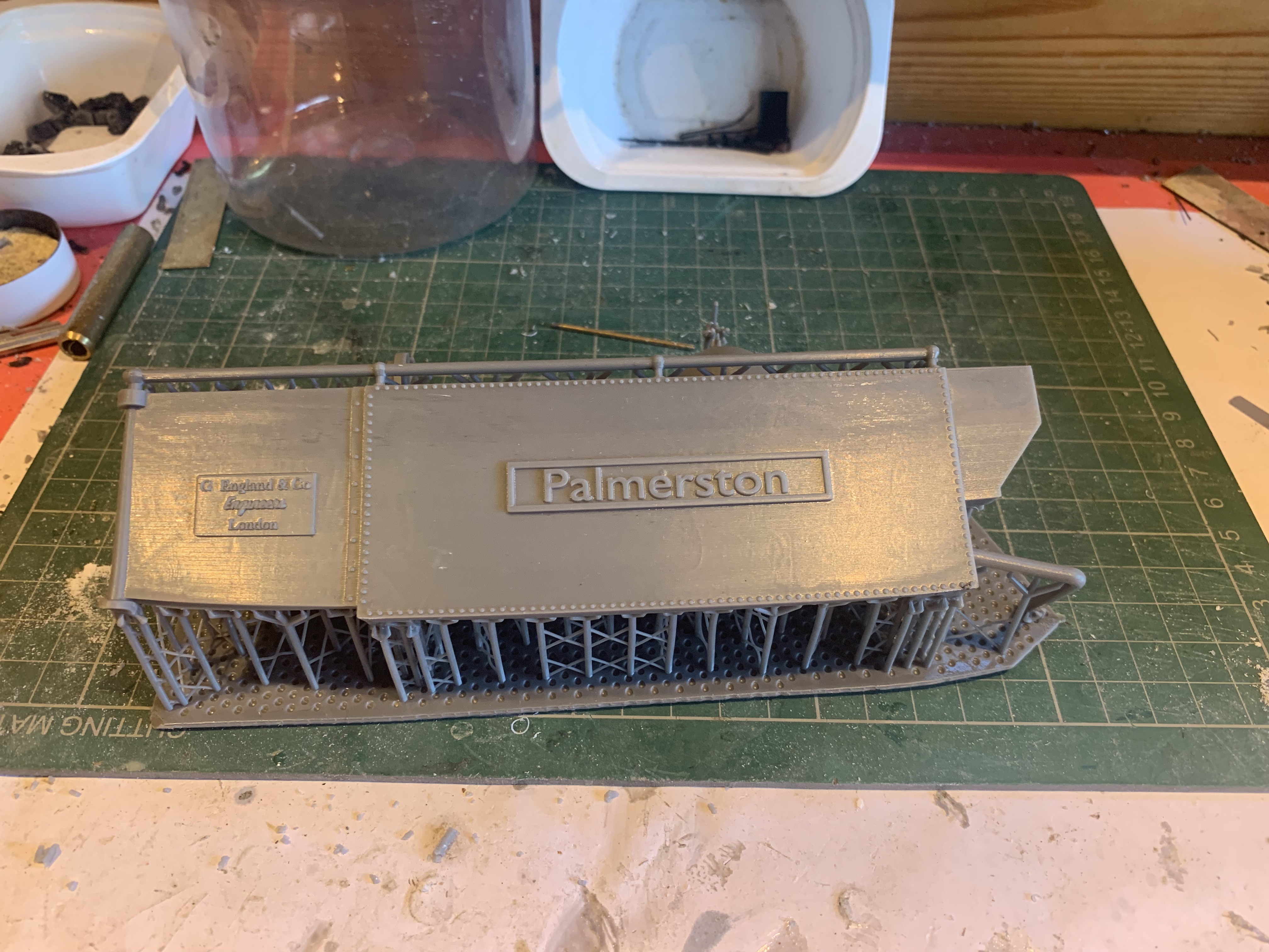

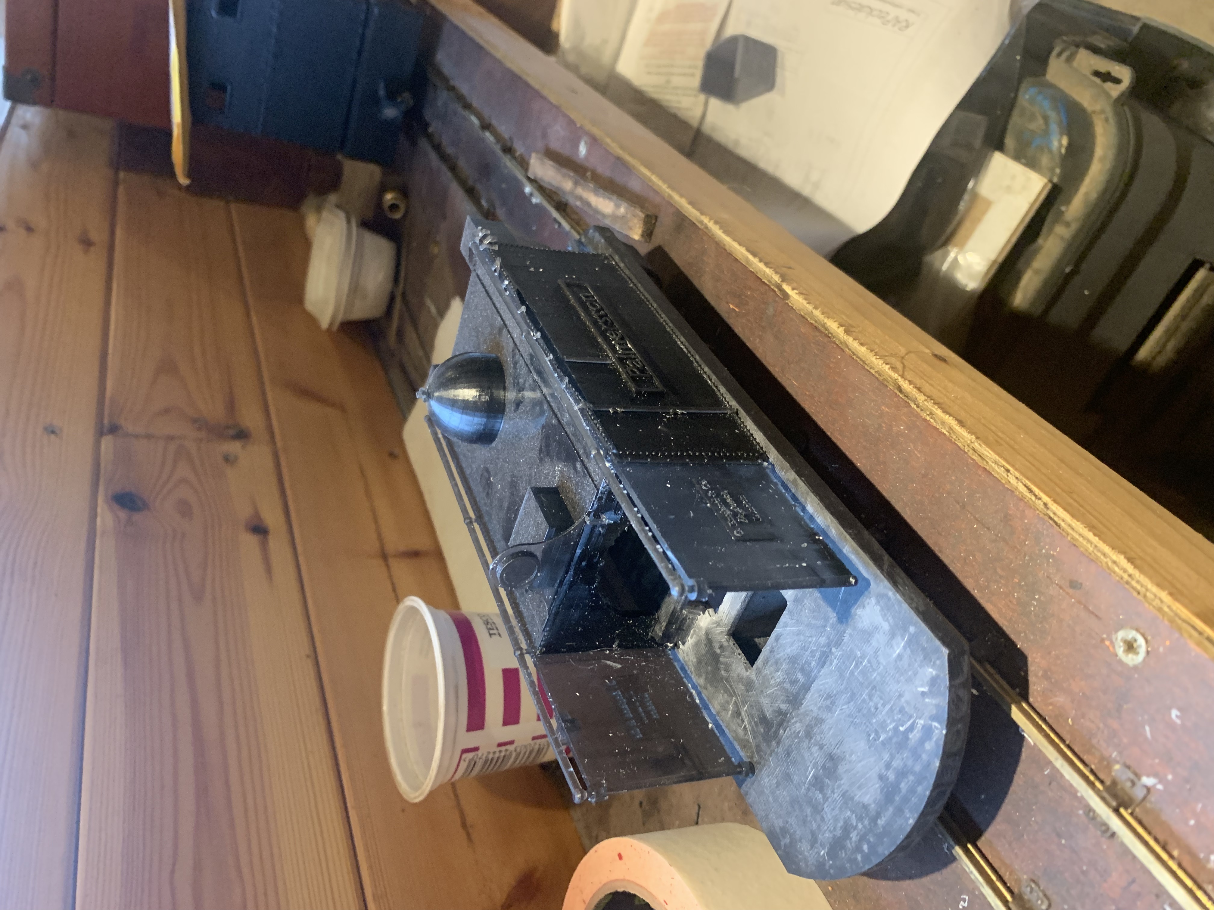

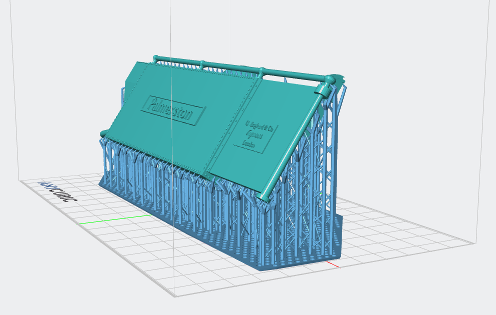

I have made a couple of attempts at printing the body.
My initial attempts to slice the whole body as one part were unsuccessful as the slicing software couldn't handle the data density. So I tried just the tanks and peripheral bits:
I did set this at an angle with the front up in the air - the result isn't perfect - lots of supports stuck to the sides. It also highlighted that some parts were too thin. A disadvantage of working from the drawings as I do is that I inevitably make the part to scale (and that makes it too thin). I have to go back and increase the thickness of the support for the pressure gauge, and the guards around the footplate.
I decided that I would get better definition on the name plate and particularly the makers plate by printing at an angle - side to side. So to avoid the under side being disfigured by supports I split it in half. The second attempt is here:
The writing on the makers plate is perfect now, but look at the distortion on the bottom edge. Bowed. Unusable.
However I think I am working in the right direction. I think that the issue is that I chose the wrong angle. I will try again with a different angle and make sure the inside of the sides are well supported and closer to the build plate like this:
Screenshot 2023-11-28 at 11.53.20.png (180.82 KiB) Viewed 189430 times
Perhaps the problem is that balance pipe at the front which raises the whole thing up in the air.
