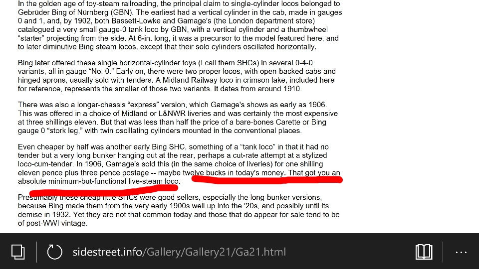

Welcome to the 1,113th topic in this forum. Discussion of a basic tram loco for my as-of-yet-nonexistent Big Maple and Little Oak Railway started here: https://gardenrails.org/forum/viewtopic ... 32&t=14524
Anyway, I mentioned how I could probably build it for almost nothing. Well here you go, I got proof. This is part of an article about an old Bing you can see here: http://sidestreet.info/Gallery/Gallery21/Ga21.html

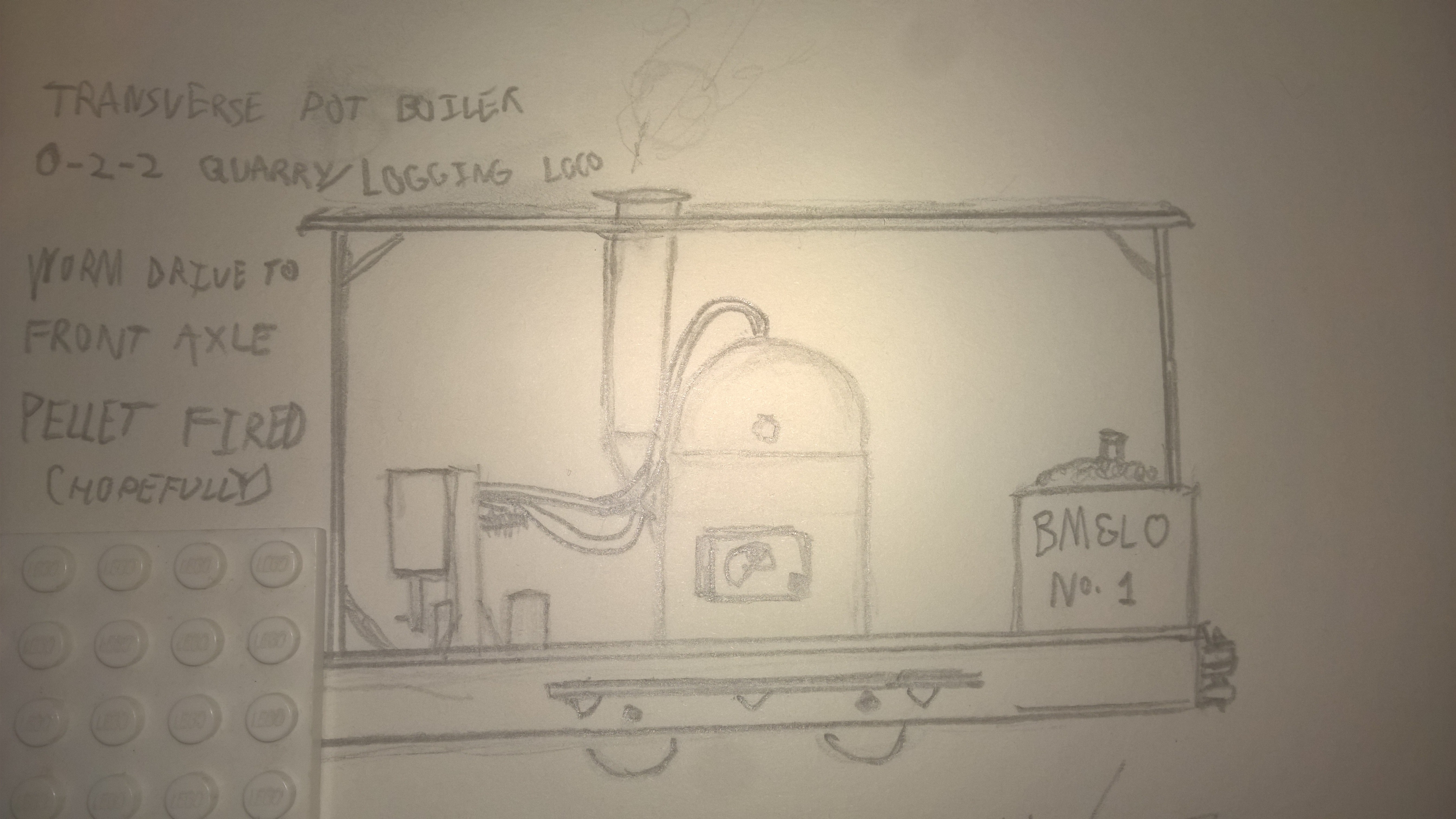

My sketch:
WP_20231123_19_48_12_Pro (2).jpg (3.28 MiB) Viewed 48396 times
As I have written it's a transverse pot boiler, with the stack coming out of the front of the firebox and the exhaust plumbed to it for draft. As with a Wilesco D2 I plan on using the spring on the trunnion as the safety valve, possibly with a tapped hole and screw in the block at the exhaust port to act as a regulator, but at the speeds it'll be going it's probably not necessary.
Thoughts on pellet firing? Seems like a cheap fuel and I imagine easier than coal?

Pellets could potentially work as a fuel source, but most of my (limited) experience suggests liquid/gas fuels make firing easier if you can get the burner right (and safe!). I've repaired pellet stoves and grills and they all use a blower fan to get the pellets burning hot enough. I'm not sure the draft from the chimney would be enough to keep the pellets burning and boil water.
...That said, there's only one way to find out! Do some testing and if it works, would certainly be easier and cheaper to build than a gas burner. :thumbup:

An alcohol burner wouldn't be too hard to build and rubbing alcohol is only 2 bucks a bottle at Walgreens, but pellets would be more realistic. You're right though, the exhaust from the tiny cylinder might not be enough to keep the fire going.

The ones I've worked on kept the blower running the whole time they were burning. They also used an auger for continuous feed of pellets so maybe a small pile of pellets would burn fine once they get going. :scratch: It's worth doing some testing at least!
