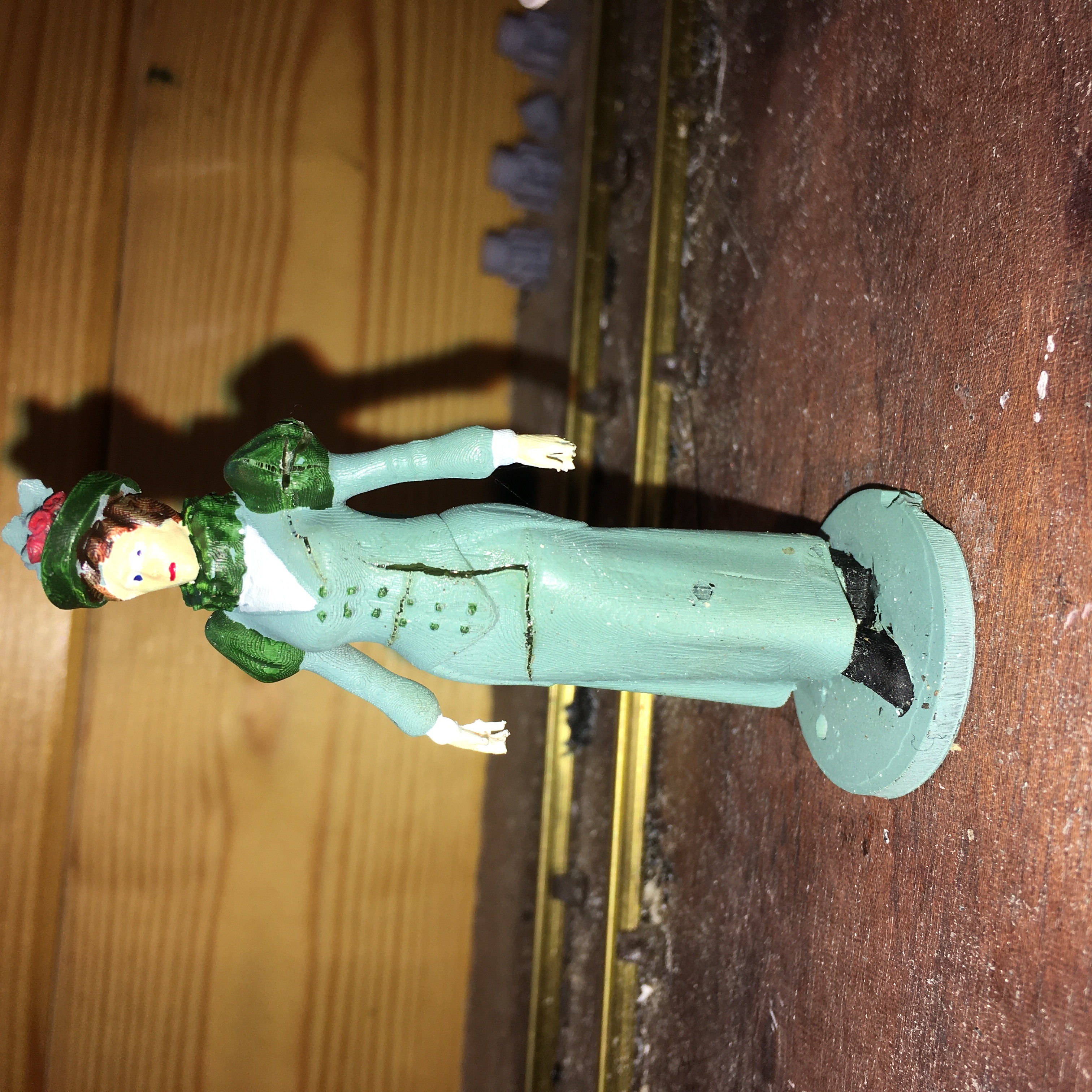

During last summer I left resin printed figures and post-boxes outside for 2 weeks. Laziness really - but the result was a bit of a surprise.
The post boxes developed large cracks - and sort of exploded - but very slowly. Something similar happened to some of the figures.
I was overhasty to throw the damaged items out - and I can only really share this one with you. It has the early signs of what I am talking about:
You can see the dark cracks along the torso, and the left shoulder.

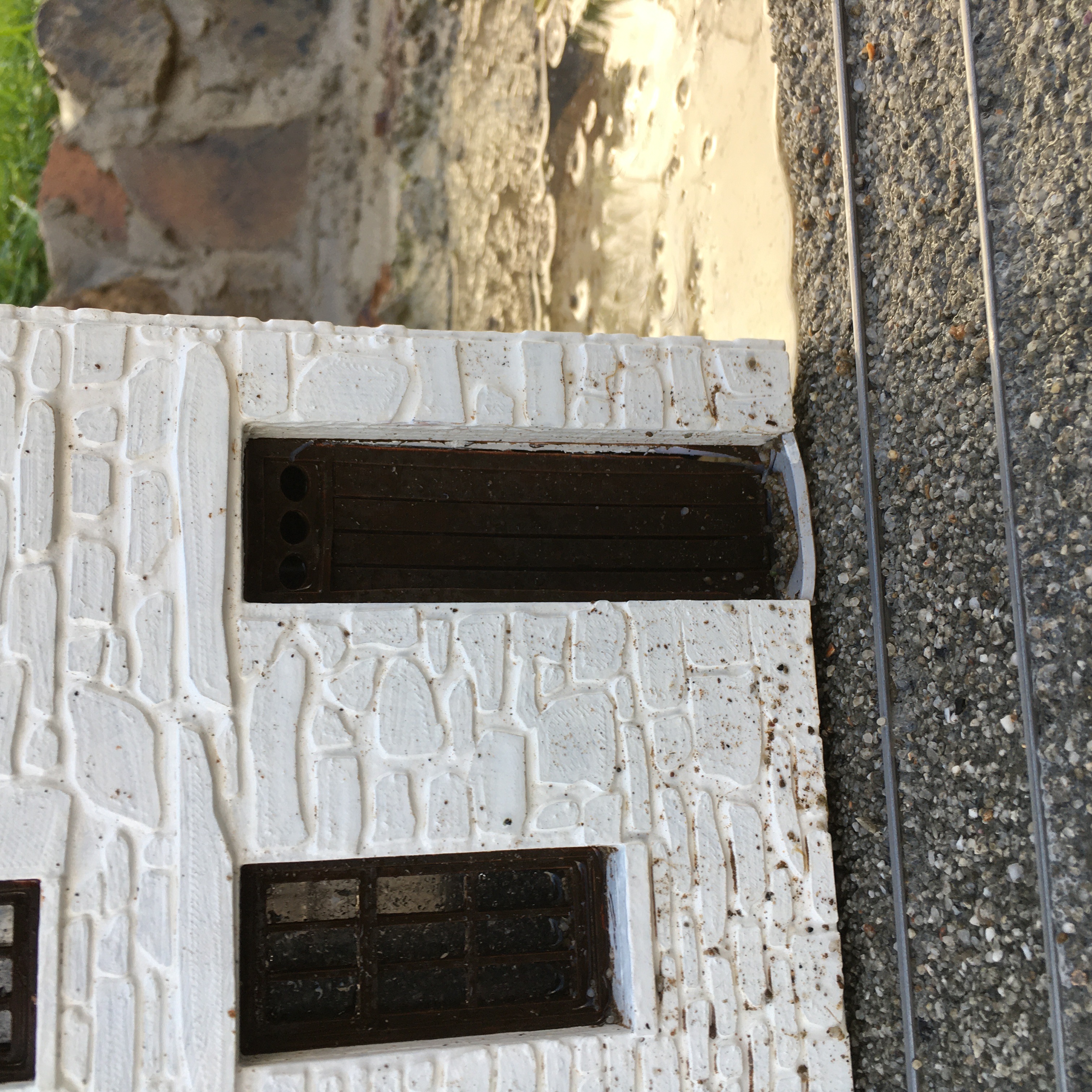

More recently I have left the row of cottages outside - again for about 2 weeks. This went out as soon as the paint was dry. Look at this upstairs window:
The framing has expanded and fallen apart.

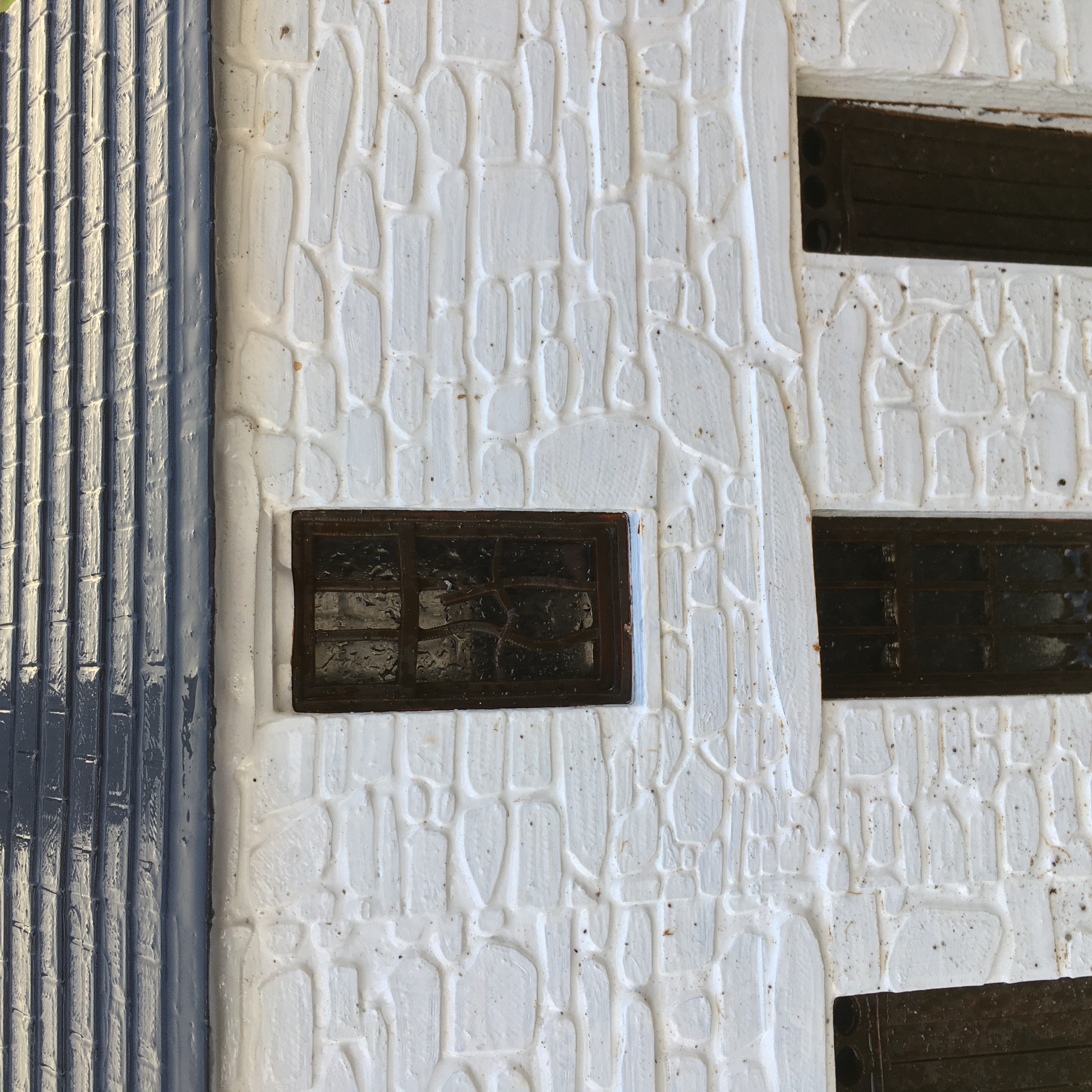

Look at the door in this photo:
The doorstep has curled up, and the door has expanded pushing it into the building. On the other hand the filament printed window next to the door is perfect.
