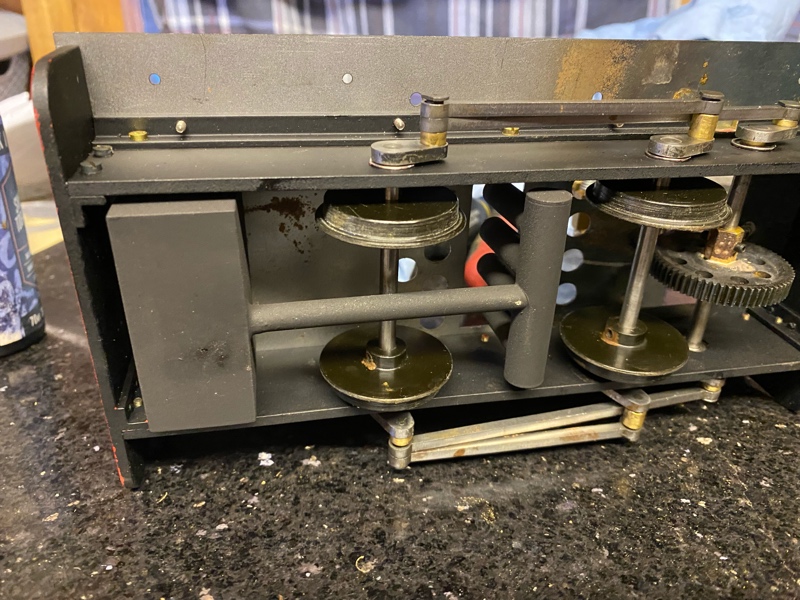

It worked but I didn’t like the idea of it not being self starting or easily reversible as the plan is to run it rc in the end. So I started working on a doubling acting twin cylinder motor, based on the single one but doubled up essentially, with inspiration drawn from some internet searching. The chassis is standard jackshaft ellie but with sealed bearings instead of bushes. I did have some issues with clearance on the gears and motor mounts but ended up soldering on a piece of threaded hex and loctiteing studding in to mount the motor on, this also allows for fine adjustment of the gear mesh which is handy.

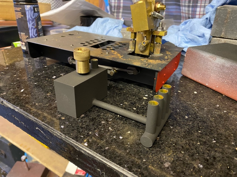

Got the burner/meths tank made up and painted with vht the other day. Pretty much as per the book but with slightly bigger tubing and a threaded insert to retain it in the chassis as I didn’t like the idea of trying to wiggle a pin in there.

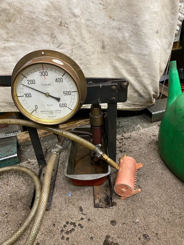

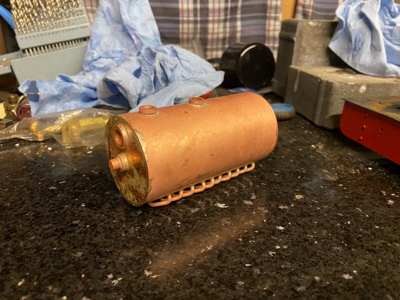

Managed to get the boiler finished up yesterday, it’s a standard Ellie boiler with the addition of some heat exchange pins as advocated by tony bird. I also changed some of the bush threads to allow me to fit a water top up valve and wee bee safety without the need for an adaptor.
Just needs a hydro check and fingers crossed will be good to go

So, things suddenly progressed quite quickly with this due to some enforced time at home due to that pesky virus that’s doing the rounds. Luckily I managed to get the boiler tested before going down with it.

One thing I’ll mention is that if you’re looking at the jackshaft version, the original lubricator design fouls the jackshaft crank, which is why I moved it to the ‘drivers’ area.
Not to sure what I can do about the reversing valve so any suggestions are welcome!
