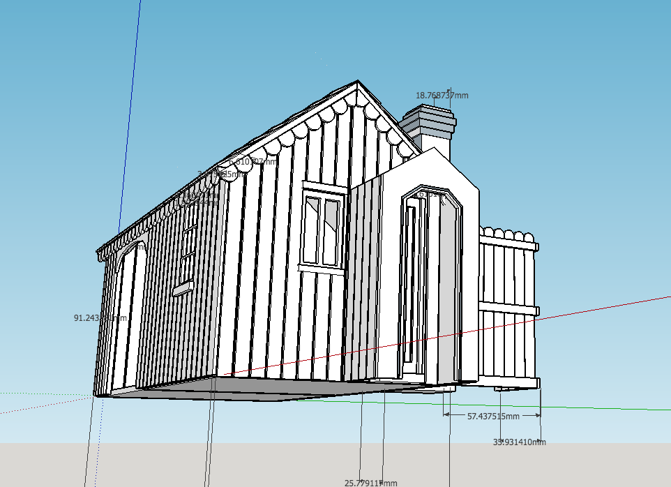

I am thinking about the building to go at the passing place I have been creating on the railway in the valley of the mill.
Since this location is up on the far end of the garden, and near the "open grass lands" of the lawn it seemed appropriate to make a model of Dduallt station building to fit this situation.
It is the original wooden construction of course that interests me - not the modern stone one. The drawings were given to me by a local 7mm modeller David John, for which I am grateful.
So far:
Screen Shot 2021-09-03 at 15.17.05.png (59.34 KiB) Viewed 17728 times
The sides will have to be printed in 2 parts - as will each side of the roof, otherwise each component should fit on my printers bed in one piece.
So that is the sides, floor, chimney porch and urinal created. The roof will be the interesting thing to draw because I want overlapping slates again like on my previous buildings. I have so far got away with overlapping the components for this (because my printer can cope with it) but I will try to make the individual slates an exact fit on the subframe this time. More to follow:

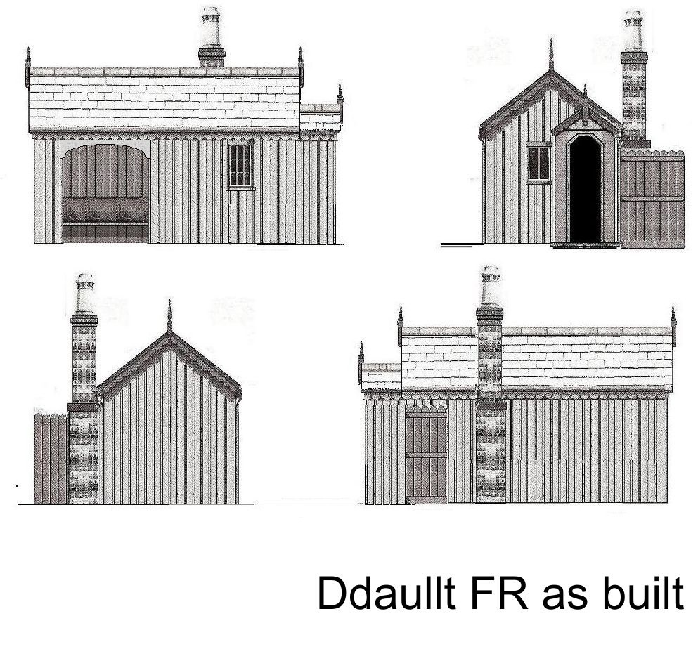

David John has confirmed that I can share his drawing of the station with you.
Ddaullt as built copy.jpg (303.33 KiB) Viewed 17713 times
The drawing is based on photographs, and has been manipulated to make the verticals vertical, and to maintain the proportions.
So to create my model I have imported the drawing into sketchup, and scaled it on the basis that the door frame would be about 6' tall.
I then used the drawing to create each side on top of the drawing. Then I moved the sides into place.

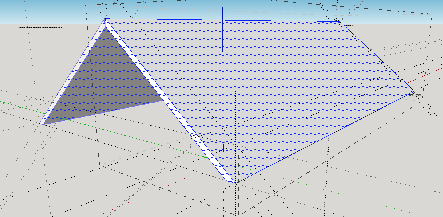

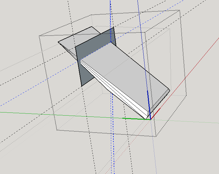

A bit of detail on creating the roof. Perhaps more of interest to anyone who is using Sketchup - but the principles apply to any drawing package.
Having drawn the walls and added the plank detail on top of each side I created guide lines along the top of the building. That enabled me to fine tune the sides so that the guidelines all intersected. I then drew 4 lines to make the shape of the roof panel. It required a few attempts to make sure that the guide lines were exactly true, but the effort resulted in a rectangular box which filled automatically. So a solid surface which I pulled 2.5mm I find that panels like roofs and walls need to be at least 3mm which to remain flat and have strength. So 2.5mm is a good base to build detail on top of it.
This roof panel was made into a component. Using components ensures that the shape you have created does not distort as you move it around. It also means that the thing you have made can be used again. So one roof panel copied and pasted makes the two sides of the roof:
Screen Shot 2021-09-03 at 21.43.17.png (95.72 KiB) Viewed 17702 times
After making the basic panel as a rectangular block I then edited the component (another advantage of components is that you can go back and improve it later - and the changes will be applied to every copy of the component you have used). I have also adjusted it so that it overhangs appropriately over the walls. I added more guide lines to help me make the top corners of the two panels meet accurately and the eaves to be horizontal ready to take the valences:
Screen Shot 2021-09-03 at 22.06.56.png (31.67 KiB) Viewed 17702 times
So that is the basic roof.

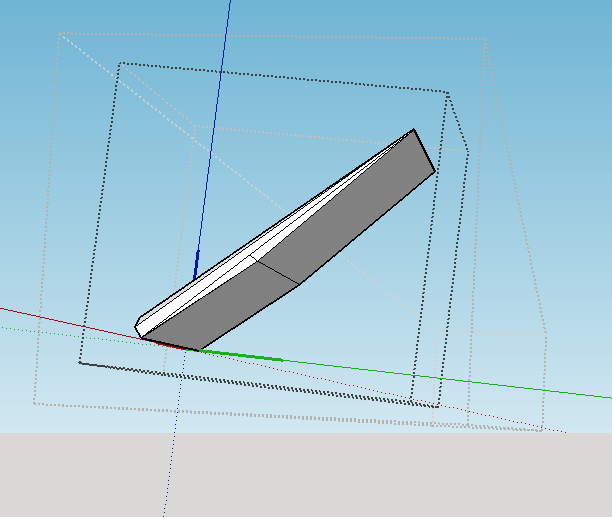

I have modified a copy of the first slate and made it a unique example of the first component - its like making a second component which is a subset of the first but has the same overall name.
I placed it on the roof at a higher point so it half covered the first slate, and rotated it so that it sat truly onto of the first slate. That meant that the top of this second slate disappeared into the roof. So intersect the slate with the top of the roof panel again and delete everything below the intersection. A bit of messing about drawing lines was needed to get a solid undersurface, but here is the second row slate:
Screen Shot 2021-09-03 at 22.27.34.png (57.56 KiB) Viewed 17696 times
You should just be able to see that there are two distinct surfaces on the underside. Well near enough. I may improve it later. And this is how it sits on the roof:
Screen Shot 2021-09-03 at 22.19.13.png (61.81 KiB) Viewed 17696 times
It isn't in the right place yet, and I need a half width version of it as well for this layer, but more of that later.

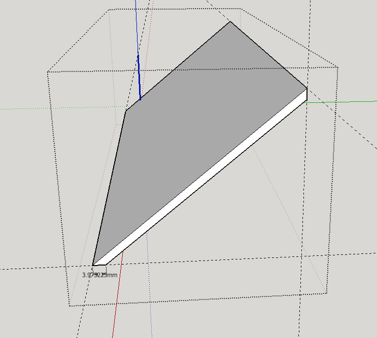

The second and third layer went into position as planned. However the third layer sits at a slightly different angle to the second one. So I used guide lines to mark where the roof top actually sat and then drew lines onto the model to follow the changed profile on the edge of the slate. Cutting and pasting these guide lines into the slate component allowed me to draw the changes onto the edge of the component, and then fill in the underside:
Screen Shot 2021-09-05 at 09.46.47.png (32.5 KiB) Viewed 17641 times
You can now see a two clear flat planes on the underside of this slate.

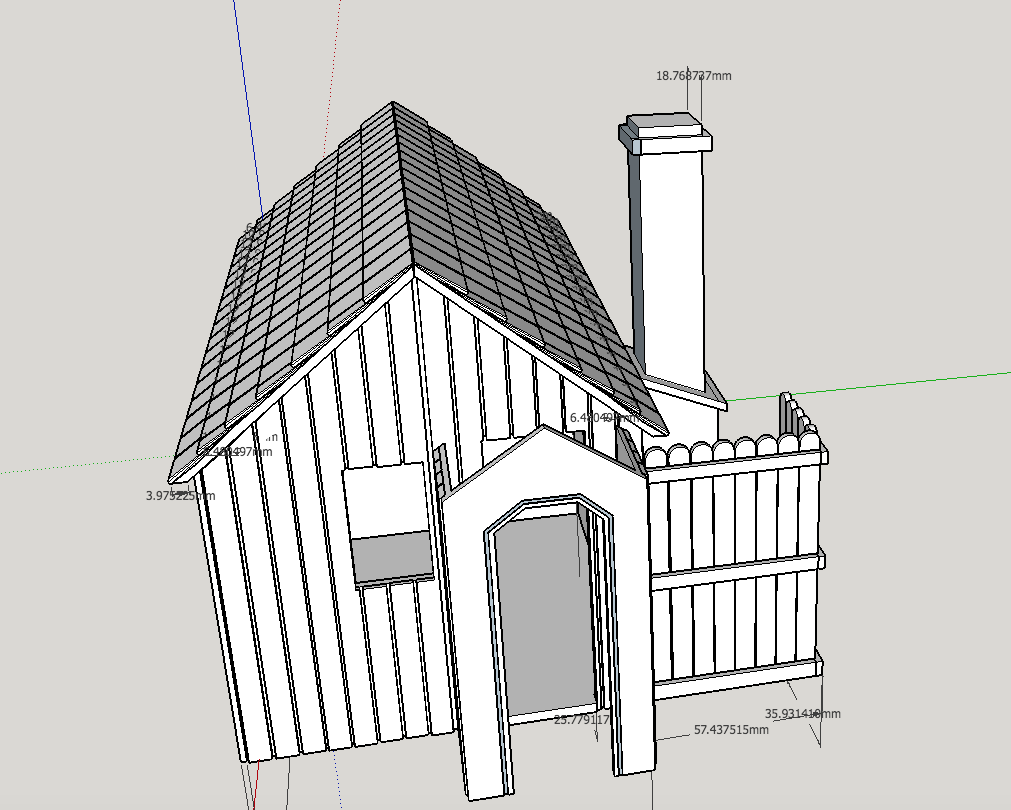

Selecting the roof base and each layer of tiles I then created it all into a group. It took a couple of attempts to make sure I had picked up all the different groups and component that I wanted. Then copy and past in place created another copy of half the roof superimposed on the first half, which I could move to one side. Under edit there is a commend "group" which has a subset" flip along" and along " groups green". So that created the second half of the roof which just needs moving into place. The second half is really just for show - although it does make sure it fits properly into place. When I come to export the .stl files for the slicing software I will only export one half - and print that half twice. The final roof:
Screen Shot 2021-09-05 at 10.09.30.png (96.21 KiB) Viewed 17638 times
Door windows and porch roof next I suppose.

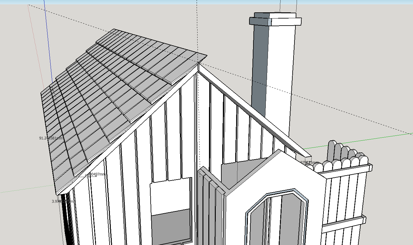

Yes its a nice building, and too good not to model. The roof valences, windows and door all created. I am now working on the chimney.
Screen Shot 2021-09-08 at 15.58.17.png (63.08 KiB) Viewed 17568 times

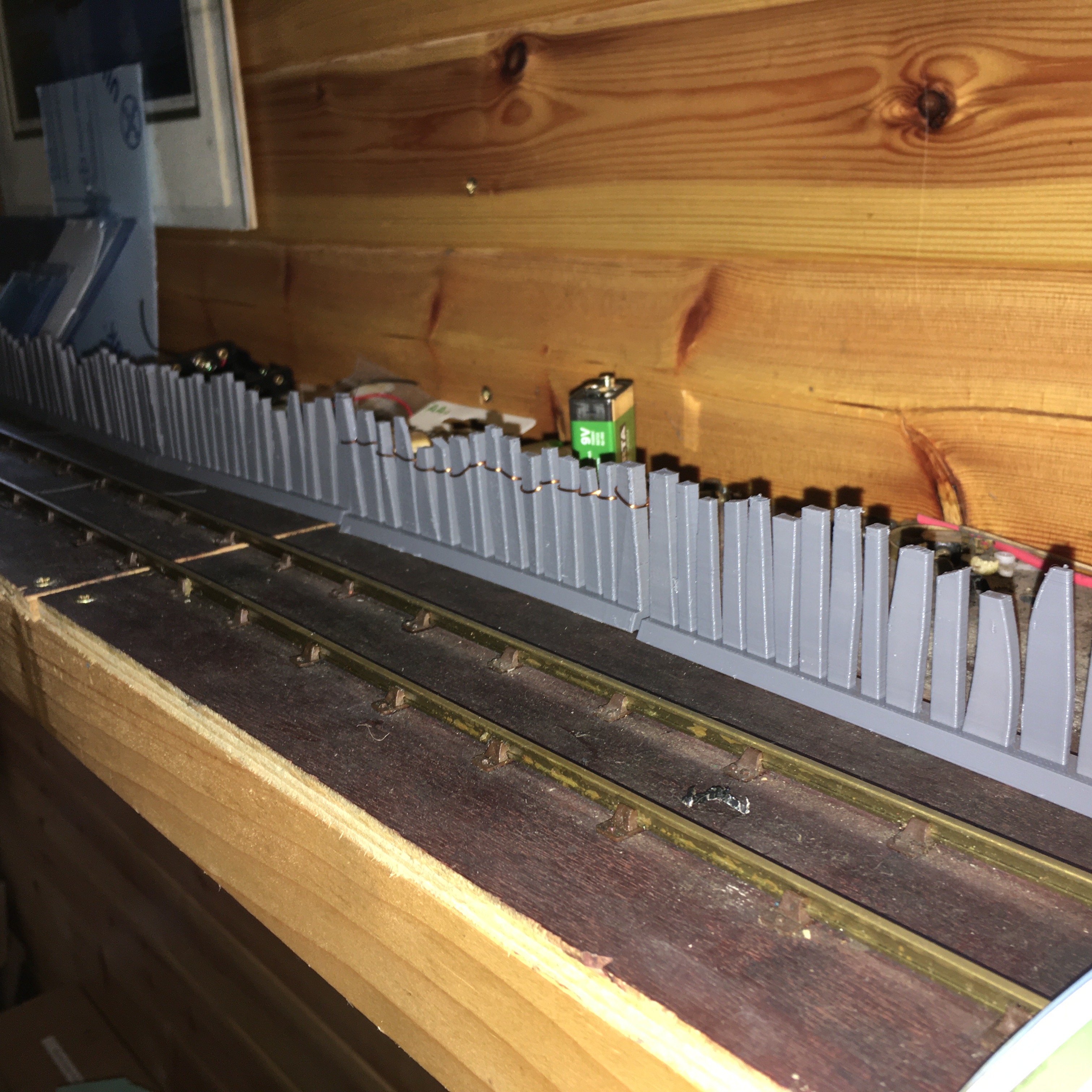

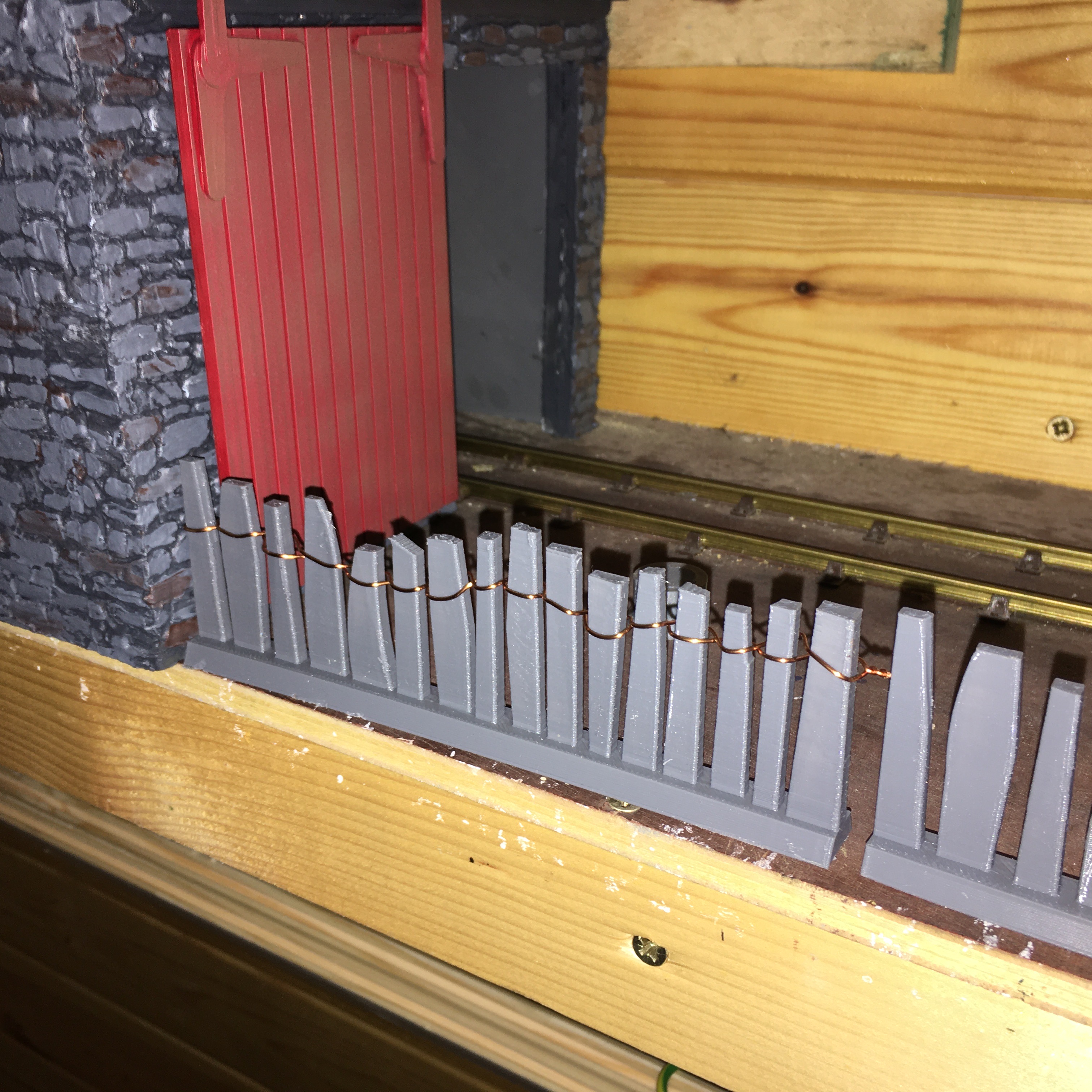

I have also created a length of slate walling which I intend to run along the edge of the track behind the building:
Screen Shot 2021-09-08 at 16.02.21.png (70.12 KiB) Viewed 17568 times
I have some copper wire which I can interlace between the slates like in the prototype. I am currently printing 6 lengths upright at once in PLA. I'll let you know if it works!
Re: Dduallt Station building
Posted: Sun Sep 19, 2021 10:50 pm
by Trevor Thompson
I have made the slate walls:
The wire I have wound around the tops is a bit thick - probably will buy thinner wire in due course.
As a long row of fencing I think it will work - particularly as a background for photos. However I will have to keep the petrol strimmer away from it if I use it in the garden.
I made it in lengths of 150mm, made 8 of them at a time in PLA, and directly onto the bed.
I have added the STL file for it to the files section in case anyone else is interested.

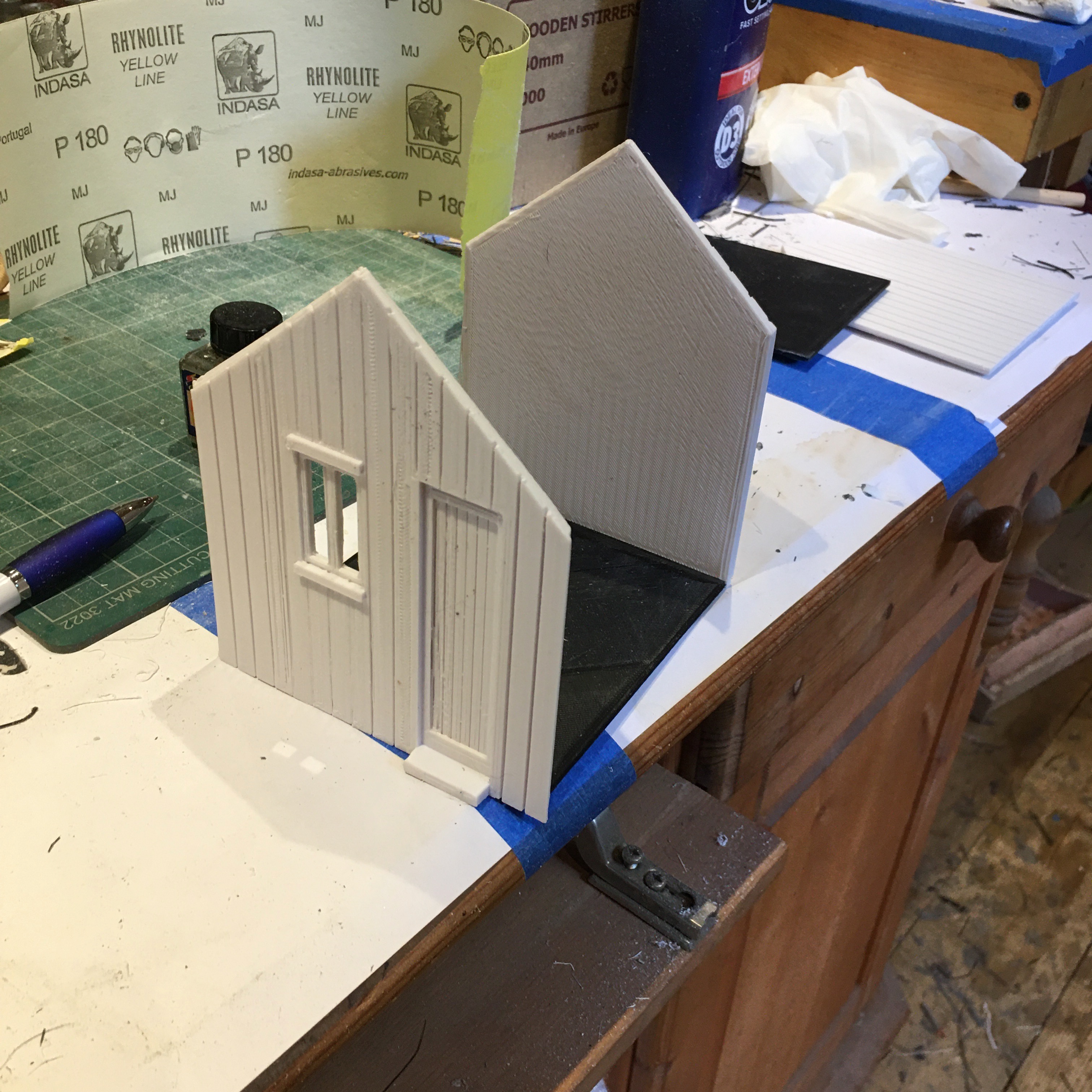

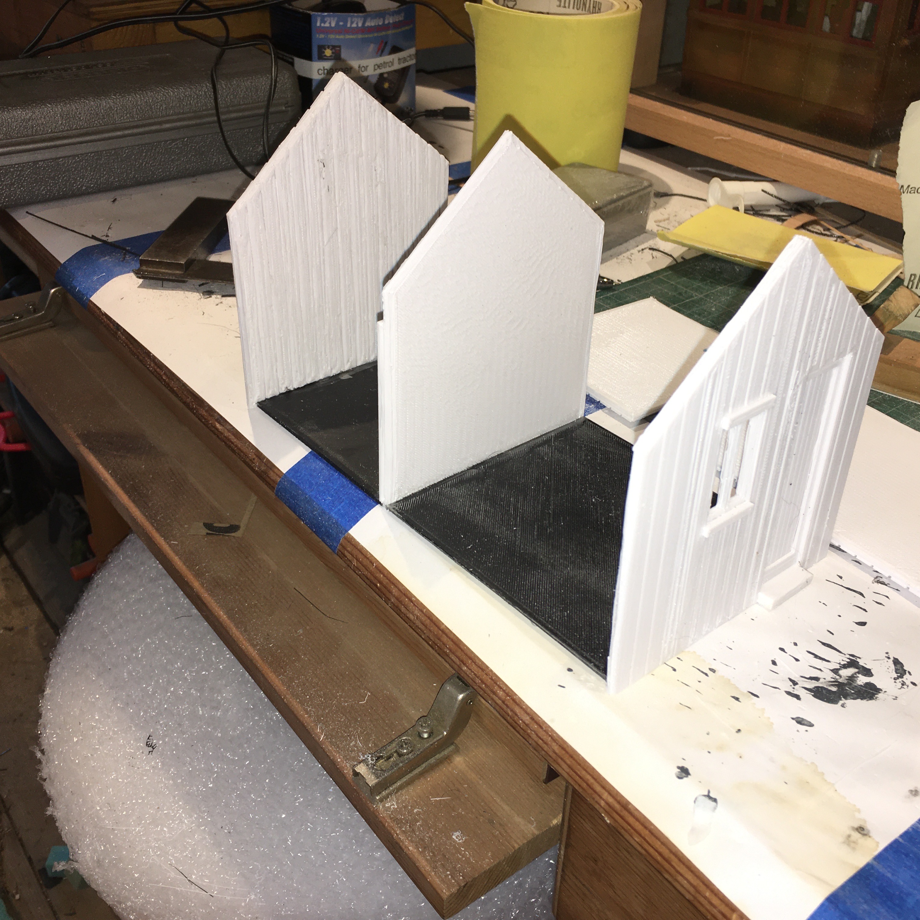

The floor and end walls of the station building are now printed, but before I show you the photo I thought it might be worth a few words on printing these parts.
My printer uses a flexible build plate which has a film glued to it. It is a replacement item. So to print the section of slate walling I used a new one. The PLA which I used for the slate walls adhered well to it, and came free when printed by bending the print plate - as the manufacturer intended. Those parts were made without a raft or brim.
However ABS is different - and mostly I use ABS. My first attempt at the floor in ABS, with no raft came off the bed quite quickly. The usual method of helping ABS to stick to a bed is to wash the bed with an "ABS slurry" - which means resolving ABS in acetone, and rubbing that on the bed. I have tried that with various thicknesses (more or less ABS in the mix), and a fairly weak mixture seems to work best.
Now we come to the next issue. The bed plate, treated with the slurry causes the ABS to stick so well that it is difficult to get the part off the bed without damaging the film on the plate, or the part just printed.
So I have gone back to using a raft. I lift the part 1mm above the bed, add supports, and slice with a raft. That allows me to get the undamaged part off the raft easily. It does mean I have to clean off the supports from the underside. I can then destroy the raft chiselling it off the plate without damaging the film on the plate. If I don't lift the part 1mm then the part sticks to the raft and is almost impossible to get off cleanly.
So perhaps this explains why I am using a raft. Perhaps my printer does compensate for a lack of a levelling mechanism by using rafts - but I am not so sure that it is actually correct now. I can print quite accurately over the whole bed area without a raft - but with PLA!
So the two sections of end walls and the floor assembled:
The top surfaces of the prints look good to me - with the plank joints clearly visible and evenly spaced. The one end which has planking on both sides has poorer quality on the inside - the face which the supports were attached to, but that is inside and I don't think it will be noticeable.
This is the issue:
You can see long lengths of filament running along the length of the planks which are not attached to anything.
I will explain it in the next post.

So the issue is that when it is printing the planks the filament is falling into thin air between the supports. Hence the loose strands.
The solution - turn the model through 90 degrees so that the supports run at 90 degrees to the planks.

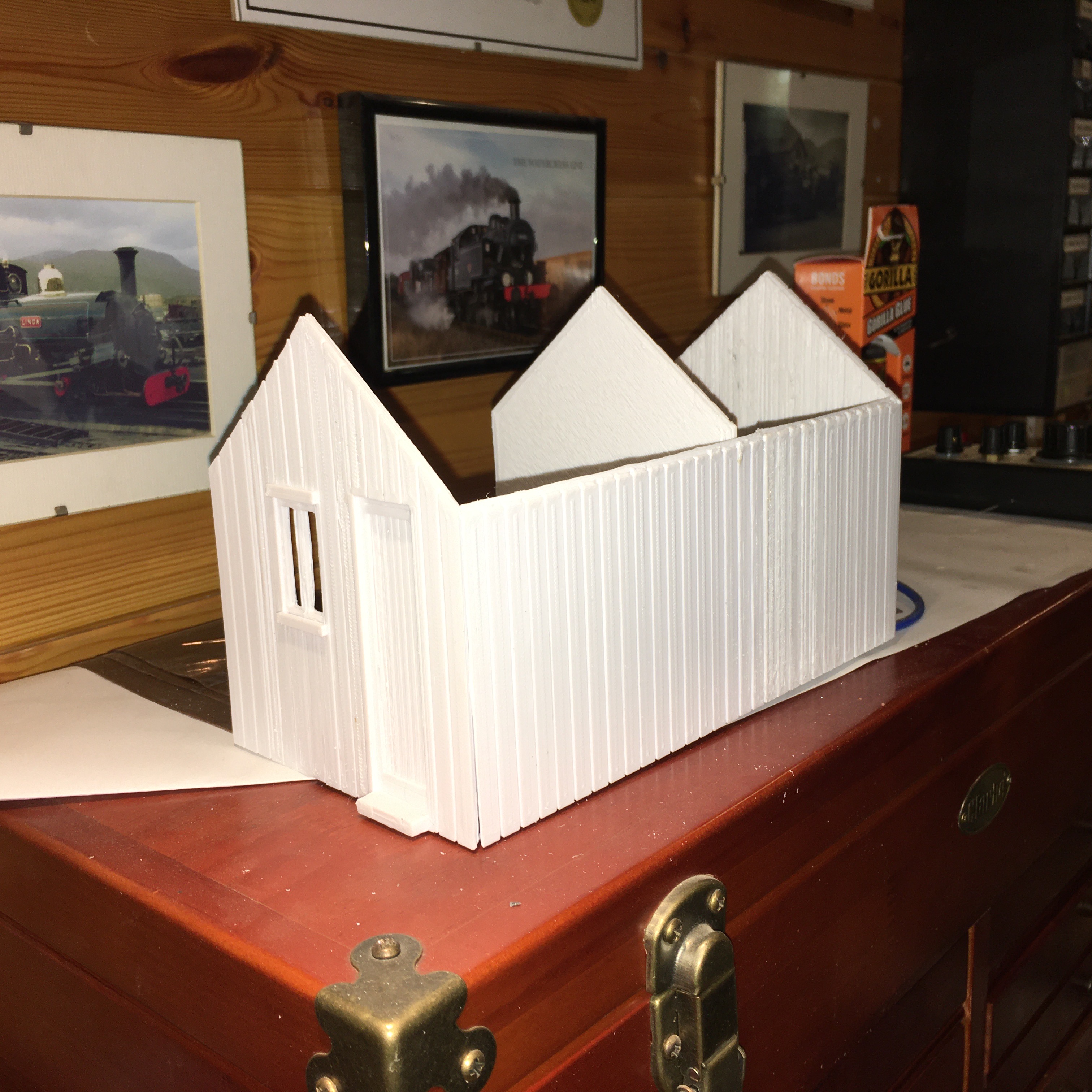

Assembly progresses:
Three end walls and two floor sections assembled:
and the rear wall added:
For ease of construction, if I were to repeat this, I would assemble the rear wall to the end walls first and then add the two sections of floor with the centre wall between them afterwards. It is a matter of aligning the different parts accurately before gluing them together. I am bonding the parts together initially with acetone brushed into the assembled joint - just like we always have with plastic kits. In this case the solvent is acetone. When I am satisfied with the assembly I am in the habit of adding a fillet of that ABS slurry I have already described. Fairly thick this time and administered via a small syringe (left over from administering specific quantities of medicine into a pets food).

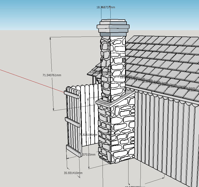

and something I have not tried before, putting the stonework onto the chimney to be printed with the chimney. I wonder if it will print OK:
Screen Shot 2021-09-30 at 10.12.47.png (88.02 KiB) Viewed 17512 times
Having successfully printed the sides and floor I am going to correct the minor errors before making them available to download via this forum. I will add the rest of the files as I have tested and corrected them.
