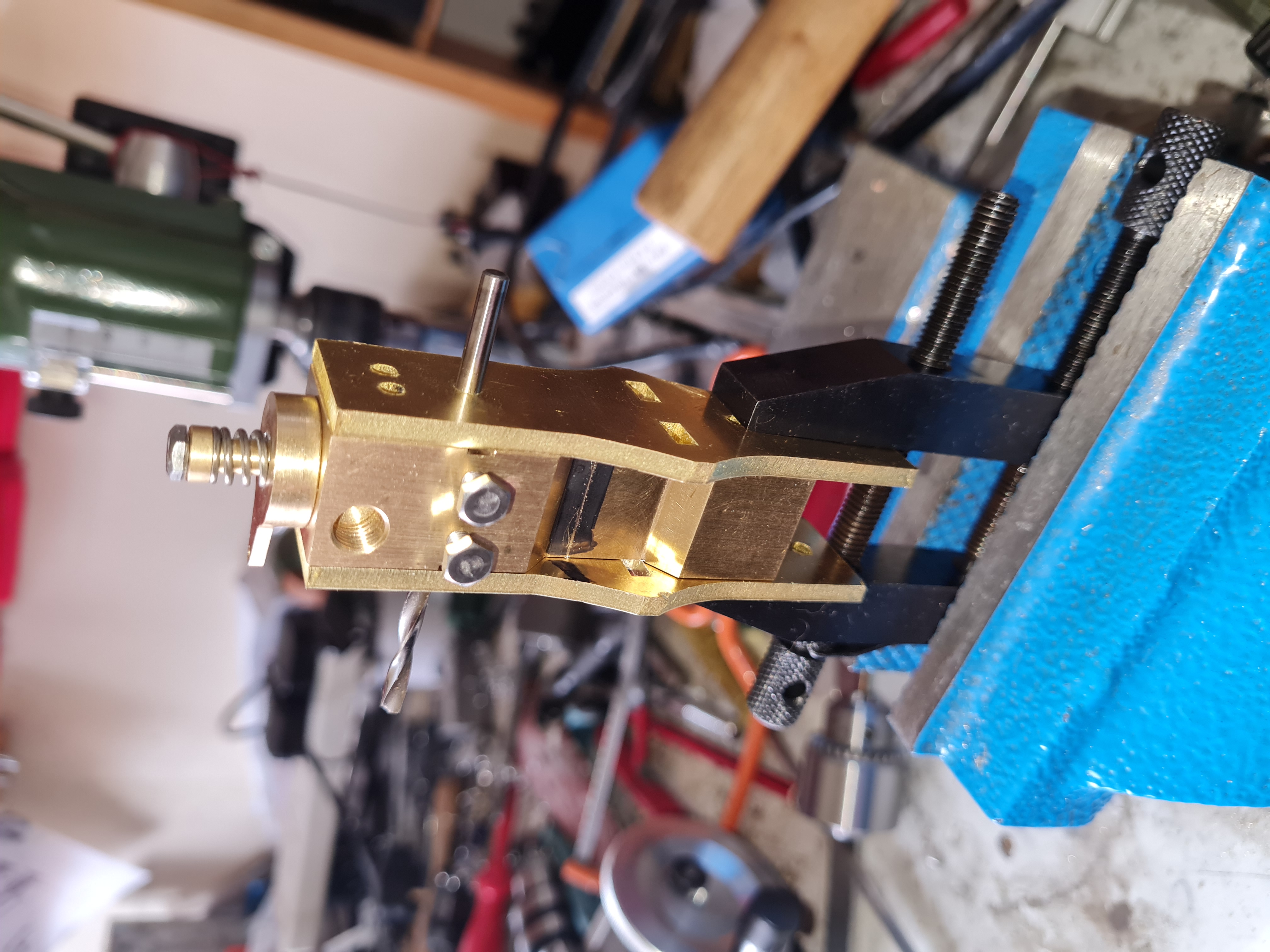

Posted: Wed Sep 29, 2021 3:20 pm
by Nickclarke
I have arrived at a solution for converting from single acting, single cylinderto double acting twin cylinder and it is surprisingly easy. I bought the standard and reversing valve from Jerry at Clevedon Steam, it is what is used on his Virgo engine. It was almost made for the job! It will be cut on the line shown in the pictures and silversoldered between the laser cut engine frames I got from Camden Minature steam. In order to make the ports line up, I will use a 1/16 ball nose end mill to machine 1/16 deep grooves on the inside faces of the two laser cut frames/standards before silver soldering the three parts together. I will need to make a new spacer piece to accomodate the 16.5mm gap between the engine frames. The 16mm gap will just about acommodate the flywheel and drive gear, which will be pinned to the flywheel. Job done! (In theory at least!).
The following photos should explain....
Standard sandwiched between the two laser cut frames.
Re: Ellie The Steam Tram
Posted: Thu Sep 30, 2021 8:51 am
by Garethh
That’s a clever solution, I like it! Do clevedon sell the reverser assembly on its own then? My thoughts were along similar lines but I was going to use a separate reverser block to make things easier as I don’t have access to a mill. This is a much neater way of doing it though!
Posted: Thu Sep 30, 2021 9:01 am
by Nickclarke
Yes, Clevedon will sell the standard seperately, give Jerry a call or an email. It is a much easier solution than having a maze of pipework to deal with if a seperate reversing valve is used.
