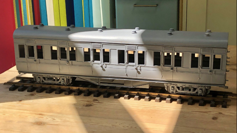

Buffers would be nice but unfortunately they cause problems on curves
This is a prototype for the fantasy 3’11” gauge BR and a product of the 2021 Modernisation Plan, which calls for the removal of rotting wood from the track (done), abandoning track power and replacing rubbish rolling stock.
At a little over 550mm, it’s rather longer than previous efforts (though still not as long as it ought to be, obviously) and is built around GRS ‘compartment modules’, with LGB bogies (temporarily, I hope), a planked foamboard roof and foamboard seating (to be added after painting). As you might expect, it’s going to be green.
Another cunning plan is to build longer wheelbase bogies, clad with more appropriate, resin-cast sides — to give a bit more width and to look a bit more Southern Region — but that’s not yet progressed beyond notebook scribbles. It might take a while.
And I’ve bought a large box of cheapo 1:25 passengers, which will probably take about five years to paint.
When the coach is done and OK though, the idea is to build a few more (and attempt to figure out where on earth I’m going to store them).

That does look good and the GRS modules have gone together well. Most inventive!

Thanks. The modules are a bit over scale (G3) for my purposes really and though it may not come over in the (peculiarly lit) picture, looking at it from across the room, the coach does look pretty substantial. Good fun.

It looks 'the biz'! Regarding buffers, could yo make some 'low profile' ones? They needn't protrude further than the handles for the roof ladders (I think that's what I can see). Or bite the bullet and decide that a narrow 'standard gauge' British Railways decided a single central buffer was the way to go? :dontknow:
Either (any?) way, it looks excellent and will complement your locos nicely.

I’ll put buffers only at the back of the last coach, I guess. The coaches will have to be in a numbered, permanently coupled ‘set’, of course, it being the 3’11” SR.
I think I might have to do some clever roof-mounted (internal!) storage in the shed.
And I’m afraid there will be more diesels!

The lift-off foamboard roof, presumably because of heat, direct sunlight and / or several sprayed coats of primer on one side only – I dunno – has gone a bit banana shaped. I’ll attempt to screw it down flat but I think I might have to come up with another way to make, or fit, them (roofs, I mean).

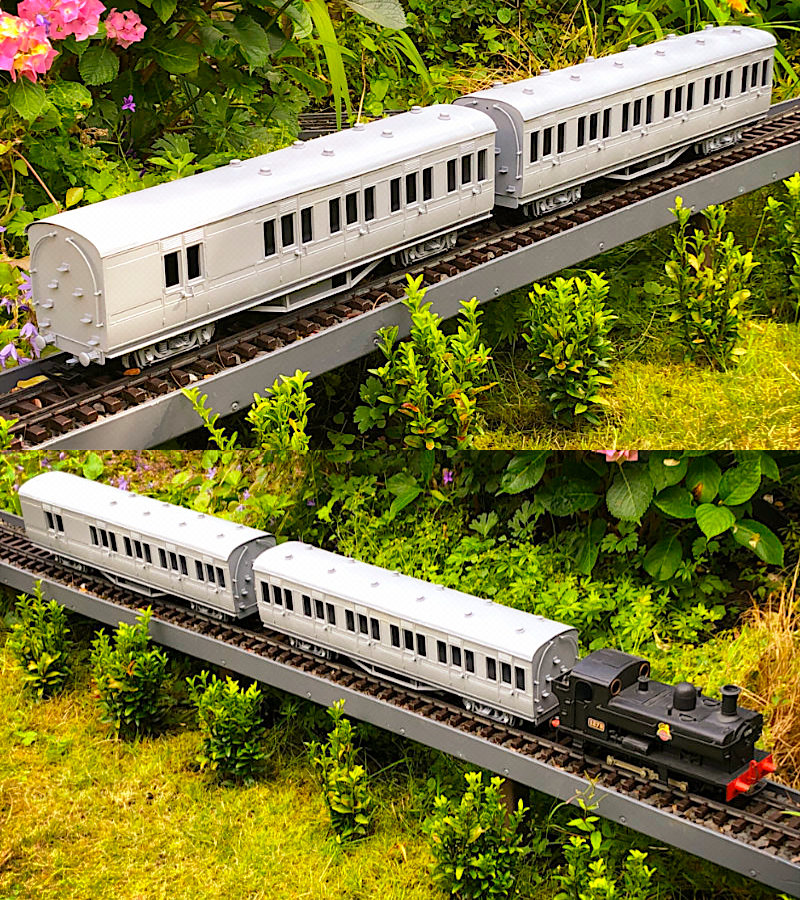

Now there’s a brake coach too!
As always, it features a couple of totally avoidable, sloppy mistakes and, preoccupied with avoiding any issues negotiating tight curves, I’ve gone and coupled them way too far apart (and yes I did test it). I’ll need to fiddle with that. I’ll have to write ‘concentrate’ on the back of my hands for no.3.
I think they’ll be fine trundling round the garden though. And they do look big.

They may look big but they also look very good, and impressive :)

Those are really very nice indeed, love the detail!
I'm not the only one thinking "Annie and Clarabel" though, surely? I'm guessing the livery will be a coat of Sodor orangey-brown?! "Duck" will need to go green, of course...
