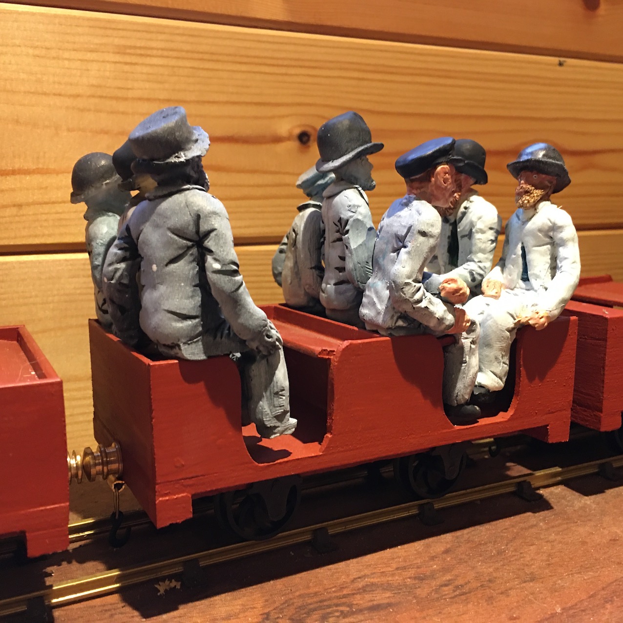

So what am I trying to achieve? If you look at photos from the Victorian period, you will see that everyone wore a hat, and all dresses were long. I want to replicate that in my models. Passengers on station platforms, engine drivers, seated passengers in coaches, etc.
I have done this in the past using modelling clay - the sort you bake in the oven. A couple of examples to highlight the issues:
Festiniog Railway guard uniform from the Victorian period - well as close as I can make it by hand. Frock coat, beard, and money satchel.
Festiniog quarryman's coach with quarrymen:
Bowler hats in evidence - and not all the same shape, lots of beards, and the way the jacket is buttoned at the top, and the rest hanging open. White linen suits. All to be seen in historic photos.

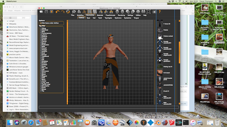

So what does it do? It allows you to create "anatomically accurate" people. Any age, any gender, muscular or weedy. everything that varies in real people seems to be adjustable:
Screen Shot 2021-01-04 at 18.50.01.png (450.25 KiB) Viewed 75893 times
This is what the programme looks like. All the adjustments are on the top two rows. You just need to experiment to see what changes.

Under geometries there is a set of adjustments on the lower row which allow you to add hair, clothes and the like. There are some basic clothes in the basic programme and others can be downloaded from the makehuman forum. They are called "Assets".
The other important feature is under "animate" and it is "skeleton":
Screen Shot 2021-01-04 at 18.53.16.png (456.74 KiB) Viewed 75893 times
It does not seem to matter much which you use but the figure needs a skeleton if we are going to be able to move its arms and legs later in another programme.

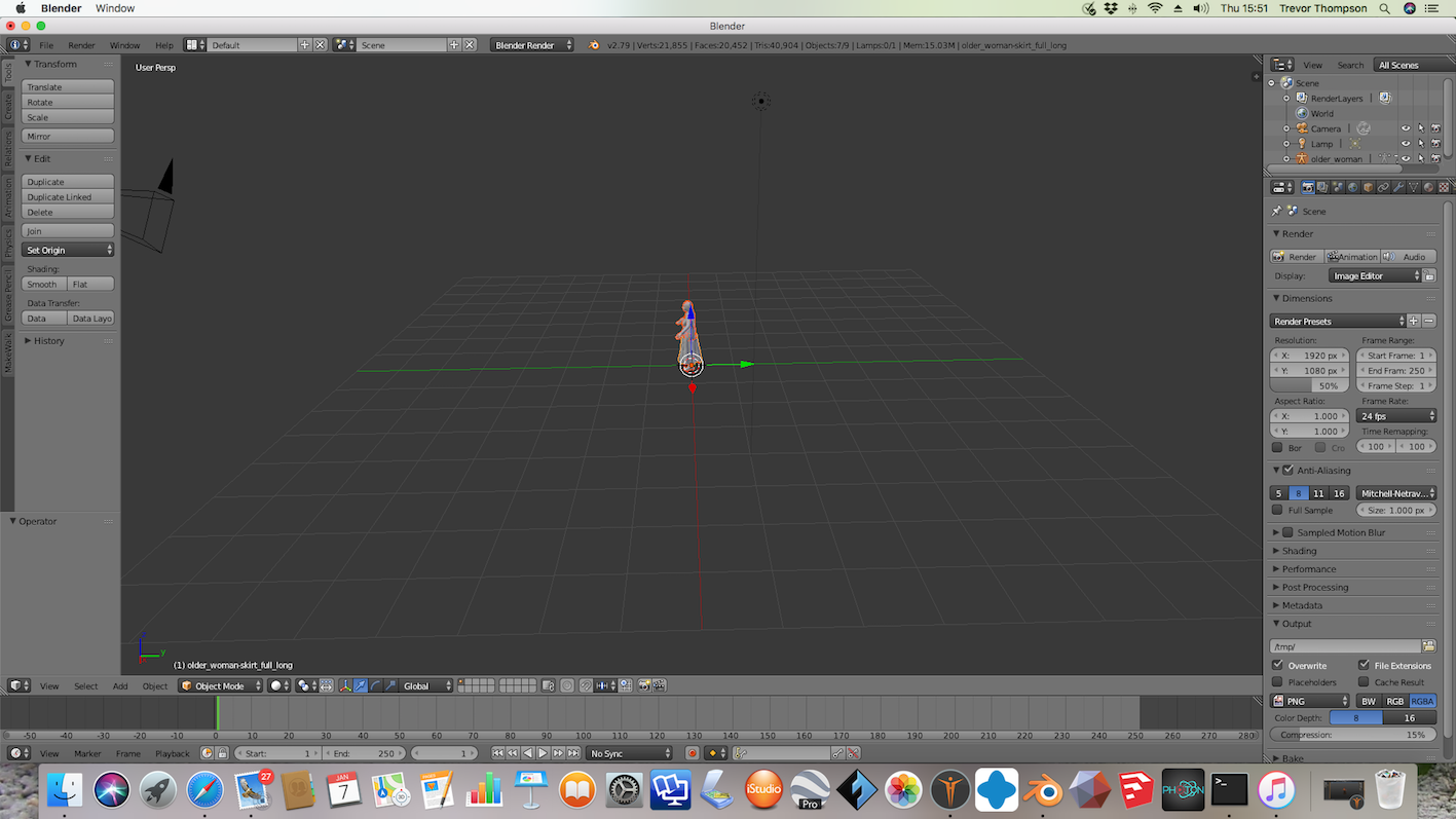

Installing Blender. Search for Blender using your favourite search engine as normal. You will find the download for your operating system, and instructions for installing it. So far so good.
I mentioned earlier that iMac users have to use an earlier version of Makehuman. When you export and import files as described it doesn't matter that iMac users have the latest version of Blender. However if you ever get to "make clothes" you will need to get the earlier version of Blender to go with the earlier version of Makehuman. The "Make clothes" function for "Makehuman" is an extension added into "blender" - and for that to work the versions need to be compatible.
So Blender.
When you open Blender on an iMac it looks lay this. Note that this is the earlier version of blender because I work on an iMac, and the later version is of course slightly different.
Screen Shot 2021-01-07 at 15.31.17.png (445.73 KiB) Viewed 75847 times

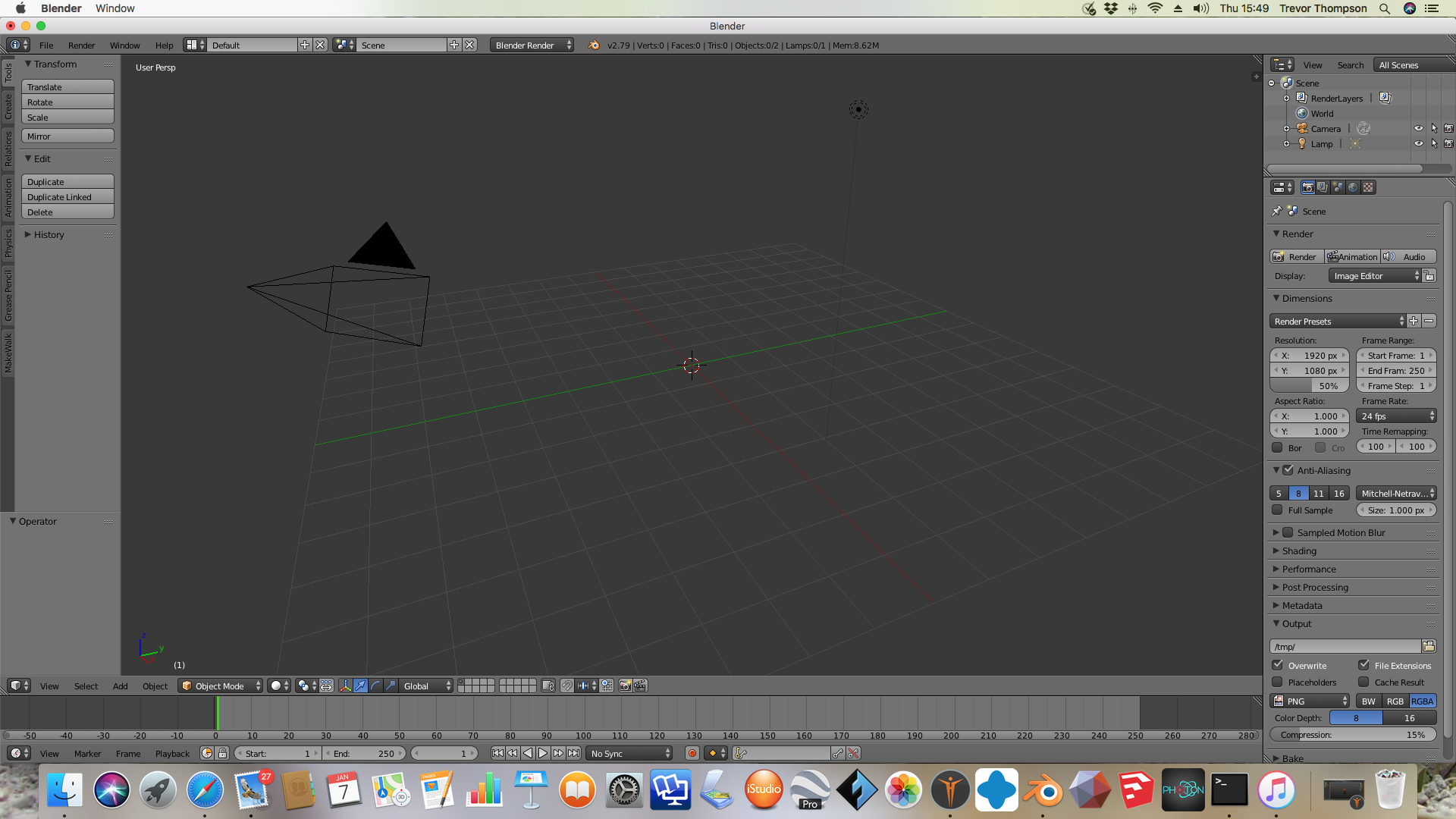

From the last screen right clicking gets rid of that message. Now you are presented with a box sitting at the origin:
Screen Shot 2021-01-07 at 15.49.30.png (400.55 KiB) Viewed 75845 times

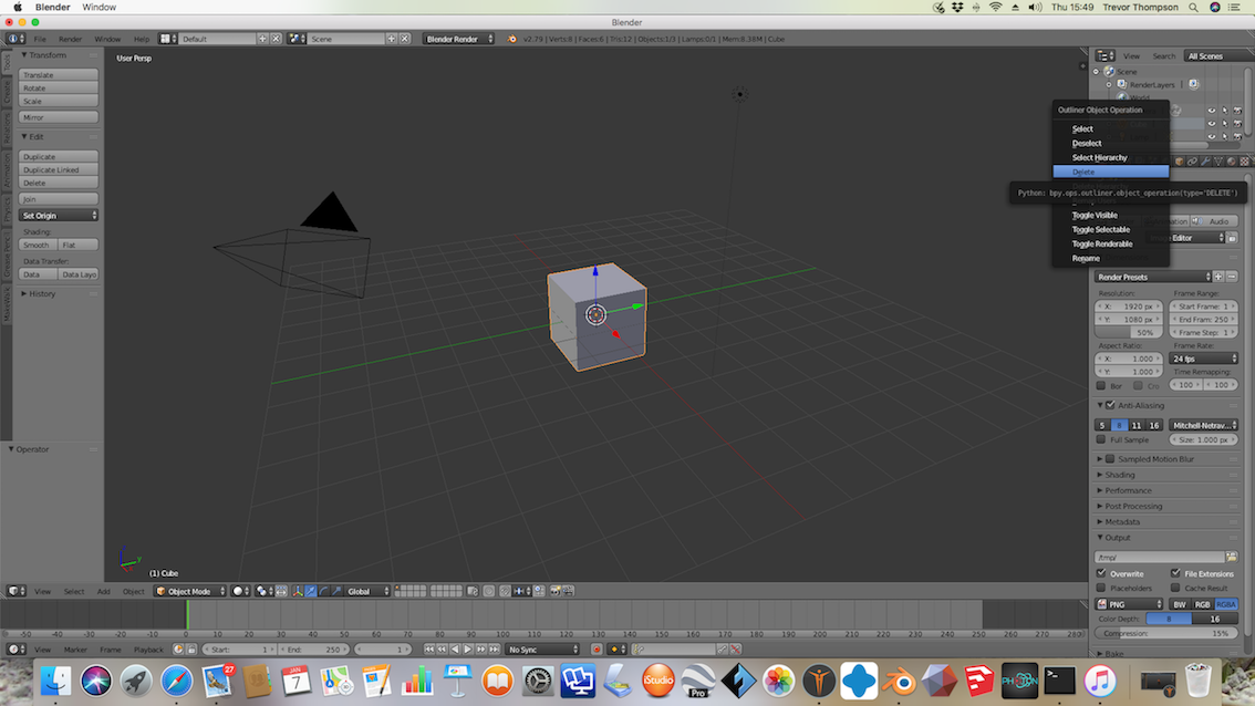

we need to get rid of the box. So up on the top right hand side is a menu showing a list. In the list is the word "CUBE". Make sure it is highlighted in white - or if it isn't click on it to make it highlighted. When you right click over the word cube you should get a pop up menu and half way down is the delete. So having deleted the cube:
Screen Shot 2021-01-07 at 15.49.38.png (474.31 KiB) Viewed 75845 times
Now to import the file from makehuman. On the top left is the word "file". Click on it and "import"and "collada":
Screen Shot 2021-01-07 at 15.49.52.png (463.55 KiB) Viewed 75845 times
Now choose the file. Ensure that one of the boxes at the bottom left is ticked. Under "armature options" - I ensure "auto connect" is ticked. Others may work as well its just what I have done which has worked!
Screen Shot 2021-01-07 at 15.50.23.png (360.63 KiB) Viewed 75845 times
The end result of this should be the figure I created in the centre of the screen:
Screen Shot 2021-01-07 at 15.51.02.png (451.21 KiB) Viewed 75845 times

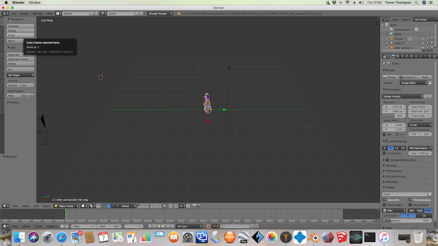

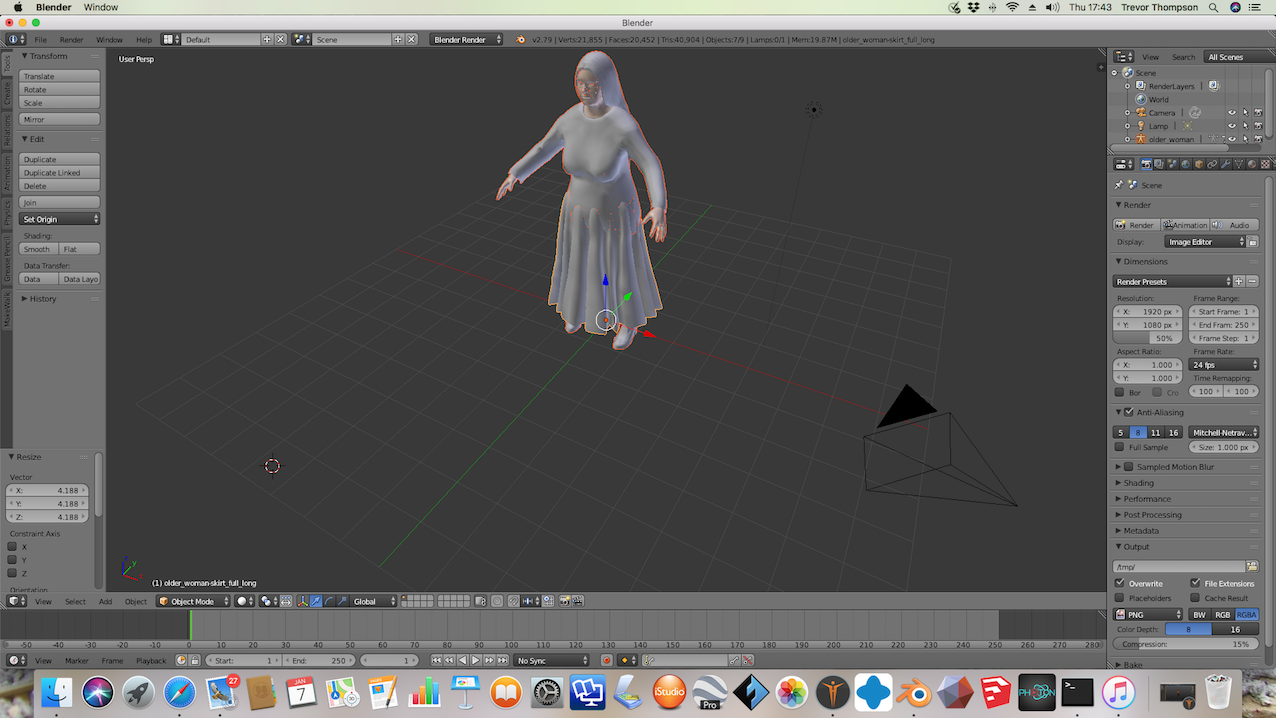

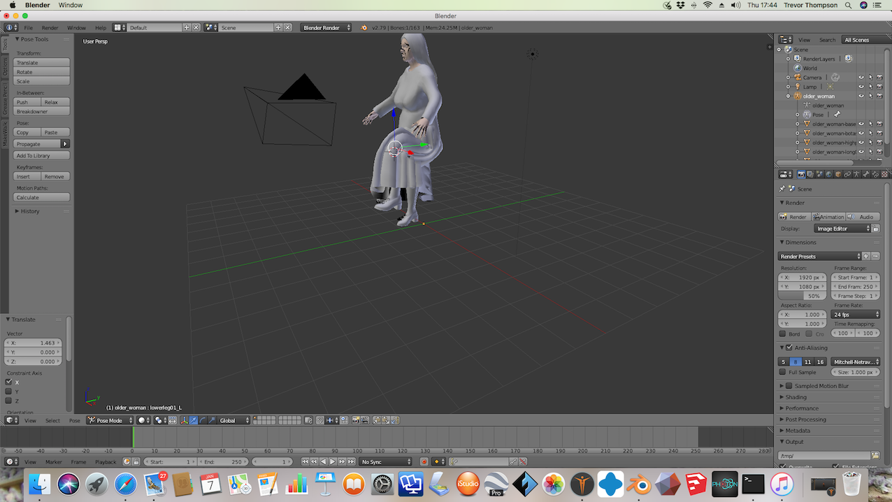

Now to manipulate that figure in Blender.
On the left of the screen you will see a number of file inserts - headings if you like running up and down the extremes left side. The top one is clicked in the next view and you can see the word scale which I have highlighted. Click in it ti engage scaling, and move the mouse to the left and the image will increase in size. ignore the arrow going all over the place just keep rolling it left until you can see the figure properly.:
Screen Shot 2021-01-07 at 17.42.47.png (504.05 KiB) Viewed 75838 times
the result:
Screen Shot 2021-01-07 at 17.43.23.png (497.66 KiB) Viewed 75838 times

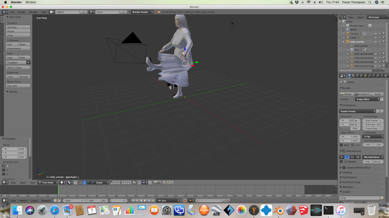

Now look on the top right of the screen There is a list which includes words like camera, and older woman. That is the file name by the way.click on the "+" sign to the left of the file name, and it will reveal the elements within the file. The work "pose" is what we want and you will see the symbol for a bone next to it. clock on pose to highlight it and then click on the bone next to it.
Screen Shot 2021-01-07 at 17.43.59.png (471.49 KiB) Viewed 75838 times

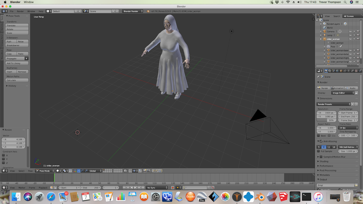

As an aside changing the view - rotating the figure - is important next. and it is achieved by using the mouse. Moving mouse scroll wheels seems to rotate the figure - well it does for me. You might have to experiment.
So you should now see a circle and a red green and blue arrow showing three dimension directions centred on the circle. Move the mouse arrow to rest over a joint - say the hip joint. Right click and hold on the red arrowhead and move the mouse - the result should be one leg moving to a sitting position:
Screen Shot 2021-01-07 at 17.44.41.png (479.19 KiB) Viewed 75838 times
Now right click on the knee joint and use the red arrow again:
Screen Shot 2021-01-07 at 17.44.54.png (474.13 KiB) Viewed 75838 times
Now its just a matter of moving the figure to see it from different sides and moving the different joints, for arms and legs. You can move the neck as well if you want the figure to be looking out of a coach window. Individual fingers can also be moved. You just need to experiment!
When you are satisfied use the file menu (top left) to get to export and then export the figure as an ".stl" file for the next steps. Better to modify the file name as well.

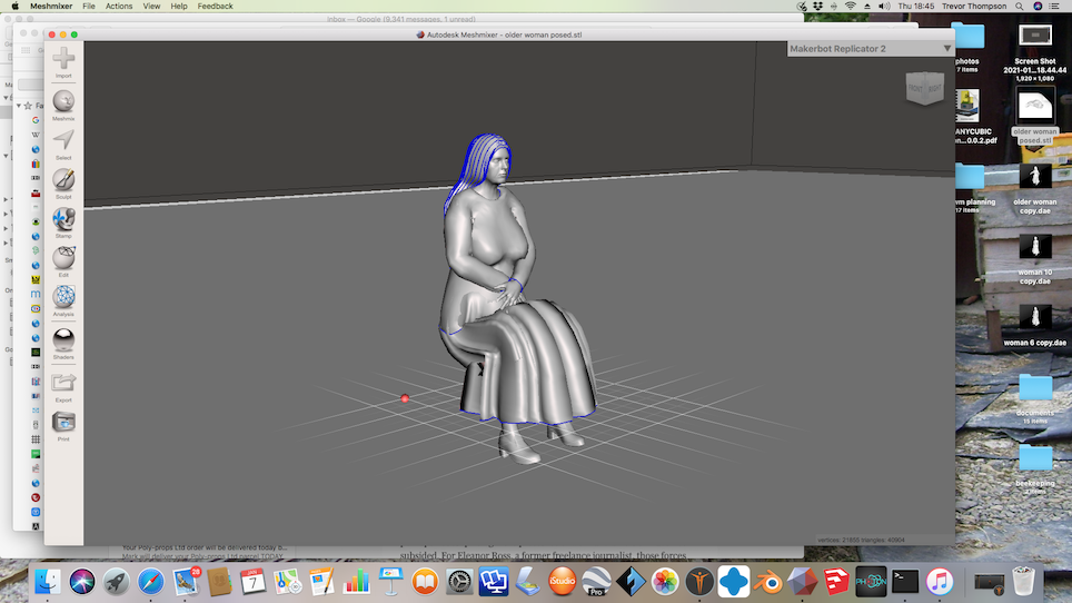

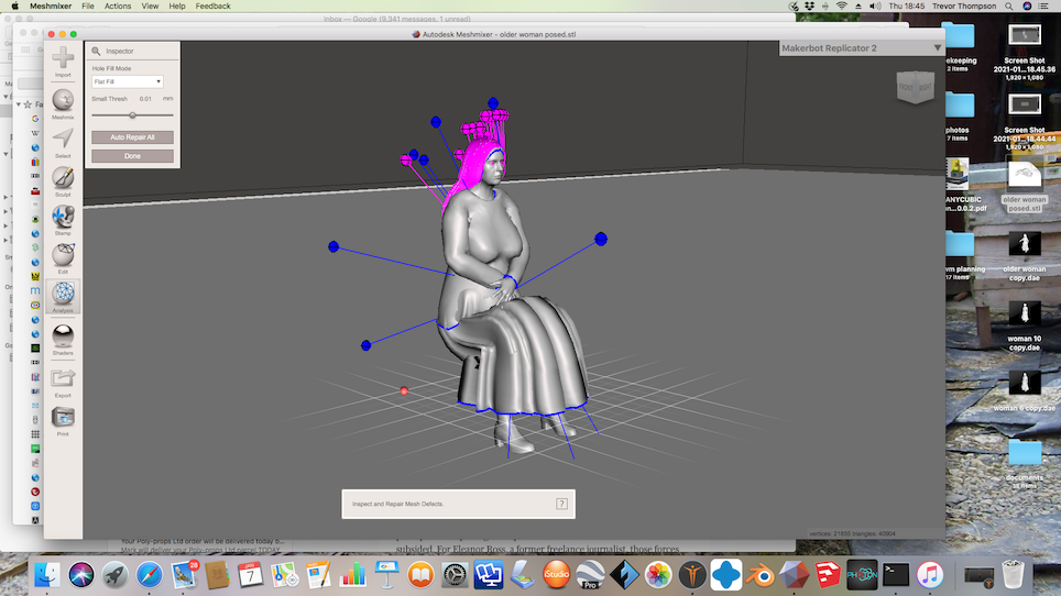

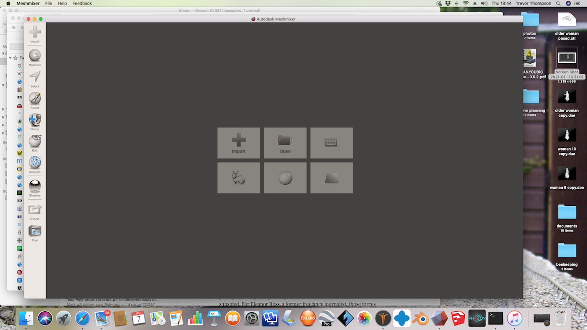

Meshmixer is another programme you will find by searching, and downloading it. Again its free.
So having opened it this is the screen"
Screen Shot 2021-01-07 at 18.44.44.png (406.44 KiB) Viewed 75834 times
import, and open the file you saved from blender:
Screen Shot 2021-01-07 at 18.45.36.png (396.98 KiB) Viewed 75834 times
Here is the figure I sat down. She is to be a passenger in a coach.
There are as far as I can work out two key tools for fixing figures here. Firstly under the heading on the left hand side "analysis" an option at the top of the menu which opens when you click "analysis" is "inspector". This generates a list of all the errors in the mesh. Magenta ones it can fix automatically. You can vary the size of the mesh with the slider. experiment. Fix automatically or click each individual magenta ball.
That is some errors fixed.
Screen Shot 2021-01-07 at 18.45.56.png (421.71 KiB) Viewed 75834 times
Now under edit there is an option "make solid"
Screen Shot 2021-01-07 at 18.46.38.png (414.78 KiB) Viewed 75834 times
This is the default repair which is carried out when you click on make solid. It can be rather crude as default, but it is adjustable. Move the different sliders. The top two moved to make the repairs smaller have a better effect - but the smaller you go the more processing time until eventually it sits there with a message "checking for errors" Effectively a crash! So experiment.
So here is a reasonable result:
Screen Shot 2021-01-07 at 18.48.08.png (411.05 KiB) Viewed 75834 times
When we started these repairs the file had a thin skirt, and if you looked up it the legs were represented only by the bones - and the boots were just hanging there. If I tried to print it the legs fell off. What I can't show you here is that the bottom of the skirt is now solid with boots sticking out. The model really is a solid object with a complete mesh surrounding it. It will print.
I can't give you definitive directions for getting the best out of these repairs - you will just have to try it. You may be able to tell me how to do it properly!

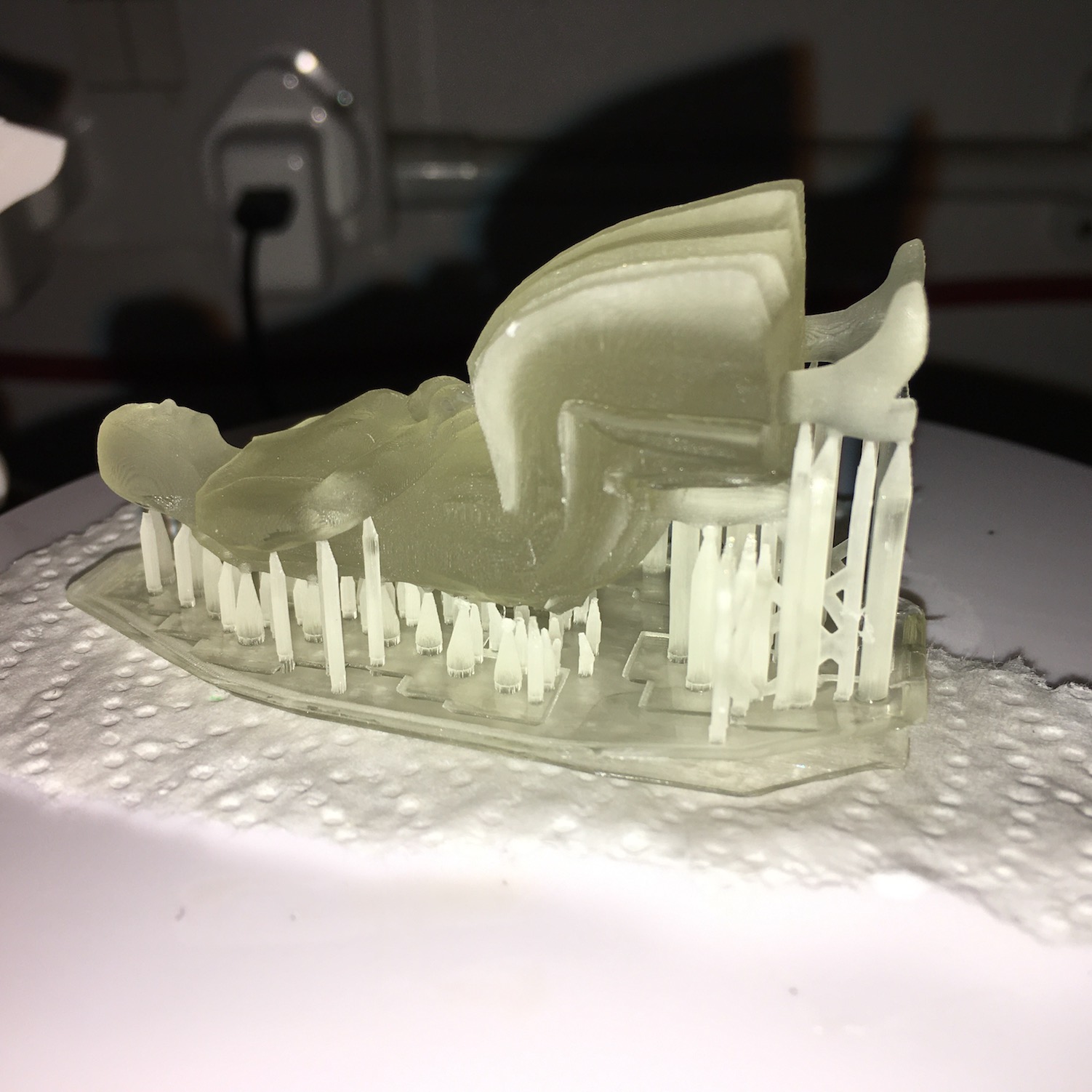

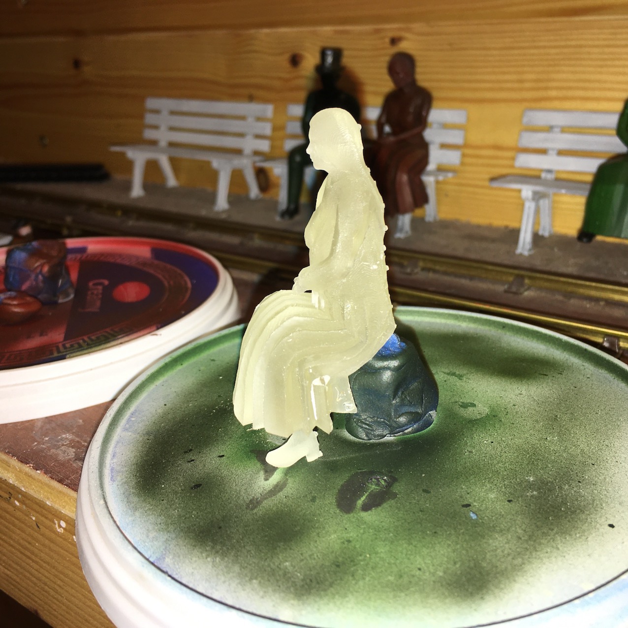

Re: Resin Printed individualised people
Posted: Mon Jan 11, 2021 8:43 pm
by Trevor Thompson

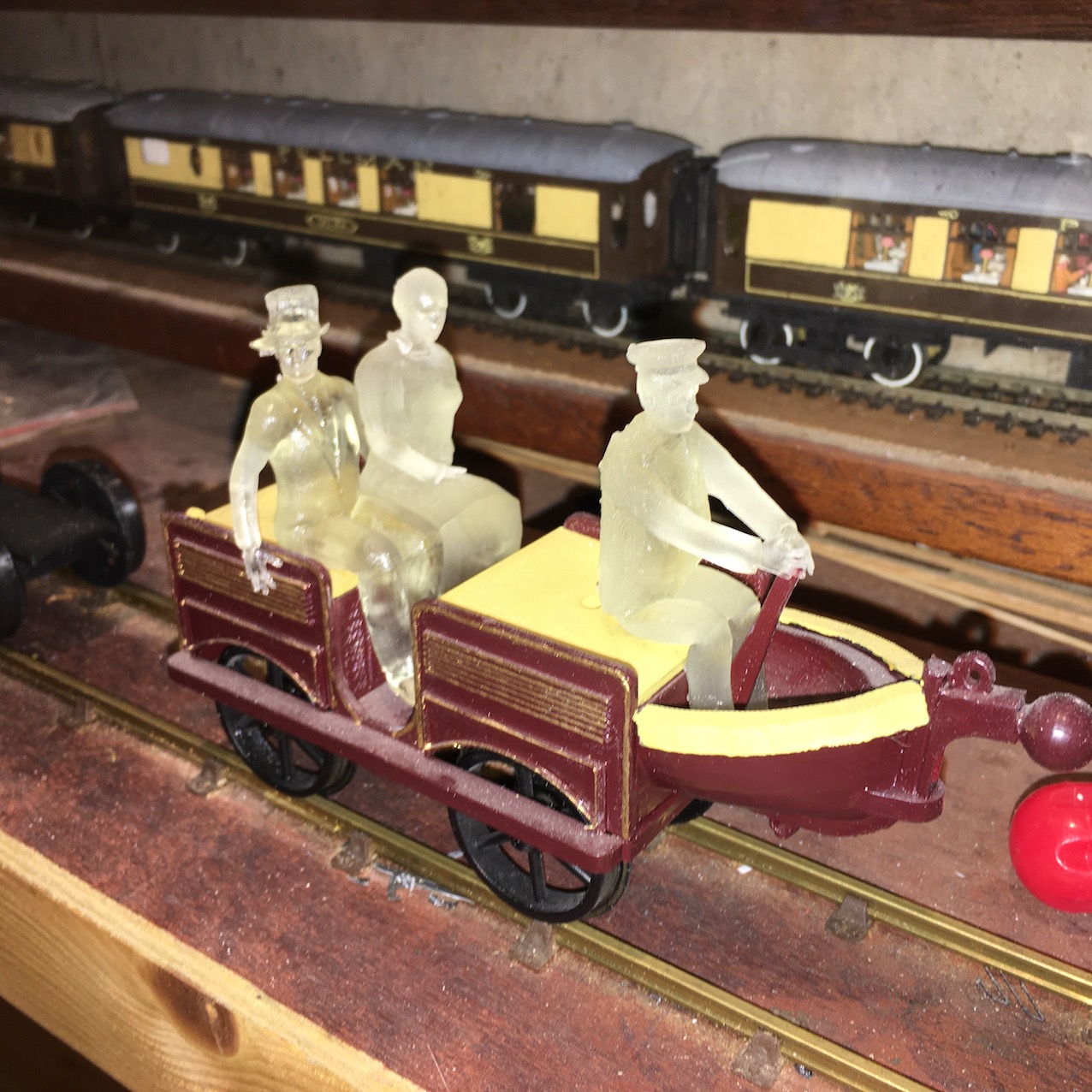

So the printed figure, as it came out of the printer:
and after removing the supports:
You can see the ends of the supports sticking out of her back. They have yet to be removed gently, probably with a sharp knife. Also I was a bit rough in removing my first attempt at this figure from the bed, and removing the supports for the feet took the feet with them. She isn't wasted really - sitting in a coach no-one will notice that she has no feet! I was more careful the second time.
So I am now making figures to fit into Spooners boat. More on that later.

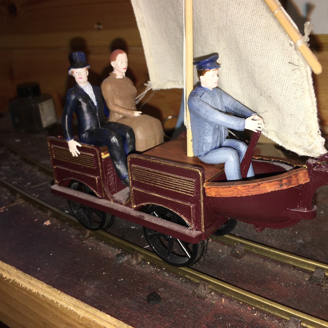

There is an illustration used in books to show what this was like which show a couple on the main thwart and a driver in the front holding the brake lever. I have tried to represent this with the figures I have made:
They actually fit into the boat correctly. They do need the final clean up of the supports, and painting.
So success.

Here is the end result:
I thing that will pass muster!
