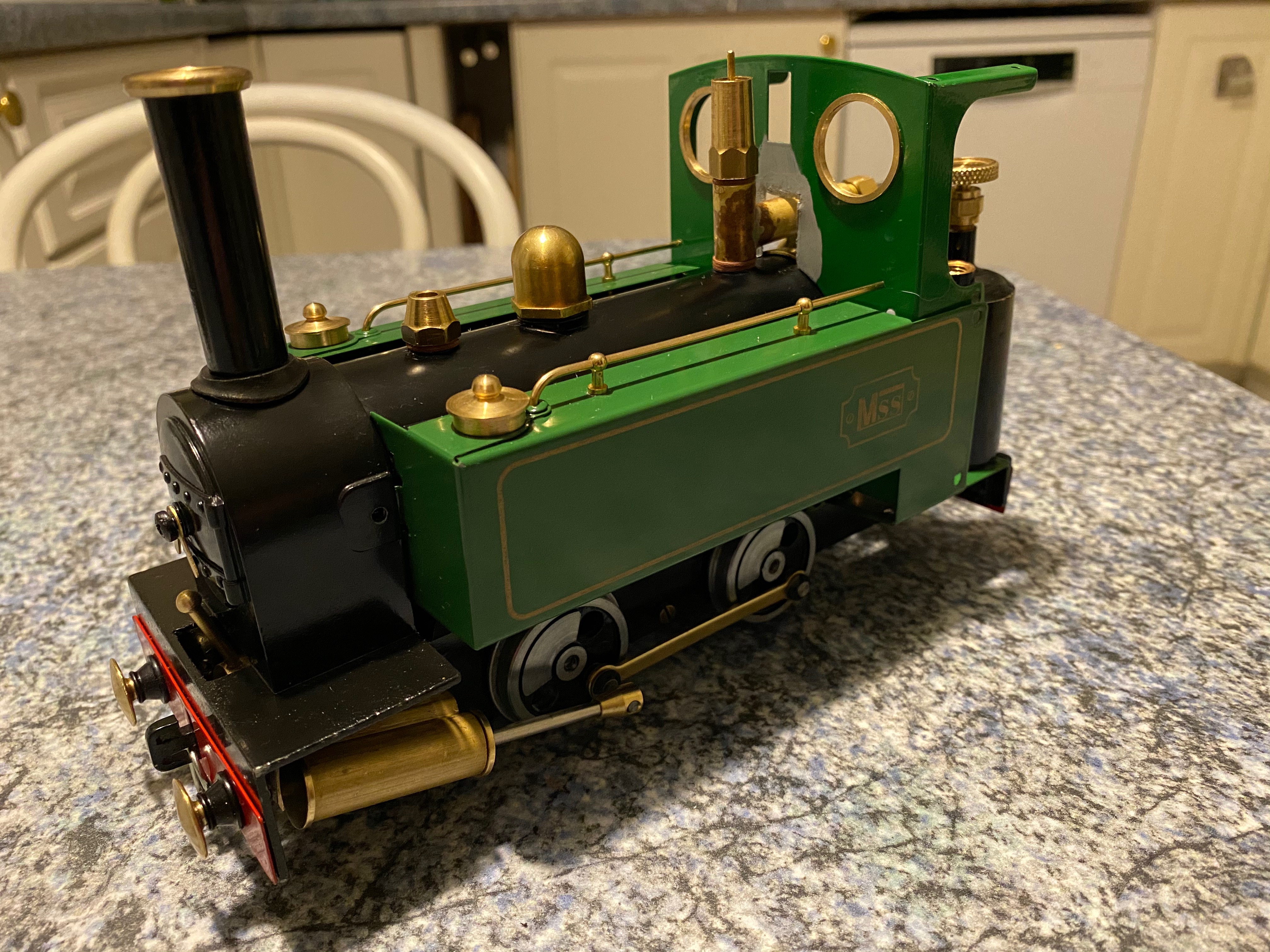

I built a kit MSS loco earlier this year and have recently fitted some upgrades including a RWM Steam regulator, displacement lubricator and ceramic gas burner.
It will plod around the track on it's own but fails to pull anything of note. I was hoping that the gas burner, regulator and lubricator would improve things but it's not much better than when it ran on solid fuel. Am I expecting too much? Last night i whipped out the reverser block and can't see much gunk indicating a blockage. You can see in these YouTube videos that it's quite happy expelling steam via the exhaust!
https://youtu.be/60SJXn5my14
https://youtu.be/tUL5RjAVIH4
Does anyone have any advice on how to diagnose it's lack of pulling power further?
Thanks,
George

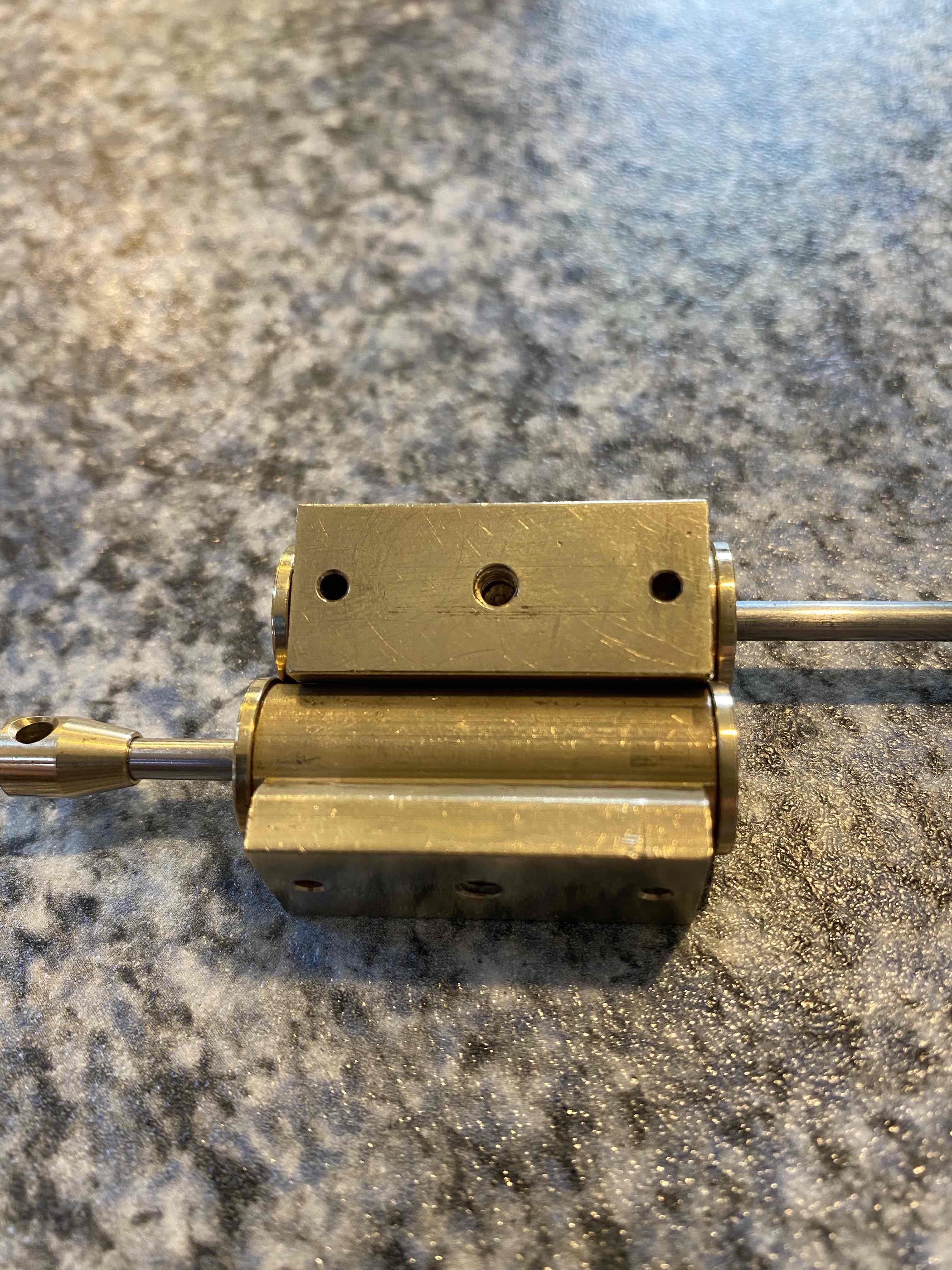

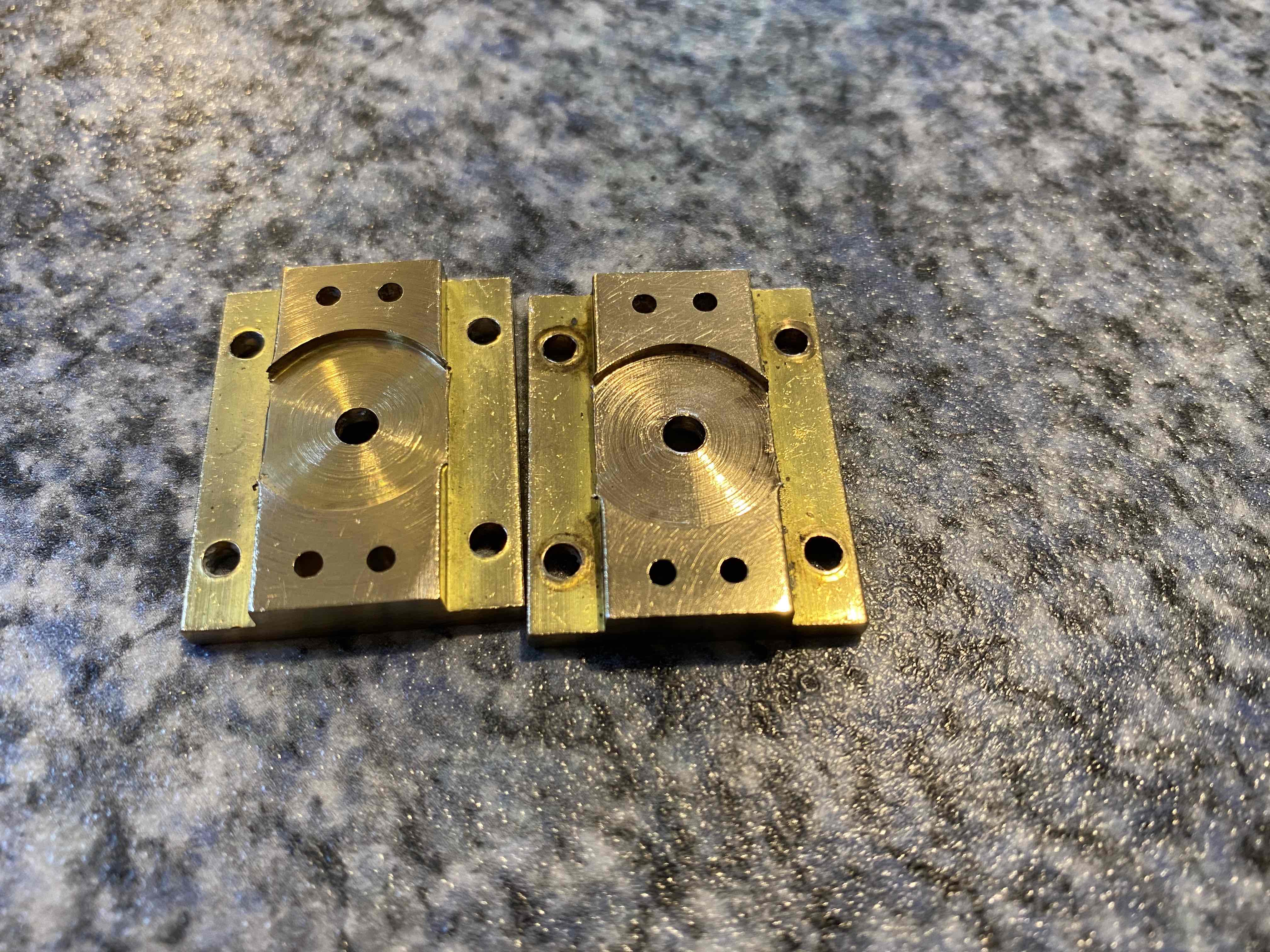

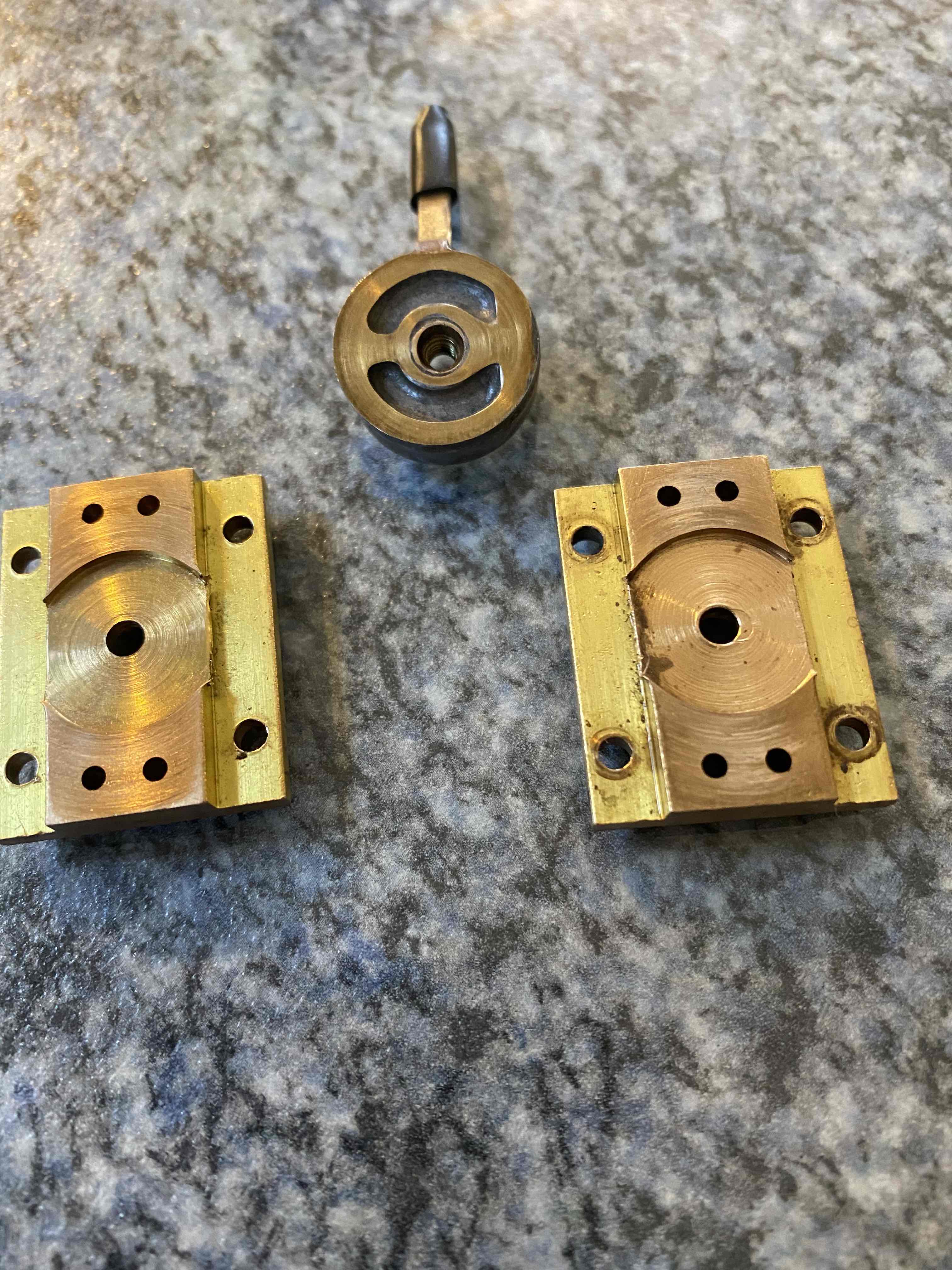

I received some autosol and a sheet of glass in the post in the last couple of days so thought I'd take a look at lapping.
Before:
After initial attempt:
The port faces are quite pitted on the rear side. I'm not sure how smooth I need to go? Am I aiming for a smooth mirror like finish?
I have an older Mamod loco I'm also working on - I noticed the reverser block has the ports widened:
Is this something worth doing to my MSS reverser block?
Before:
- -steves-
- Posts: 2473
Re: Upgraded MSS loco - expecting too much?
They look loads better, much shinier and flatter, of course less likely to leak
I wouldn't worry too much about the port sizes, I have never bothered to open the ports out as it can change the "timing" so always left it alone.

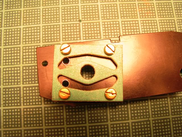

After several steam tests later I feel like I'm back to square one! It still fails to pull anything and it's quite erratic in terms of control. I've stripped it down again today and noticed a few things.
Firstly, on the reversing block - is there a trick to help line up the block with the rotating part? I've tried a few times and it seems to have both the inlet & exhaust fully open would require an unobtainable position in terms of rotation and the frame.
Comparing my new MSS reverser block to an old Mamod one, it seem the straight ends of the channels are on different sides? This seems strange. Mamod on the left, MSS on the right.
I've also been looking at the seals between block & frame. It seems the frame and block don't line up very well. How much of a problem could this be? Short of ordering a RWM reverser block - any further advice welcome!

- Chris Cairns
- Posts: 2372
- Location: Glasgow, Scotland
Whilst considering my reply I found my original photos so have re-instated the missing images in my MSS Kit Build topic here - https://gardenrails.org/forum/viewtopic.php?f=44&t=6201
If you have not already found them, this library contains many useful files - www.hglw.co.uk/mamod.html I recommend starting with the top one - Mamod Handbook.
That Handbook recommends drilling out the chassis side frame steam holes to 1/8" or 3mm. Having done that make sure that the cylinder gasket is not covering part of those holes - use a circular file to open out as necessary.
I've drilled out the steam holes here, and the gasket needs a little fettling to clear those holes.
The gasket forms the steam path for the two cylinder ports so make sure the holes are not blocked on the rear of the cylinder backplate.
You can chamfer out the steam holes on the reverser block. On your Mamod one above they've chamfered out the mounting holes as well which will likely cause a steam leak.
Does your upgraded safety valve lift whilst under gas firing? Without a pressure gauge the only way of knowing what pressure you have is when the safety valve lifts (I assume that is a Dream Steam 20 - 25 psi valve). The safety valve is not lifting in either video so your pressure may be a bit low for running in?
Is your chassis free running? If you lift the pistons off the crank pins & fully retract them & rotate the cylinders out of the way you should be able to push the loco to see how far it will travel/free run. Sometimes the mount on the gas burner is too wide which then affects the wheels.
You are correct. The cutout plate on your MSS reverser has been mounted back to front. You could try temporarily fitting the correct fitted one from your Mamod to see if that makes any difference.
Chris Cairns

Since my last post I gave in and ordered a couple of RWM reverser blocks which arrived this morning. They come with some gasket material on the sides and are obviously are made to a far superior quality. I'm going to fit these over the weekend and see how I get on.
I think the regulator might be leaking steam, I'm going to take it off the boiler and wrap a bit of plumbers mate on some of the threads.Does your upgraded safety valve lift whilst under gas firing? Without a pressure gauge the only way of knowing what pressure you have is when the safety valve lifts (I assume that is a Dream Steam 20 - 25 psi valve). The safety valve is not lifting in either video so your pressure may be a bit low for running in?
No issues free running, without the pistons attached it will roll across the table quite happily.Is your chassis free running? If you lift the pistons off the crank pins & fully retract them & rotate the cylinders out of the way you should be able to push the loco to see how far it will travel/free run. Sometimes the mount on the gas burner is too wide which then affects the wheels.

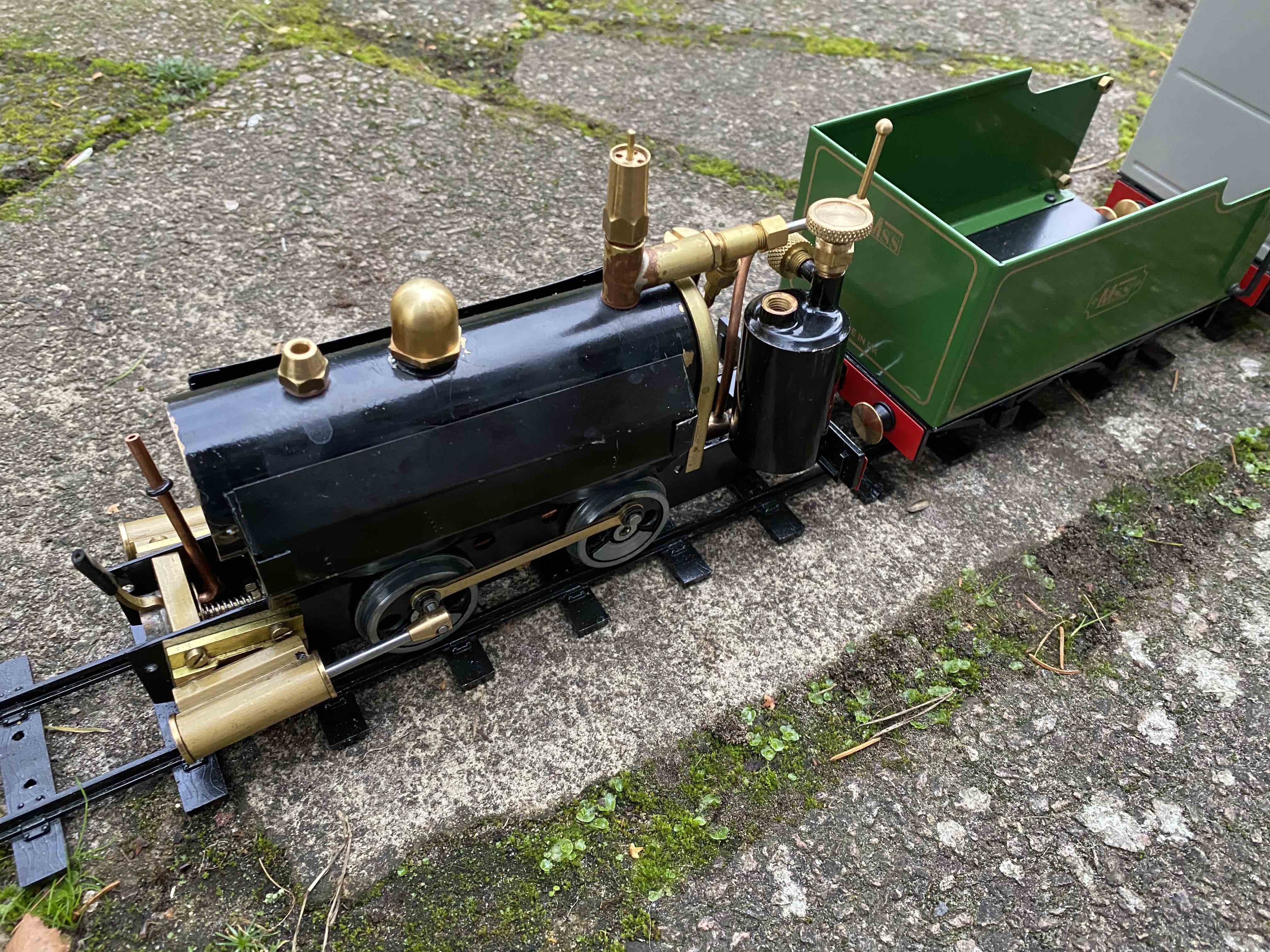

I put the body + chimney stack back on to help stop the boiler wobbling while testing. Please ignore the shoddy slot cut + priming for the regulator!
Testing went well, I'm hoping with a bit more running in the performance will keep improving.
Still doesn't have much pulling power but it feels like the performance is a bit more stable on the track at least.

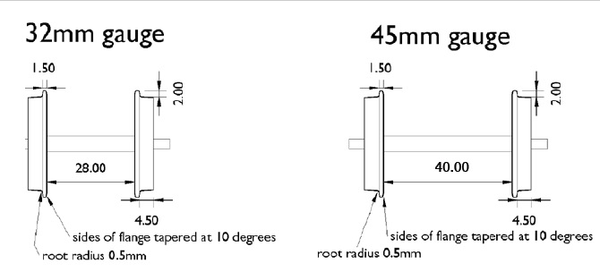

As soon as I lifted it off the the rolling road the wheels started spinning. I'd assumed this was because there wasn't enough power to push it's own weight but it could be an issue with the wheels I guess! I had thought about the wheels but I couldn't tell the lack of movement was the steam coming out of the pistons or the wheels.Superbiker_uk wrote: Fri Jan 01, 2021 3:37 pm On the last video posted showing the steam coming from the front of the cylinder, does it run when lifted off the rolling road? Were the wheels binding on the rolling road? Just wondering as I've experienced issues with the wheel gauge and profile of some MSS wheel sets. Obviously has nothing to do with the steam leak but it's surprising how much 'power' is sapped from a Mamod when the wheels are not correctly profiled, gauged and true on the axles.
Is there a way I can check the wheels?
- Chris Cairns
- Posts: 2372
Best tool is a set of callipers.georgesheppard wrote:Is there a way I can check the wheels?
A fellow member of our 16mm NGM Group was running an MSS which was struggling at the same points on the layout. A collective cry from the members - check your Back to Back (B2B). These came out at 28.5mm (the maximum dimension for the 0.5mm tolerance), however we spotted that the wheels had rather thick flanges. Thus these wheels were actually over gauge (greater than 32mm) when measured across the outside of the flanges. The member machined the flanges down in his lathe & the loco has run great since.
These are the wheel standards recommended by the Association of 16mm Narrow Gauge Modellers. The MSS wheels are made using blank mazak wheel castings which get a machined plain 90 degree flange, and certainly at some point in their manufacture the flanges were much thicker than the recommended 1.5mm.
