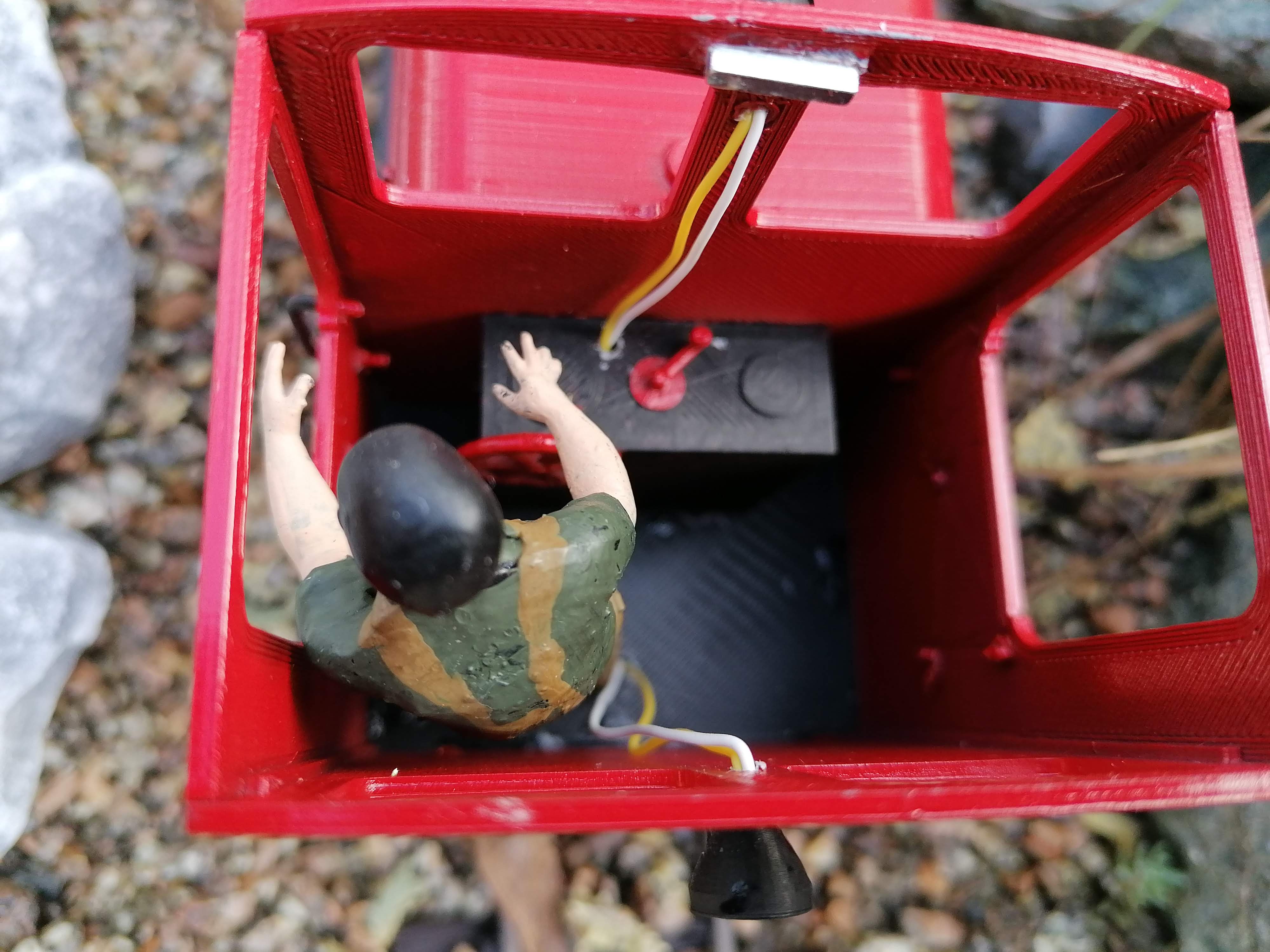

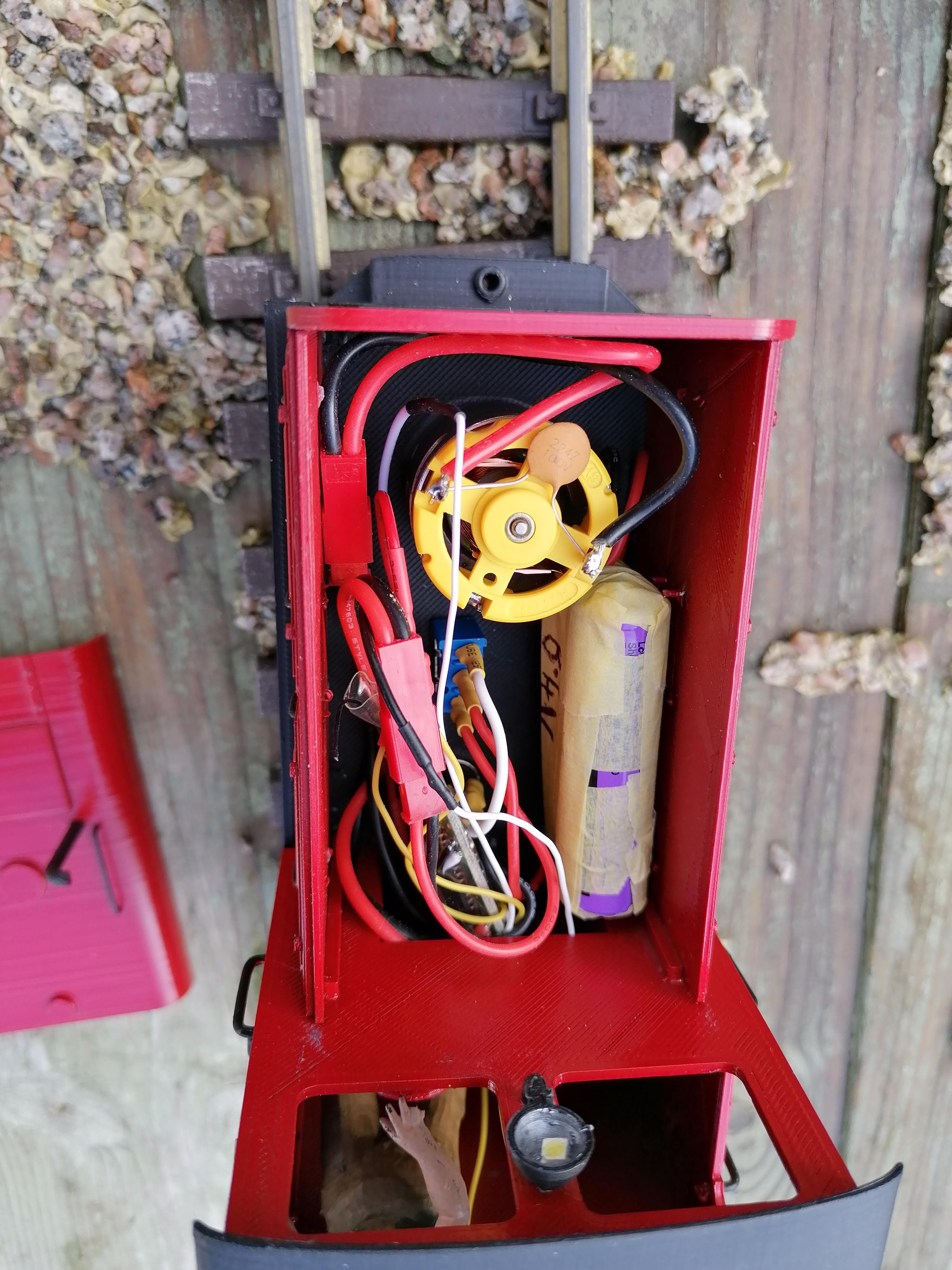

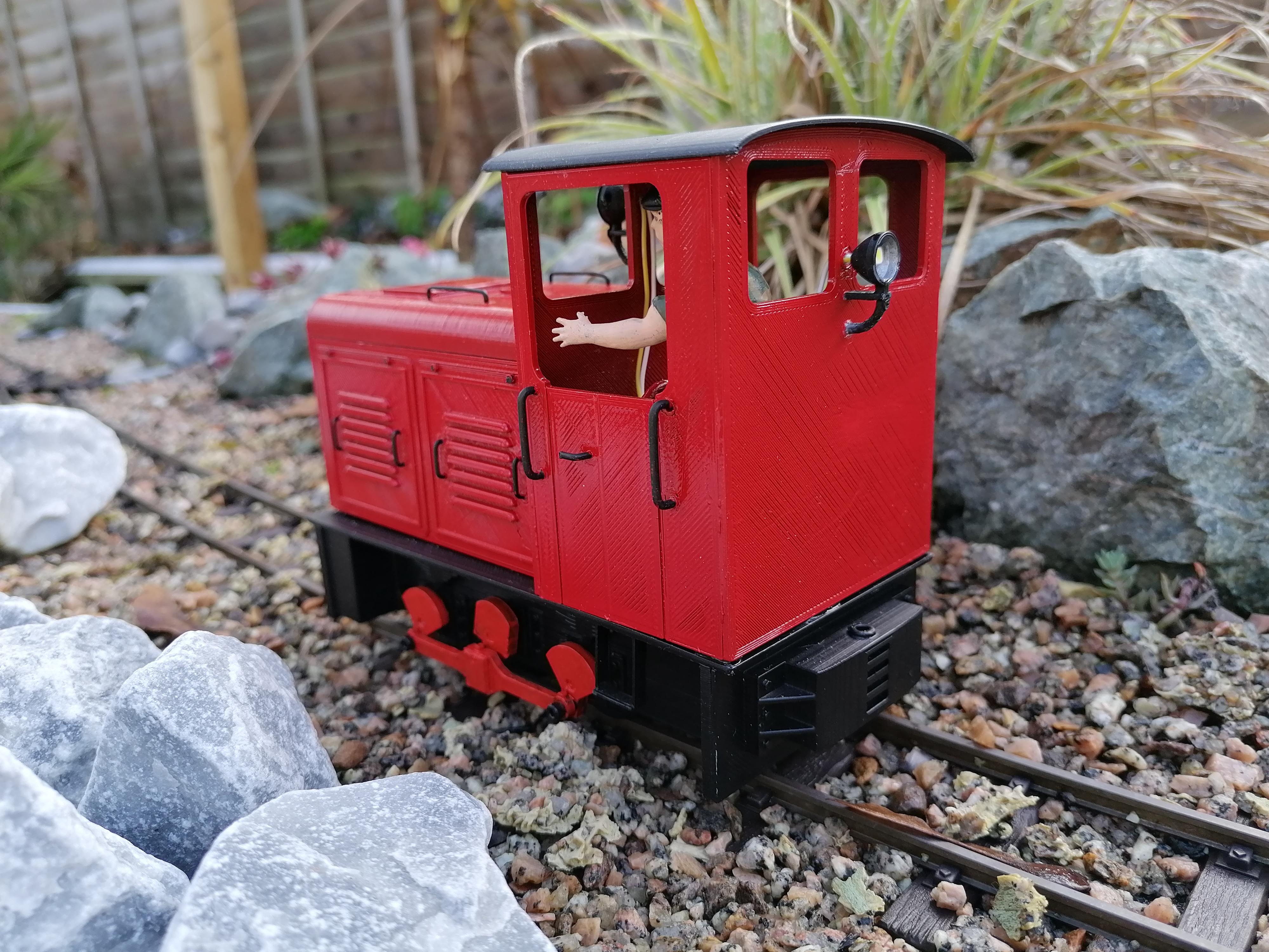

Recently I have been working on the CAD work to produce myself an LKM NS2f. Well with all the parts complete, the kit put together, painted and made into RC, I had the opportunity to grab a few pictures of it. Almost everything is 3D printed by me, the driver, wheels, cranks, con rods, body, cab, lights etc. The axles are 3mm Stainless Steel with brass bushings with the axles milled at each end to give an easy quartering setup. LED's came from a ring of LED lights, gears, no idea, just some I had laying around, I actually wish I knew where to get these so if you know, please share :) Deltang RC and an MFA 5 pole motor.
I am aware the electrics are untidy at the moment and absolutely zero work was done to the 3D prints, they were printed and sprayed, hence so many lines.

That looks great, a bit of a change of direction, from your metal chassis/bodies.

That is a nice looking loco. Quite interested in the jackshaft and cranks, did you end up with any tight spots that needed attention or did everything just fit right off the printer? I've not attempted a loco with con rods, but looking at this I think I am inspired to incorporate con rods on the next one.

The con rods were a little tight in places, but a small fettle with a 2mm drill bit soon sorted that out. The quartering method is built into the axles and the cranks, it worked very well indeed and I had no idea if it would work, hence not posting anything about it until it was finished and I was confident it worked as expected. :thumbup:

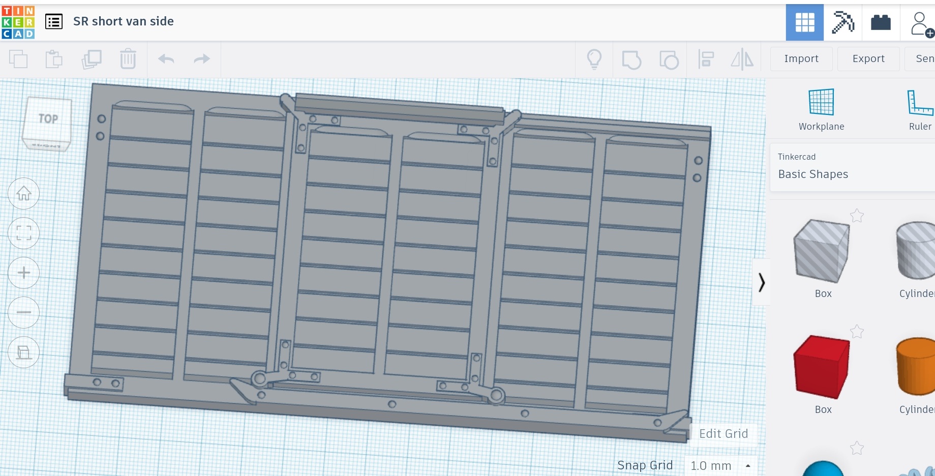

Hi Rik. Glad you eventually got to view the pictures. I used Tinkercad for all the CAD work, takes some doing and is quite restrictive, but very very easy to use compared to any of the proper CAD programs. :D

Yay! Three cheers for TinkerCAD
Here's my latest TinkerCAD tinkering.
A Southwold Railway early closed van.
Like most of my modelling, the detailing is representative rather than perfect scaling, but I know it will print without the need for further tweaking.

That is some detailing for Tinkercad, wow, I am impressed!
