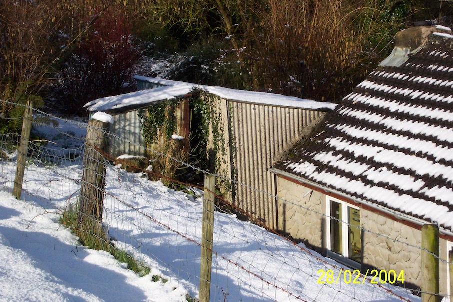

Originally it looked like this, the railway will eventually find a home on the other side of the barbed wire fence behind the cottage.

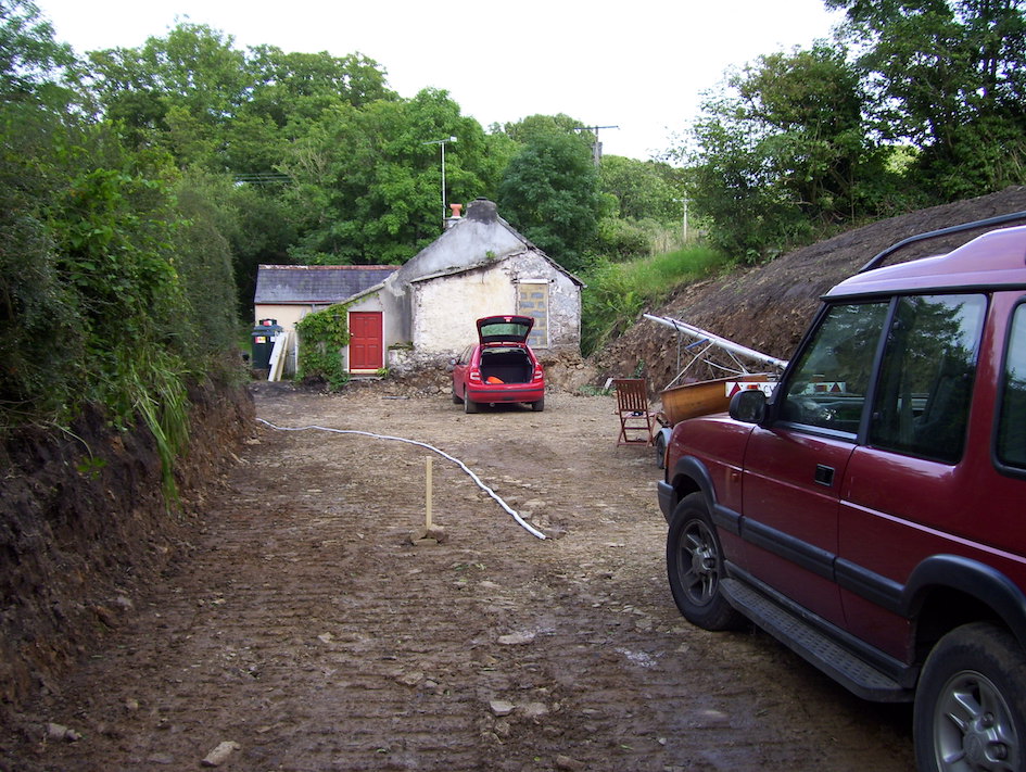

So let me take you back to 2007, when we extended the cottage and had a garage or perhaps it should be boat house inserted into the garden.
400 tons were dug out here and the bit you are interested in is that earth bank behind the discovery, leading behind the cottage.

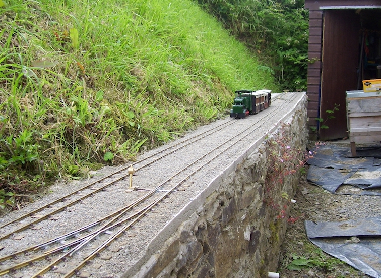

So it started out as a test track, a length of single line, with a run round loop at one end and a passing place at the other. Effectively allowing a locomotive to run to one end, run around its train, travel to the other end and repeat the operation.

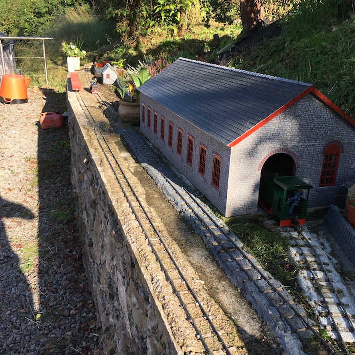

Fast forward a few years and you can see the result:
This end of the line has a model of the engineering workshop on the Corris railway, and a station building also based on a Corris prototype. For the other end which will I suppose develop into the "Terminus" there is a station building half built, and a signal box. However that end is still quite unfinished.

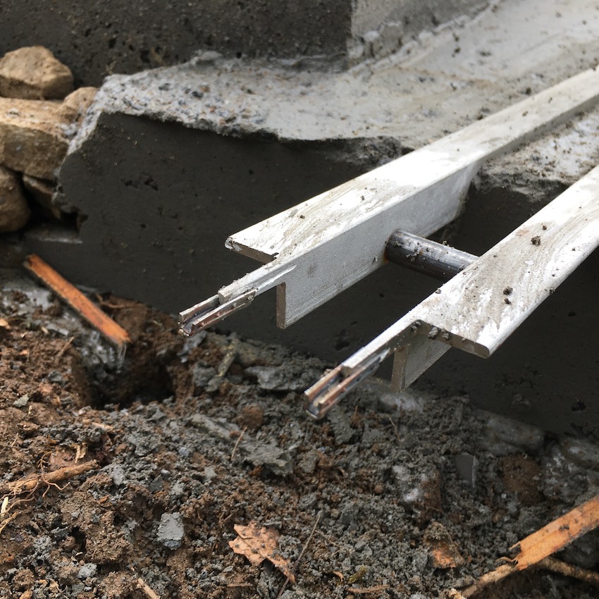

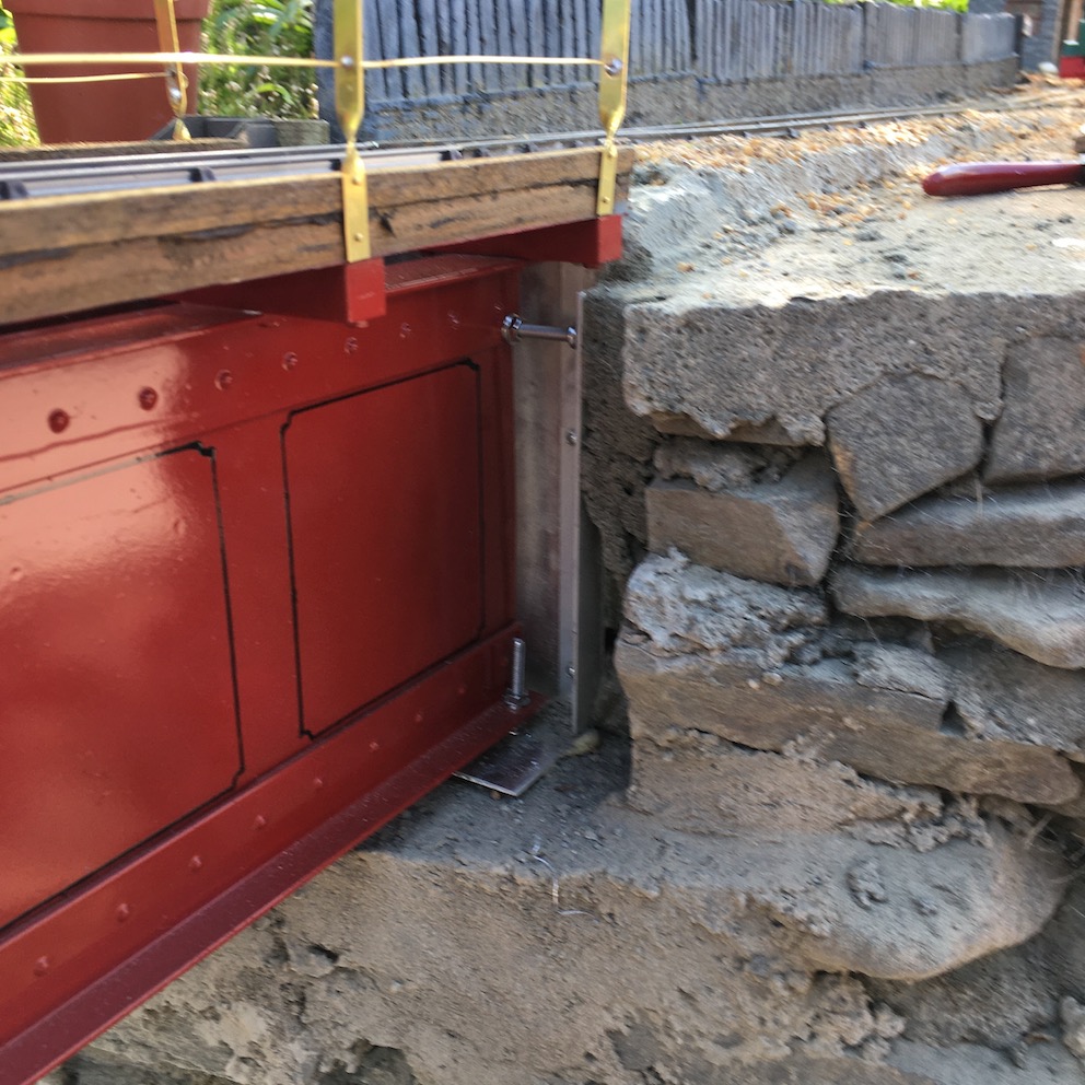

The bridge just lifts out. It is out most of the time because it crosses the main access into the garden. To ensure that the track always aligns properly:
The stonework at each end has a cut out with an aluminium socket inserted into it. Fixed in place. Each end of the bridge has bolts "sticking out" so that they engage with the aluminium sockets. One end has 4 bolts and the other 3. So far it has always engaged accurately.

That's a great workshop building. I think most of us start with small ideas that somehow mushroom. Yours is looking great. Looking forward to the extension.
That's a ingenious solution to the lifting bridge alignment problem.

That bridge looks beautifully engineered

ge_rik wrote: Mon Oct 05, 2020 8:44 am That bridge looks beautifully engineered
Thanks for the positive comments! AND it isn't 3D printed!

I do like how you have engineered the height and width adjustments, simple but effective. 🚂

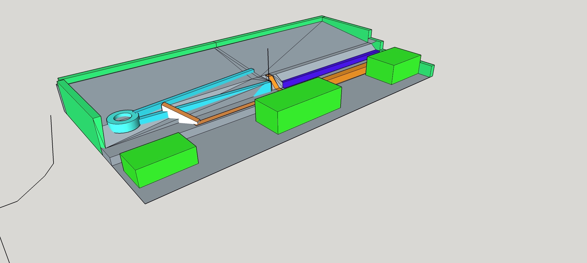

Just to give some background and context I have produced a sketch of the site:
As you can see the cottage, which is the central green box, is built into the side of a hill - like many welsh cottages. The orange block on the right hand side behind the buildings is the path on the top of the retaining wall you have already seen. The dark blue block is the existing railway. You can also see that the orange block crosses to the left of the railway and up into the garden. That is where the bridge crosses the path, joining the dark blue to the light blue.
So the extension is shown in light blue. Follow the light blue block from the bridge and you will see it crosses another orange block - another path. That is the first extension which i will show you in a minute. The rest of the light blue which continues to the left, loops around and then crosses the path again to end in the centre of the garden higher up. That is the other important factor.
The first section is level, and the extensions are all rising at a constant slope of 1 in 60. Gravity trains? I am particularly interested in modelling Welsh Slate railways. Festiniog in particular. You may already have guessed that I am focussed on making models of real things. I want a prototype. That applies to the rolling stock and the railway. So this railway has elements of Corris and Festiniog railways within it.

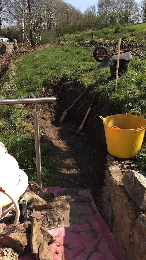

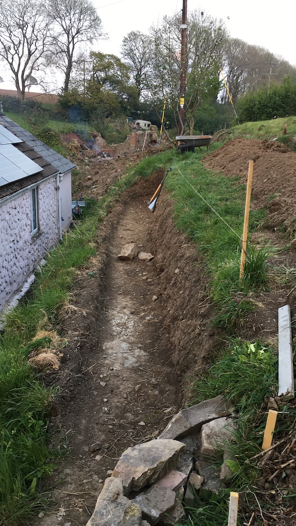

When we were all locked down I started digging out the bank by hand. I had already built a short section of wall to take the end of the bridge. It seemed like a "good idea".
It was hard work, requiring a pick to break up the bank, which is 75% rock, and 25% soil. Most of that rock will appear shortly!

As the days rolled on I kept working at it, clearing about 2/3 cu metre per day:
The railway is going on the green bit above the path!

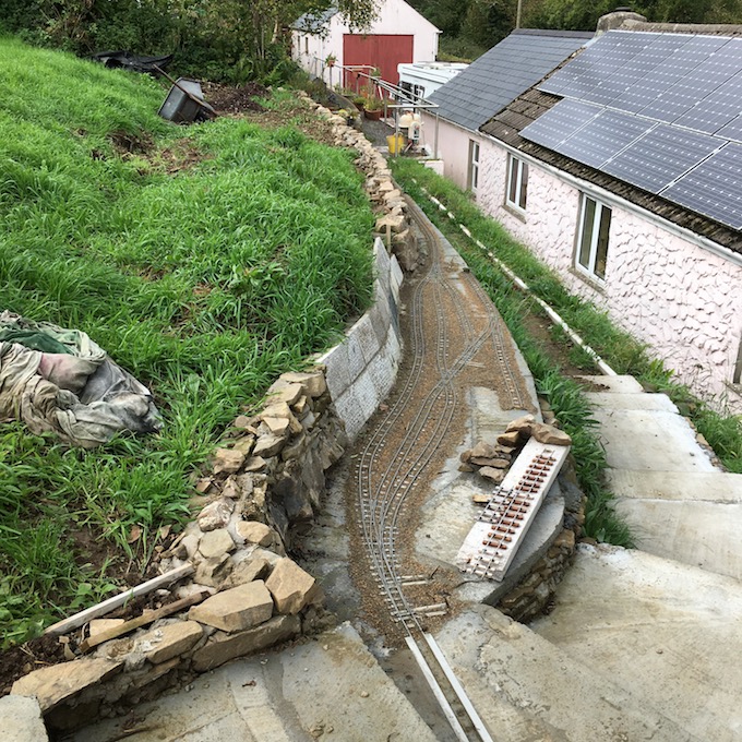

You can see the beginnings of a retaining wall behind the railway. One of the advantages of doing all of this groundwork is that I will have converted a steep bank into terraces. No more risk of slipping off with a strimmer!

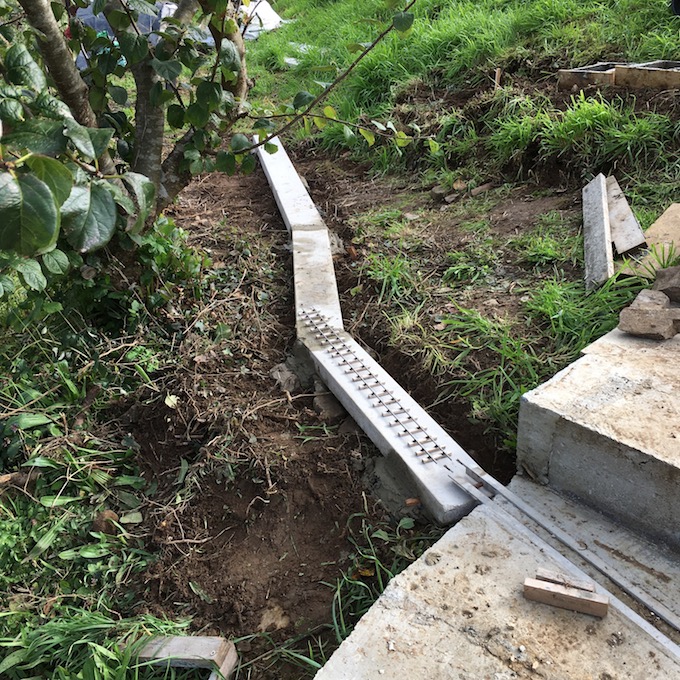

At the end of the section I made a set of steps turning up into the garden. So there will be another way into the garden when the bridge is in place. You can see the curved track bed which has widened out to accommodate a station, and how it crosses the new steps on the level, before curving past the apple tree.
The steps have lengths of stainless angle let into them to form track. They are held apart by stainless bolts. The ends are filed and sawn down to the same section as the rail - and they join onto the real track with standard fishplates. It isn't obvious but they are concreted into the steps so you can walk on them.

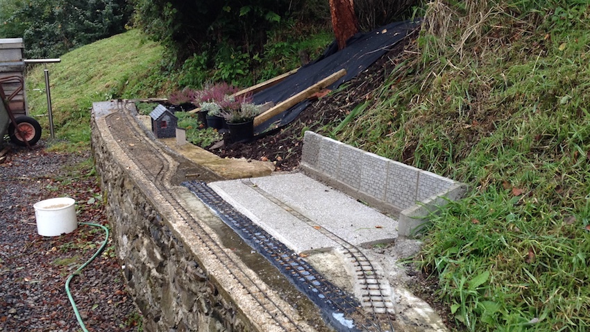

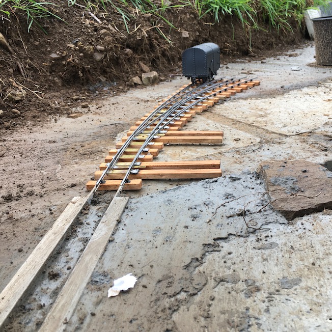

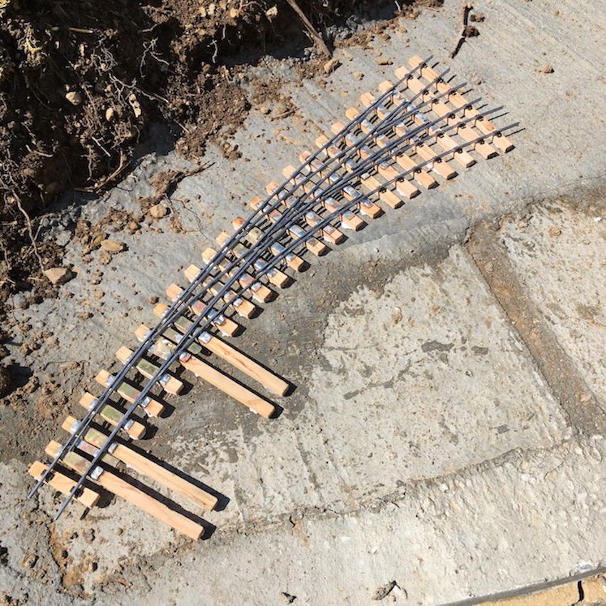

Continuing with some details of my track over the path:
here you can see the stainless embedded roughly. The three way point is also shown.
and a detail of the connection to proper track:
While I am the first to admit that narrow gauge railways didn't invest in complex pointwork, I wanted to keep this station as long as possible in the minimum space. So three way points seemed acceptable to me! A hand built straight 3 way point:
and the same on the curve:

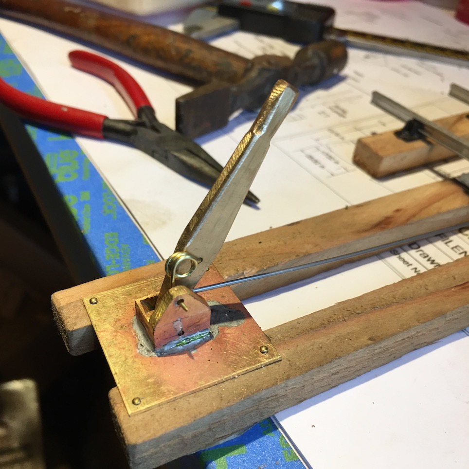

Finally my latest type of ground frame, which incorporates an over centre spring to try to provide positive but light pressure to hold the point closed in either direction:

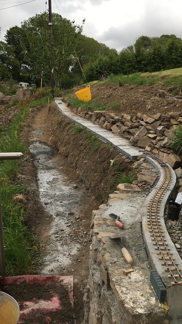

To bring you right up to date:
I have finished the retaining wall behind the railway. Todays task is to start to level the terrace above it - where the wheelbarrow is lying. That will enable the gardener to plant the terrace. I envisage plants flowing over the retaining wall. We will see! Finishing off the edging between the railway and the footpath can wait for a while. I am keen to make the rest of the track bed.

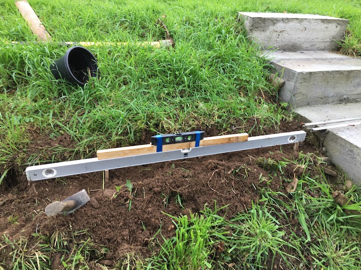

So were off! The second extension is started.
Yesterday we levelled off and planted up the terrace above the first extension:

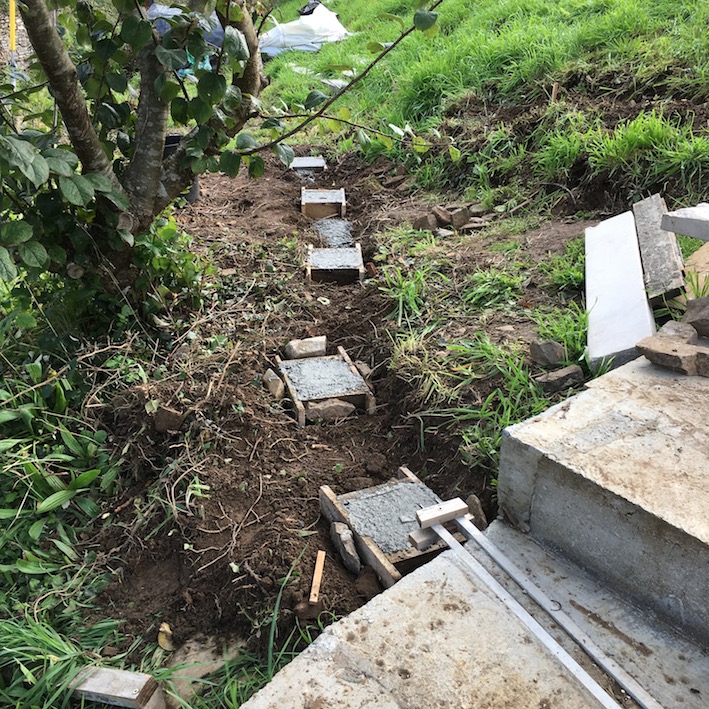

and I laid out the first parts of the extension. I have decided to lay the concrete "gravel boards" onto concrete pads. the gravel boards are 6 ft long and 6 inches wide. It is the most reliable way I can think of making sure they are all correctly lined up and at the correct angle. At the same time I am trying to avoid the heavy groundwork which the rest of it has entailed. I have calculated that top of the foundation needs to 70 mm below the level of the rail top. and I have hammered stakes into the ground so the tops are at the correct height. The stakes are 3 ft apart. So firstly my lashup to get a longish spirit level with a small spirit level taped on at the correct angle:
That is the top crossing and the formation set out to follow the contour, at 1:60 downwards.
And the same thing from the lower crossing with the stakes laid out leading upwards at 1:60 past the apple tree again following the contour as best as I can:
So I need to make shuttering and cast foundation pads around each stake.

The shuttering in place and the concrete pads poured:
And the gravel boards grouted in:
