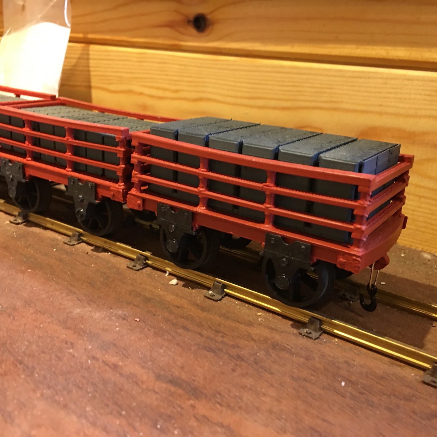

Wooden Festiniog slate wagons based on a drawing in Vol 2 of Boyles book:

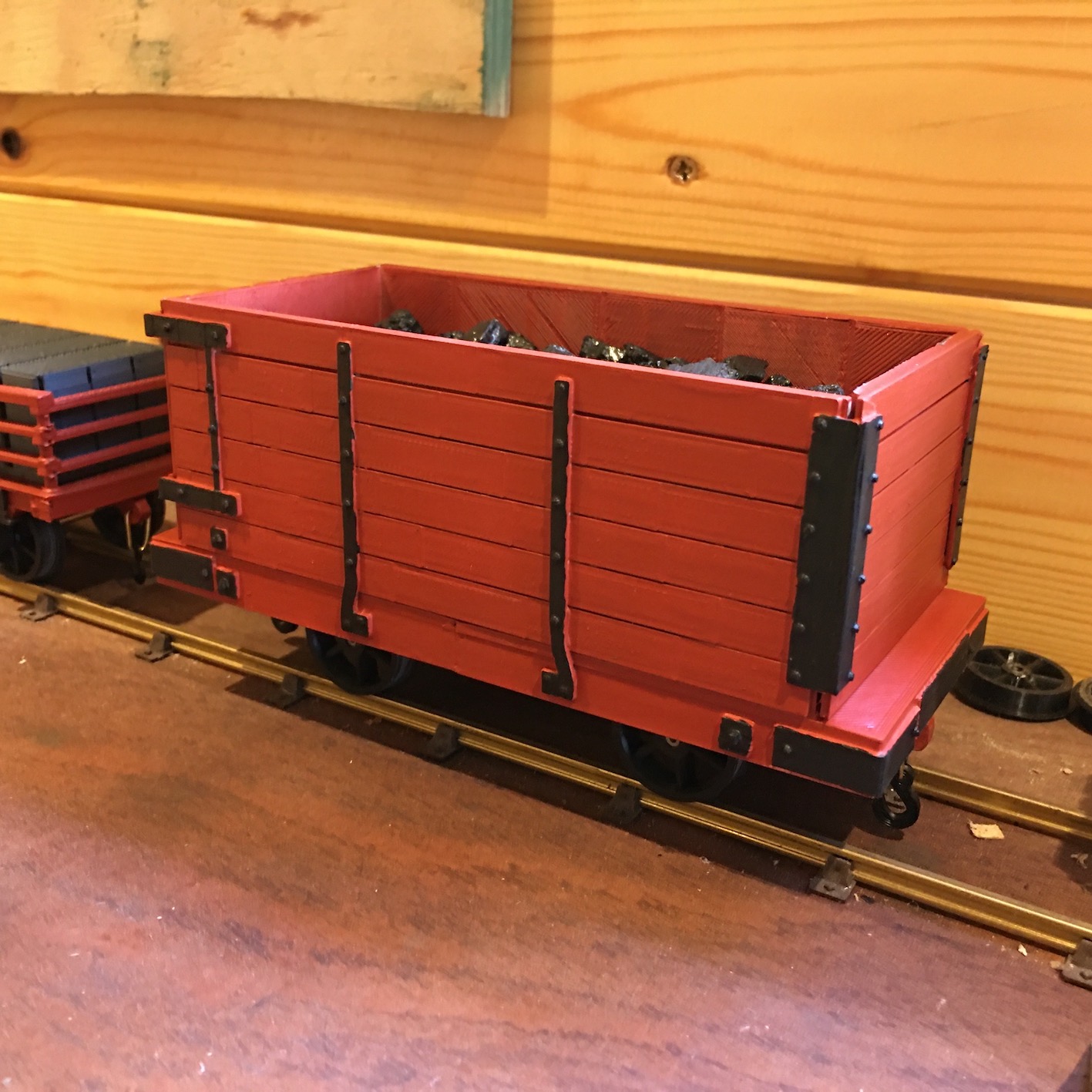

Wooden Festiniog coal wagons based on the drawing in the 16mm Association guide to the Festiniog:

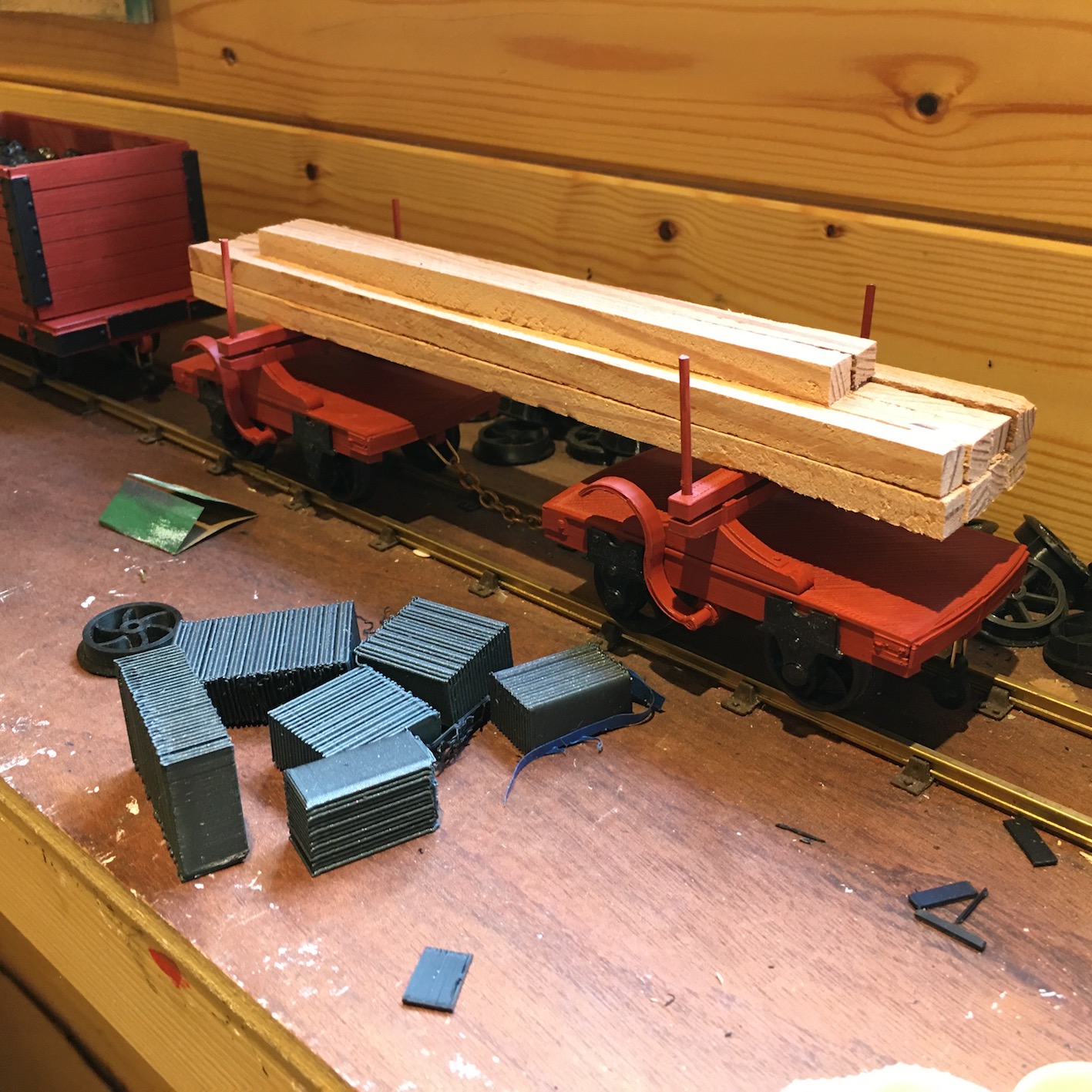

Bolster wagons which appear in a photo in the same document: Note the slates are indifidual slates printed in a block - and they do fall apart into individual slates!

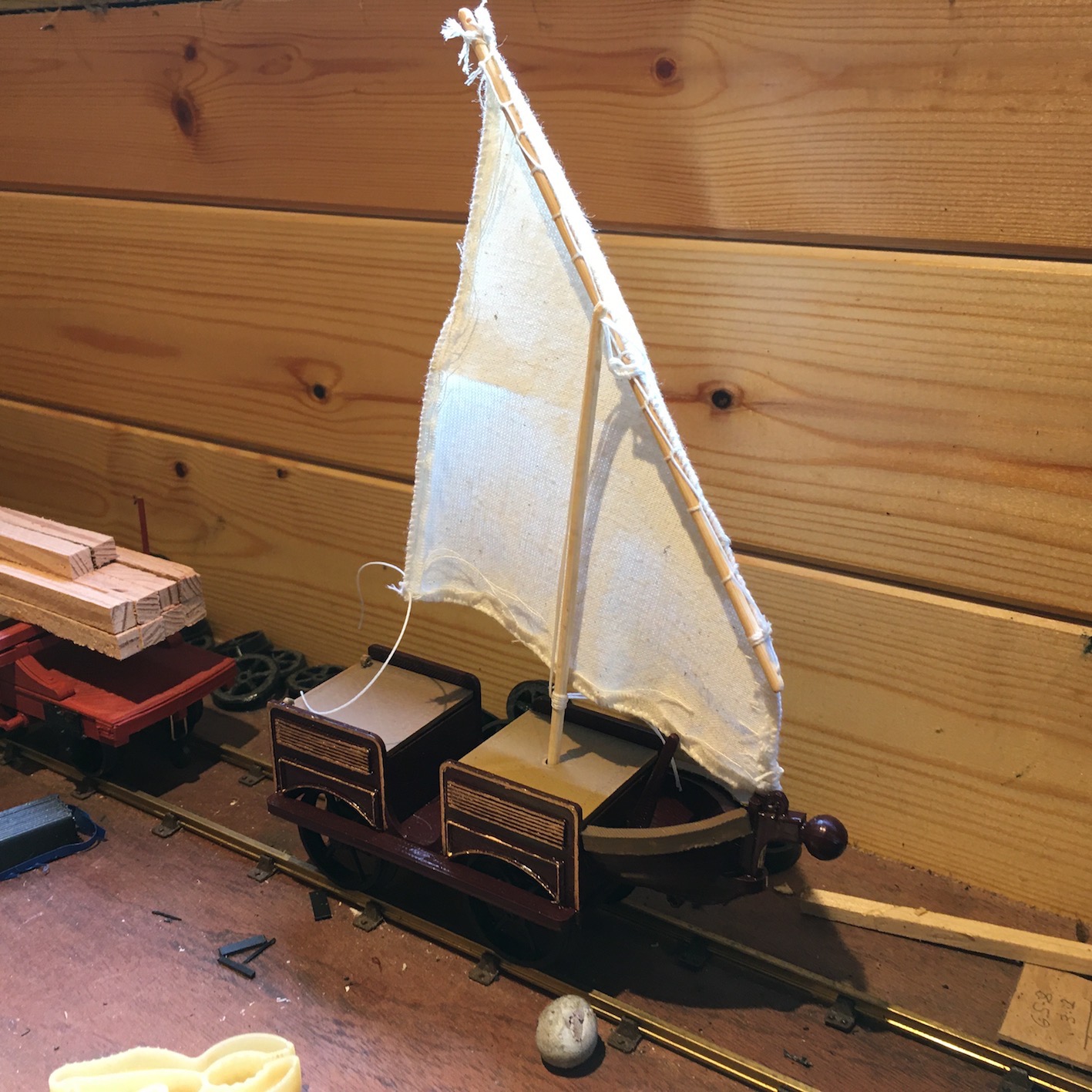

And of course I could hardly forget to mention the model of Spooners Boat:
I can't pretend to be an expert in CAD or anything else related to this, but I am satisfied with what I have been able to produce so far. On the other hand perhaps i have something worth sharing. So lets go back to the beginning and look at the process I am going through to create the model of the diesel Kerr Stuart 4415.

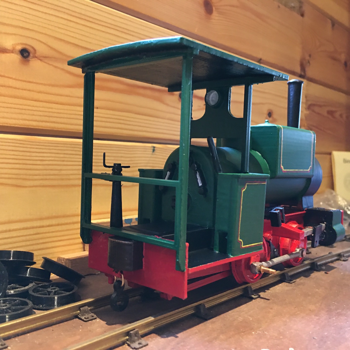

So to the Kerr Stuart 4415.
The starting point was a set of drawings which are on line. The locomotive is currently under restoration in Boston Lodge - and there are blogs online and on Facebook.
There are plenty of videos on uTube which explain how to use Sketchup - but they all concentrate on making a simple house of an indeterminate size. They were of little help when I was learning. Bit by bit I hope to describe the things I wish I had known when I started!

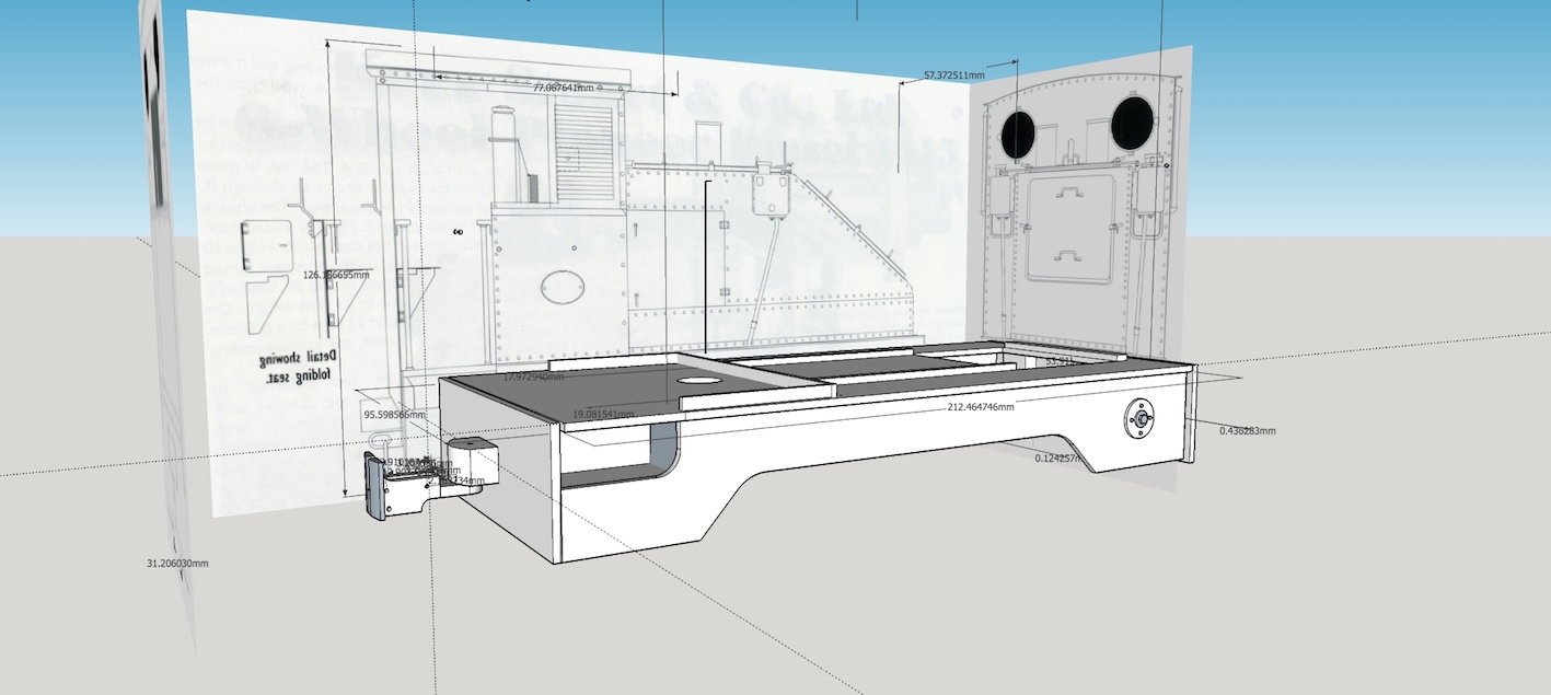

Having the drawings you can import them into Sketchup, scale and orientate them correctly so that they almost form the outline of the model:
The big advantage of doing this is that you can trace the outline of the components on top of the drawing and it will automatically place the things you draw on top of the drawing. All drawing packages have tools for drawing lines, rectangles and circles. The trouble with a 3 D package is how to force the software to make the drawing in the plane you want it in. Doing it this way sorts that out. Anything drawn on the side view is aligned to the side face. Anything drawn on the end view is aligned to the end view. Of course so far we have something which is flat, 2 dimensional. There is a tool in Sketchup which allows the flat shape to be pulled or extruded into the third dimension. So a square becomes a cube. It becomes three dimensional. The whole model is built up from lines, rectangles, circles and the like, extruded and altered to fit what you want. Just as a taster, here is the finished CAD image of the finished model ready to be converted into print files.

Having created the extruded version of the part you want to make, you have to move it into the place where it is to go in the final model. To help with this you can create guide lines using a tape measure tool. You can control where the part moves by holding down the directional buttons on the keyboard, before moving the mouse.
There is a function in a menu called "instructor" - if you click on this it brings up a menu at the side of the screen which tells you how to use each command. I still use it when I need further guidance - but to begin with it was most helpful.
So looking at the locomotive again. Drawing over the side elevation I created an outline of the side of the footplate. My using the tape measure tool over the end view drawing I worked out how wide the footplate should be. Using the pulling tool that square was extruded into a box, by holding down the mouse button and scrolling. Letting go of the mouse, I typed in the width in mm and pressed enter. The box is automatically extruded to the correct width. In a similar way the sides of the footplate, perhaps better described as the frames, were created. They are formed from three rectangles, and some lines to make the angled edges. Unwanted parts of the boxes were then deleted. the shape was moved into the correct place:
Another important point. Sketchup joins things together. If you draw two cubes and move one to the other it joins them together. If you then move one the whole thing distorts. The bits which touched "glued together". So its important to make "components - it is in the edit menue. So the footplate is one component. The frame side is another component. A secondary advantage of using components is that you can make a frame side once and use it twice. But you have to "flip" it - that is a sub menu under the components menu in the edit menu. (perhaps that is enough to help you locate it). Having created a component I can go back and edit it later. If a frame spacer needs to be 2 mm wider, I can edit the one component and every frame spacer will have the new width. Of course the frames then have to both be moved manually. Incidentally I did make the frame as a simple rectangle early on - and went back to edit the component a number of times later. The upstands were part of preparing the finished model for printing. Something to locate the body against.
You can see that I am cheating - I am hiding parts of the model and showing you relevant bits. So the footplate has a hole for the gearbox to poke through, and up stands to locate the bodywork, which have all been added later. There is also an image of the bearing on the front end of the frame. You can also see my standardised version of an early form of the chopper coupling used on the Festiniog. Yes I am printing chopper couplings, including the hook. I also make my own hooks for the slate wagon couplings in the last post. They seem quite strong enough to work on my railway (which has 1 in 60 inclines). I am standardising on using them on locomotives and coaches. I am also making all the wheels I use.

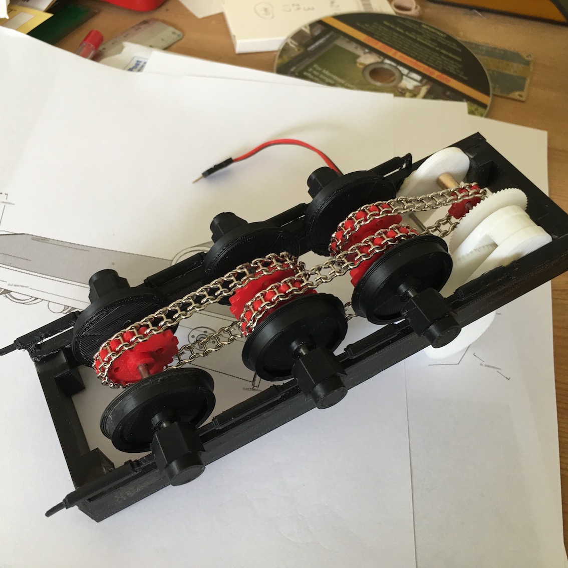

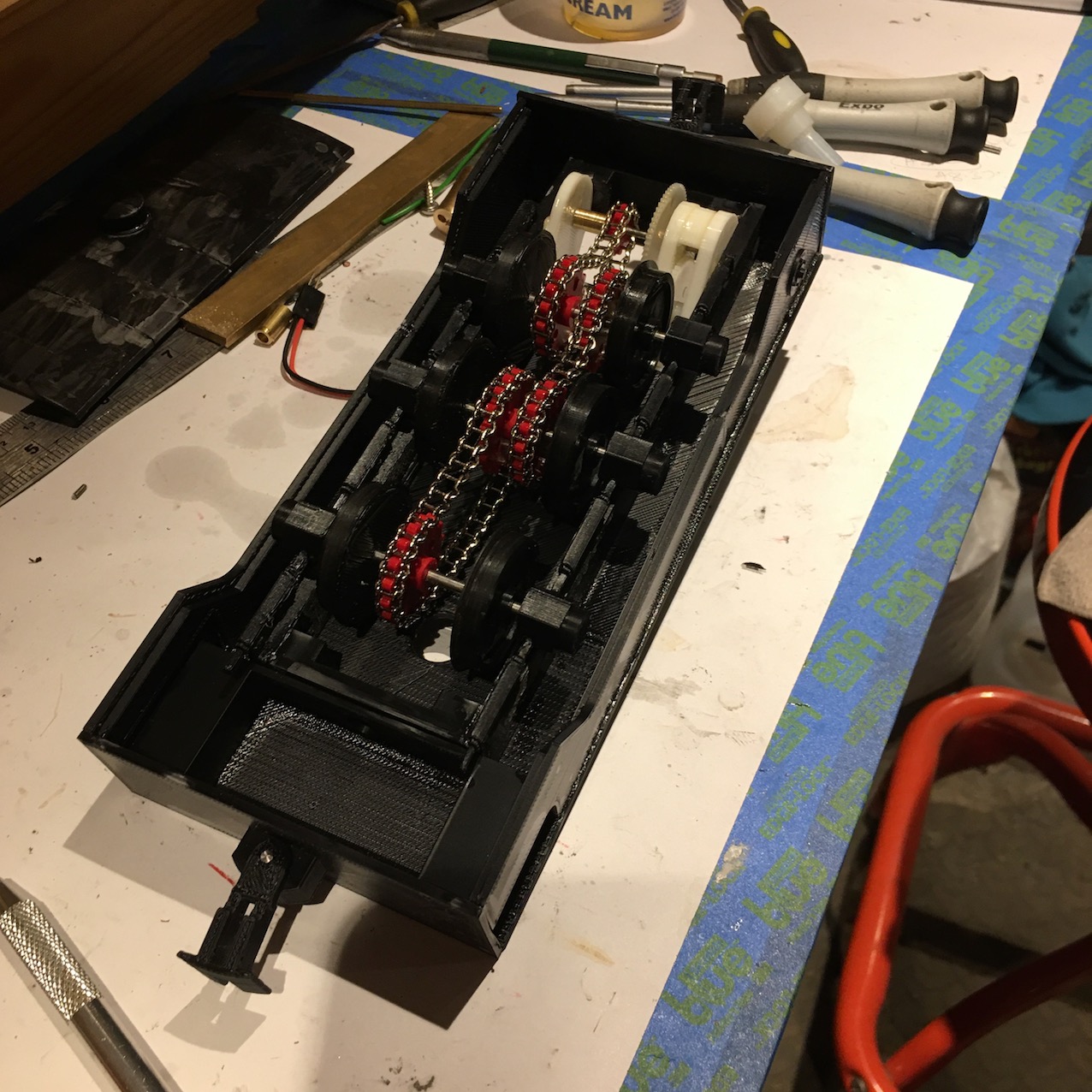

Here is the inner chassis assembled and tested in three views. The sides were printed axle hole down on the printer bed. The 3mm holes are printed in site but only go as deep as the top of the Hexagonal part. The frame stretchers printed as separate items. The wheels as 6 wheels at once with the inside face on the printer bed.
The stainless axles were faced and centred on the lathe, partly so I could press the wheels on to the axles accurately using a home made fixed centre. (A bit of pointed rod) to engage into the centre formed on the axle. The wheels were made with 2.8mm diameter holes printed in them, and were just carefully mounted in the 3 jaw chuck and drilled with a 2.8mm drill to clean them up.
They have gone on OK - seem to run true, and a tight enough fit on the axle to hold the back to back measurement.
The gearbox was printed in 3 parts in white ABS. Why white - just what I could get during lockdown. The motor is held into the motor locating tube with a couple of dabs of Gorilla glue - the polyurethane one which foams.The holes for the gearbox axles are printed 2mm diameter and cleaned up with a 2 mm drill by hand. The three parts were held in position relative to each other by the 2mm axles - it seemed to work because the gears run easily. The gears were bought, I cant print such small detail (I have tried). Chain and sprockets bought - and a press fit onto 3mm axles.
Incidentally I tried printing the gearbox in one unit but couldn't get it to work properly. So three parts the motor tube and the bit which has a gear each side of it - one piece printed with he gear end of the motor on the bed. Second part the section to the right in the second photo, including the spacers, flat end down. Third bit the piece which the ends of the shafts go into on the left of the second photo. The three parts just bonded together using Acetone.
I am going to make a second gearbox with better quality gears, and 3mm intermediate and final drive shafts. Not that this doesn't work - but it seems a better way to do it.
Incidentally I like to print wheels and other bits which might have been black on the real thing in black filament. When the paint comes off the tread is still black (if I actually paint them).
So to the photos:
The footplate, and chassis proper will be assembled later. Last frame side is on the printer now.

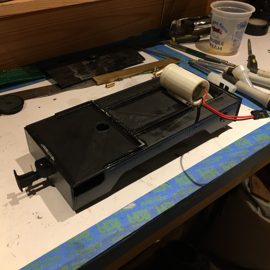

The chassis for 4415 is now complete. Printed and assembled:
and the underside:
and the spectacle plate is in the printer:
