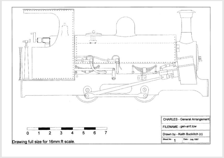

Back in 2011, I bought boiler shell material for Keith Bucklitch's "Charles" loco design, I had also turned the wheels. But then I shelved the plan and went on to build the Live Diesel, using the wheels on that locomotive. I now have two large scale Penrhyn steam locos and feel enthused to make a start on this fine "mainline" loco. I am planning on concurrently building a completely different loco as well, so these projects will take a lovely long time. I've been checking my stock, I have one more unused pressure gauge :thumbup:
Years ago I scanned and .pdf'd Keith's Garden Rail "Building Charles" 8-part series from which this general arrangement is taken

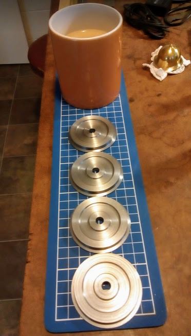

It's been too windy to run the new loco so I've made a start cutting the wheel blanks - the hard way! I used to use the bandsaw at work... Now I'm using a parting tool down to about 1" diameter and then hacksawing the remainder. It's the first time to use the backgearing of the lathe in a long time and I'd nearly forgotten how. My target was to produce one wheel blank per day, but missed a day yesterday :D

It's far too windy to run the new loco, so I've been turning wheels
This is the front face of the wheel and this recess will be painted black

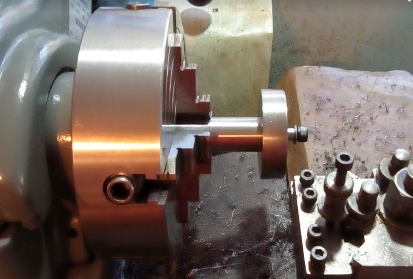

I seized the opportunity Christmas presented in the early evening and finish turned the wheels
The wheel turning mandrel wasn't true in the 3-jaw chuck, so I used the 4-jaw. Even with the extension, the set-up was rigid enough for the 3 mm deep LGB flanges

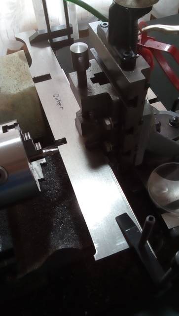

Whilst looking at my steel sheet for making frames I remembered all those years ago I'd already got steel strip in for them, and there it was oiled-up on my stock shelf in the garage :thumbup:
Here we are setting up the frame to mill the end face

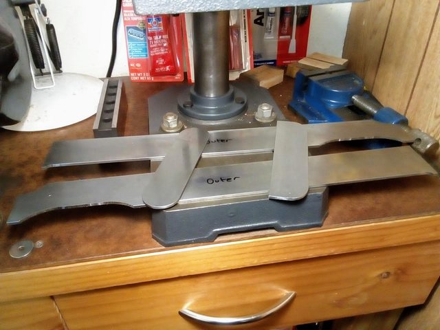

The weather's too hot for running the new loco so I've been doing some more work on the frames, making the distinctive buffer beams. I filed the radii this time :thumbup:
This is the latest state of play

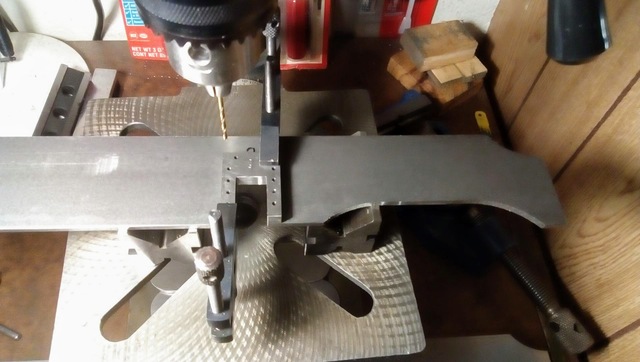

It's been so hot and dry that I haven't been venturing out to run anything on the line. So I have been making some progress on the frames. I have been closely looking at pictures of the real thing to work out axle box dimension, I thought I'd better make proper axle boxes even though they may not be sprung
Milling the axle box slots in the frames
