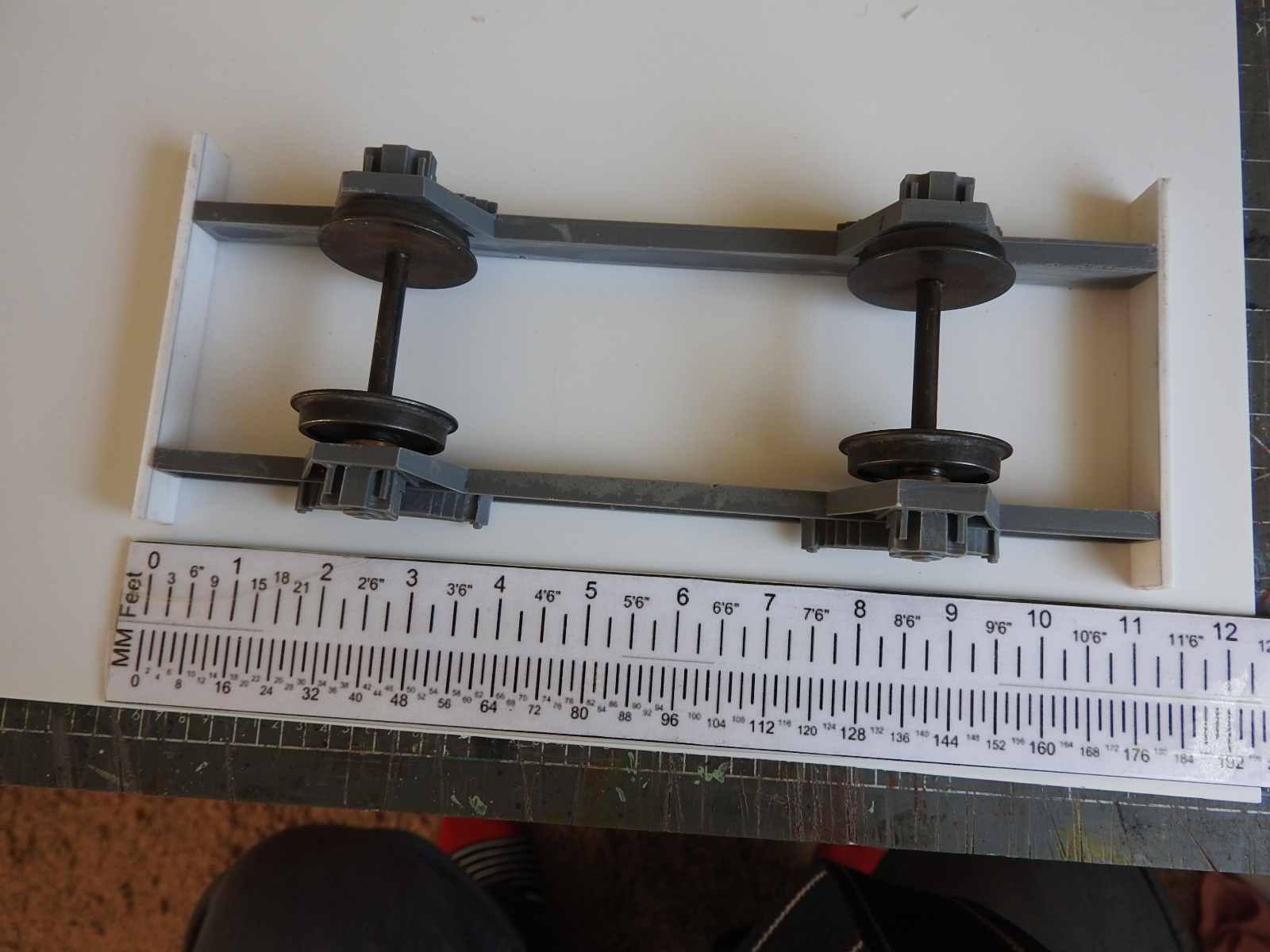

So here we go with my 1st attempt at doing that. I have cheated a little bit in that I have used some Swift Sixteen 'I Beam Chassis' but I hope you can forgive me that one thing, well two with the wheels... :lol: :lol:
1st I needed to drill some holes into the beams has they don't have any for the bearings. I could have put some Plasticard on the inside of the beams with the bearings in them and I did think of that after I drilled the holes.... :roll: So I carefully marked the hole centres and drilled 6mm holes 3mm deep. I have to say the 3mm deep holes was carefully guessed.... :lol:....I did mark the drill bit 3mm + from the tip to act has a depth gauge. They turned out ok has you will see...
The two small holes you can see are bubbles from the mouldings....
The chassis with the wheels fitted and the end plates.
A very very short video of the chassis freely running....

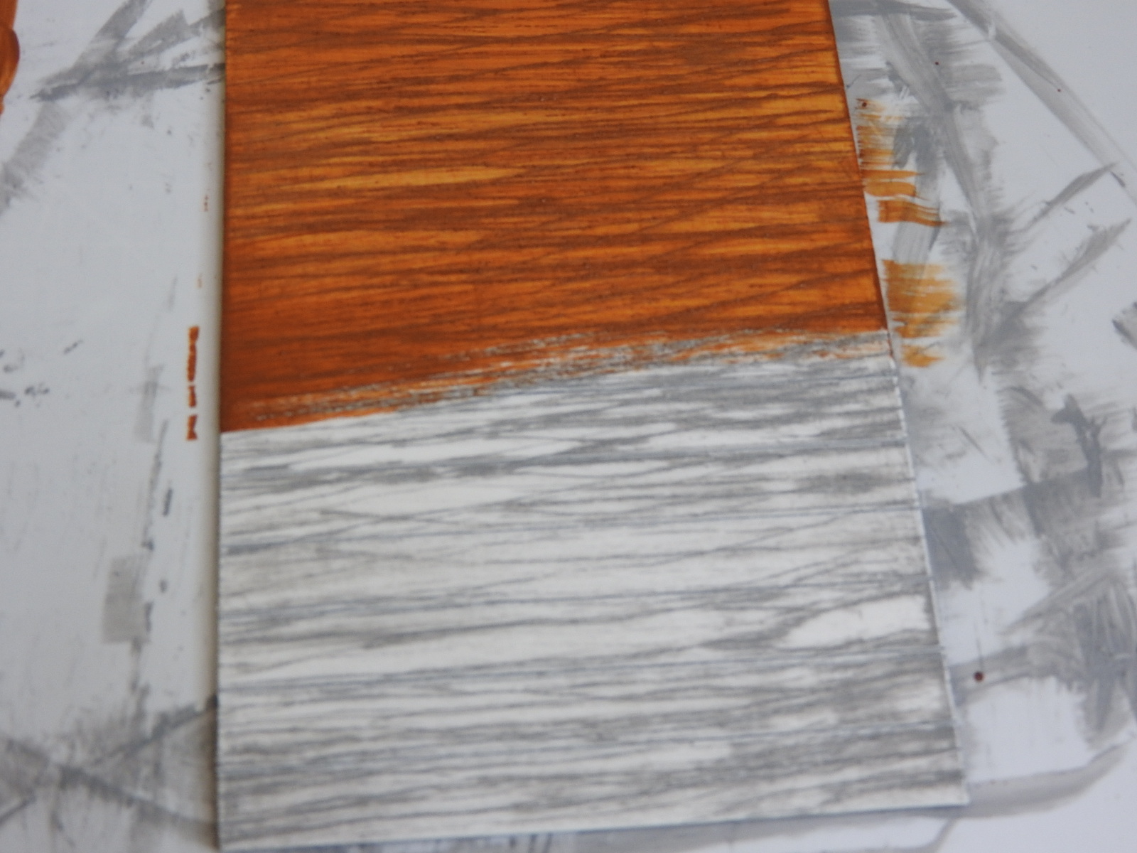

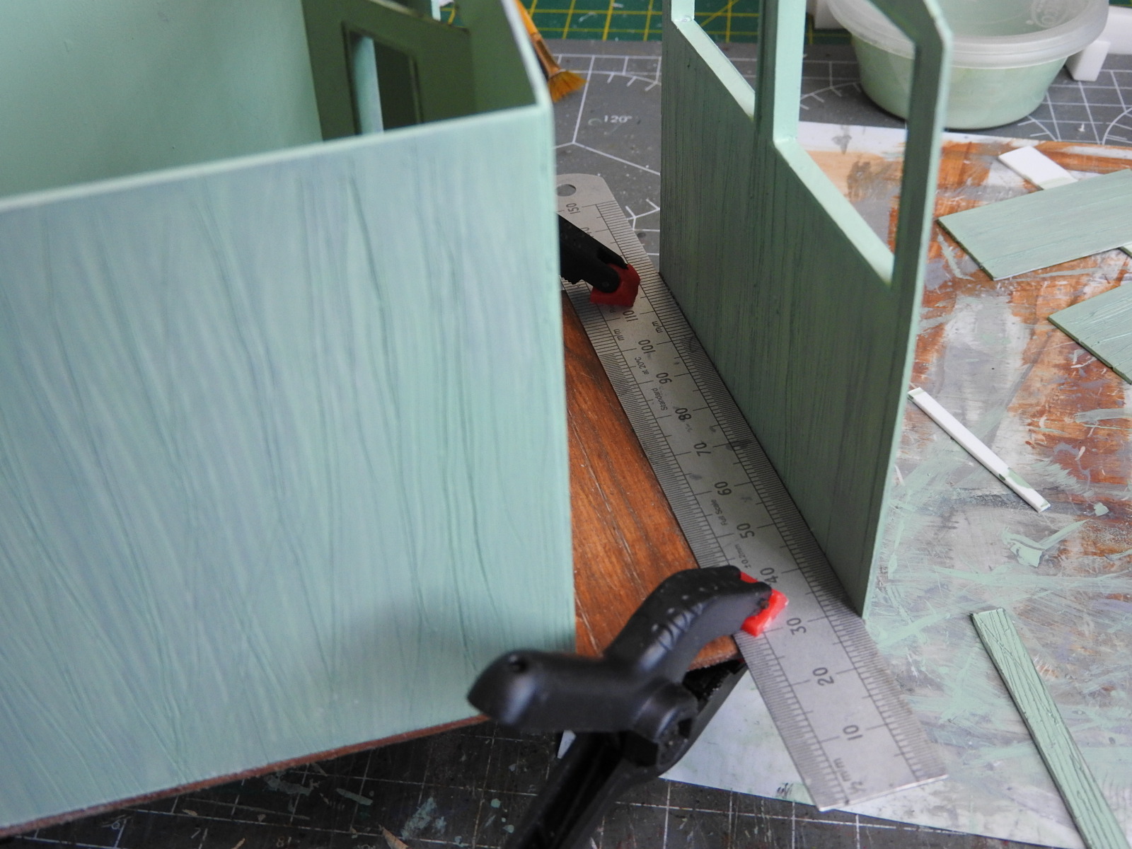

After the chassis, the floor was cut, scored and painted.
I was going to just leave all of the van with just the grey paint, but maybe next time. There really does need to be a wood colour under the grey, so a little bit of experimenting will be done...

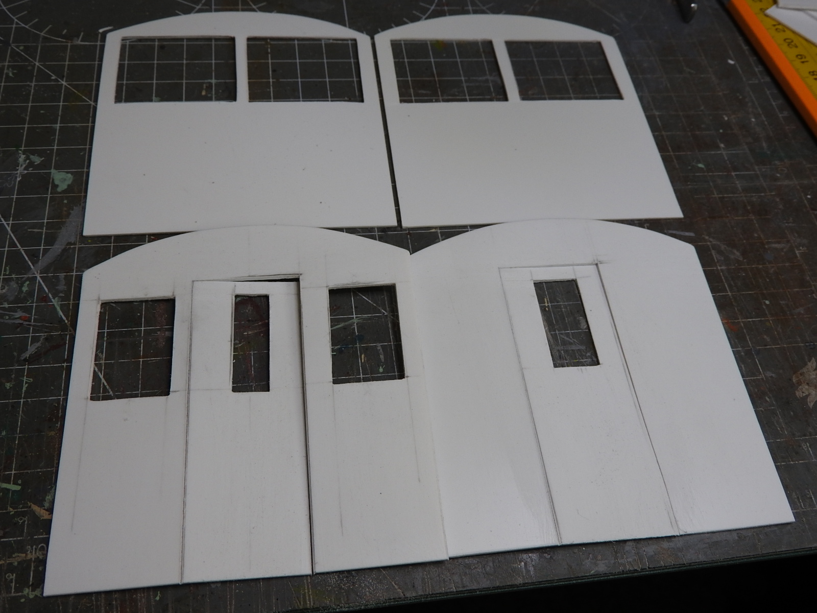

Next is four ends, four ends I hear you say. All will be revealed in a few minutes...

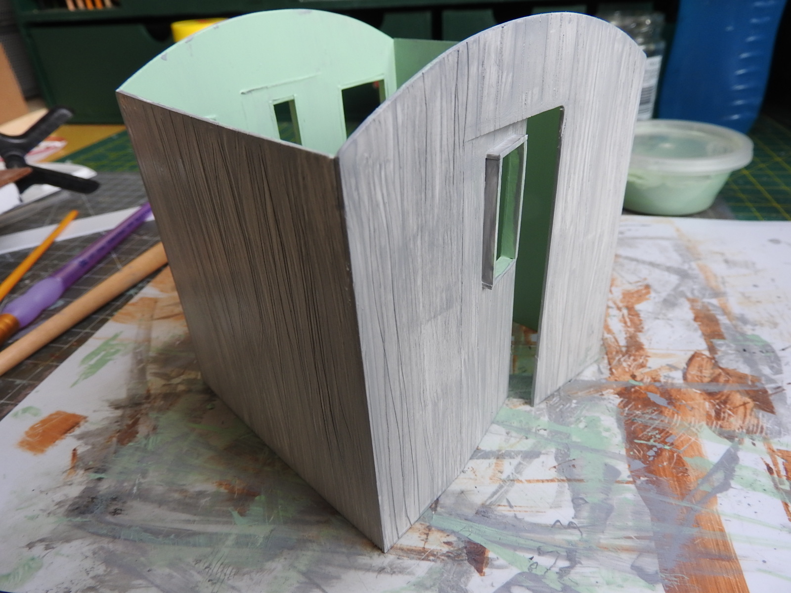

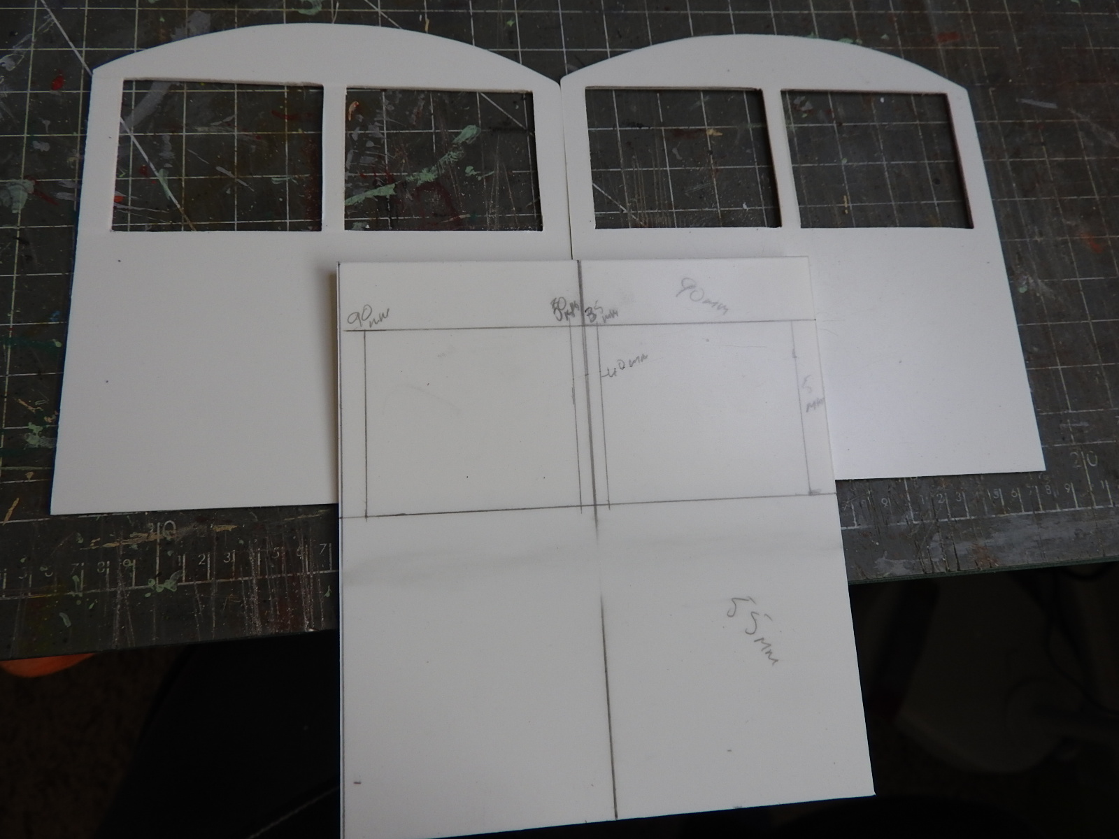

The two inner ends and sides,
Now the outer ends of the van,

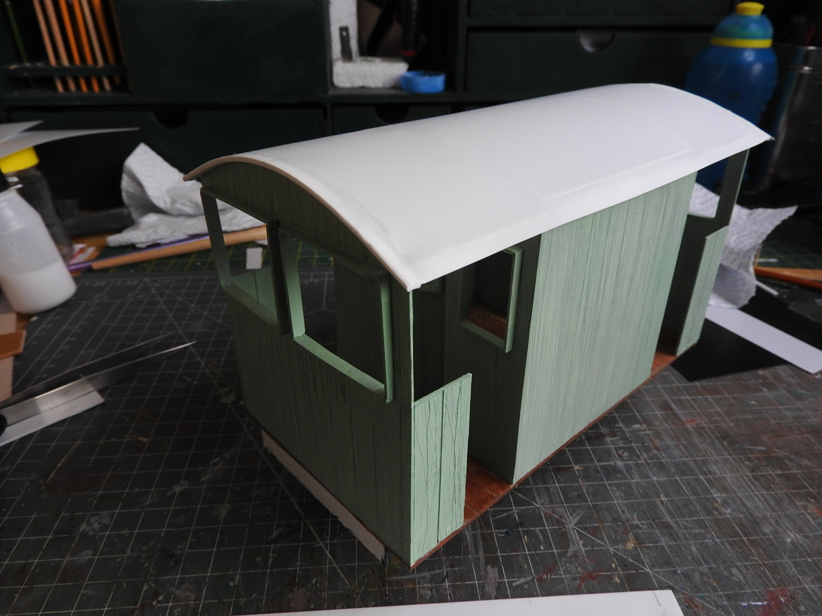

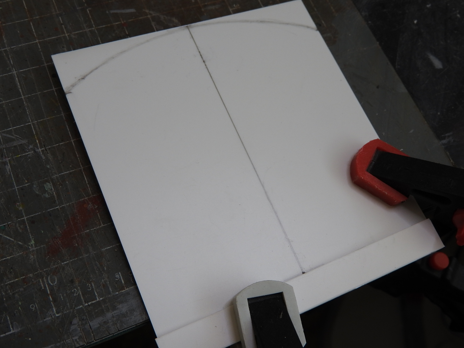

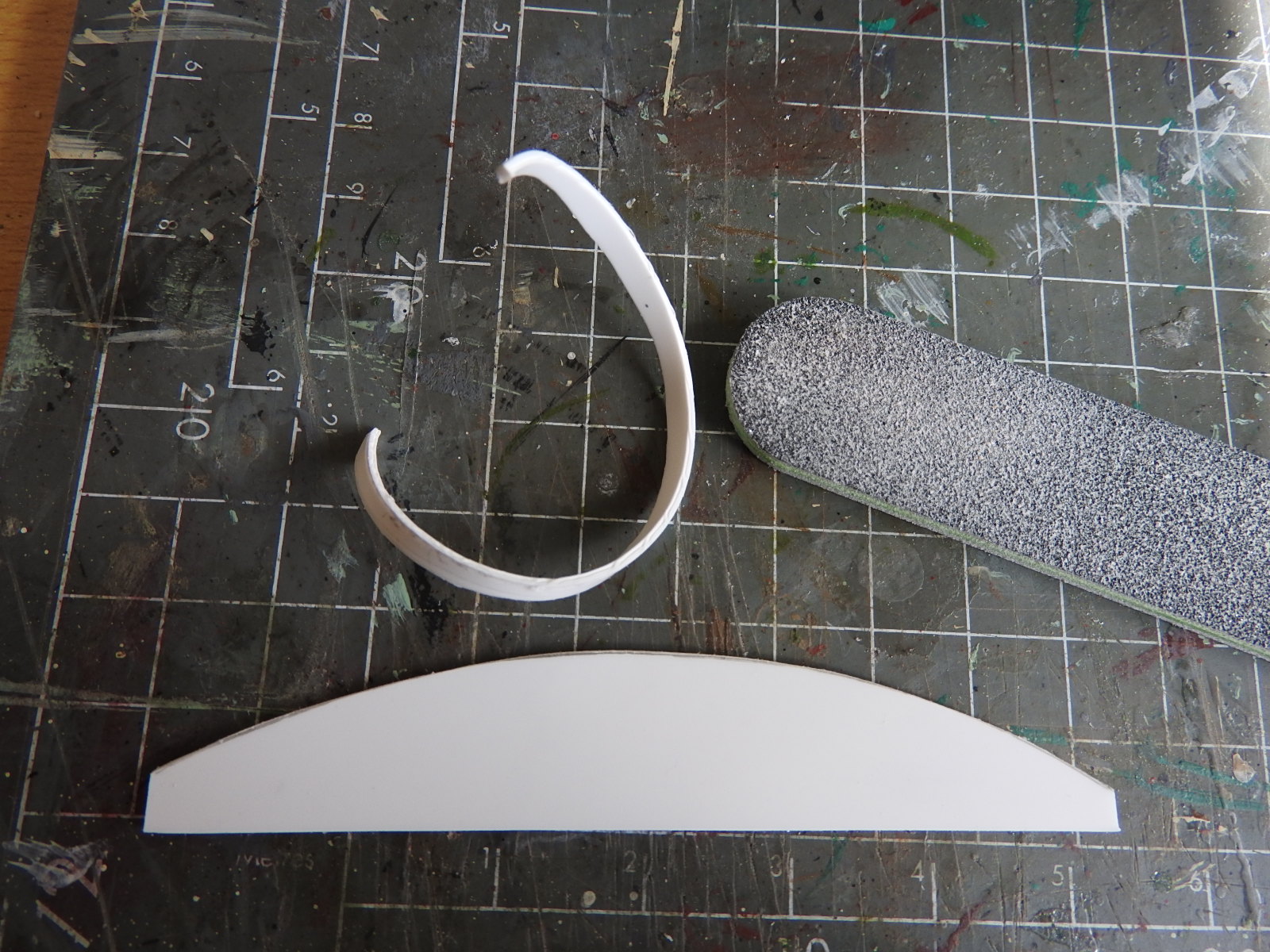

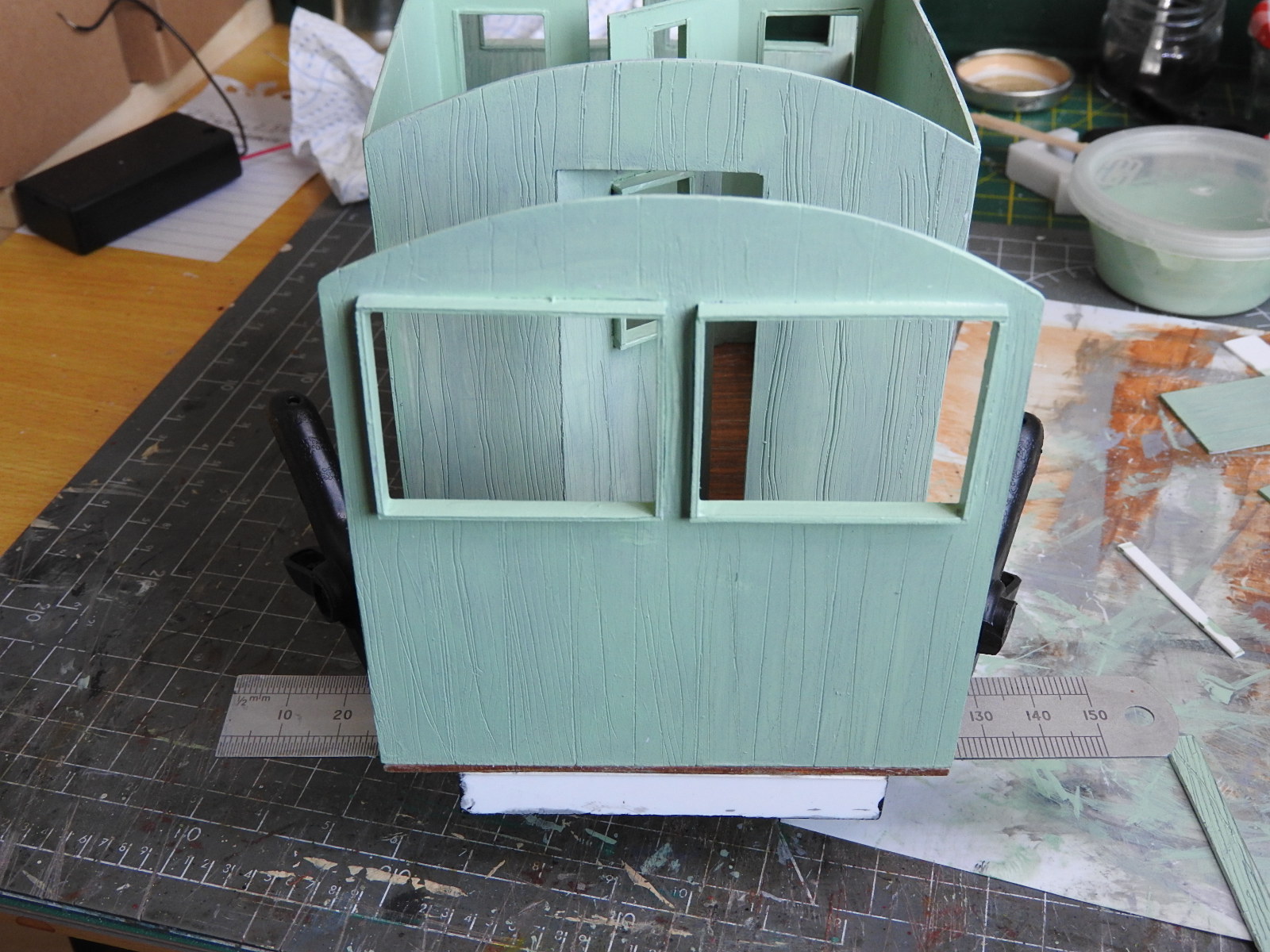

I made two jigs for the roof so I could cut the four roof supports out, they needed to be different for the inner ends because of the height of the doors.
With the roof on,

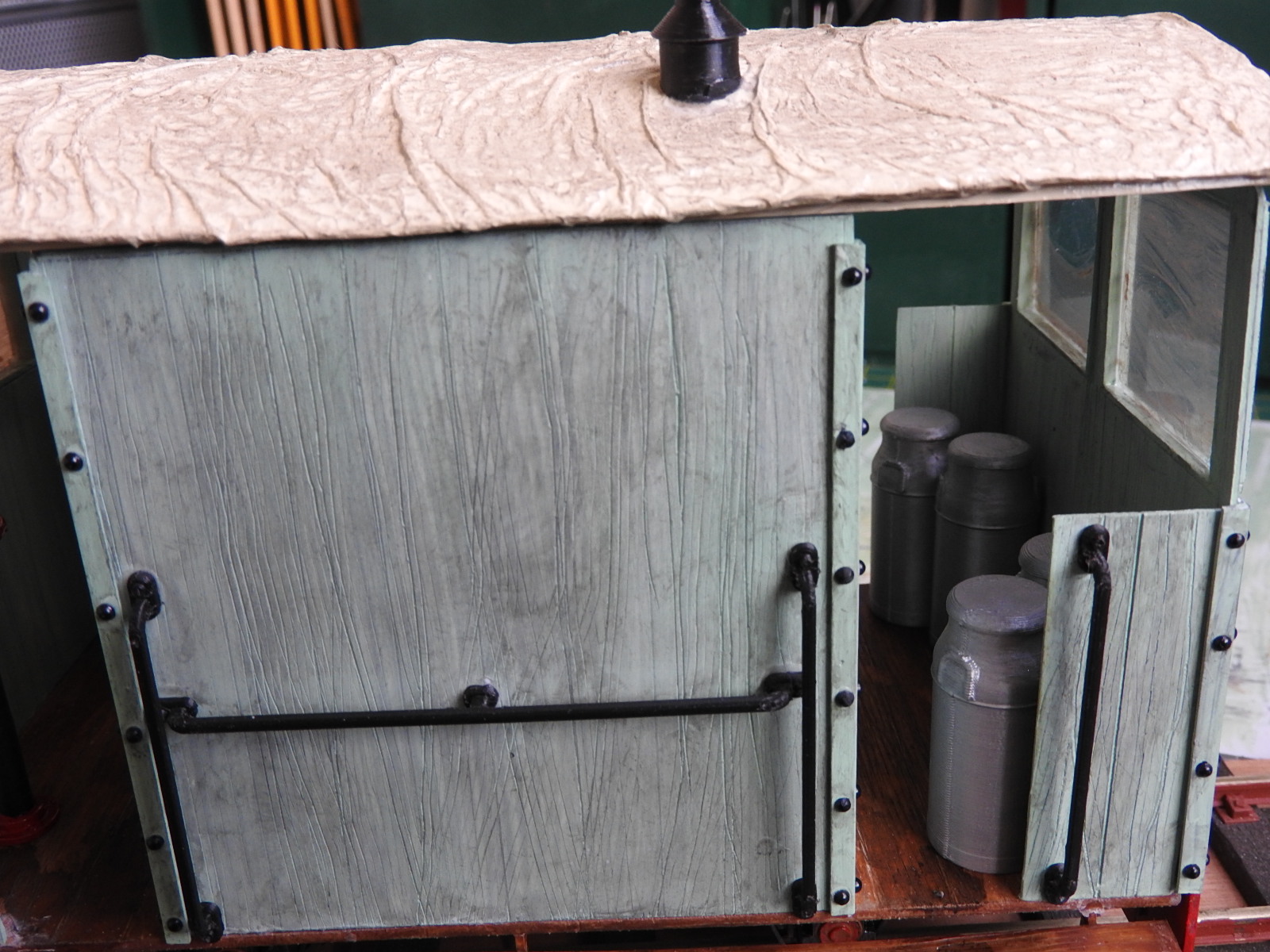

I am sorry I haven't took any more photos showing the making and fitting of the buffer beams and the other things, like the running boards. But they are a simple build and one that most of us can do, some a lot better than I can do..

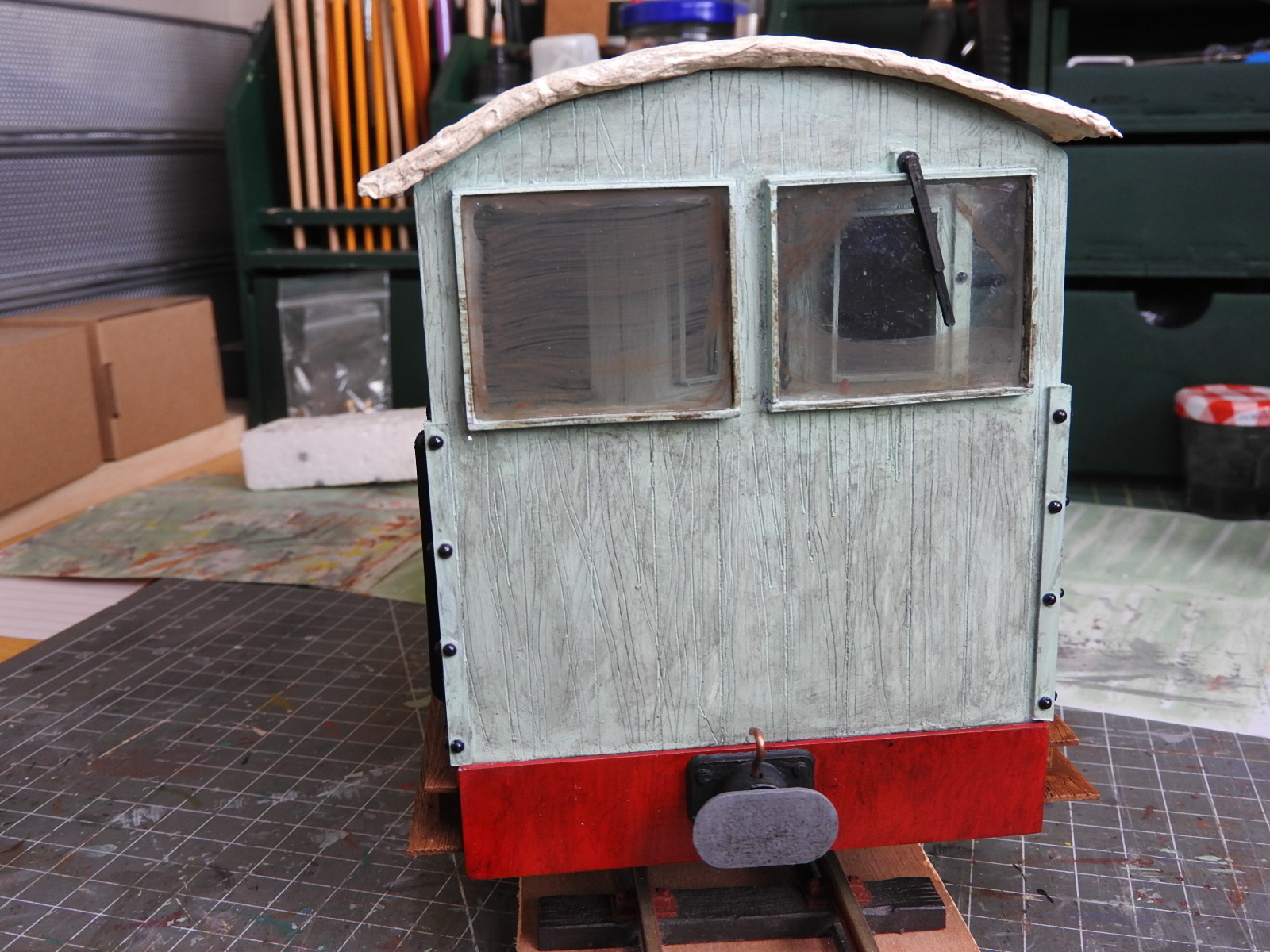

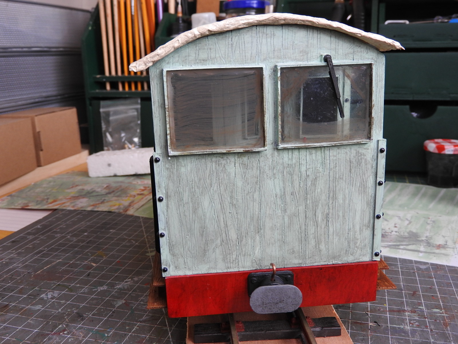

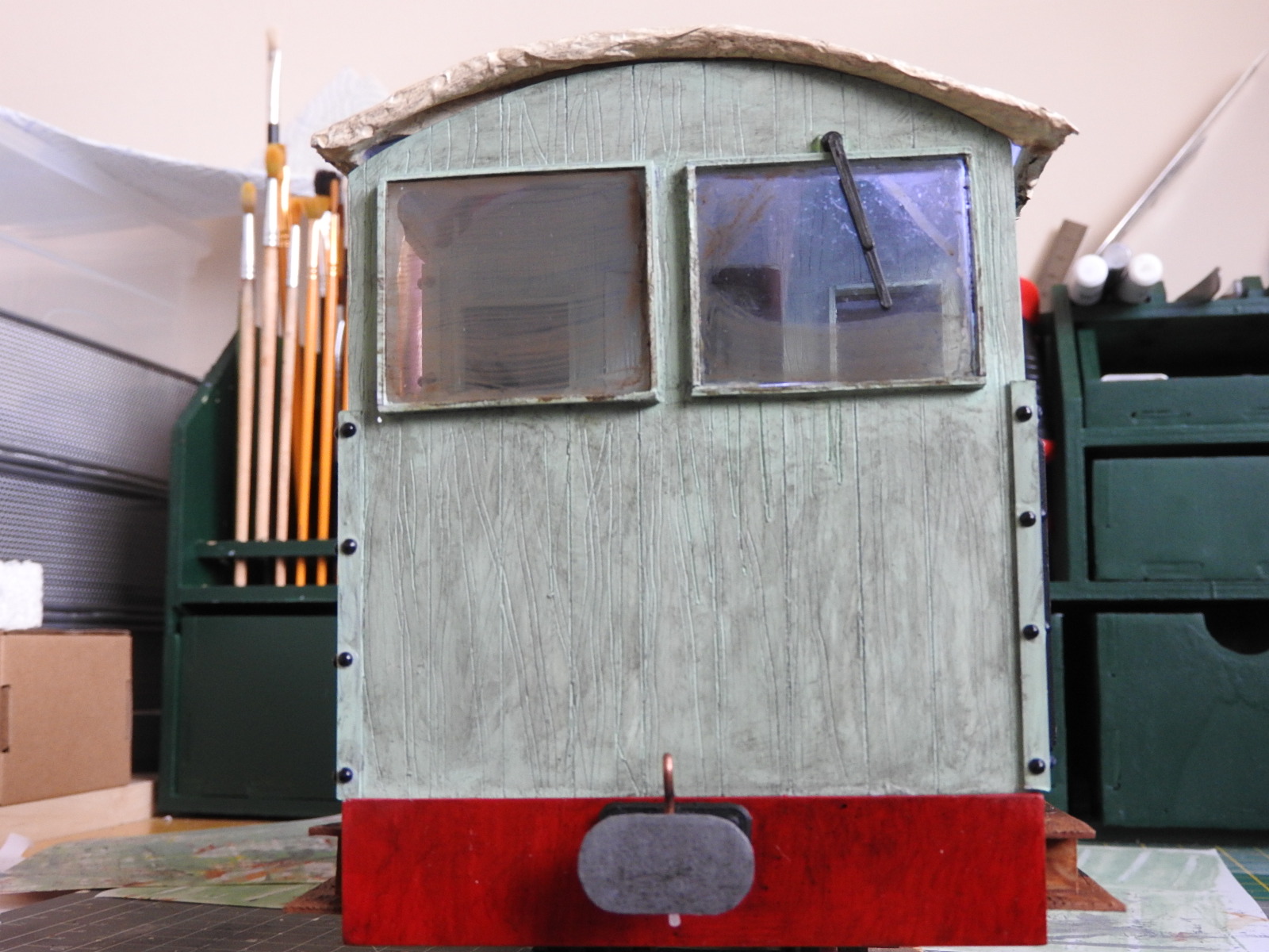

I did however put some glazing in the van ends and Anne suggested there should be some wipers on the windows so the Guard can see out, (I need a Guard I said) hint...So I thought it would do no harm. I ordered two of them plus some made to order grab rails, plus 4 Milk cans and a chimney from SLR models for Β£10, which Nicki did has a favour for me, all of them would have been a little bit more though.. :roll:

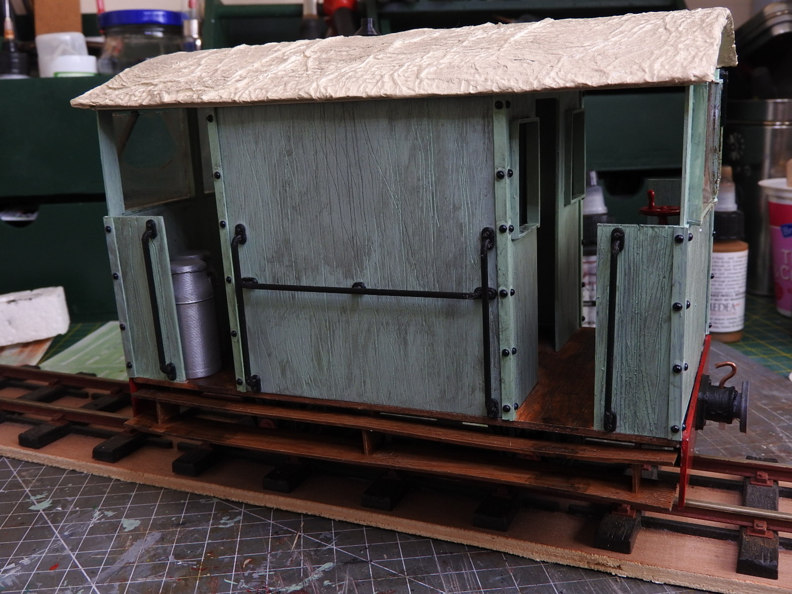

After fitting the wipers I did think they don't look right and also the roof....maybe I shouldn't of gone with the crumpled look, at the time it looked good, BUT.....

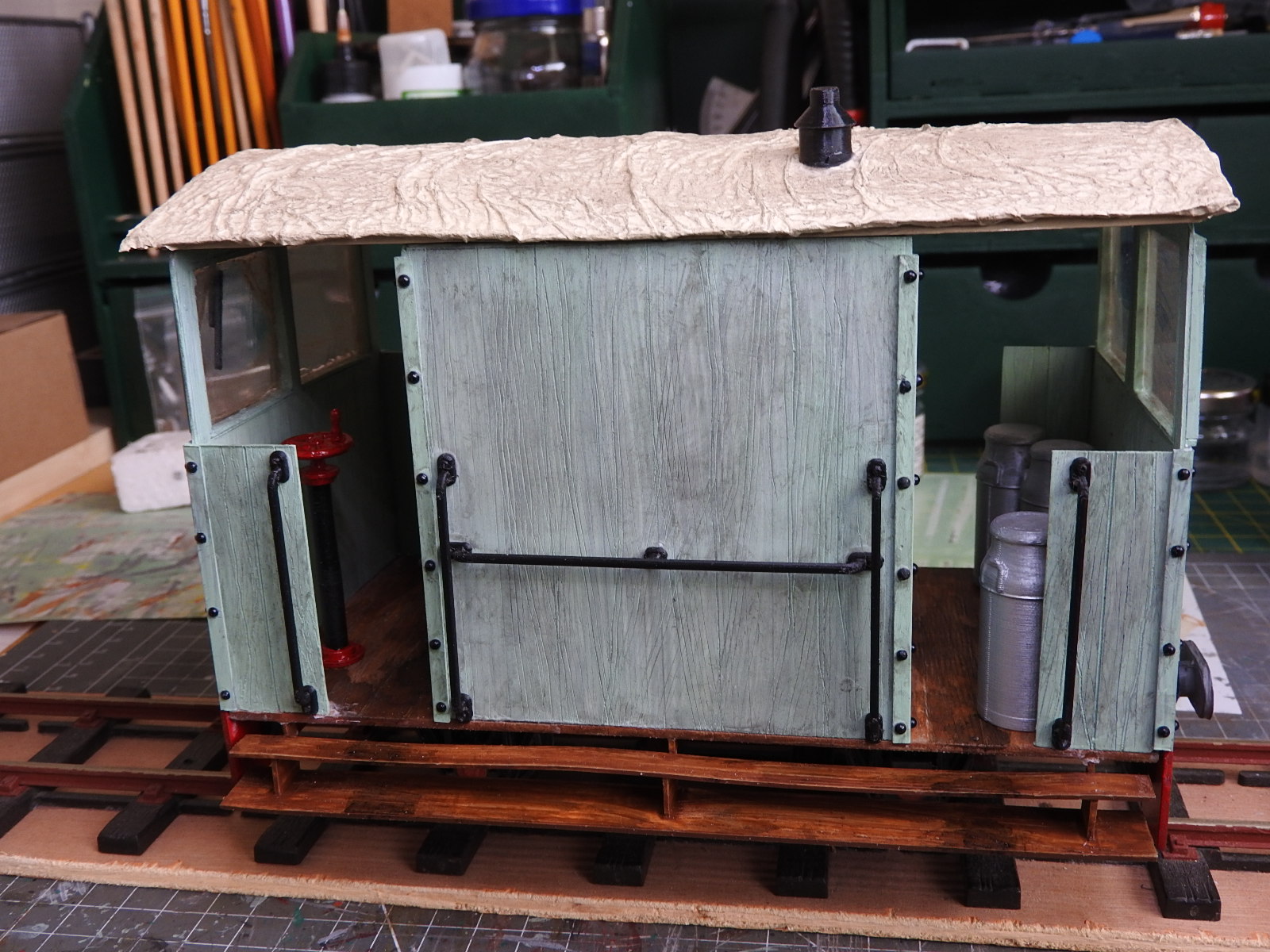

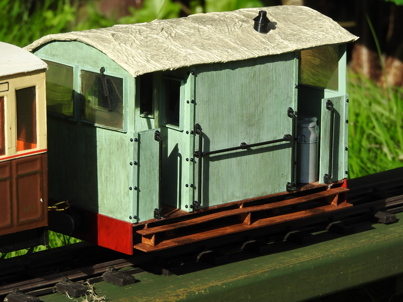

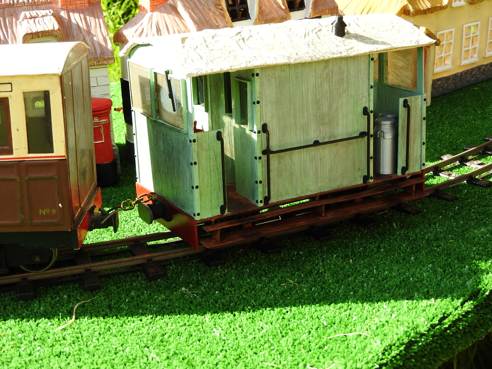

Anyway here it is, weathered and done. The couple of photos of it behind the coach and Anne's Tram are purely for photo purposes, I am going to have it behind some coal and flat wagons, that was the idea anyway......
I think It come has to the end of the allowed space for this post. So I will put the other couple of photos up later.
I hope you like my take on a Guards Van, it may not be proctypicial, but I don't pretend to do proctypicial. I do what I think looks good for us. I don't really have the knowledge anyway of how railways should or should not be. I just love railways in all its forms......

You must be pretty pleased with yourself. There is a lot of pleasure in scratch building. I would agree with you about the roof. You have rather overdone the texture but you could tackle that if it bothers you. Other than that it is a good build. The Milk churns on the veranda are a nice touch. The van looks just right as part of the train.
Don
Re: My 1st ever completely scratch built something...
Post by FWLR » Tue Sep 03, 2019 8:05 am
You have just made my mind up Don. A new roof is going on.....
