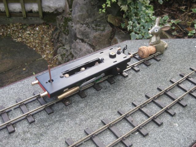

I have been playing with a Bowman 300 chassis
https://youtu.be/BaEyA5QuzZ8
What to do next anyone have a spare body and or Boiler?
Regards Tony.

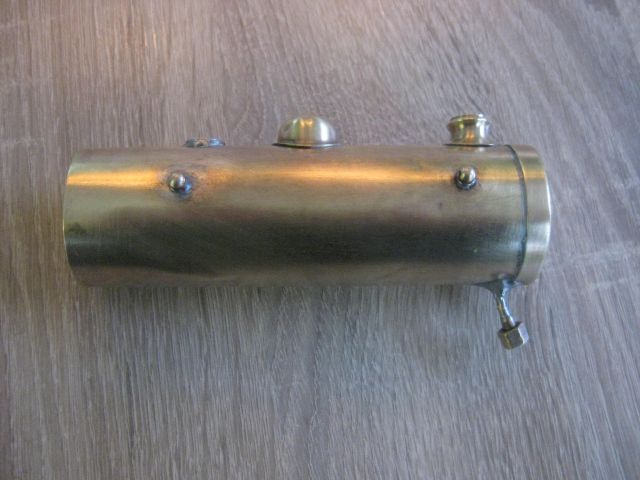

And the boiler has arrived.
IMG_7323 LR.jpg (50.71 KiB) Viewed 9780 times
The paint has been removed.
IMG_7329 LR.jpg (49.28 KiB) Viewed 9780 times

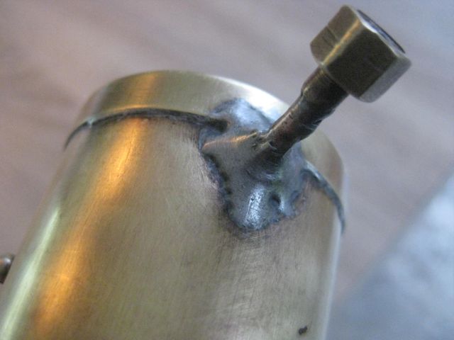

The boiler looks in reasonable condition with only a couple of issues with some bad soldering on the steam pipe and safety valve bush.
IMG_7330 LR.jpg (37.71 KiB) Viewed 9780 times
IMG_7331 LR.jpg (35.35 KiB) Viewed 9780 times
These have been removed and will be replaced along with a hand rail knob which is missing.

Re: Bowman 300 chassis
Post by tom_tom_go » Sun Jan 13, 2019 11:12 am
Hi Tony,
If those parts are silver soldered how did you remove them?
Tony Bird
Posts: 601
Post by Tony Bird » Sun Jan 13, 2019 1:05 pm
Hi,
The boiler is soft soldered together, I don't think Bowman ever used hard solder. So it was just a matter of heating the boiler and waiting for the solder to melt before removing the fittings.
