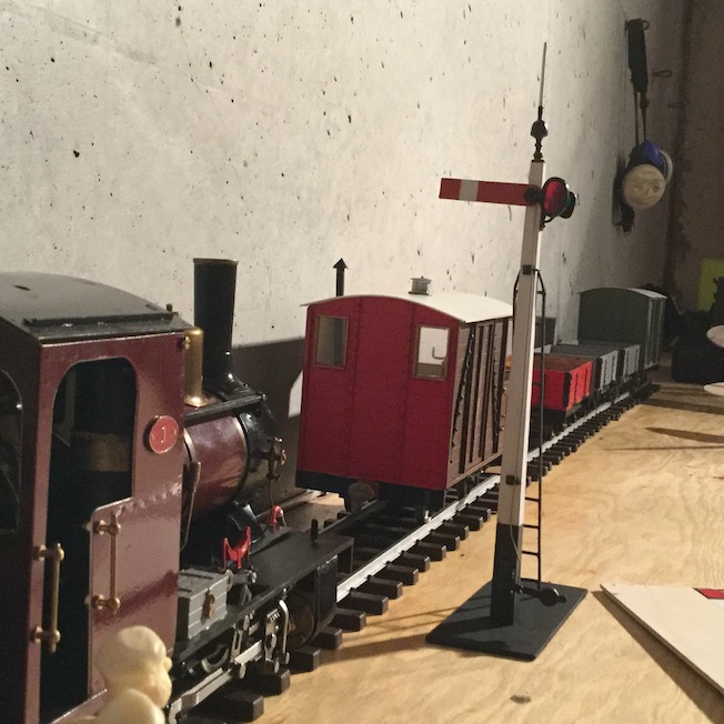

I decided this week to build the signal kit. Here it is completed, with some rolling stock to give scale. It was a nice kit, as are all things Roundhouse, with nice crisp white-metal castings that required very little dressing with a file before assembly. A simple kit, but it makes up into a nice model.
So here you can see the little white figures as well as the detail parts on the engine. My next thing to do is to paint the little train crew.

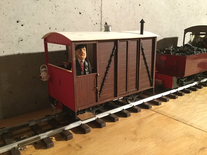

I had forgotten about the 'Vlad the Impaler' finials on MacK & H signals. I am glad to see someone else who favours red ends on brake vans!

Good job with that Keith.
Do you think this signal can be left outside all year round?

I don't think I will leave it outside here, because it will get buried in snow and possibly damaged if someone, or an animal, tromps on it. There are also a lot of ravens about in the winter, and they steal things.
It's mostly white metal with a wooden rod making up the post. I suppose in the U.K. it would do OK outside if it was painted with outdoor paint and touched up now and then. The wooden rod might warp in moisture I suppose. I don't have much experience with leaving things outside.

Yes I do like the red end on my van. I don't remember why I chose to do that, but I like a bit of colour.

Nice photos Keith. Like the signal, it does look great.

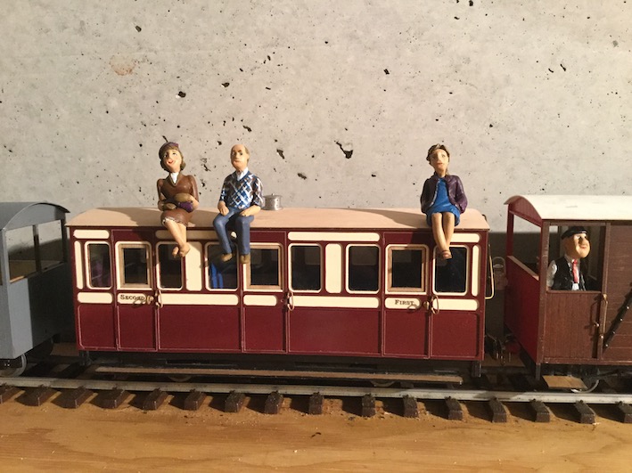

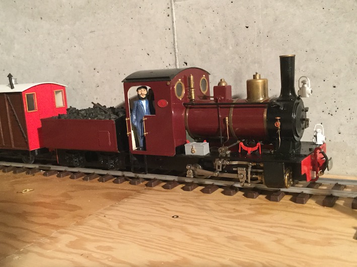

I've been up to some more small stuff on my workbench, on my list of little odds and ends to finish up. I've painted some of my little "model town" people I bought an assortment of at Peterborough in 2017. I wasn't looking forward to this but it's actually quite fun. They come in a ghost-like white colour. First I paint them all black and then pick out the details with small brushes. It's more fun than it looks because when they are all white they don't have much personality but then as their faces appear, I can't help making up little stories for them... or at least imaginary personalities. In this picture some of them are sitting on the roof of my Brandbright coach because their seats in the Gladstone car have been removed. The lady in the brown dress is very pleased because she is on the train in order to do some shopping. Her husband is not very pleased, for the same reason. He would rather be having a pint with his mates or watching football. The young woman is on a day off school and is going into town to see a friend.. but she didn't tell her Mum the "friend" was a boy.
The driver is on his first morning back from the week-end, which explains his clean boiler-suit. Despite his "Wot'-yew-lookin'-at?" expression, he's not a bad guy. Maybe a bit rough 'round the edges, but he keeps his loco clean and knows what he's doing. I like him.
I haven't made up my mind about the guard. If his smile is genuine, then perhaps he's a bit simple. But to my mind, he looks as though he has a bit of a secret- It's more of a smirk, like he's feeling smug about something but is keeping it under his hat for now. But I will reserve judgement. Maybe he's just a bit drunk and is trying his best to hide it. I've used little pins to simulate rivets on the bracing on the sides of the van, put frame-irons on the sole bars and a lamp-chimney on the roof. Also a little pointy thing on the stove chimney to keep rain out.

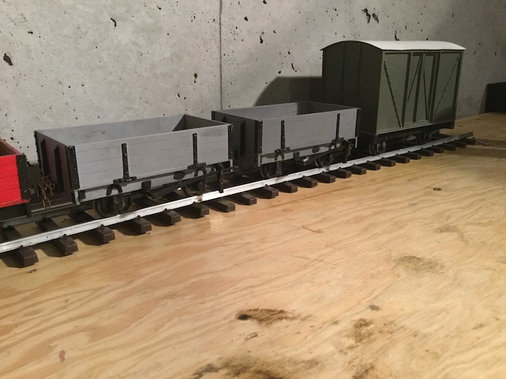

Here are some of my goods wagons. They're from IP Engineering and I've had them for years but I just finished adding frame-details to them. I still need to build some brake rigging under the box van and I have another open wagon that needs these details added.

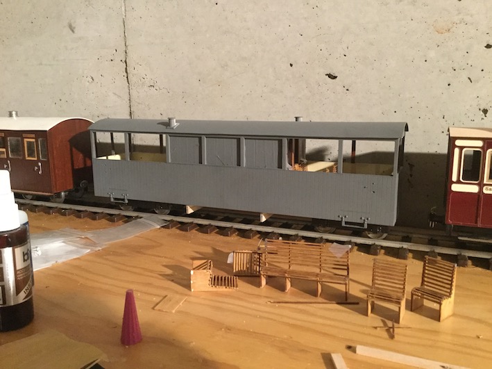

Finally, here is my "Gladstone" car from IP Engineering. I built it about five years ago, and at the time I liked the plain brown "wood" finish. However, I did add a full plush interior to the first-class middle bit, and I've decided that the whole car would look nicer in the prototype's current restored "blood and custard" scheme, so the seats in the open ends have been removed and the windows masked for painting. Also I did not like the "anti-hogging" braces in the kit- it was just very thin plywood simulating the steel rods, and in photographs it seems to me the stick-outy bits on the model are actually full timbers running the width of the car in real life. So I cut off the external bracing and have added the transverse timbers. When the paint is done, I will use brass wire to re-do the bracing rods, with some bits of aluminium tube on the middle bit to simulate the big bottle screws that tension the rig on the real one. I like this coach and am excited to see it in its new colour scheme.
That's it for now, although there are more things in my "to do" box before I'm done!

Very nice all round, Keith.
I'm a bit of a sucker for small details and the way you've painted the sweater on the guy on the roof is a masterpiece! Well done.

Ha ha, thanks, I'm glad you like the guy's sweater. I don't have many colours in my paint box at the moment and I felt sorry for him, having to go shopping with his wife in a hairy brown jumper, so I used the black, blue and white paints to give him something a little more cheerful. He doesn't look any more impressed but at least he has a nice sweater.

I'm very envious of your figure painting skills, your eye sight and steady hands are clearly a lot better than mine. I particularly like the pullover that the gentleman on the carriage roof is wearing, that must have been quite difficult. I'm afraid if I had painted that it would have been a simple single colour.
