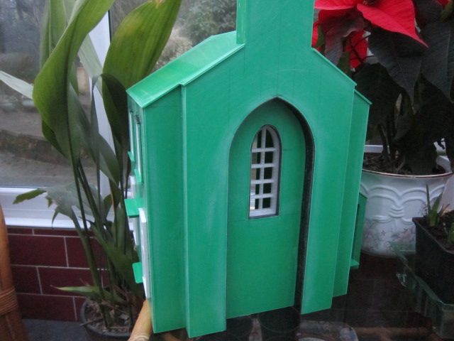

You might have noticed, I love to see a variety of buildings on garden railways and enjoy reading about construction materials. This will look good and cope with the weather conditions I'm sure. The Jackson's windows are used in most of my structures too and are fine. Also available are a selection of plastic windows and glazing which are sold at the Llanfair exhibition by a young German couple. These are excellent and give a wider choice of options. They are available on-line but my German is not up to the standard I feel confident enough to order.
If you know anyone with a 3D printer, windows can easily be made to measure, such as the ones used in my Accountant's building .......
