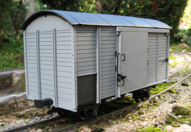

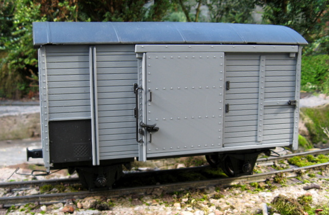

Decided I needed another van to handle the fruit traffic on the railway - so this time I bashed a Newqida box car (£18.99 + P&P).
A bit too long, a bit too continental and a bit too yellow for the PLR!!
So, after some surgery with a razor-saw and a few coats of paint......
I think it looks OK. Need to give it a good test-run (weather permitting) to check it works OK - but plenty of detailing on the model to save me the trouble.
Will weather it once the paint has fully hardened.

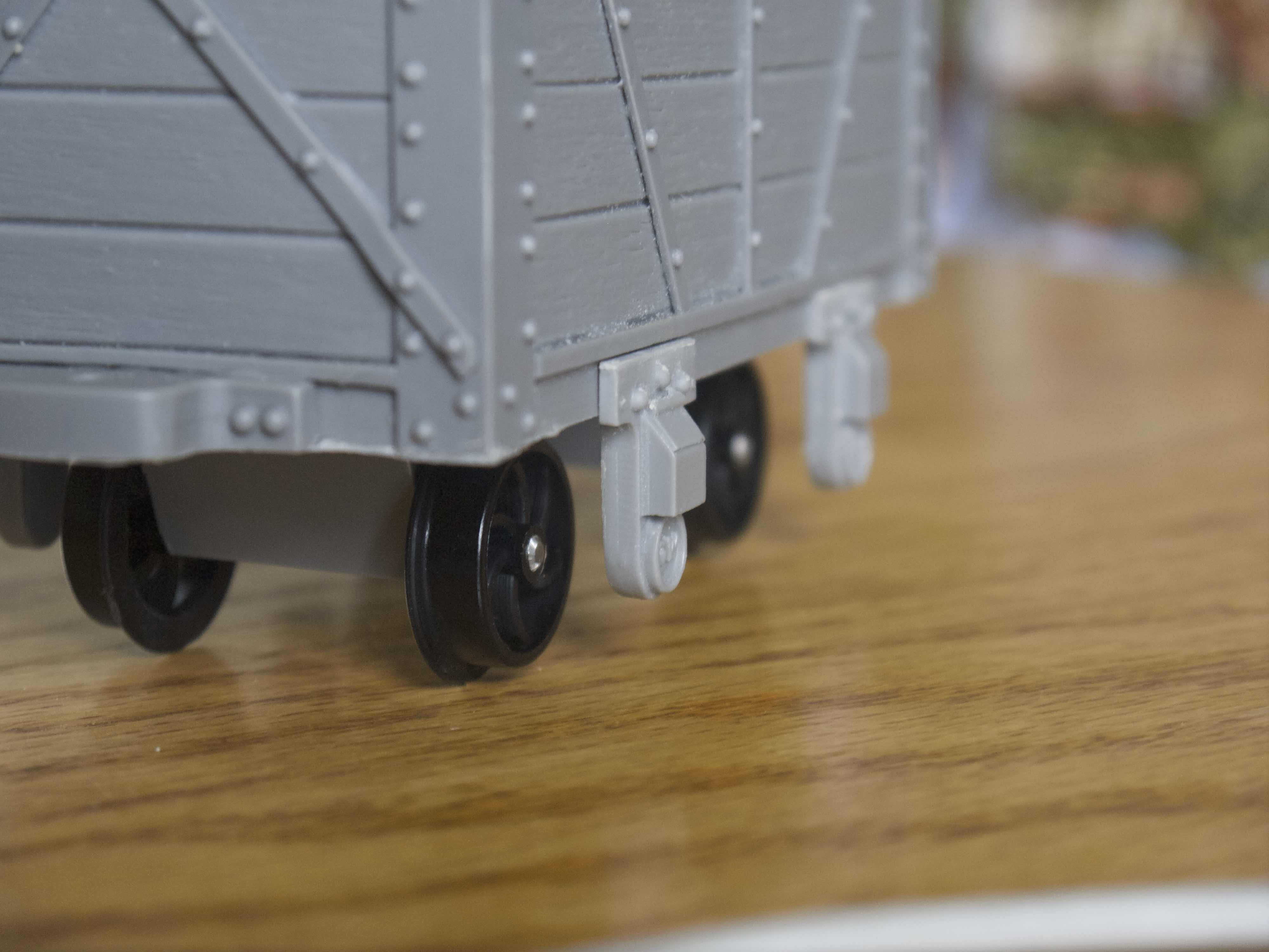

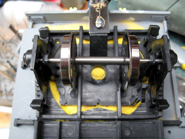

Posted: Sun Aug 26, 2018 10:44 am
Simon, I know Rik suggested it, but doesn't just putting 32mm wheels in a 45mm chassis look odd with the solebars/axle boxes an extra 6mm too far away from the wheels?
Re: Another new van for the PLR
Posted: Sun Aug 26, 2018 11:20 am
philipy wrote: Sun Aug 26, 2018 10:44 am Simon, I know Rik suggested it, but doesn't just putting 32mm wheels in a 45mm chassis look odd with the solebars/axle boxes an extra 6mm too far away from the wheels?
Accucraft get away with it on their models - I suppose it's a personal decision as to whether you can live with it. I found a spare set of Accucraft wheels and tried them. It does work, though they will need some plastic or brass tube spacers to keep the wheels centred.
Thanks Rik. I don't think I'd be happy with that look, myself, but each to his own.
I think Rik's right about it being a personal question of if you can live with it! When I assembled a Swift Sixteen 7 plank wagon I was dismayed by the gap between the axle boxes.
I thought it would bother me a great deal (it's not even as if the axle extends to the fake axle box). But even though it's far more obvious than the gap on my Newqida coaches, in fact I rarely notice or remember, and it appears frequently in my consists because I now think it's a great looking wagon and a nice little runner.
I won't know until unless I try it, but I suspect that even if wheels on the van will look odd from certain angles very low to the track, I personally won't ever actually notice it while running!

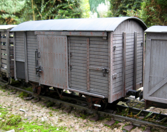

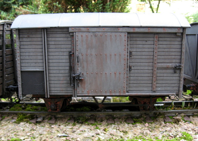

Posted: Tue Aug 28, 2018 9:36 am
Done a bit of weathering, and added cosmetic brake gear.
