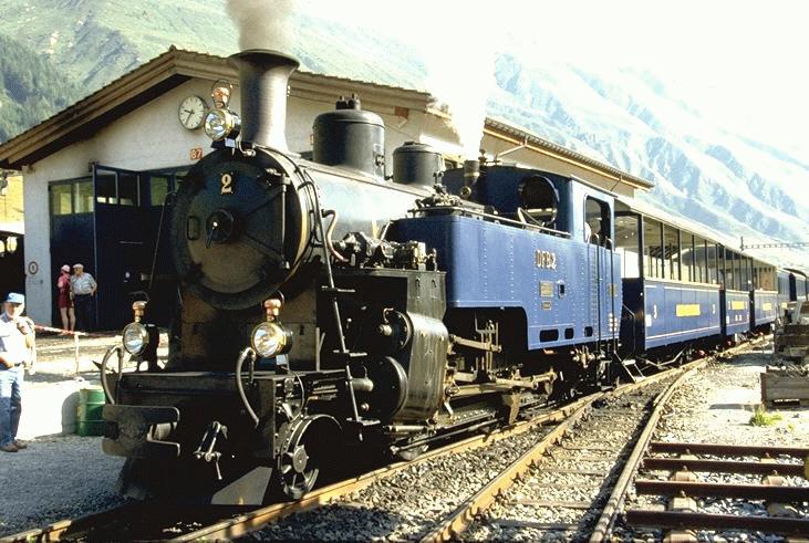

I now have to make some lamps at the front and back and then she's ready for a coat of paint. She'll be royal blue, with the handrails on her sides and roof left unpainted.
Re: Regner project
Post by tom_tom_go » Thu Apr 05, 2018 8:12 pm
Chemically blacken the roof?

Post by IanC » Thu Apr 05, 2018 9:02 pm
Nice work.
The roof would look good black. It will go with blue and set off the loco nicely.

Post by daan » Thu Apr 05, 2018 10:14 pm
I need a bit of black for some other parts as well, so I can paint the roof black as well. Since it's a darker colour than blue, I can first paint everything blue, see how it looks and if black will be better, spraypaint the roof black. That can easily be done afterwards, since the roof isn't fixed to the body. Thanks for the idea :thumbright:

Post by IanC » Thu Apr 05, 2018 10:36 pm
Yes,
As a general rule, paint the lightest colours first and darkest last.
Rule 1 applies. It's your loco. She should be painted in your choice of colours.
