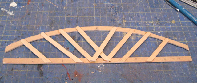

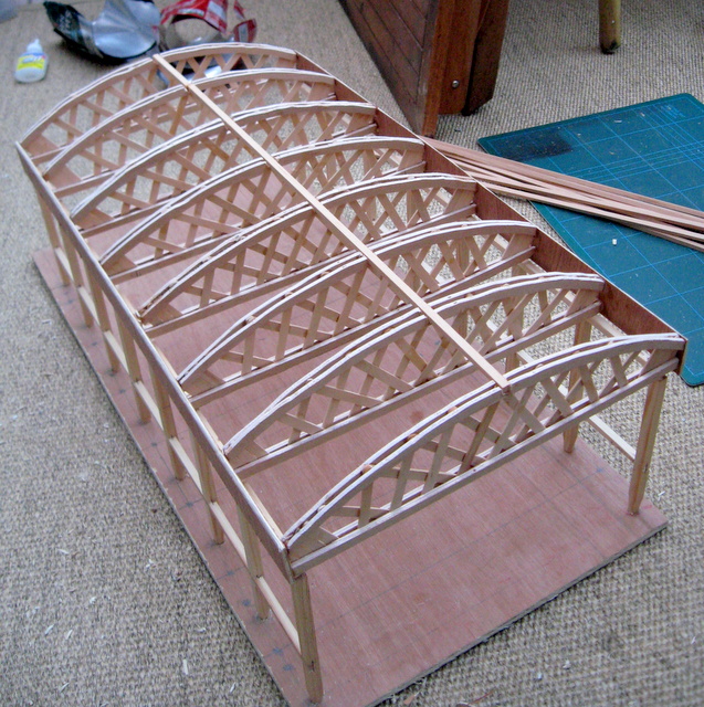

Made a start over Christmas on my latest project - the sawmill at Peckforton.
I wanted to make sure the roof structure worked out OK before doing too much to the rest of the building. My interpretation of Belfast trusses - a bit over-engineered for the size of the building, but I wanted something that looked a bit different.

That is quite a building Rik so far, how big is it?

tom_tom_go wrote: Thu Jan 04, 2018 9:44 pm That is quite a building Rik so far, how big is it?
Hi Tom
Quite small, 285mm x 510mmm. Hence the comment about over engineering. It was the largest I could squeeze into the available space, leaving room for a timber gantry for unloading wagons.

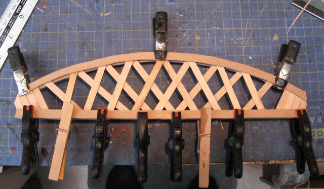

Yes, the Duxford hangers use Belfast Trusses. The curved members are cut from thin ply (very shakily).
Coffee stirrers are then glued on following a pattern I worked out from a picture of a truss.
Once all the struts are in position,
Another curved beam and flat beam are glued on top to make a sandwich
I'm afraid my fret-sawing skills ain't wot they used to be.
