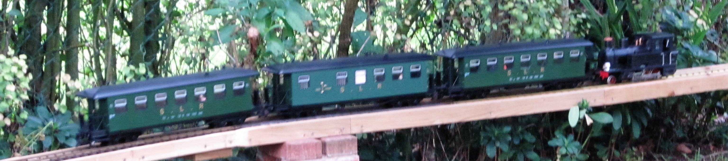

Very good Pete! I did with these in 2015 and my diary thread is here :-
https://gardenrails.org/forum/viewtopic ... 3&start=30
However, my photos have been 'photobucketed'
- could reupload them on this thread as a guide if welcome?
