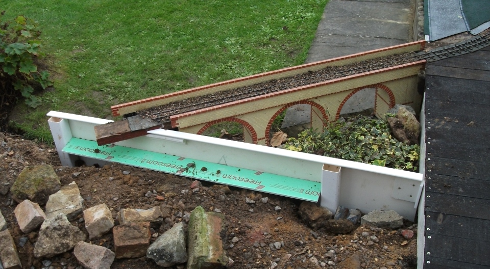

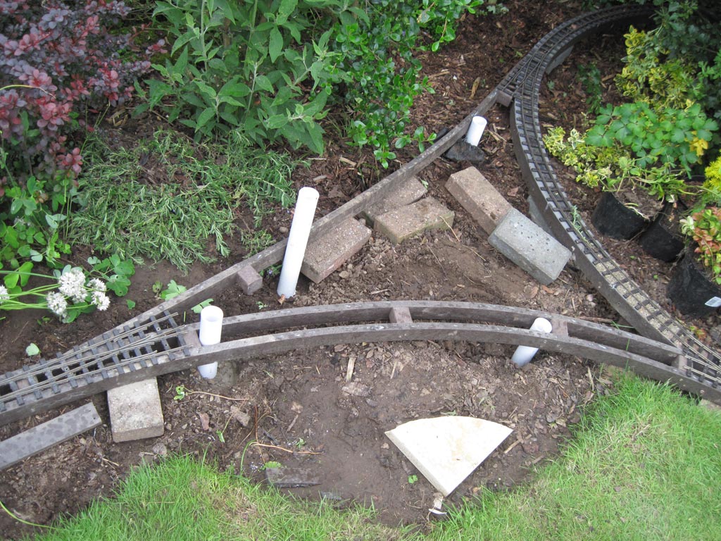

We started with a couple of rectangular areas using plastic rain water pipes for posts with mainly timber (with just a few bits of plastic) structure and timber board decking.

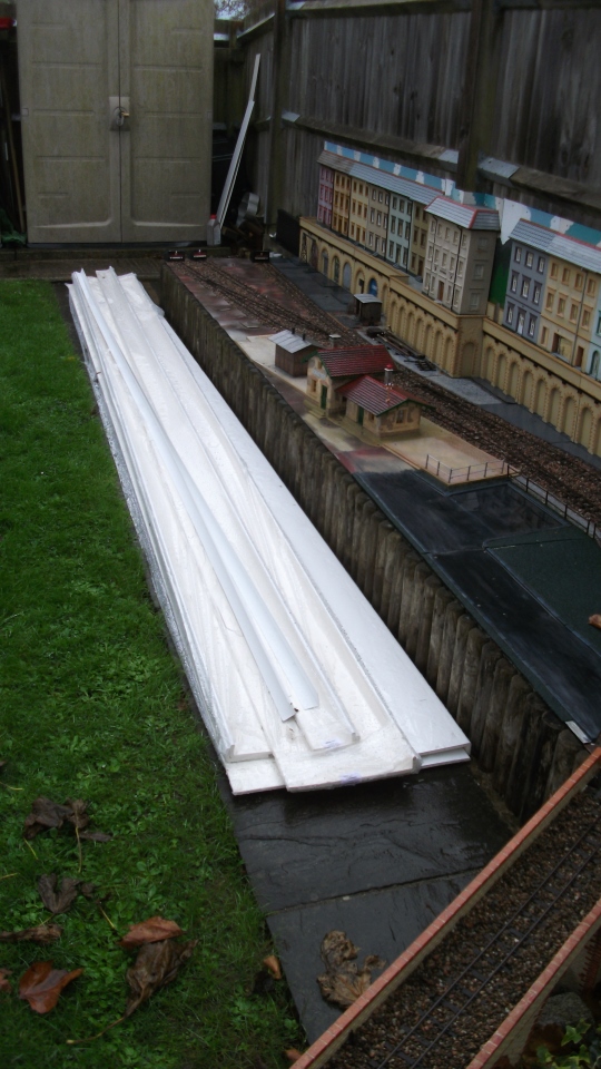

The Material was ordered on Monday and turned up Thursday, but a couple of lengths of one item was not what I had expected, so has been changed - I thought I ordered a couple of lengths of 35mm x 35mm x 5mm thick angle section - I had been told that 35mm x 35mm was not available but what turned up was 40mm x 40mm x 2mm thick section - this was just a corner flashing and not a suitable structural member. I was then told that no angle sections 5mm thick were available so I substituted with 100mm deep fascia, of which I had already order several lengths. LESSON - be very sure of exactly what you are ordering.
This is the stuff shortly after delivery. Being 5 metres long, it takes up a bit of space but just fits in the length of the garage.
Drawing was refined (improved) to ensure that none of the 9mm thick board has to span more than 450mm in any direction, and all the edges (save for some small corners round the ‘trees’) are supported. Also the use of 35mm x 35mm angle has been replaced with 100mm fascia.

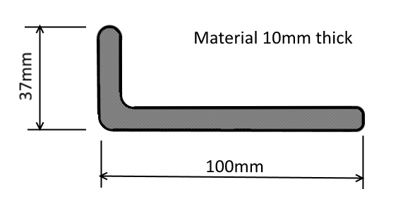

This is a section through the 100mm deep fascia. The 300mm deep fascia has the same 37mm deep flange.

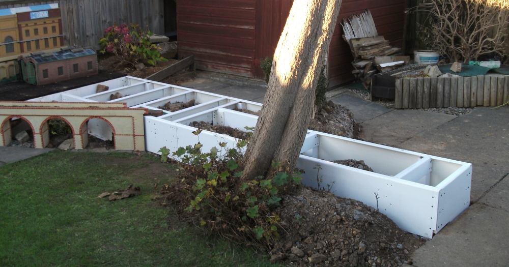

More external and internal framework has been happening.
The more the parts come together, the stronger it gets. But still great care is needed to keep everything flat and square.
All the outside square parts are now in place, and I will be trying to get most of the internal members in these areas done to give a good rigid base before starting the angled section round the little bushes (behind tree).

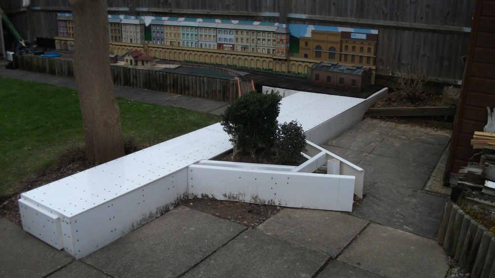

Works are continuing steadily, with the major straight part now all decked and the first bridge abutment structure made.
Leaving the most awkward part to the end is not always a good idea, but at least I am more experienced at working with the material, so I can see through any problems without delay.
