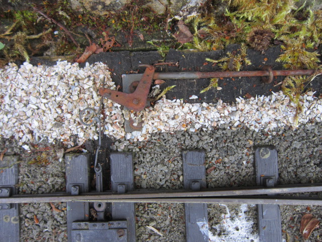

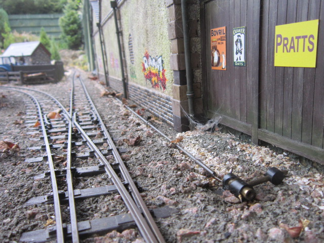

I have two types of distant point control in use and I am very satisfied with both....
One is a stiff wire running through screw eyes, surface mounted and in a straight line alongside the track. This is controlled by a point lever which operates a crank. It is at least four metres long and works perfectly. My only criticism is that it will not allow a train to trail through if the point is set against it....
The second is operated by a Bowden cable, (bicycle brake cable) and is buried underneath my baseboard and gently curves several times to reach the point 2.3 metres away. At one end I have a push/pull knob (no lever) which will easily push against the blades. Also, a train can trail through the point if set against it.
Both work well and I'm quite sure an even longer cable would perform the task. No additional springs have been fitted to either.

Posted: Wed Jun 28, 2017 8:24 pm
Andrew, the 'stiff wire' was my simplistic way of describing the system.... it is a series of brass rod sections soldered together with tube joints. There might be some steel in the system too but I can't remember in detail... my age you know!
As far as expansion is concerned, there hasn't been a problem at all. You can see an omega loop at the crank end so if any movement occurred that should accommodate it.

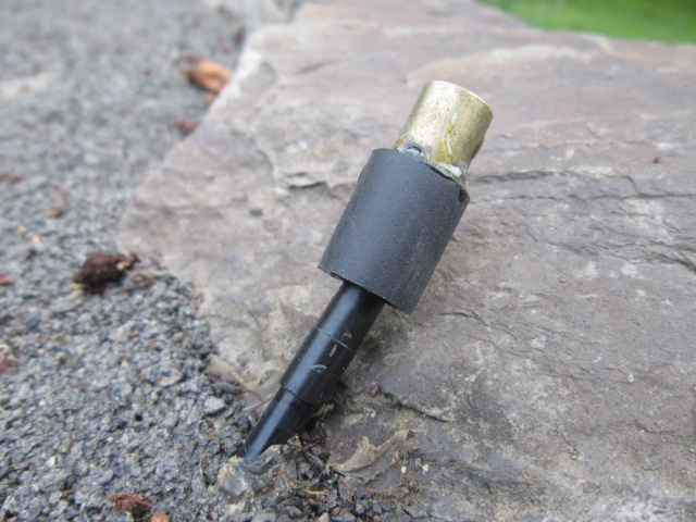

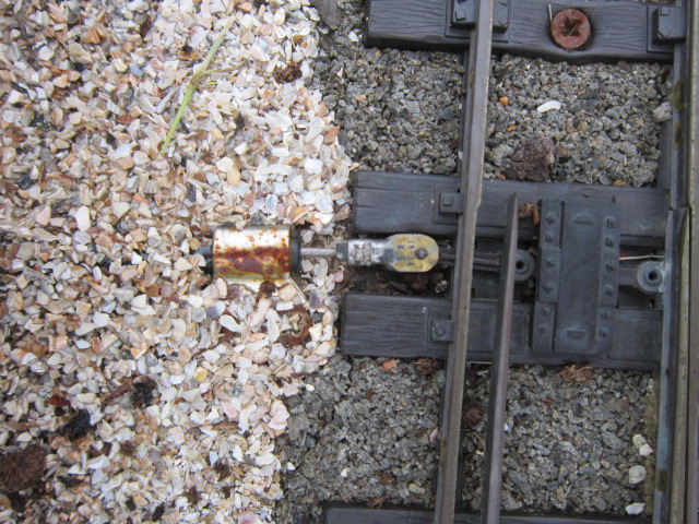

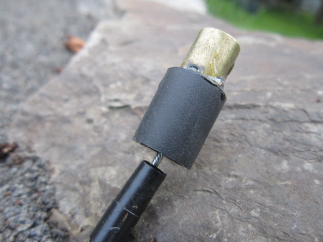

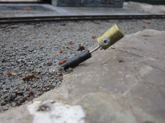

Posted: Sat May 02, 2020 7:30 pm
Soar Valley Light wrote: Sat May 02, 2020 6:27 pm
Do you think the Tenmille point lever would drive the points through a Bowden cable?
Easily.... you would need to make a connection between the multi strand cable and the point slide-bar, but that can be worked out I'm sure. At the point end of the cable I used an electric cable crimp with a small hole to pass over the tie bar upstand (?).... see picture. Not sure the full throw of the lever would be required though, so stops to prevent full travel could be used.
The cable itself will push equally as well as pull.
