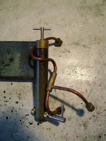

Ah, OK, so the rear engine doesn't have any superheat. There are two modifications I have done to improve the running of mine. First was to replace the exhaust pipework with larger diameter tube and throw away the exhaust pipe in the smokebox. The second was to rearrange the lubricator pipework, from this:
to this:
The change has finally given the rear engine the lubrication it was needing and it improved power and speed hugely.
to this:
