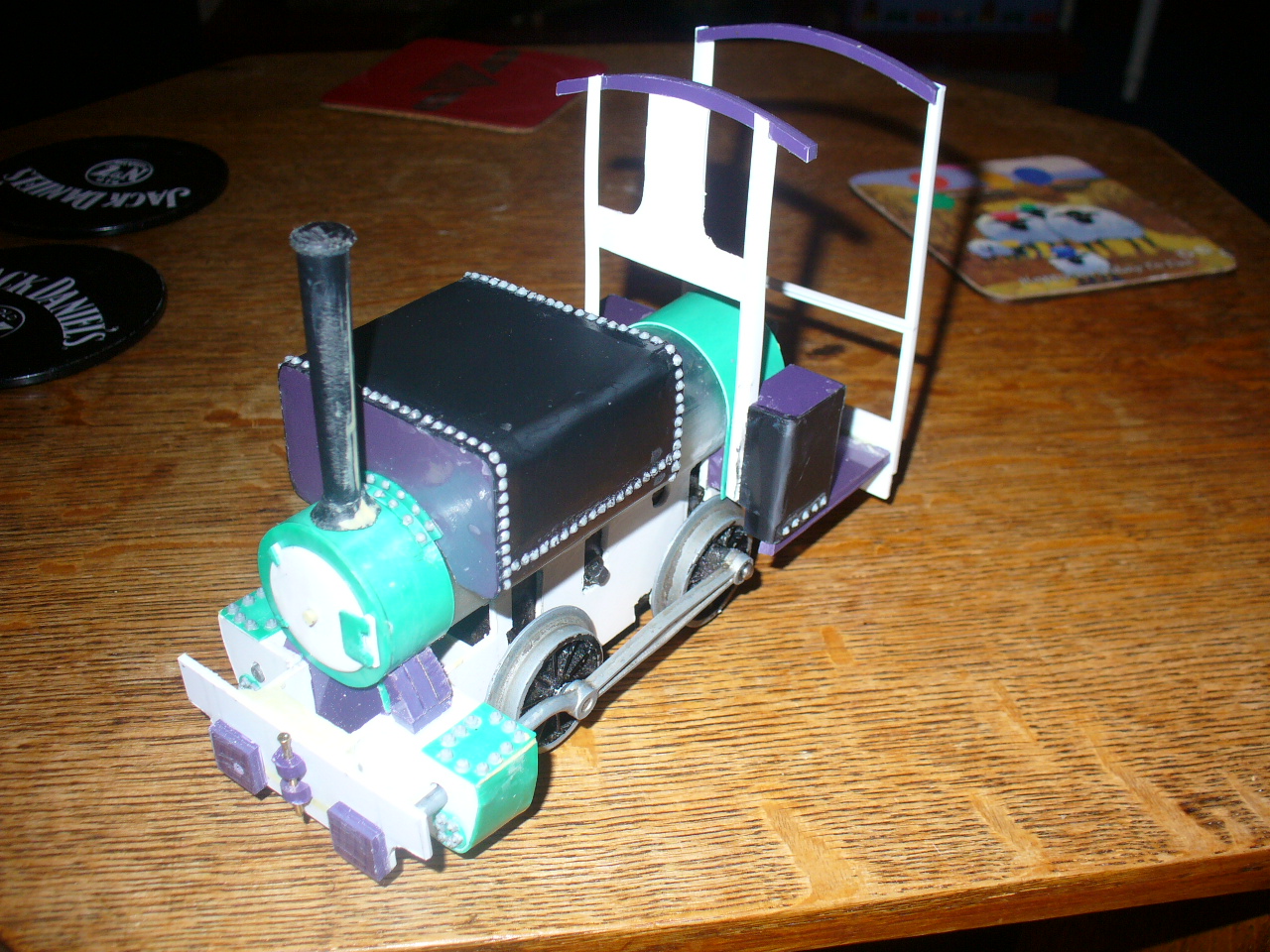

So, to make the saddle tank I cut pieces to make a frame of the correct shape and size...
Once I was sure that it would sit properly I skinned it in thin plasticard. The next job will be to fill any small gaps with milliput and then carefully add rivets in the appropriate places around the tank before gluing it in place.
Here it is with the saddle tank and funnel propped in place. I've also added the bits that go between the smokebox saddle and the cylinders since the last post. Just out of interest can someone tell me what are those called?

Post by pskipper » Thu Apr 13, 2017 8:47 pm
Not the best of pictures but more progress has been made, it's been a rivetting couple of days :lol:
Next job is to turn the dome which will happen sometime next week all being well...

Post by pskipper » Wed Jun 14, 2017 8:23 pm
Dome turning went a little wrong as I cut the boiler curve a bit too high resulting in a shortened dome. However I still had enough of the PVC bar to make a second dome so that was okay. I've finished off the cab roof with a bit more bracing than a real Wren and sprayed a coat of primer on to see where I needed any remedial filler work. It was at this point that I realised I hadn't made the cap for the water tank which is why it is unpainted. Loco is being inspected by Mr Thompson who, following a little surgery to his arm and filling in the hole in his back, will be the driver.
I was going to make some discs to blank out the wheel spokes and make them more wren like but I'm keen to move on to some other projects so I'll get it painted and they can wait for some time in the future.
