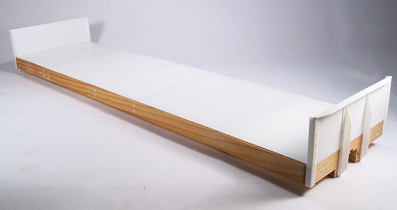

I briefly flirted with the idea of building the bodywork in metal, but eventually decided on polystyrene sheet, with punched rivets. I was still concerned how strong a polystyrene sheet open body would be in this scale, so I built a couple of ends and fitted them to one underframe as a test. The photo shows the first underframe fitted with a polystyrene floor, with the ends fixed in place.
The end is glued to the wooden under frame with contact cement and solvent was used to glue it to the floor as well. This was rigid enough to encourage me to start on a set of sides. The result after a couple of weeks punching rivets into polystyrene sheet and assembling all the bits resulted in the basic body shown in the next photo.

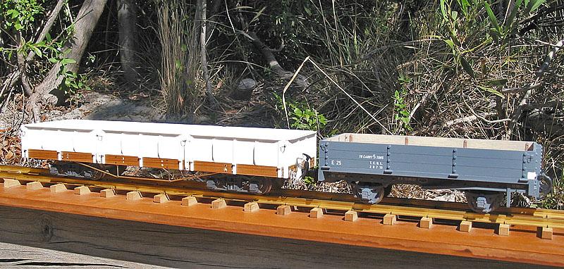

This photo shows the model with a four wheel wagon for comparison. The VR ng original would sit much lower than this, as the bogies were recessed into the under frame, with the flanges just below the floor.

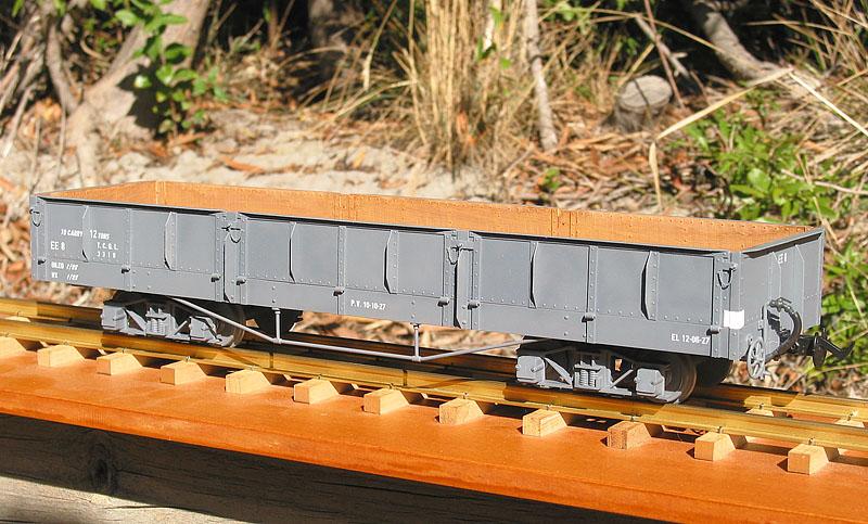

The next photo shows one of the models after leaving the paint shop. The TVT grey is the usual industrial rapid enamel applied by airbrush, with my own waterslide decals. Aust. open wagons weren't painted on the inside, so the interior was dry brushed with various shades of rust to resemble the usual condition of a VR ng wagon.
