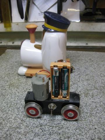

The motor and 4WD has been fitted to the chassis.
The battery holder and switch fitted.
Switch extension fitted.

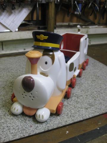

Finished.
Test run.
Video of test run at.
https://youtu.be/oG4YJ6E7Q6o
