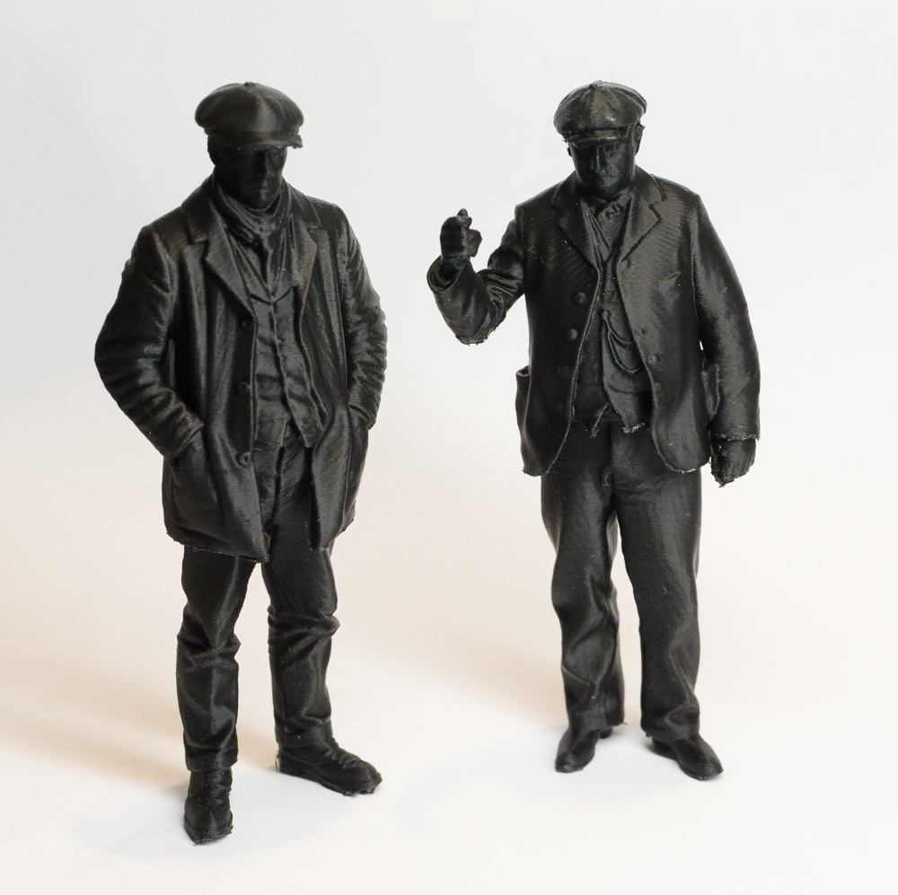

In the real world;
I've just finished printing one of Dursley's loco crewman and it looks amazing. Photo to follow when I've finished getting the supports off. The back of the coat is a particular problem because of the level of detail. I think I'd take some time to fill in the gap between coat and body if I were to print another one.

As promised photos;
Dursley's figures printed at 0.06 layer height with 0.2mm nozzle with Sunlu PLA+2 filament.
Not great photos with the exposure pushed to show the detail. The black, slightly glossy, filament shows up layers more than a matt filament would. The white marks are where supports have been cut off, but there's room for improvement on that. I hope that when painted many of the flaws are a lot less obvious.
Thanks again for uploading these files :D

They’ve come out really well Paul, even better than I would have anticipated from a filament printer.
