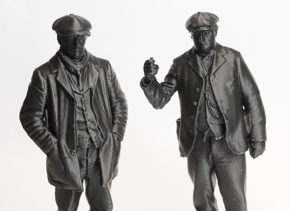

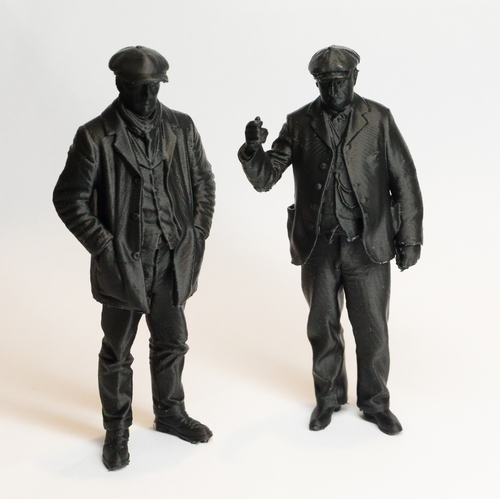

As promised photos;
Dursley's figures printed at 0.06 layer height with 0.2mm nozzle with Sunlu PLA+2 filament.
Not great photos with the exposure pushed to show the detail. The black, slightly glossy, filament shows up layers more than a matt filament would. The white marks are where supports have been cut off, but there's room for improvement on that. I hope that when painted many of the flaws are a lot less obvious.
Thanks again for uploading these files

They’ve come out really well Paul, even better than I would have anticipated from a filament printer.
