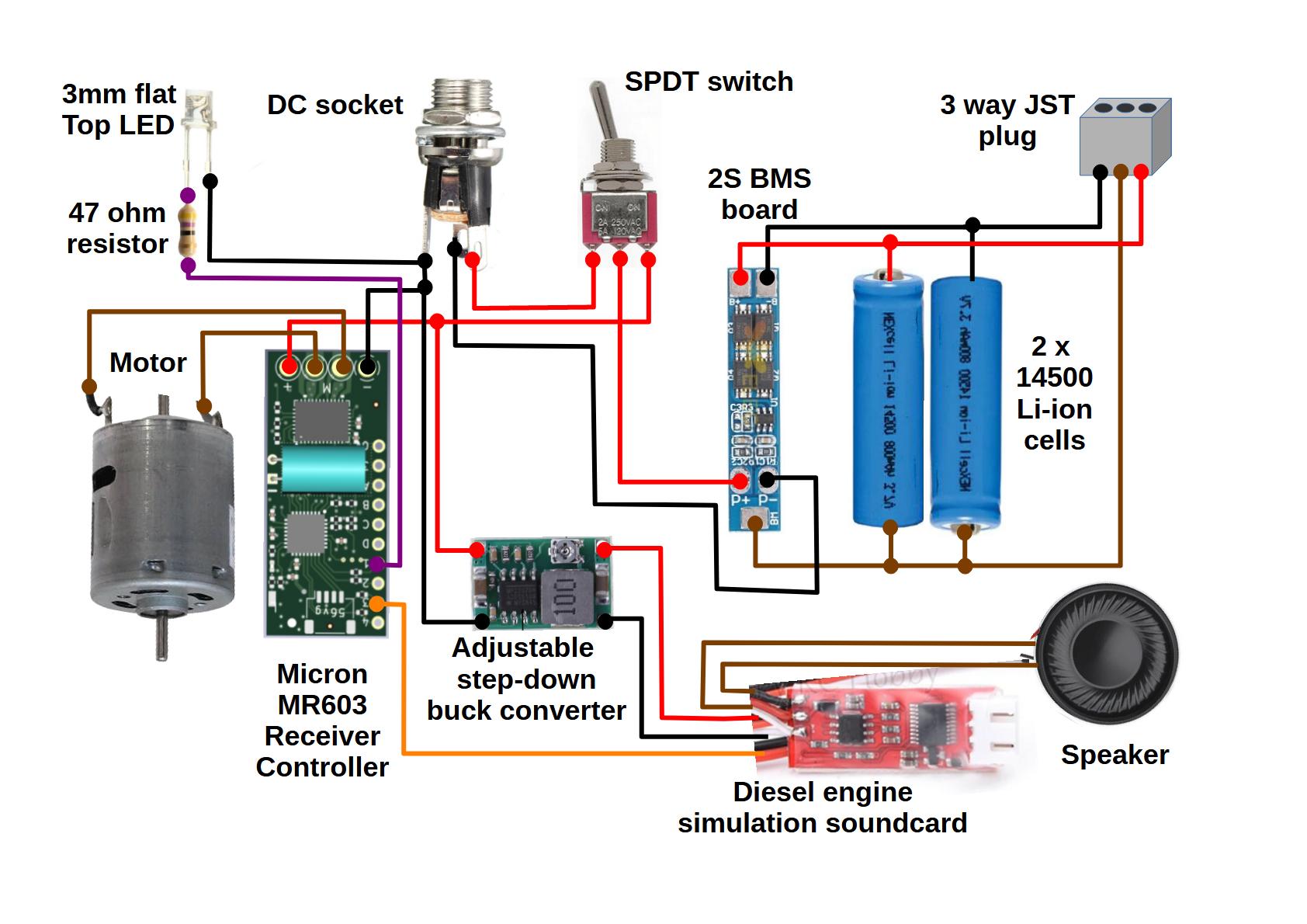

Re: Cheapo diesel sound card
I've powered my soundcard through an adjustable step-down buck converter set to 5v
EDIT2: Now corrected label for switch and added a 47R resistor between P1 and the LED

BTW, 2 questions... what's a DPDT Socket ??
( Sorry, couldn't resist it!
More seriously, what do you use to produce the lovely schematic diagrams like this one. It obviously doesn't take all that long to do, given the response time from my post to your reply.
Yes I've got some of those V.Regs but if it will work off +/- 7v, I can avoid that complication and extra wiring.

That's pretty much the wiring I used for mine, but without the buck convertor, the sound card I bought can handle 2 x li-ion batteries (8.4v) with no issue so just run them direct from the power input of the RX.

That's useful to know. I just assumed it would require 5v-steves- wrote: Sun Mar 31, 2024 9:49 am That's pretty much the wiring I used for mine, but without the buck convertor, the sound card I bought can handle 2 x li-ion batteries (8.4v) with no issue so just run them direct from the power input of the RX.

Ooops! I copied and pasted the text box but clearly didn't edit out "socket" from the original. Isn't it amazing how easy it is to miss mistakes like that. I don't think I'll be applying for a proof reader's job in the imminent future.philipy wrote: Sun Mar 31, 2024 8:54 am
BTW, 2 questions... what's a DPDT Socket ??![]()
I use the draw package in Libre Office (formerly Open Office). The freebie alternative to MS Office. I've already written up the HGLW loco mod on my blog and created this wiring diagram for that. I'd say it takes 30-45 mins to produce one of these.

PS. It's probably advisable to protect the link from P3 to the soundcard with a 1k resistor, or maybe even a 4.7k resistor if you're powering the soundcard with 7.4v
PS - Now corrected the label for the switch and added the 1k resistor to the wiring diagram (see above)

I am no electrician nor technical guru, but won't putting a resistor on the signal wire reduce the range of the signal input thereby limiting the throttle range of the soundcard?ge_rik wrote: Sun Mar 31, 2024 10:25 am PS. It's probably advisable to protect the link from P3 to the soundcard with a 1k resistor, or maybe even a 4.7k resistor if you're powering the soundcard with 7.4v

Thanks chaps, it is now working!-steves- wrote: Sun Mar 31, 2024 11:30 amI am no electrician nor technical guru, but won't putting a resistor on the signal wire reduce the range of the signal input thereby limiting the throttle range of the soundcard?ge_rik wrote: Sun Mar 31, 2024 10:25 am PS. It's probably advisable to protect the link from P3 to the soundcard with a 1k resistor, or maybe even a 4.7k resistor if you're powering the soundcard with 7.4v
PS - Now corrected the label for the switch and added the 1k resistor to the wiring diagram (see above)Would a diode help to stop any current getting back?
Please remember that me and electronics don't get on all that well, so I am really only guessing.
Had a 'mare with the programming because the third input was set at "3 flashes" and nowhere in the instructions does it say how to reduce them. Eventually by trial and error I worked out that by inputting all the way up to 12 flashes it then goes back to 1 flash. It never ocurred to me to go that far, I assumed it would stop at about 7 or 8!
Soooo, It is way too loud, actually scared the dog ( really!). I tried putting the resistors in as Rik suggested, but that reduces the noise to a single rythmical "pop" or cuts it completely - which I think is what Steve is suggesting?
I was about to try putting a pot in line and fiddling to see if I could find a loudness vs sound, sweet spot, when I saw Steve's post.
EDited to add: I've just tried a 1k pot and it's barely off the stop when the sound goes from 'proper' to 'pop pop' with nothing in between.

Just take a breath, Guys....
These cards are fed with a variable width servo pulse, not a logic '0' or '1', so the 1k or 4k7 resistor is not required.
Adding resistors here will not reduce the sound-level.
To add a volume control, you could add a 100 ohm pot across the speaker output, and the speaker connected between the wiper (centre-connection) and the 'ground' end of the pot.

Thanks Phil. Breathe taken...Pot inserted.. works like a dream! The dog even came in whilst it was on and didn't run away this time!Phil.P wrote: Sun Mar 31, 2024 2:46 pm
You're a star.
