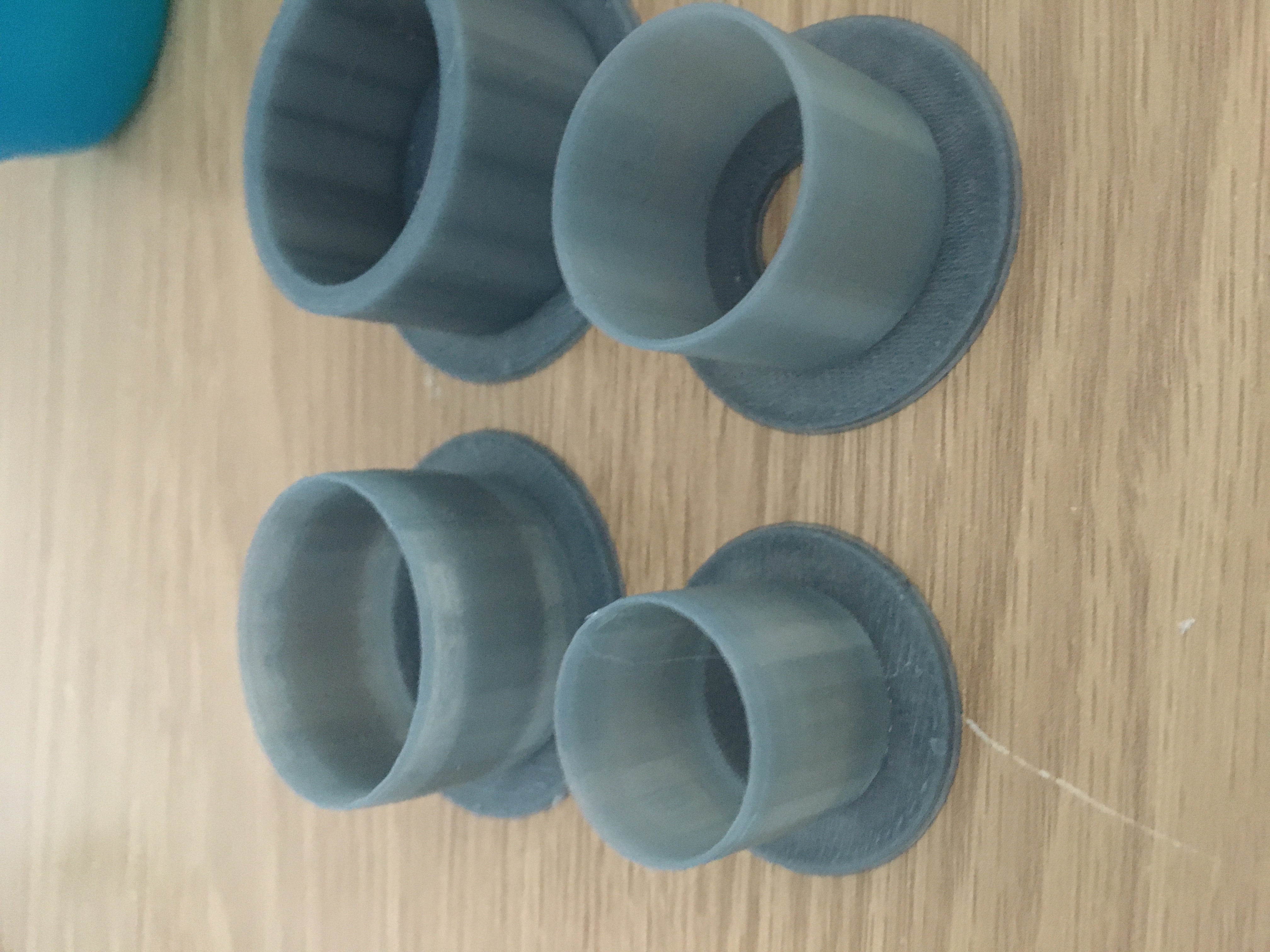

I have done lots of prints on my machine, some which have turned out good and some disasters. But I have soldered on and I have now got a little bit better, only just mind, with doing some programming with TinkerCad. I still need to master the gate and I need some hinges for it, so with that in mind I thought it would be good idea to try and make a hinge. The one that ge_rik has done on is blog shows you how to do it. Thank you Rik, you have been so patient with me. I do encourage you to play with TinkerCad, it is a brilliant bit of software and though it may have it's limitations, I really wouldn't know yet if it has, by playing around and using it you can do a lot with it, some great and some not so great. I am done some fairly average things with it. Like a couple of paint pot holders. I don't know about you, but when I use my paints, the pots I use are not really that suitable with them either being too big or too small and not very stable.
So I tried various things with TinkerCad and these are what I did with them.
I first started with these to see what different setting came out. The first one is on the left. The photos are not the best I have done sorry. It came out with a thin wall and lots of flats on it. I looked at the setting on TinkerCad and realised that there was the individual setting, so I made the wall thicker and with less flats. The next photo is a group of 4 different print settings.
The bottom right is the setting I ended up using for the print.
Then I needed to get the inside diameter for two of the paints pot sizes I use the most, which is pretty straight forward when you find out what the outside diameter of each paint pots and then the thickness of the wall and add that on.
This is what I have now got.
Has you can see they still have the rafts on which aids with the stability of the pots. I did try one with out any raft and it just came off the printer just by the slightest touch..So I ended up with just a ring.
It's not a problem, I can always find a use for it...

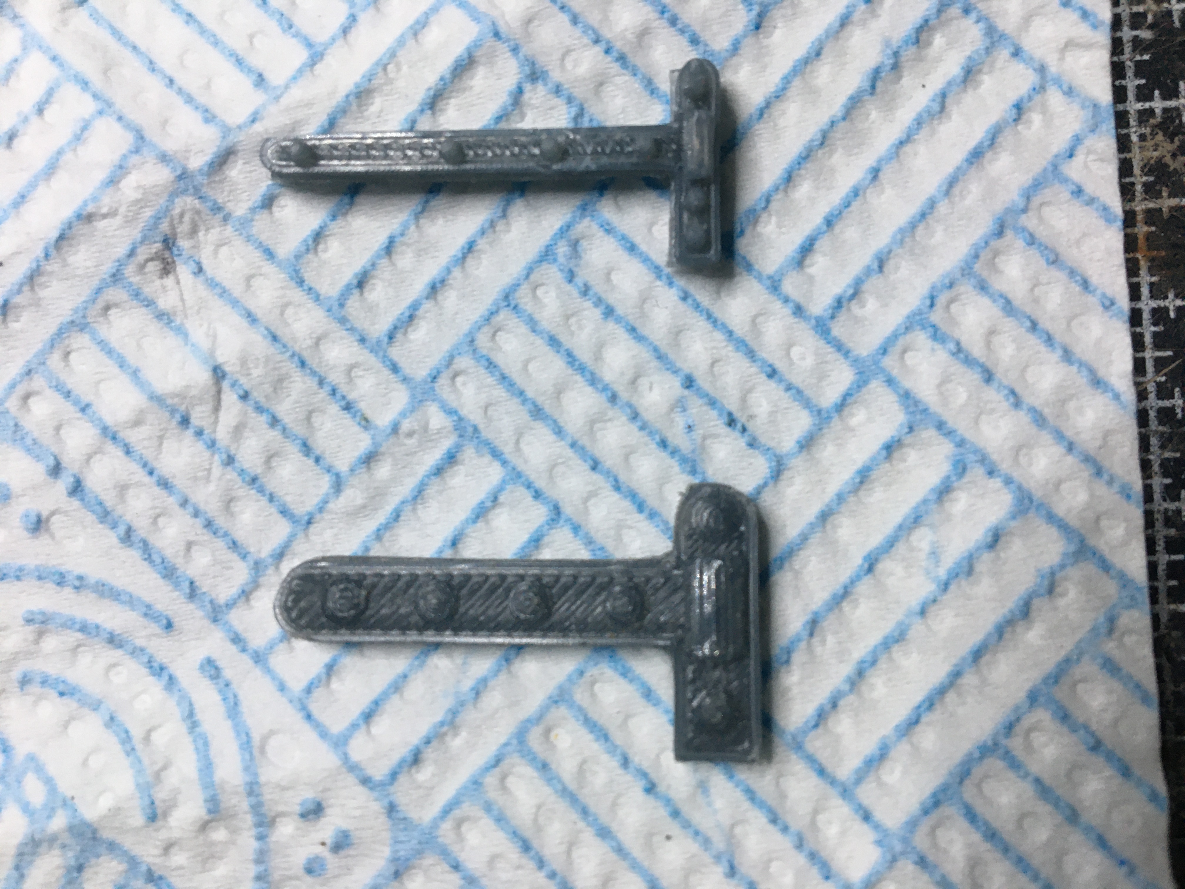

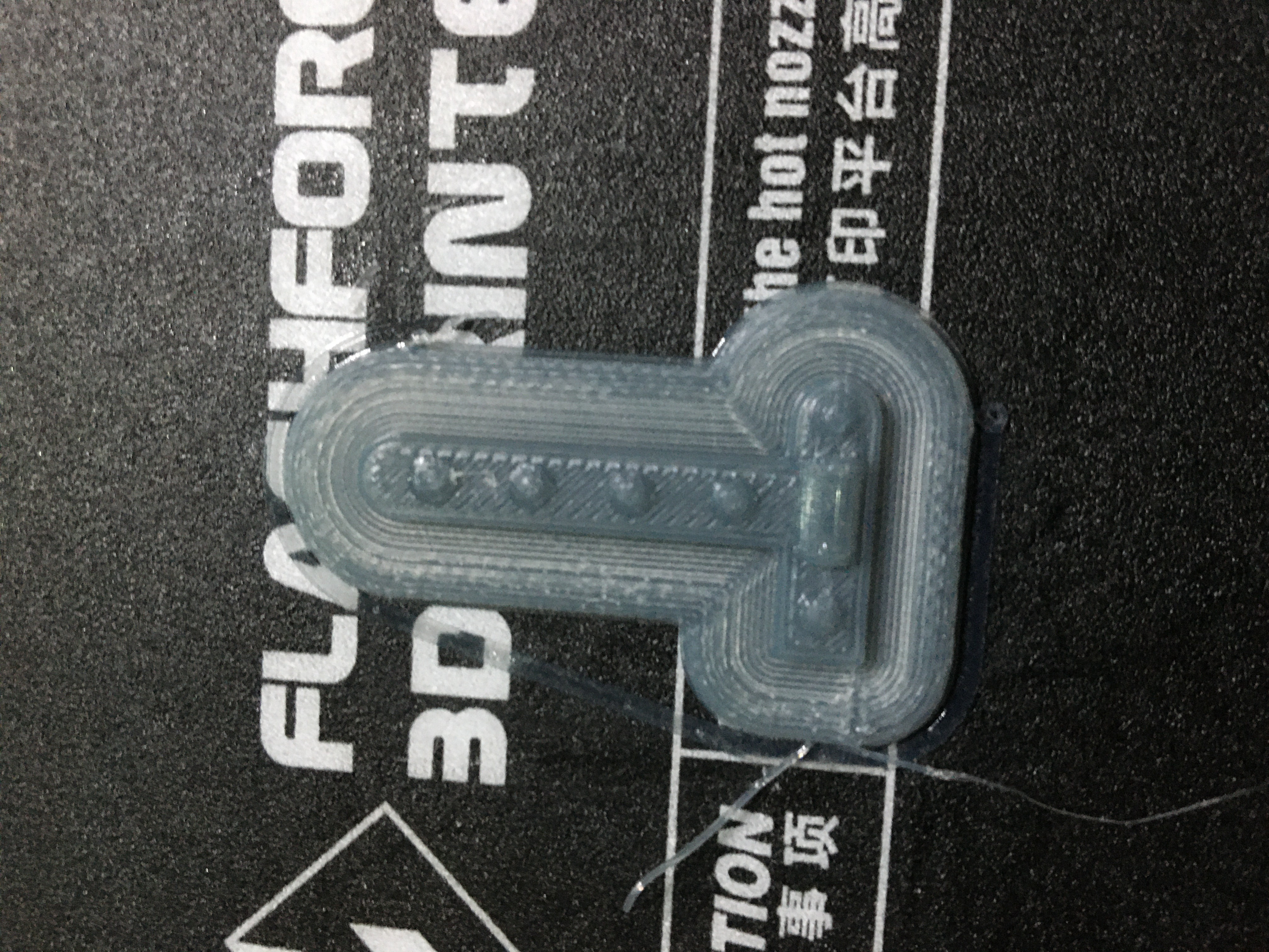

I now also have an hinge of sorts. I did try doing Rik's which he has put on the forum, but it turned out somewhat wrong. It was probably my fault with the understanding of the setting, but the rivets came out with very sharp points at the top, I know that's me
stupid....It also was a tad thin, so I played around again and this is what I have now. There is only one rivet on either side of the hinge plate, but that can be altered. The main thing is I have managed to print a hinge...
There is a decency warning with the first photo, it's just the way it printed.....
The second photo shows the one on the left, which is what I have come up with and the one on the right is Rik's setting, or my interpretation of it, sorry Rik.
Again on Rik's also, one of the rivets came off really easy, I guess though that is because I didn't have it on the main body of the print.
Anyway onwards and upwards, hopefully.

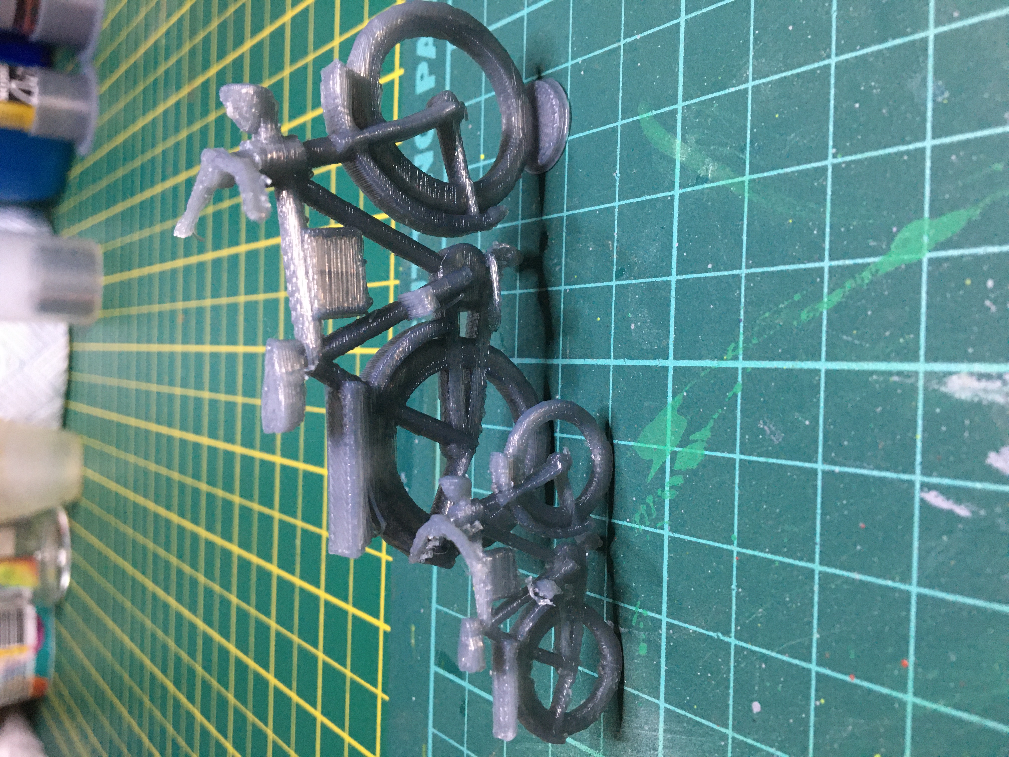

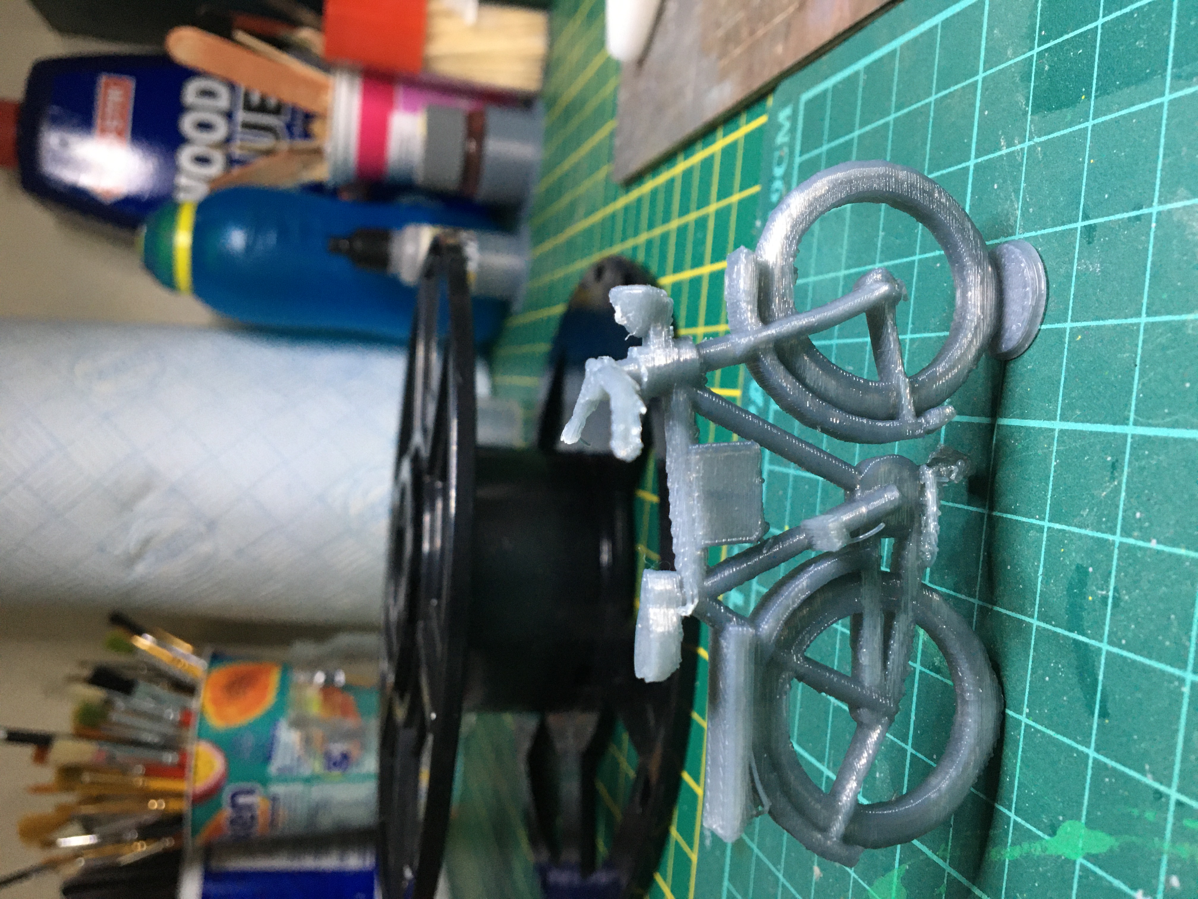

I did get to print the Bike also Boris. Although two problems arose from them. Firstly, the original small scale print I did put supports and they were a bit of a pain to take off. 2nd, I scaled it up to 140% and it was a lot better, but the handlebars and one of the foot pedals were a bit thin, the pedal actually broke off. Also it printed with two rafts on the bike wheels, which helped with getting the print off the bed and I kept one on to aid with it standing up.
Maybe the handlebars need to have supports, so I will try it again with the supports on, although is the a way of just having supports where you need them and not covering all of the print
Close up, they do look a bit rough, well a lot. But from a distance they look ok. I don't know how much it cost to print them, I only used about 1 meter of filament and it took about 45 minutes approximately.
I forgot to write down the time and material used....

2 options for this in Flashprint that I'm aware of:FWLR wrote: Wed Jan 13, 2021 8:05 am Maybe the handlebars need to have supports, so I will try it again with the supports on, although is the a way of just having supports where you need them and not covering all of the print![]()
Put supports in manually by going into 'supports' and instead of clicking on the "A" for Auto Supports (at the top) use the '+' for Add (on the left) to add individual supports - once you have selected this you can click on your model wherever you want to add supports.
Put supports in automatically in the usual way, then use the 'x' for Delete (on the left) to remove individual supports - once you have this selected then any supports you click on will be removed.

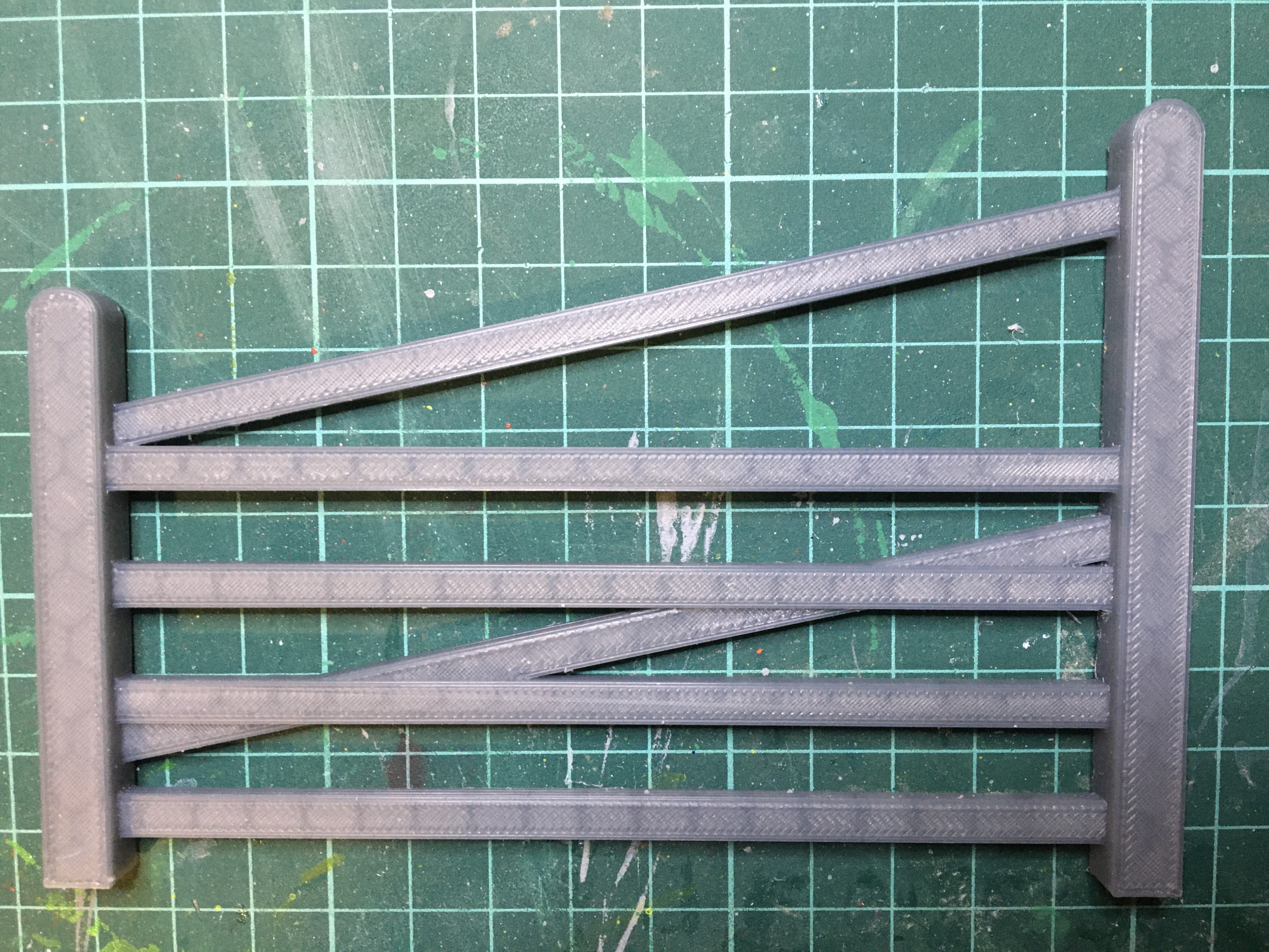

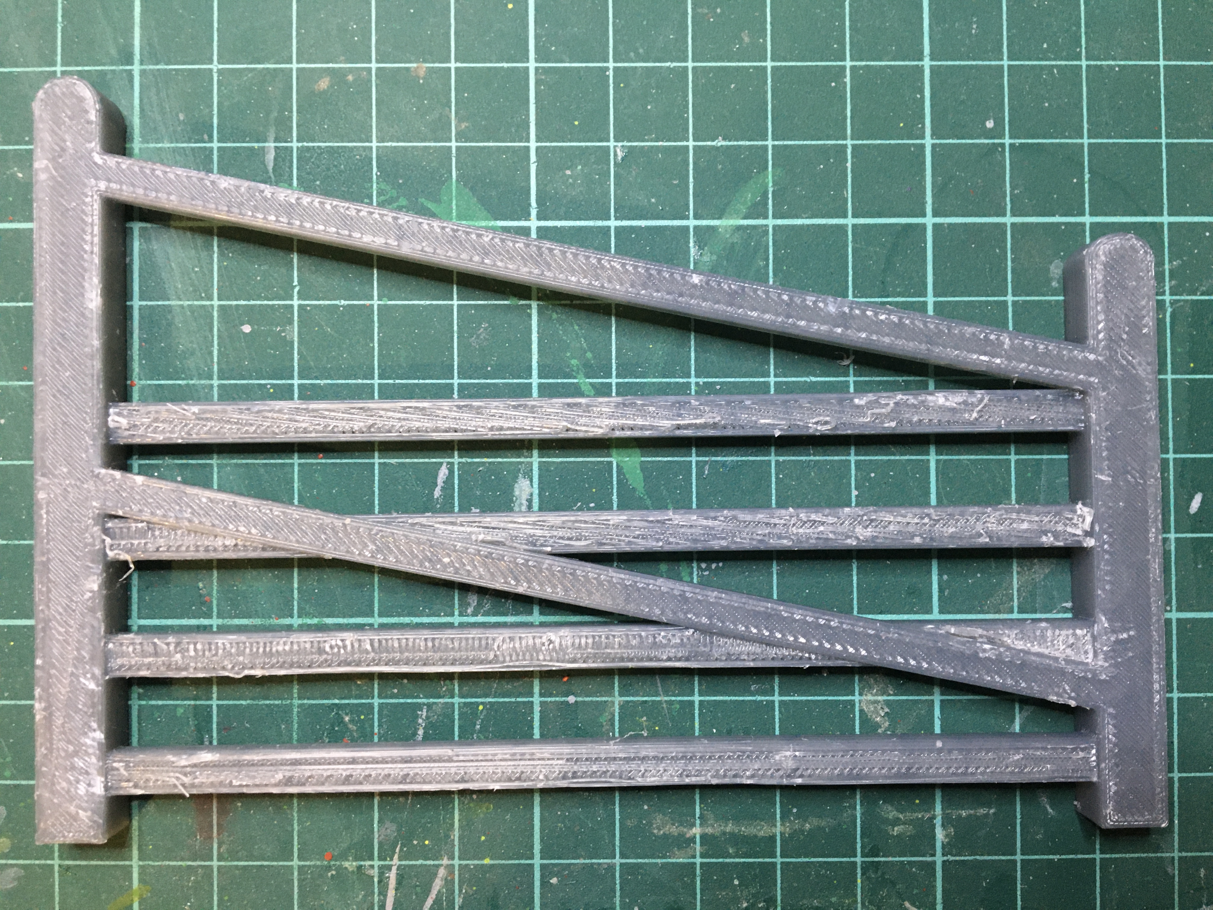

Now I haven't been to good lately and I am going to see the heart consultant at 1.45pm about these blooming pains I have been getting again just lately. So the 3d work has had to be put on hold, well it was curtailed somewhat. I have been far too long on the laptop, looking at things on Thingiverse and other stuff.
I have though managed to build a gate, it took me two and halve weeks. Anne was getting very upset with me, so I needed to limit my time on it. Because I haven't been working on TinkerCad much, it's slightly difficult trying to remember how things work on it.
Anyway here it is.
Finished on the printer. I haven't done the hinges though. I thought I would see how it turned out.
Now with most of the raft off.
The second photo is the bottom of the gate. You will see I made a huge "cock-up" by printing it flat. Because I haven't got the two planks that are at 45Deg level with the posts, the raft has been a bit of a pig to get off. There is still some left on, but has this is a trial it will do.
The hinges need to go on, but I will need to get the planks level with the posts. I know I think that the posts need to be the same thickness as the planks don't they.
There is the question of the infill also. You can see it really plainly. Don't know what to do about that.
This will have to do for now until I come back from the hospital later on, that's if I am up to it...
Anyway here it is.

The size of the gate is,
Length 134mm
Longest post height 92mm
Shortest post height 71mm
Plank width 5mm
Space between planks 9mm
I am thinking is the correct scale. It was all guess work for me....

- Posts: 8004
Re: My Flashforge Printer Journey.
That looks pretty darned good to me Rod. Well done!
Now you've started you'll soon be on a roll. Won't be long before you start drawing and printing your own rolling stock. How about the Flying Scotsman?
