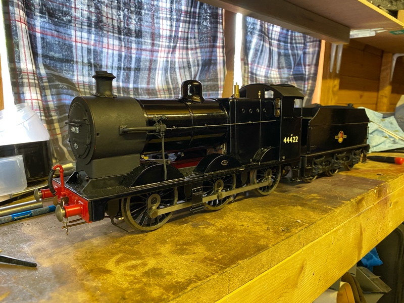

Post by Garethh » Mon Sep 20, 2021 1:42 pm
Painting turned out to be a bit of a pig, but it’s finally done, not perfect but it’ll do…
I’m sure I’ll find bits and pieces to do, but for now she’s done and ready to hit the track

Painting's a funny thing, innit? One day it goes well, the next might be a disaster. That's come out beautifully, you ought to be proud. :salute:

Old Man Aaron wrote: Wed Sep 22, 2021 3:10 am Painting's a funny thing, innit? One day it goes well, the next might be a disaster. That's come out beautifully, you ought to be proud. :salute:
It really is, some bits came out spot on straight from the can, others needed much flatting and polishing to get to an acceptable point, despite the same process being used! I’m happy with it, but there’s room for improvement next time…
