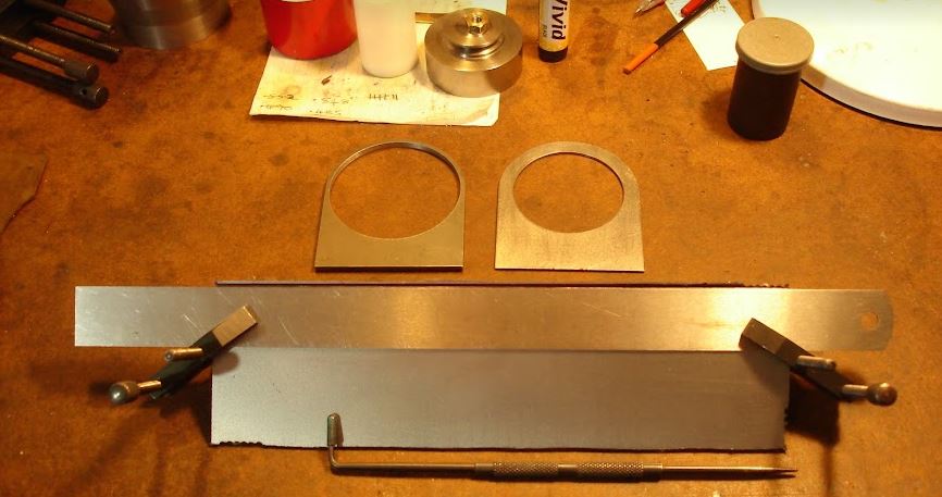

This end-of-workbench clamp makes sawing sheet a pleasure
Best wishes,
Dave

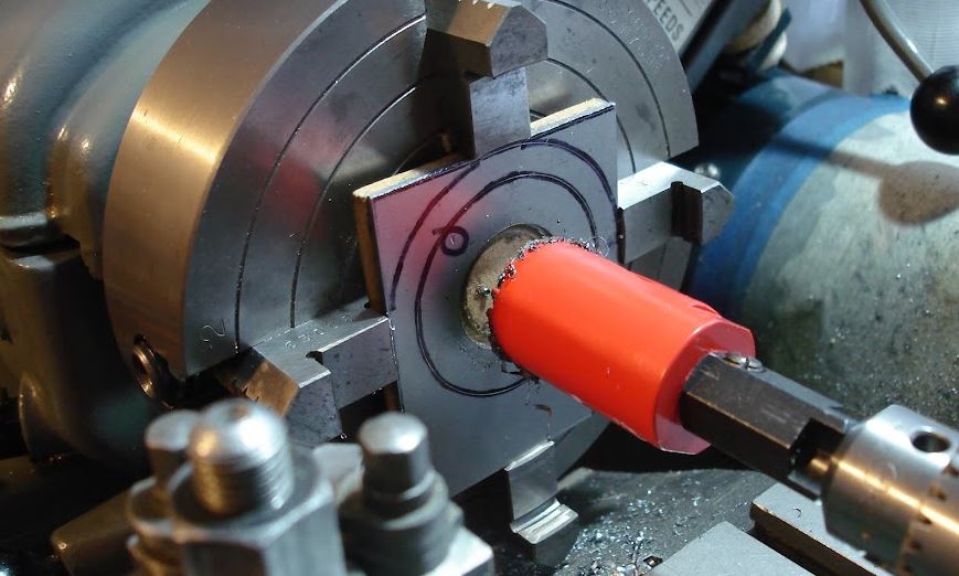

Starting off the smokebox door hole with a holesaw, the rest had to be bored out
Best wishes,
Dave

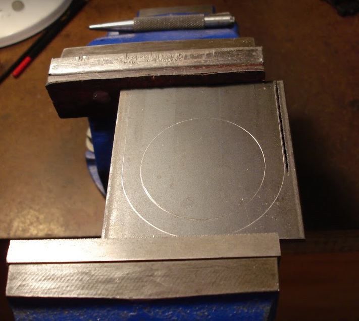

Here's the back plate from 4mm hot rolled steel. I wanted it thicker to engage better with the boiler shell. The profiles were scribed from the front plate. The hole will be a lot bigger
Best wishes,
Dave

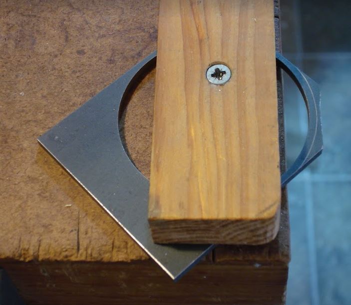

That's a big hole for the boiler barrel, turned in the lathe on a faceplate. I'm just sawing off the excess before grinding and filing to profile. I used the bench grinder, very satisfying. Lots of checking with the digital caliper to get the curve even
Best wishes,
Dave

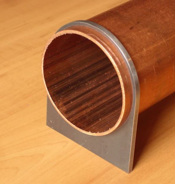

Checking the fit with the boiler barrel material, I bought that about 10 years ago from Macc Models, for this model :D
Best wishes,
Dave
