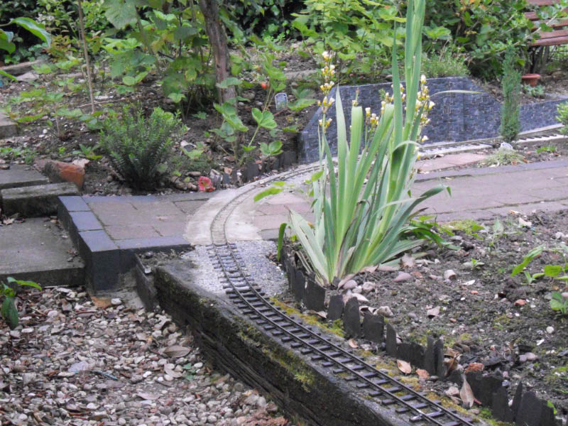

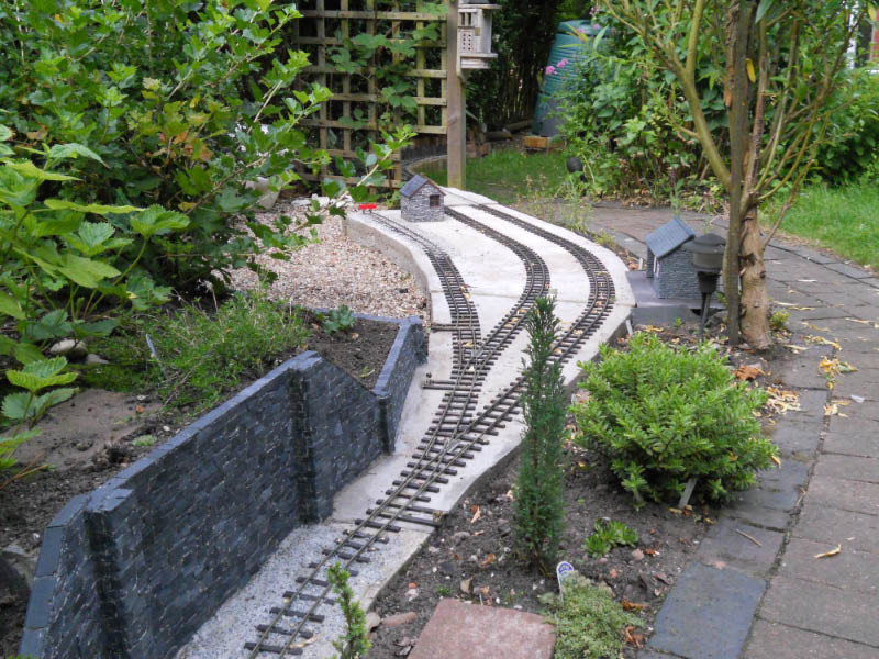

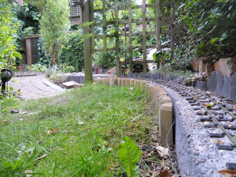

With the Railway Inspector here, time for a little update on this thread. Thought I'd throw in a few photos showing the current extent of the line, especially Hendre station which has been coming together nicely. Ballasting remains to be completed, and the platform still needs to be built. Anyway, here is the current state of play.
First a couple of shots showing just about the whole extent of the line so far.
And then we start on the approach to Hendre in the down direction.

hussra:73283 wrote: Image
Iawn, yn wir. Where are the remains of the ballast turntable? Looks fab.
Pendo Pilot
Post by Pendo Pilot » Sat Jul 28, 2012 6:21 am
Whilst you may not be advancing as fast as some :D I must say the quality is superb. Looking rather excellent there fella.
