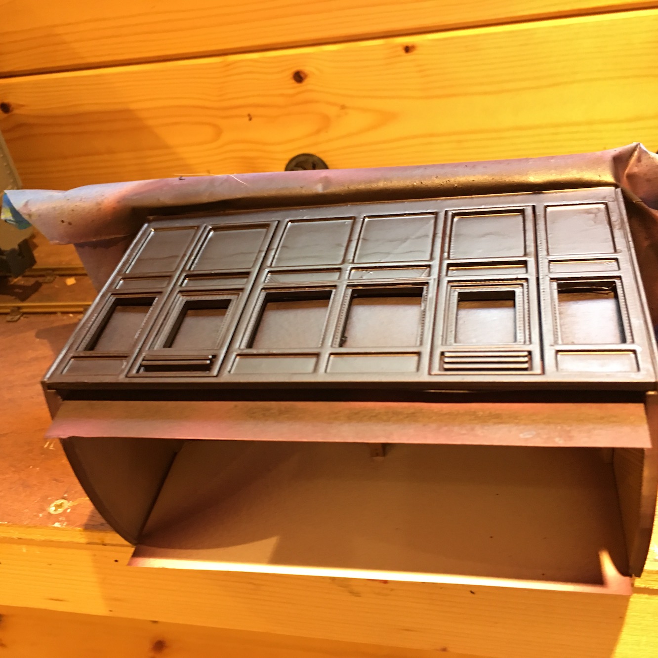

Rik mentioned the difficulty of printing roofs.

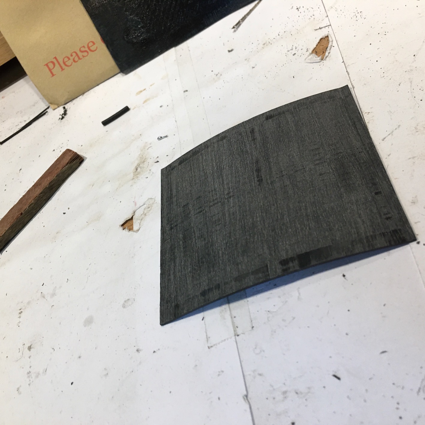

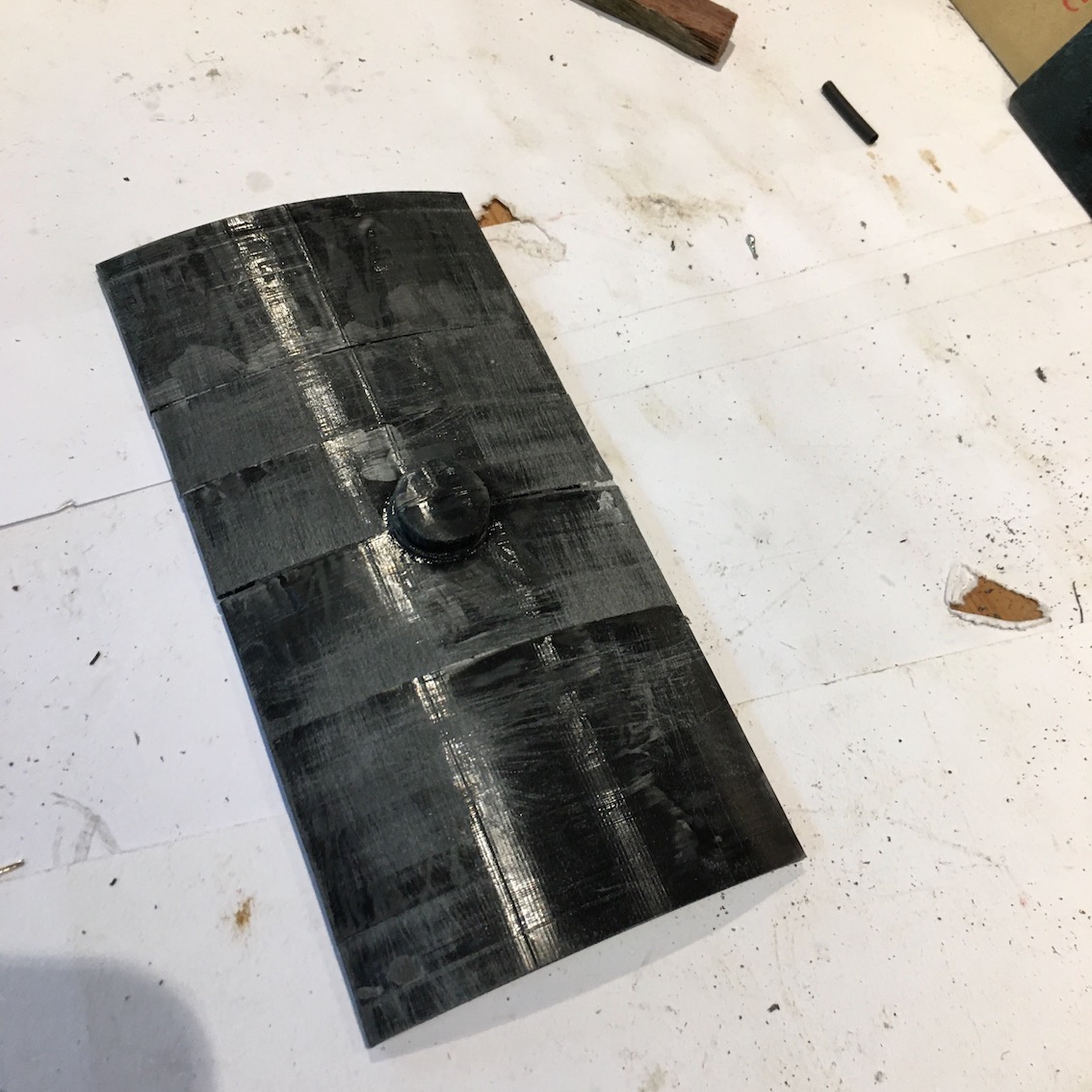

That prompts me to share a couple of failures. Well I haven't used them so they are failures - but I have kept them because they are actually recoverable.
Note that it seems best to print roofs on end - ie front or back of the roof on the bed plate.
The first is a roof for the Ashbury 4 wheel coach. This was printed in two parts - the join is in the middle of the oil lamp. So just print the front half twice. This was printed at the default speed and temperature. There were numerous cracks in this. So serious that I could actually split it into sections while handling it. I think that the issue is to do with shrinkage as the part cools during printing. The central parts are thicker and perhaps retain the heat better than the thin edges which shrink away from the nozzle. I have glued the sections back together and filled the shrunken bits. I think I could use this one (but I subsequently made two better roofs):
The second is a roof for 4415. So this roof was printed in one piece and with a slightly elevated temperature and 30% reduced extruder speed:
This had 2 slight cracks on the thinnest edges - but they only penetrated a few mm - and I couldn't break the roof by bending it around the crack. Still having the problem but only a little. The cracks are now invisible because I fixed them using bits of ABS dissolved in acetone as a filler / glue. It has been sanded. Roofs are one thing it is worth sanding - there is nothing to loose and a lot to gain in improving the appearance of the bit which is so close to your eyes!
The problem I was having was that at various heights the layers were not bonding properly to each other - and cracks were appearing at the edges - where it is thinnest.
So I think it is worth making roofs this way but it probably won't work first time. It might also be easier using PLA. The ABS I am currently using is renowned for being more difficult.

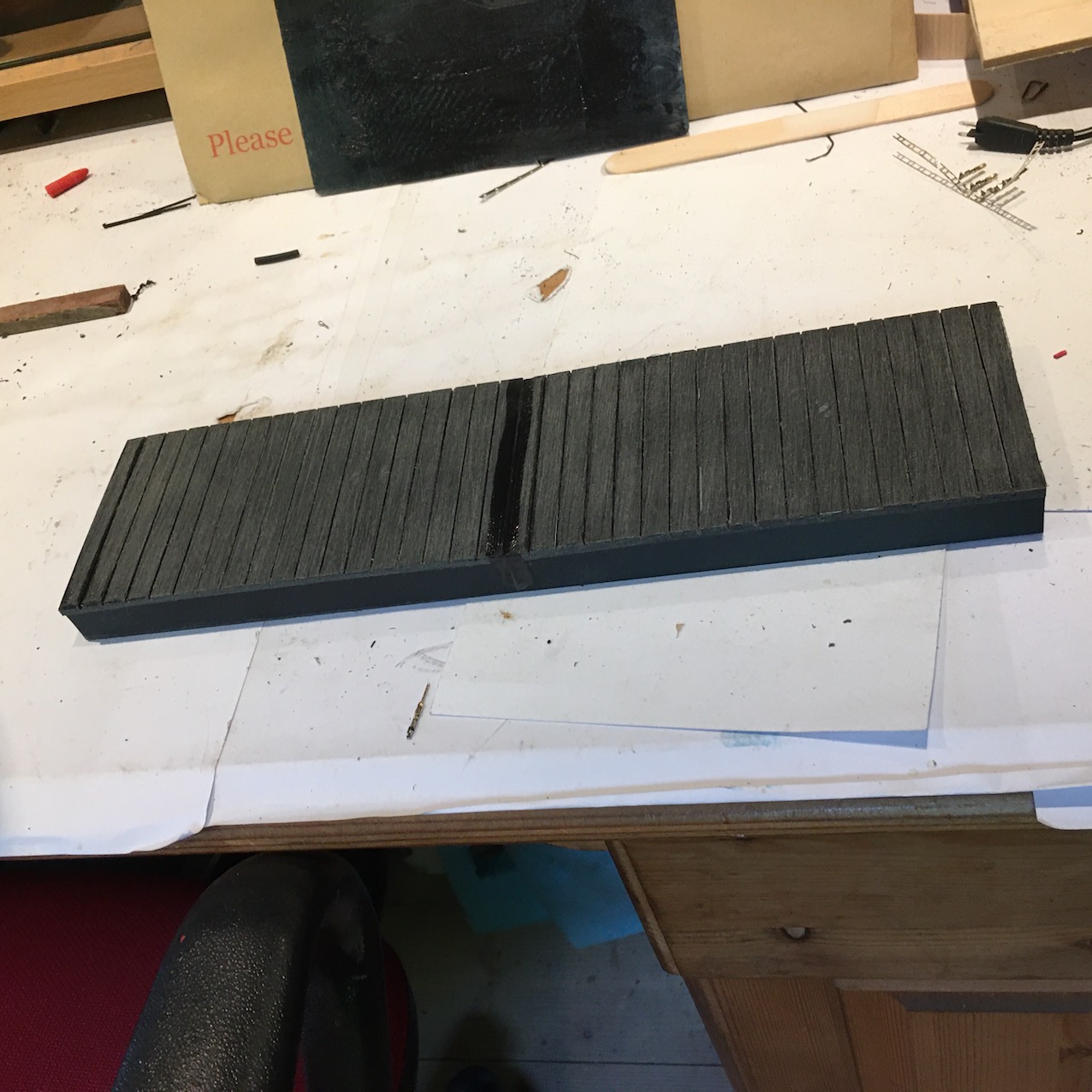

I have persuaded the ABS to stay down on the bed at the moment. The first 2 sections of the bridge deck are printed sanded and assembled. Oh and there is no detail to loose here and wood has grain flowing along the plane, so why not? The tops of things are always most in the line of sight:
This took 6 hours to print each part. there is some slight curvature on the top of the deck but not enough to make the parts unusable. The bridge deck is going to take over 30 hours to print. The whole bridge only took 5 hours to design and draw.

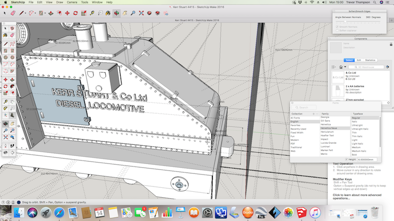

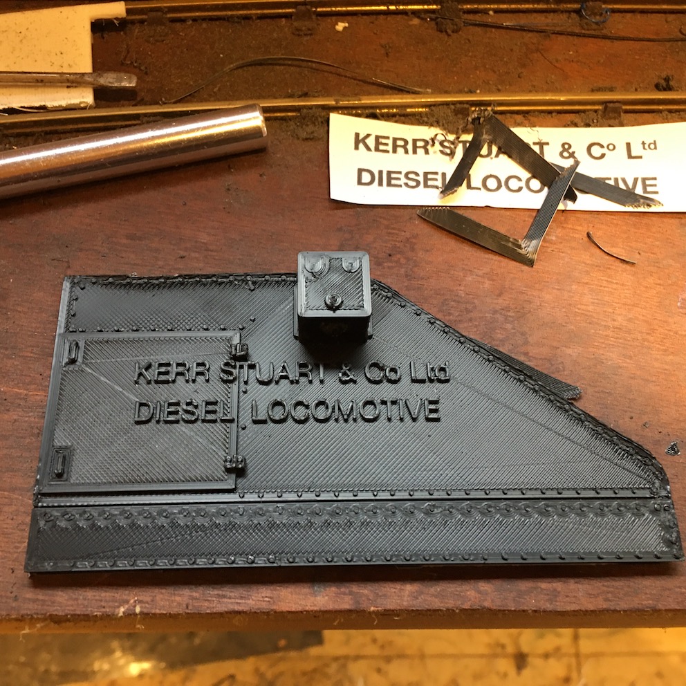

And I have had second thoughts about the 4415. I have a cunning plan to make it easier to paint the lettering accurately. I am going to try using 6 solid top layers and 4 solid bottom layers to see if it has any effect on the quality of the print. It shouldn't be embossed - but lets try it overnight:
The printed locos look brilliant. I like the driver facing the right way as well.
I have the first section of railing printed for the bridge There will be 12 sections of which 8 are identical:

If you want the lettering as an overlay in a different colour to the body, you could try actually printing it in the correct colour.
- Posts: 1202
- Location: South West Wales
Re: 3 D Printing 16mm models
Ah that would be clever. I haven't tried printing in different colours - and I have white filament!
As a test it has worked, although I am going to fettle some of the rivet detail:
And of course the bridge is progressing:

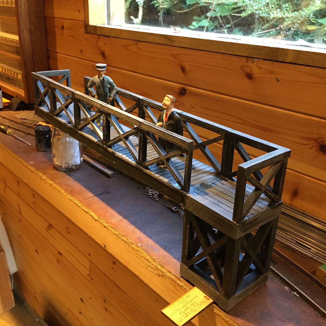

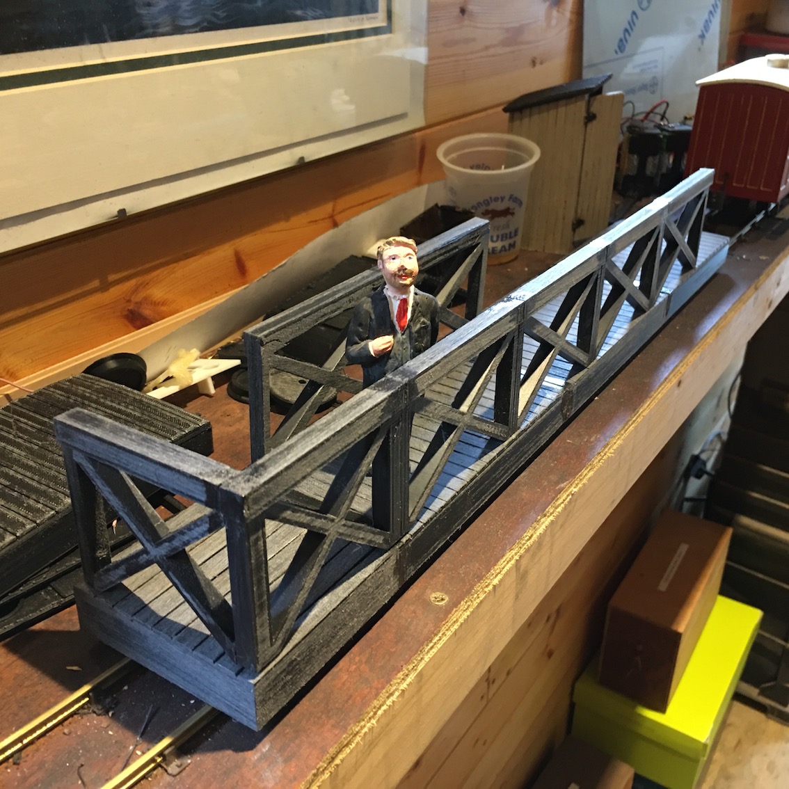

Latest update on the bridge:

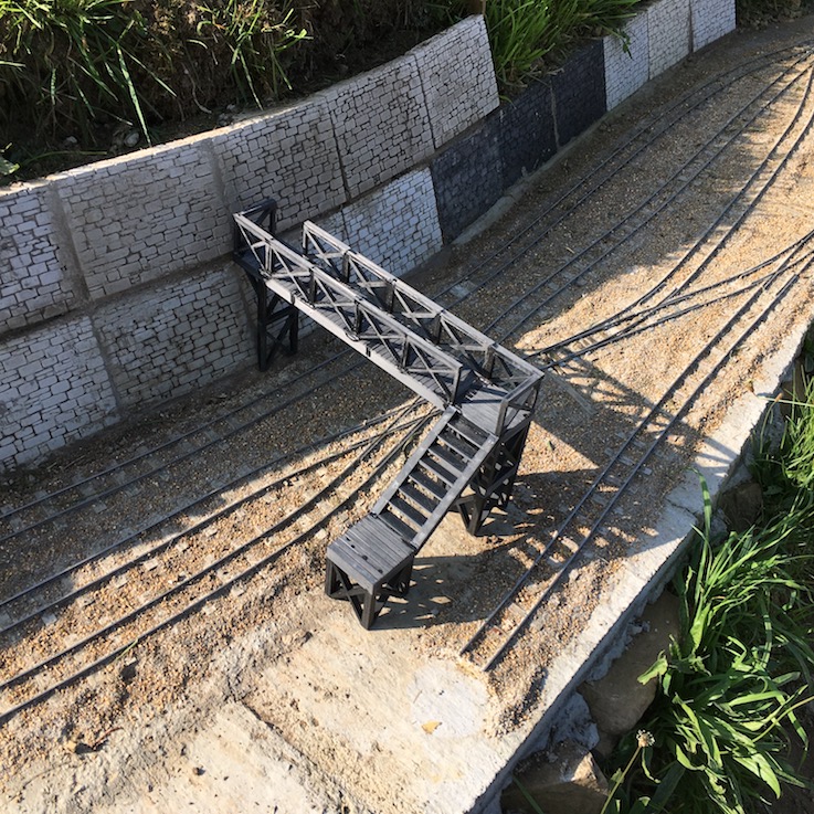

It is beginning to look like a bridge! Progress to date:

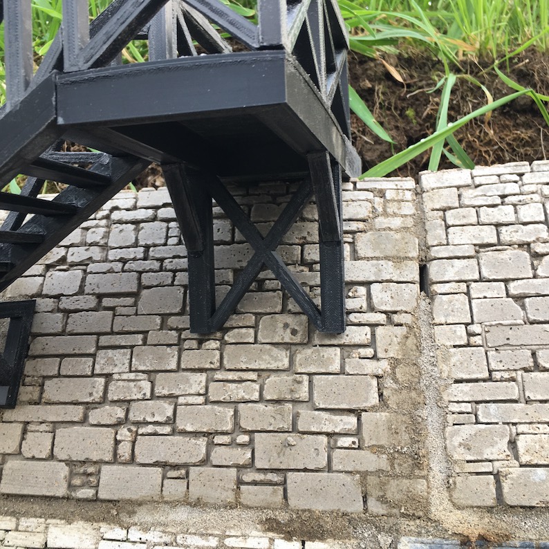

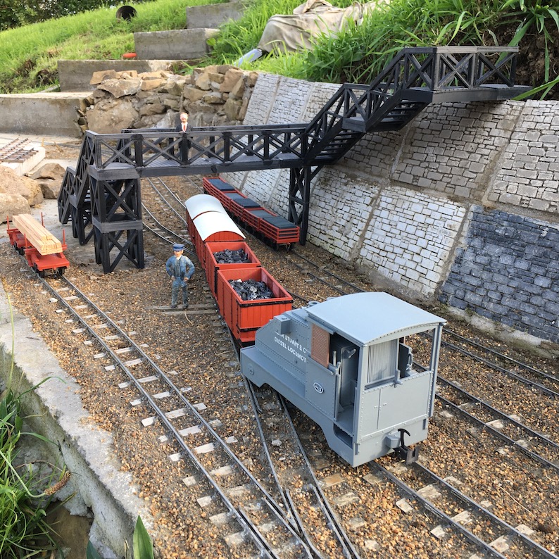

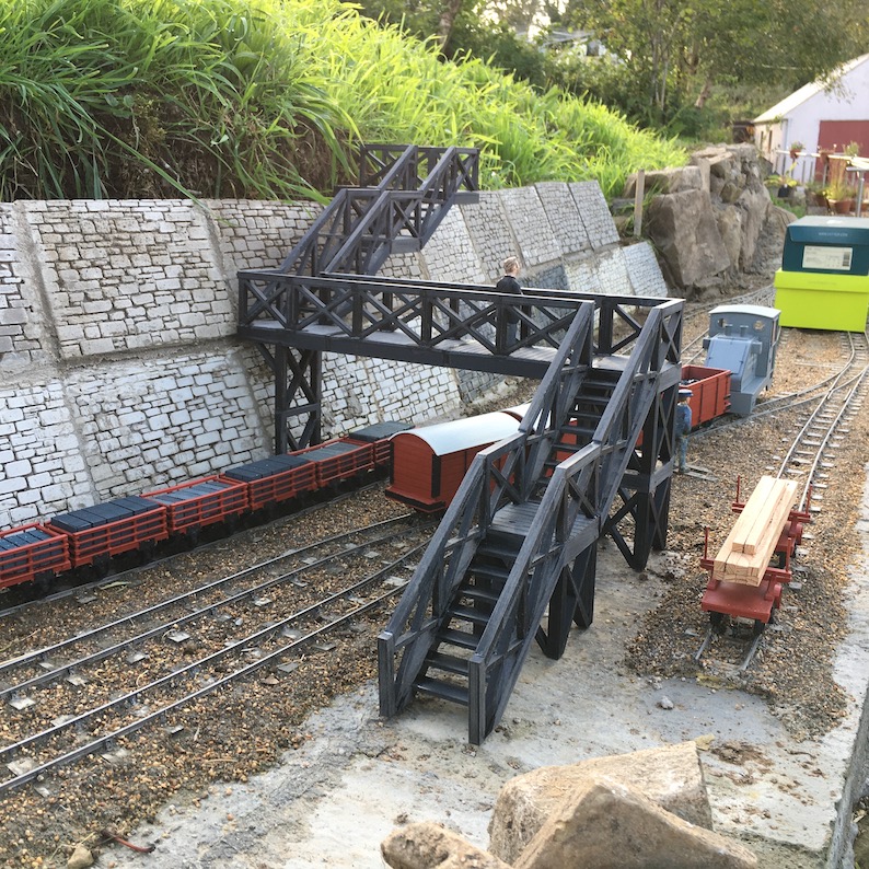

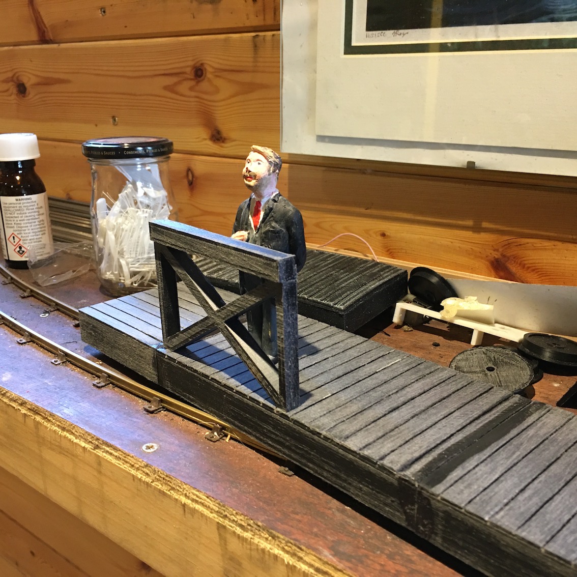

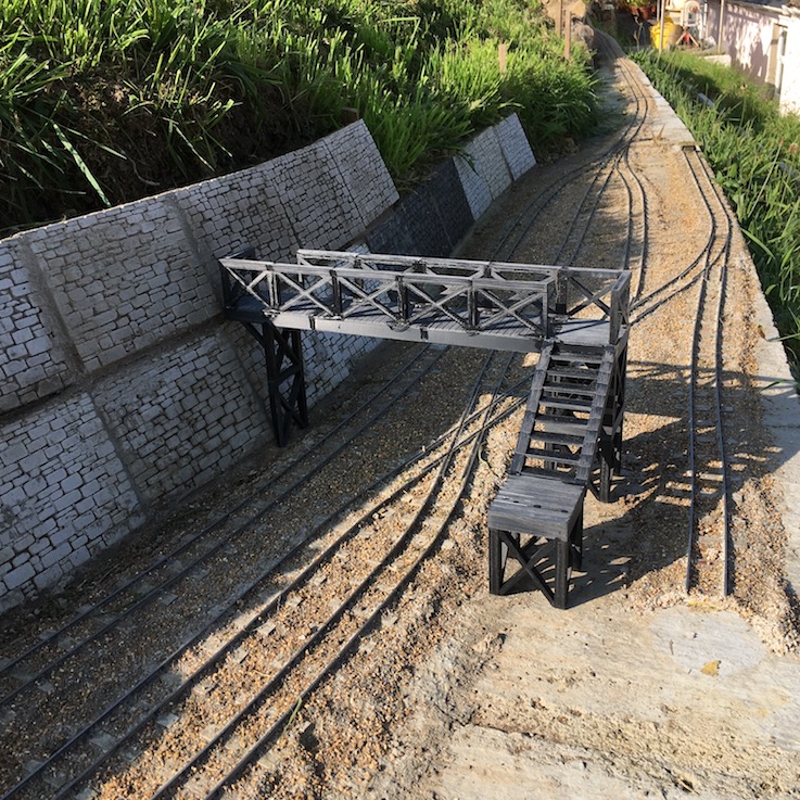

So the bridge is now finished. It printed out successfully without any significant issues. Only a few elements had to be redrawn.
I have purchased the plastic weld glue, and used it successfully, but I have found a mixture of acetone and waste plastic very successful when surfaces are not perfect fits. I think it results in a stronger joint. I fill a bottle with acetone and push offcuts of ABS into it, stopper tightly and shake. After a few hours it forms a paste which can be added to one part of a joint with a pin. I wouldn't use it on rolling stock where stray glue might damage detail, but on something like this bridge it has worked well.
A word about settings for printing. I have increased the extruder temperature 5 degrees above default, used 6 top layers, 4 bottom and side layers, and 20% infil using a honeycomb matrix. I also dispensed with the raft, and added a brim around the components. The resultant bridge is strong- I can pick it up in the middle and all of the cantilevered staircases remain firmly attached.
In total the whole bridge used 1.3 kg of filament.
So firstly two views of the bridge in place:

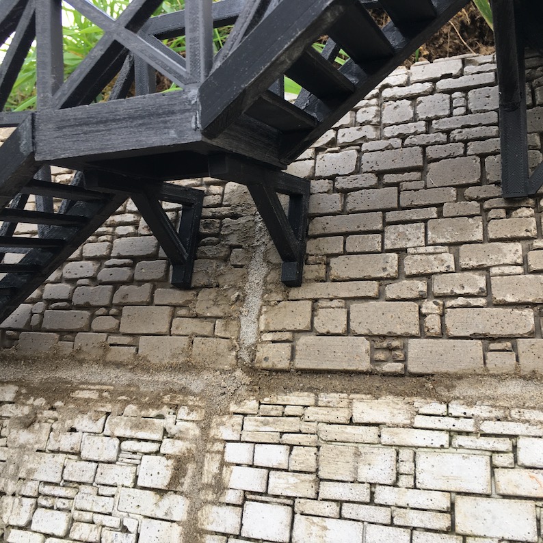

and views of of the "supports" I have invented for each of the platforms rising up the retaining wall (which are not there in the prototype): These supports are not structural - in the model - but I think that something along these lines would have been necessary in full size.
Just needs some paint. It will be fun painting that lot with an airbrush!

What a superb piece of construction, I must say that really looks the part. I am somewhat surprised that you are going to paint it as I think it looks pretty good as it stands, although that may be a trick of the camera and in real life it may be quite different.

No - it does look as good as it appears in the photos.
It is just that the real one seems to have been either oak or larch - anyway it seems to have been bare wood which weathers gray. It must have been a very durable wood because it was built in the 1870's and lasted until 1933. I want to paint it in various wood colours with the grey dominant on the upper surfaces.
Thanks for the kind comment!
