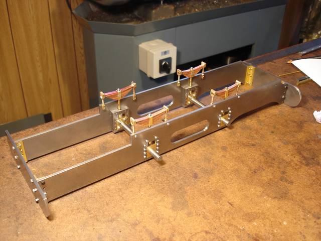

The first spring is complete

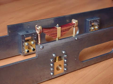

What attracted my attention though (and is puzzling me) are four bolts on the axleboxes (inside).
What are these about?

Why don't you use hex bolts Dave out of interest?

I like roundheads to represent the abundant rivets on the original
The four bolts hold on the separate back plates, I didn't have thick enough stock for the usual milled flange arrangement

dewintondave wrote: Fri May 29, 2020 9:00 am ... The four bolts hold on the separate back plates, I didn't have thick enough stock for the usual milled flange arrangement
understand,thank you (although I'd have probably silver soldered it to get the right thickness?).
Having said so, there is no right or wrong way of doing it :D

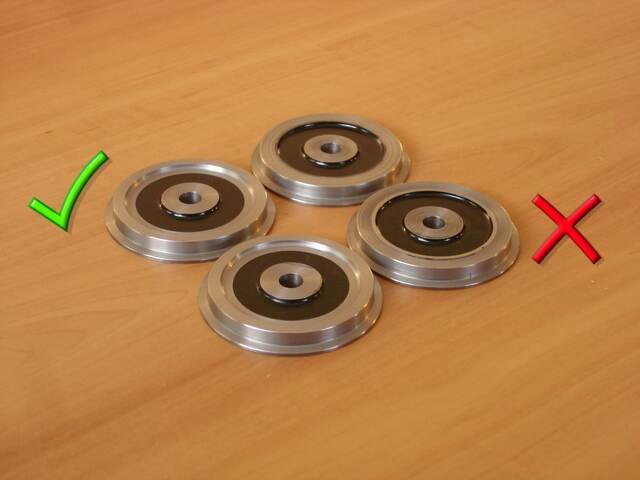

I'm back on with the project after a few distractions. It's now turn for the smokebox, but before that I needed to increase the wheel recess to keep the appearance in line with the other locos
Wheels refitted, and chassis back on the shelf

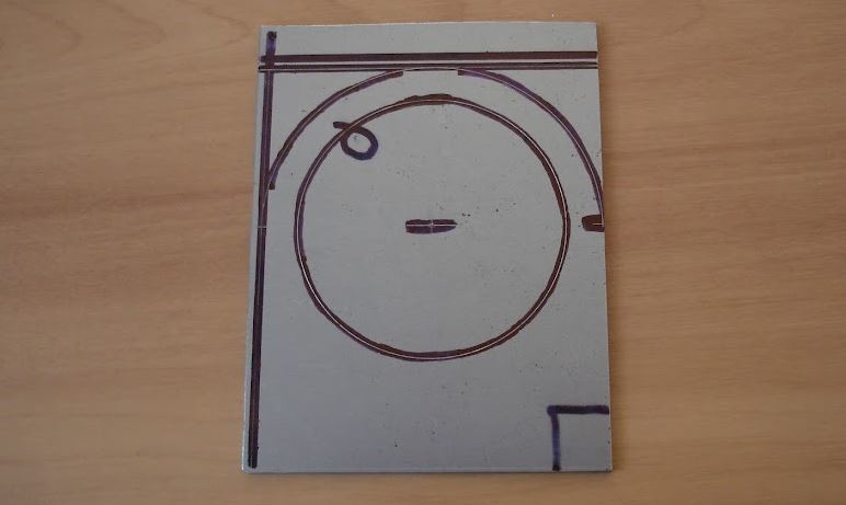

I'm doing a steel smokebox again, as steel is what I have. I'll paint it internally this time.
Here's the marked-out front plate. Who else uses their digital calipers for scribing lines? :thumbup:
Best wishes,
Dave

dewintondave wrote: Wed Sep 08, 2021 4:35 am Who else uses their digital calipers for scribing lines? :thumbup:
Guilty! Nice to see some progress on this!

dewintondave wrote: Wed Sep 08, 2021 4:35 am I'm doing a steel smokebox again, as steel is what I have. I'll paint it internally this time.
Hi Dave,
Do you use 16 gauge on this type of project?
Do you paint internally with gal?
Thanks Tim

Hi Dave,
Thanks Tim
It's 1.6mm Tim, I'll just use ordinary household oil based enamel. The last one wasn't coated with anything except steam oil for a year before I started coal firing
