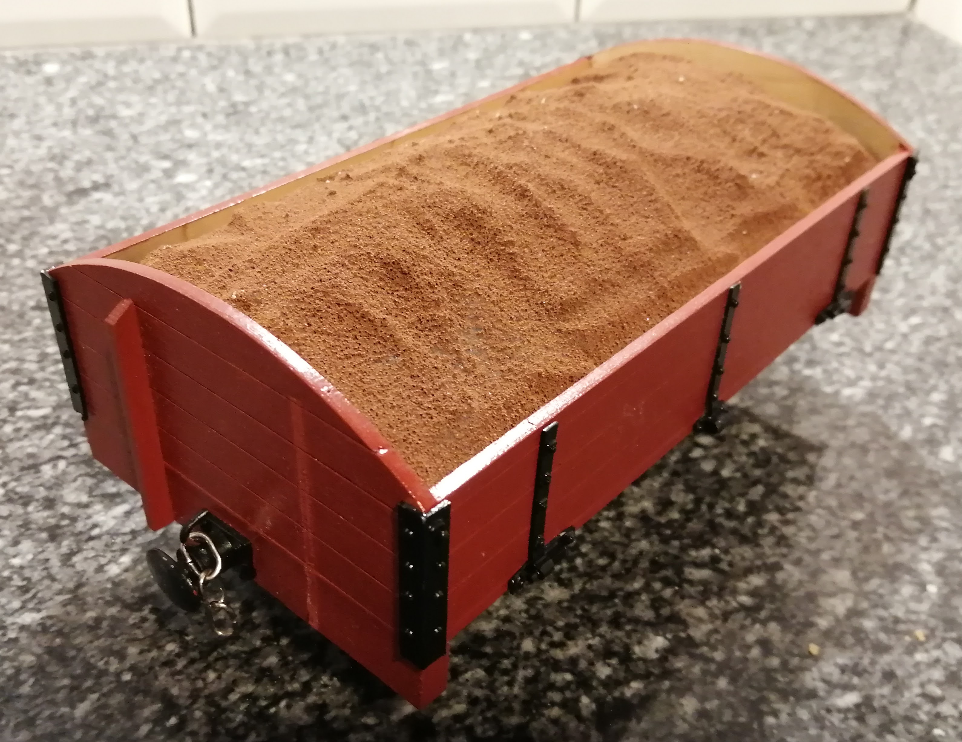

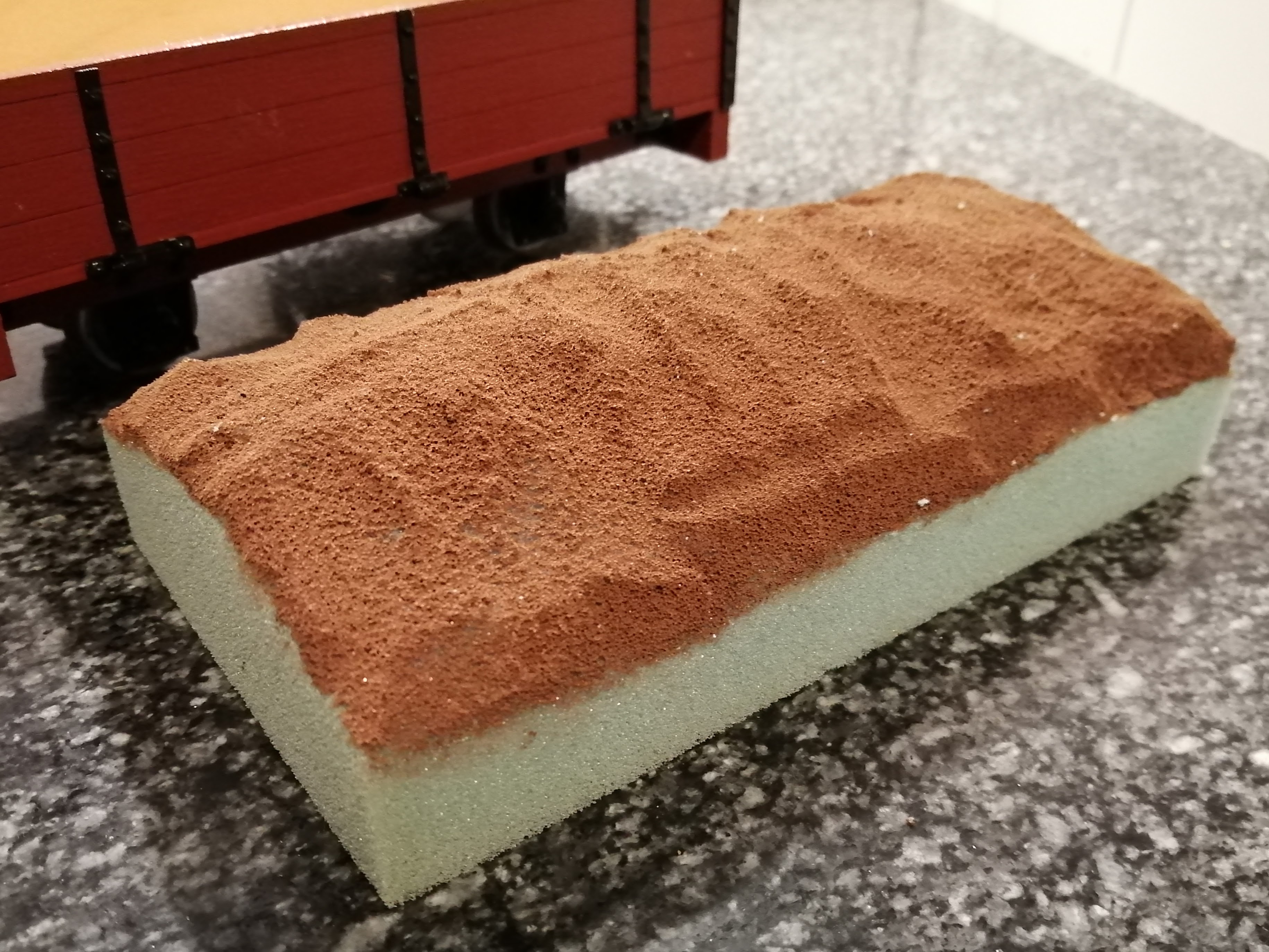

Loving those wagon loads and the fact they can be easily swapped about utilising the wagons full potential as per prototype. I used bath sponges, 35p from a local Pound Shop. I just nip the top to remove them. Here's an I.P. WD open wagon with a load of sand, which is actually not sand! I just carved the sponge with scissors then slapped on some Humbrol Brick Red. I have coal and gravel loads made the same way but with pink and white sponges! Posh.
Love the very teasing view of the new coach too, partly hidden by the shed door!

Those wagons look fantastic! The bogie open looks exactly the way I remember the one (two?) lying at Beddgelert in the late sixties. The loads look incredibly realistic and 'fill' the wagons 'properly' (i.e. no gap between the load and the wagon side) It's a great step toward realistic operations.
Pippindo,
That sand load looks more realistic than real sand! I'm so impressed. There isn't much call for sand traffic on my line but I'm going to have to invent a building project somewhere along the way to justify having one myself - always assuming I can come somewhere close to replicating your excellent example.

Ah. That's very kind of you, but the apparent lack of a gap is largely down to camera angle - some of the loads are quite "gappy"! Painting the edges of the blocks helps though - and the gaps make it easier to take them in and out, which I'm keen on...Soar Valley Light wrote: Mon Jan 04, 2021 8:48 pm

I like the ridges on the sand load. Adds to the realism.

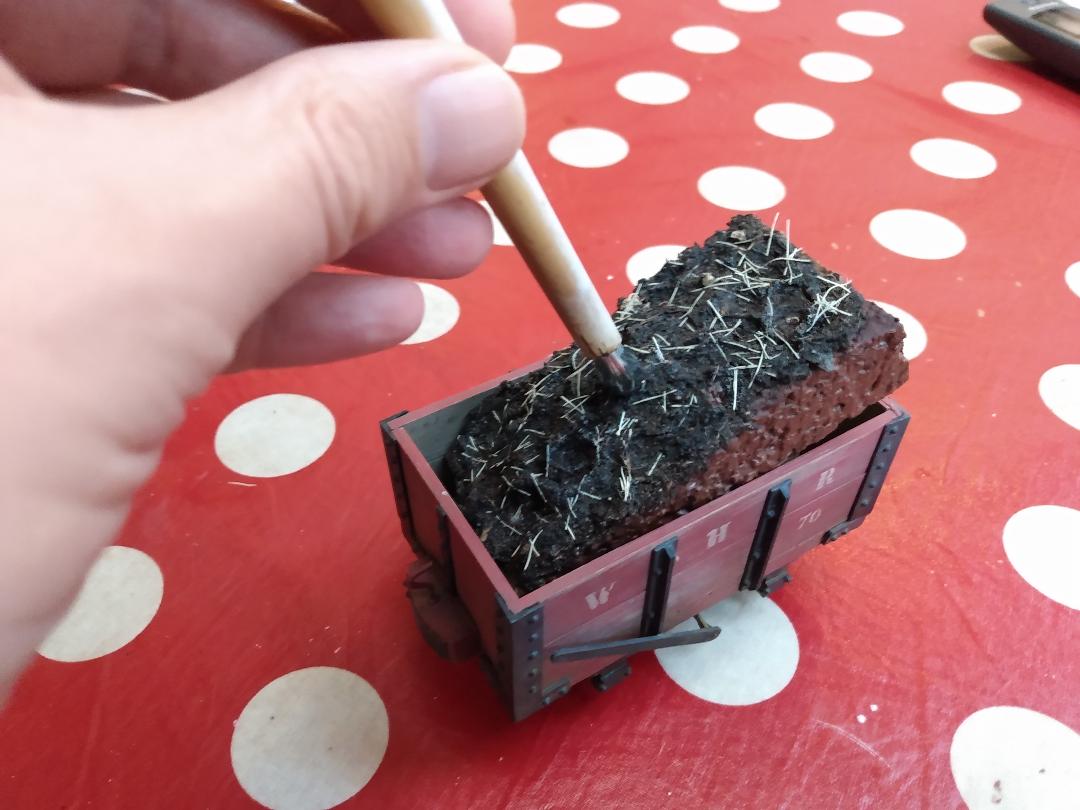

As promised, here's an update - if this looks like a load of cr*p, then I've got it about right:
A little research showed that back in pre-preservation days the Welsh Highland sometimes used to carry manure - which I've (hopefully!) replicated with a compost/PVA mixture and some old brush bristles.
I'd assumed that manure would have been being transported from the local farms to fertilise barren city parks and flowerbeds, but it seems it was the other way round - cities, full of horse-drawn carts etc, were desperate to get rid of the stuff. I'd thought too that it would have travelled in sacks, but it appears that mineral wagons, like this one, were used, much more fun to model!
For now I've completed my ultra low-cost (no cost!) wagon load project with a tool to retrieve the loads - the end of a magnetic dart that came with a kids' dartboard, glued into a length of garden cane:
Poo sticks, anyone???

I'm going to have to produce something similar for the Boneworks. For some reason, they also collected piles of manure as well as carcases. Maybe it was something to do with the production of fertiliser??

Looks so convincing I can smell it from here!

Puts a whole new aspect to the term 'train movements'!
Fantastic stuff Andrew and very effective too.

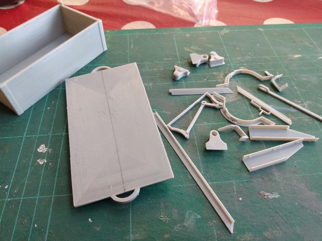

I'd planned for a while to model at least one of the Ffestiniog's side tipper wagons, which were converted from 3 ton slate wagons. I'm not sure what the originals were for, but in my made-up history the Welsh Highland has "borrowed" them for the Penlan granite traffic.
I somewhat ambitiously decided they'd make a good first project for 3D CAD. Naturally, I fell at the first hurdle (I'll pick myself up and try again sometime!) but the idea piqued the interest of a fellow GRF member, who very generously finished the project, resulting in this kit of parts, seen after an initial clean up:
I don't recall working with PLA before, and it's an interesting experience. I'm finding it sort of "sticky", as in when you clean the flash from a part it seems reluctant to leave! Beautiful parts though, aren't they? It's really interesting to see a project through another modeller's eyes - the level of detail incorporated is quite exquisite. Amazing to think too that all this was modelled on a screen first, and then extruded into being...
Anyway, here's where I'm up to so far - One wagon (the prototype, sent to me fully finished) in primer (looks good in gold, doesn't it?!), one partially complete, and the last with some new pieces being made to represent FR wagon 830, which has some detail differences:
I'm taking my time over this, doing a little every now and then, but I'll keep you posted...

That is brilliant Andrew. They do look very very good and when put at the back of one of your locos they will be a train to be proud off.
Must look to see if I can locate those files.....

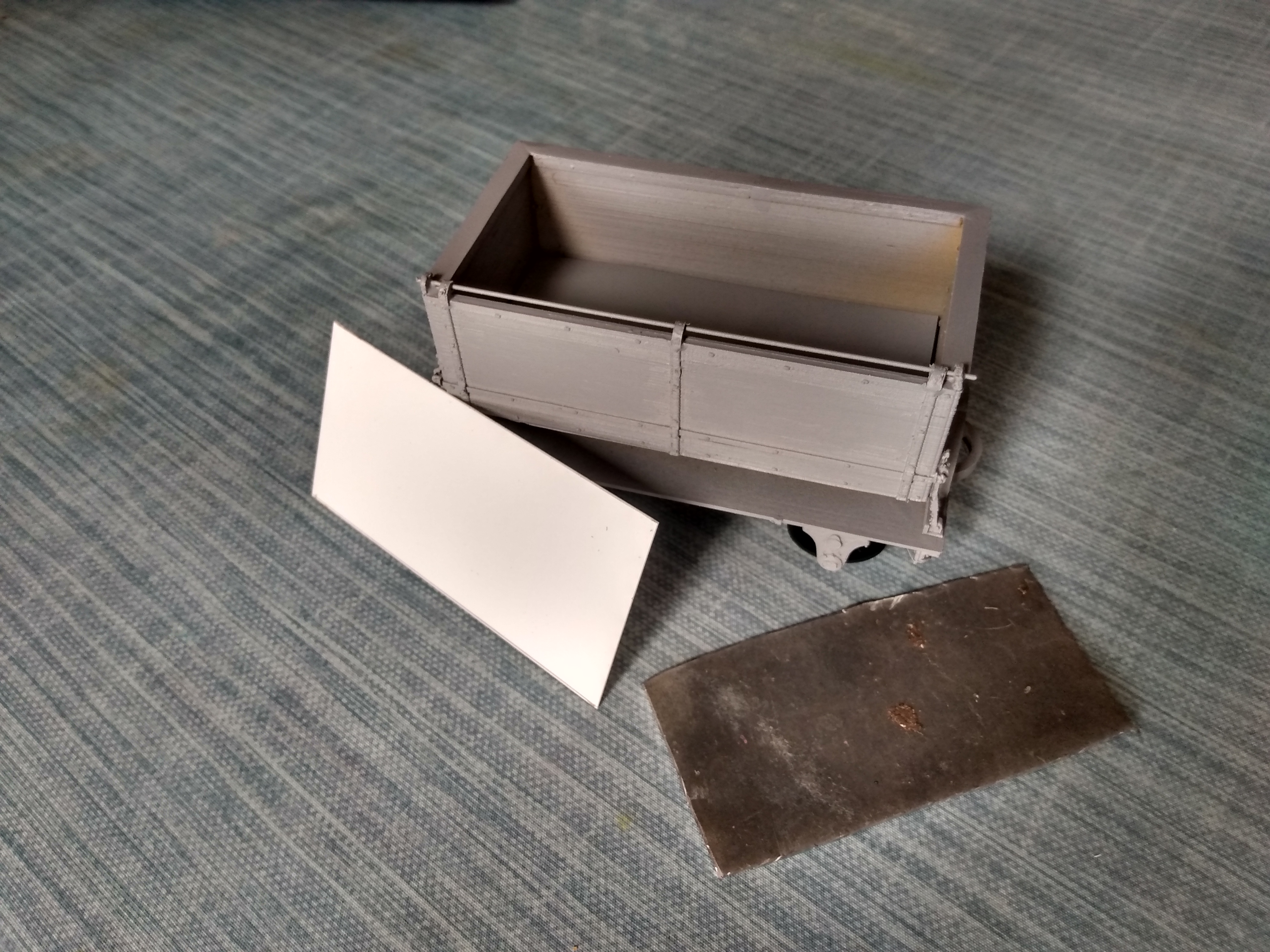

False bottoms - they're the way forward! No, I'm not talking prosthetic posteriors (although I'm sure there are forums for such discussions), but dummy wagon floors, with extra weight added underneath. I did it on my recent coal wagon build and have just employed the same trick with the tippers. The picture shows one wagon with its weight and false floor added, and the bits ready for adding to another - lead sheet is wonderful stuff! The wagon now weighs in at over 160g, which should be enough, I think...
- Posts: 6043
Re: (WH)WHR Rolling Stock
Good idea if there isn't enough room underneath between the solebars.

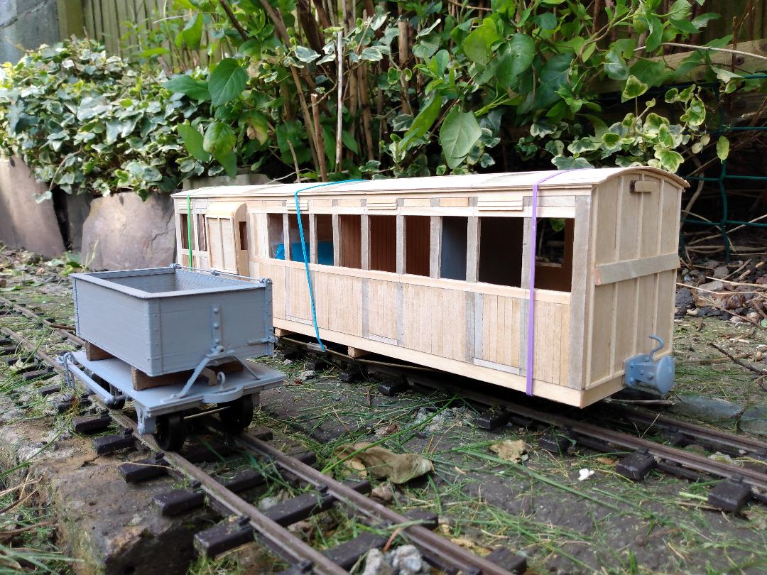

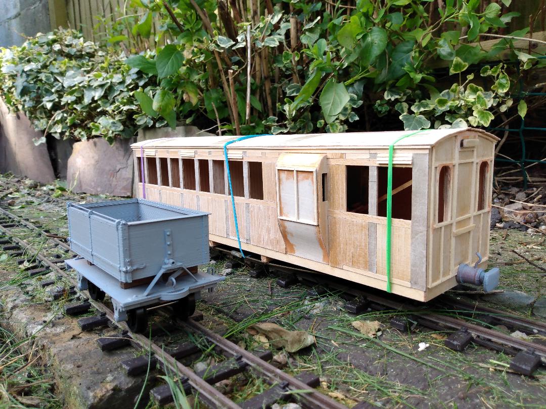

Afternoon all,
After weeks with little time for progressing my current projects, I've managed to crack on a little lately.
Here's the third of the FR tippers, this one modified to represent 830 - all three now await weathering. And FR Van 4, with most of the woodwork now complete. This needs a little more detailing, then it'll get a coat of paint before I turn my attention to the interior.
Van 4's a quirky carriage, rebuilt from an 1880s full brake in 1928, with the result that the ends are 40 years older than the sides. The eagle-eyed may have spotted that it has a different of coupling at each end. The real thing does too, with a chopper type at the Blaenau end and a slate waggon type at the Porthmadog end, harking back to the days when up passenger trains would have a string of slate empties attached to the rear. I hadn't noticed that when I built my model of similarly-equipped Van 2, so I was able to removed one of that carriage's couplings and swap it, resulting in a spare for Van 4. The waggon type coupling's a little large, but it should cope well with my sharp-ish curves...
As you can also see, the track needs some tidying up before trains can run - I've made a start...
- Posts: 6043
Tippers have turned out well Andrew.
I do like the coach as well, be interesting to see it with interior and paint job.
- Posts: 5715
Agreed, you have put a lot of work into the coach and it looks great.
- Posts: 7990
That's a mighty fine looking coach. I'm not sure I fully understand how the different couplings worked. I can see the logic of it travelling in the Up direction, but what happened in the Down? Did they have to reverse the coach at each end?
- JMORG
- Posts: 940
- Location: Gloucester
They did actually turn one of these carriages to run on the WHR out of Portmadoc at the time.ge_rik wrote: Mon Apr 05, 2021 7:40 am That's a mighty fine looking coach. I'm not sure I fully understand how the different couplings worked. I can see the logic of it travelling in the Up direction, but what happened in the Down? Did they have to reverse the coach at each end?
Generally speaking, on the FR the empty slate waggons were pulled up the line and descended back down by gravity. To aid in coupling, the vans used the hook and link on the down end. The Birmingham's, Small Asbury's and quarryman's all had screw couplers, with a hook at the top end. This made it easier to couple the locomotive (hook and link) to the carriages. The vans hook and link also allowed easier coupling to the locomotive. Bogie carriages had choppers with various adaptions to allow hook and link Birmingham's to be coupled; from my understanding the bogie carriages were generally kept as pairs (for example, 15 and 16) with a van added and Birmingham's as "spares".
It's a mess I know, I think this is why the Garraway administration adopted choppers for all stock (if possible)!
See here: https://www.festipedia.org.uk/wiki/Coupling
