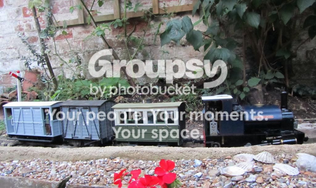

Bits of the line are looking quite pretty at the moment and in this photo you can see the lettering on the newest Brake Van. (No. 27)
Today I tested the MV to see how well it worked behind River Butley and apart from a few hicups...
she ran very well indeed.
Beautifully slow acceleration away from the station. The Van also gives the loco a little push as it slows down around the curves (ahem, corners). Really enjoyed running my little railway today.

Not too much - I want to avoid excessive wear on the bearings. About 300g or so. The van can't push the loco along any great distance, I think the improved performance comes from the fact that I can have the regulator further open and it doesn't race away on the straighter bits. With 3 link couplings when the train catches up with the loco with a satisfying clonk it imparts enough of an impulse to restart a stalling loco (The excelsior is a devil for not self restarting)
I kept forgetting it was in the rake and shutting the regulator in the station and putting it into mid gear fairly well kills the speed, only to hear the clonk, clonk wirrrrrr as the train catches up and the van skids to a stand - still learning how to use it. The aging is mainly just thanks to the paint peeling off as I used to leave this van outside.
I am looking forward to testing it with my Millie. I've always found the millie to be a challenge with the long wheel base. It has a tendency to stall on the corners then build up a load of chest pressure and blast out onto the straights at eye watering speeds. Hopefully this should keep it in check!
