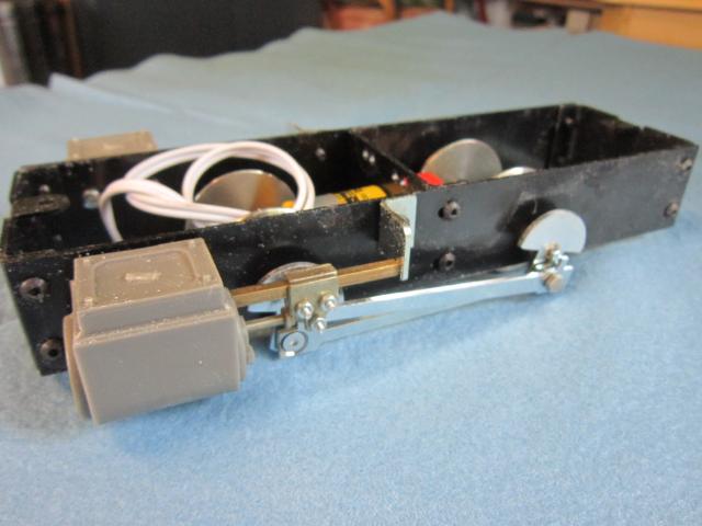

Another project begun.... plenty still to finish, but why not?

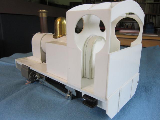

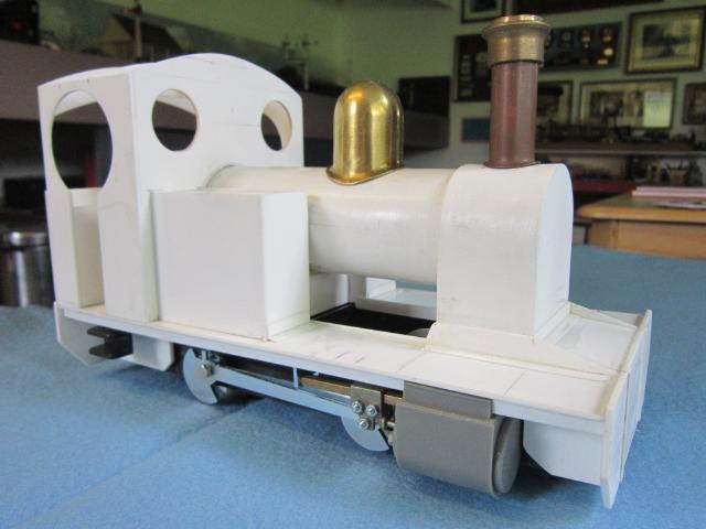

Some time back I 'won' a motorised chassis from ebay and it has been sitting patiently waiting for me to decide what to do with it.
Following the build of my last steam outline battery loco I am ready for another to join the stable. I know there are resin bodies available to fit this chassis but I like to create something myself.
I didn't want an open cab for a start. There had to be room for batteries with access to them and the receiver etc.. I also avoided a second saddle tank design. So... side tanks it was, with a small coal bunker built into the back of the cab.
This is what I came up with...
These pictures are before the fitting of Cambrian rivet heads, so far I have attached about 350 before running out. I will be at Llanfair next Saturday and hope to get more there. The project will be on hold until then.

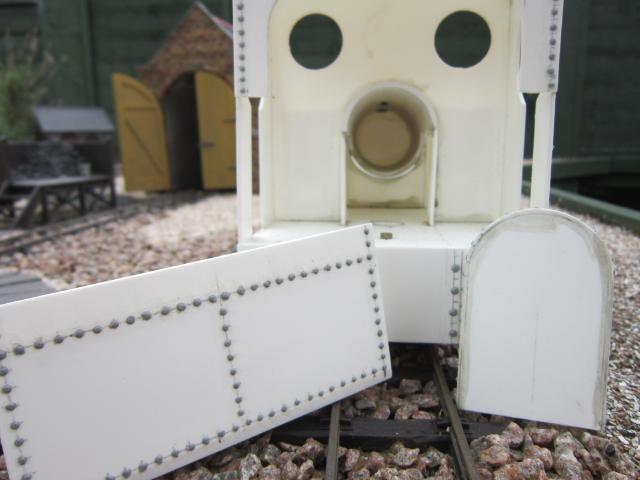

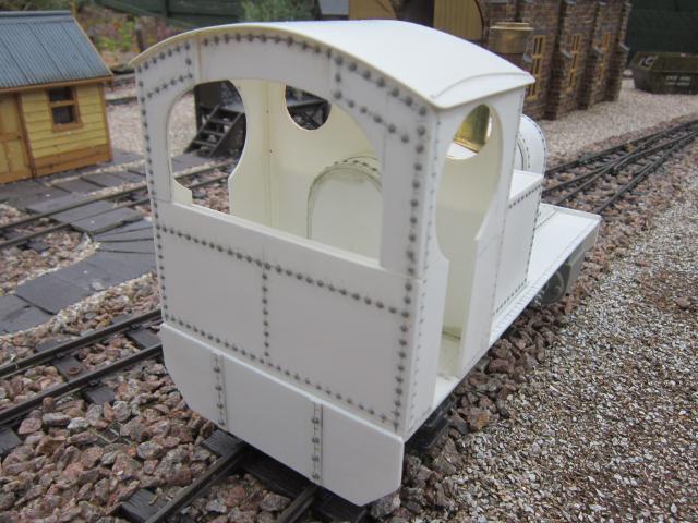

An update on the rivet head application.... I have drawn out lines where the heads are to be stuck and measured an equal distance between them. Having now run out completely I will have to wait until the Llanfair show where I hope to buy enough to complete the model.
I will not put them as close together in other areas of the loco as they would not have been pressure or load bearing in those places.
The coal bunker is detachable from the body by removing two screws underneath. When out of the way access to the battery box (boiler) and receiver (side tanks) is a simple matter.

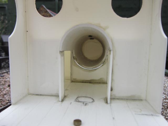

Not long ago I made a winding house to head one of my inclines. It was made from embossed plastic sheet with a drum inside and 'slates' on the roof...

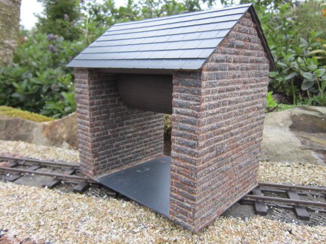

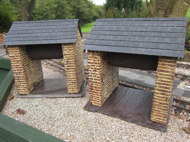

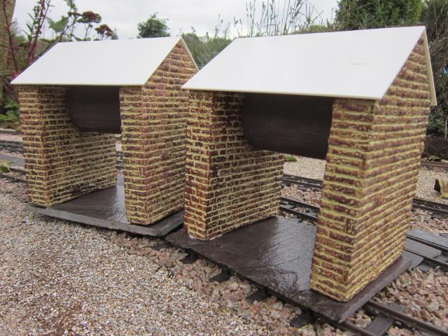

Unfortunately I needed two the same so I decided to have the sides and drum cast in concrete. These are the original patterns
Cain Howley has cast the units and I have begun to asemble them.

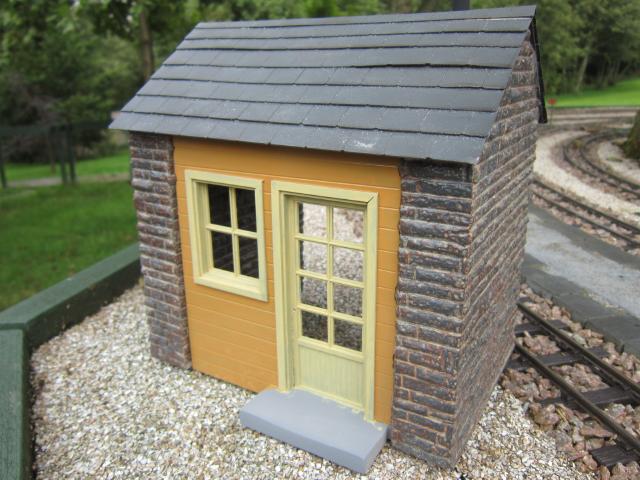

Meanwhile.... the original plasticard building is being altered to a ticket office with the addition of a 'timber' clad frontage.

Cain uses a natural crushed grey stone ballast type material with some small aggregate included. It dries with a highly detailed surface finish.Soar Valley Light:113498 wrote: What material are the walls cast in? .
I have used a cutting disk to alter the shape of the tunnel mouth and can tell you it is extremely hard concrete. It can be drilled with a masonry bit to add locating pegs etc.
These buildings are destined to last a very long time in my opinion.

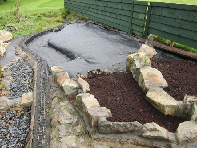

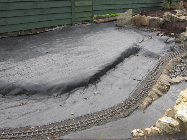

Some pictures of the stonework as mentioned above...
The last one shows stone cemented in position but waiting for the soil to be put in place. Also, this shows how I prepared the ground by covering the entire surface with weed control fabric. This has two advantages, one keeping the roots of grass and weeds already established from spreading into the planting area, and two, preventing the moles from pushing up through the plants and destroying the landscape.
Most of the wildlife is welcome here but moles are nothing but a pest and leave a trail of mess and destruction wherever they go.

Looks really good, Peter. I did wonder at first whether you had decided to cover everything in tarmac .... then read the description.
