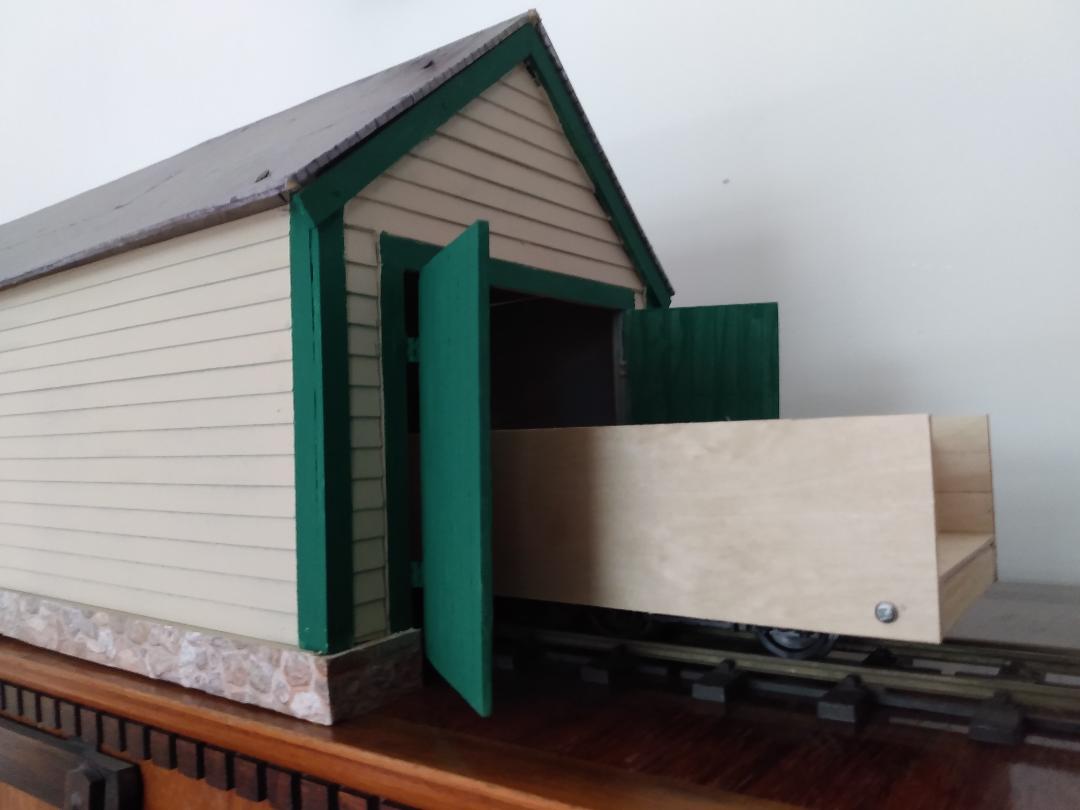

There's not much progress to report on the Ffestiniog brake composite, but wandering past the carriage and wagon works yesterday revealed that a second carriage project appears to be in progress - a somewhat mysterious one...
Most of the carriage was tucked in the shed, with no room to squeeze past to see the rest - and the staff were keen to send me on my way. Why the secrecy? Who knows? I looks like the beginnings of a perfectly ordinary carriage - ply, stripwood and Big Big Train bogies... We shall see...

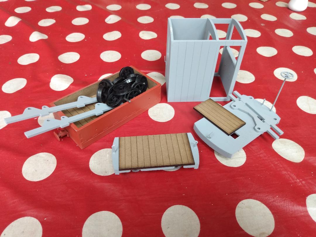

In other rolling stock news, inspired by another thread on here I purchased a kit for the Ffestiniog one plank "beer wagon" from Phil Sharples. The main problem with his kits appears to be that they're crazily good value for money, so I found myself unable to resist purchasing two more at the same time - a flat wagon (to form the basis of the Welsh Highland drop-sided open that JMORG's also modelled recently) and a freelance brake van (because I really like brake vans). Here's progress so far:
I've changed the coupling arrangement on the beer wagon (doing a chameleon impression against the red tablecloth in this picture) and opened out some existing tabs on the other two to allow space to use 24mm wheels instead of the 20mm ones supplied. The brake van has a little added detail but is almost complete, with the flat trailing behind at the moment. We've got a busy weekend, but I hope to get time for some more progress on these next week. The kits are very well designed, and I'm surprised how much I'm enjoying working with MDF too - more may follow...

Looks like you are really going to busy Andrew. Interesting build in the first photo. Can't wait to see what it turns out to be..

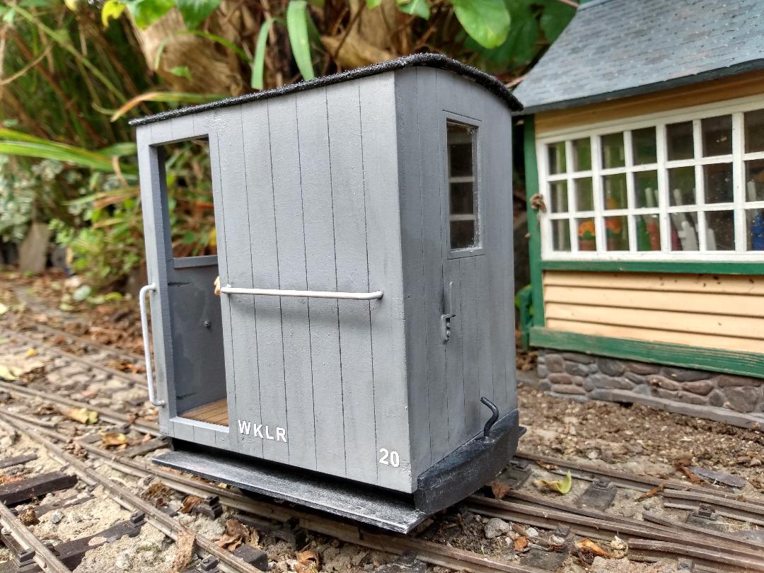

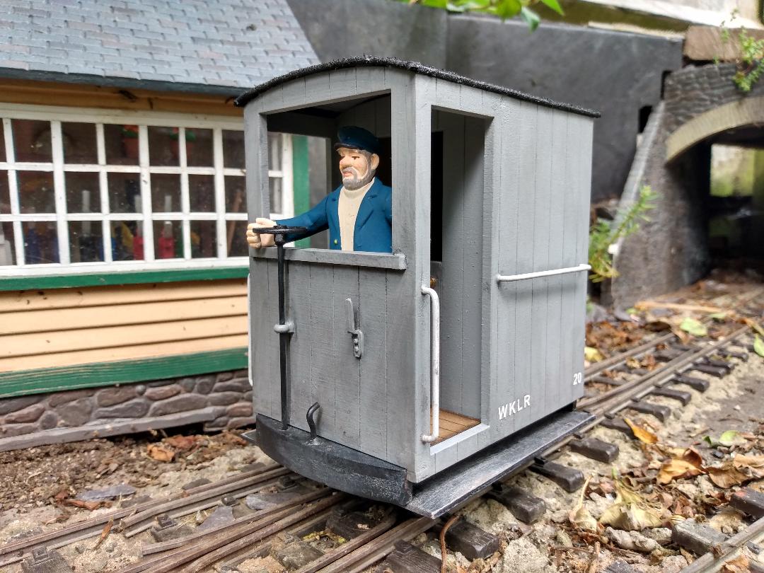

Hi all,
Sorry, haven't been terribly active on here of late - I've got lots of threads to catch up on over the weekend!
In the meantime I thought I'd share a couple of photos of the first of the Phil Sharples kits I've completed, the guards van. It's more or less a straight build, just with a little added detail. I had modified it to run on larger 24mm wheels, but it looked a bit like it was tottering about on high heels, so it's gone back to 20mm ones again - the coupling height still seems OK.
Here it is:
Pleasingly quaint, I think? I'll try to give it a test run and take a few photos over the weekend...

Re: (WH)WHR Rolling Stock
Neat that Andrew.
- Posts: 7990
Nice looking model. The guard looks good too. He has a nautical bearing....

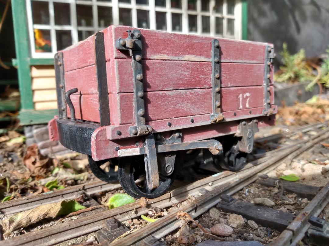

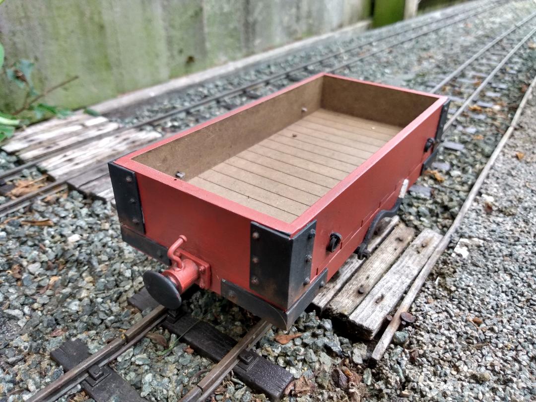

Ah! Am I right in thinking that you've spotted the guard's origins Rik? He's a McDonald Happy Meal figure of Captain Haddock of Tintin fame. I barely had to make any mods at all apart from repositioning one arm, but he does still look like he'd be more at home on a trawler! Given that the van boasts almost no mod-cons, no glazing in the cabin door, let alone a stove, I thought a jumpered guard was quite appropriate!
I've just finished the second Phil Sharples kit, a flat wagon to which I've added a plywood body to represent a NWNGR drop-sided wagon. The idea was to use the kit as a bit of a short-cut, which worked, but at the expense of it not being a terribly faithful replica of the real thing, the proportions are all wrong. I don't mind much, I like the chunky look of the wagon, which will be used mostly to carry granite.
That is one lovely paint job, Andrew, it just looks so hard worked. Well done.
Another superb weathering Job Andrew, I notice there's even a small cobweb on the right hand hinge strap, perfect.
You do have a knack with weathering Andrew. I love the way you seem to have the rusty bits just right.
You'll have to try harder than that to offend me Rik!ge_rik wrote: Wed Jul 29, 2020 10:05 pm I was going to say Captain Haddock but thought you might be offended....
I don't frequent McDonalds much either, but the toys do crop up in charity shops from time to time - I've got two pairs of the Thomson Twins in different vehicles. Good luck with yours.
Glad you like the wagon and its weathering everyone. My technique mostly involves attacking a new paint job with fine sandpaper, and then sloshing some dilute paint around before dry-brushing on some rust. I'll take some photos sometime...
PS I think that "cobweb" is a stray strand of UHU Grant!

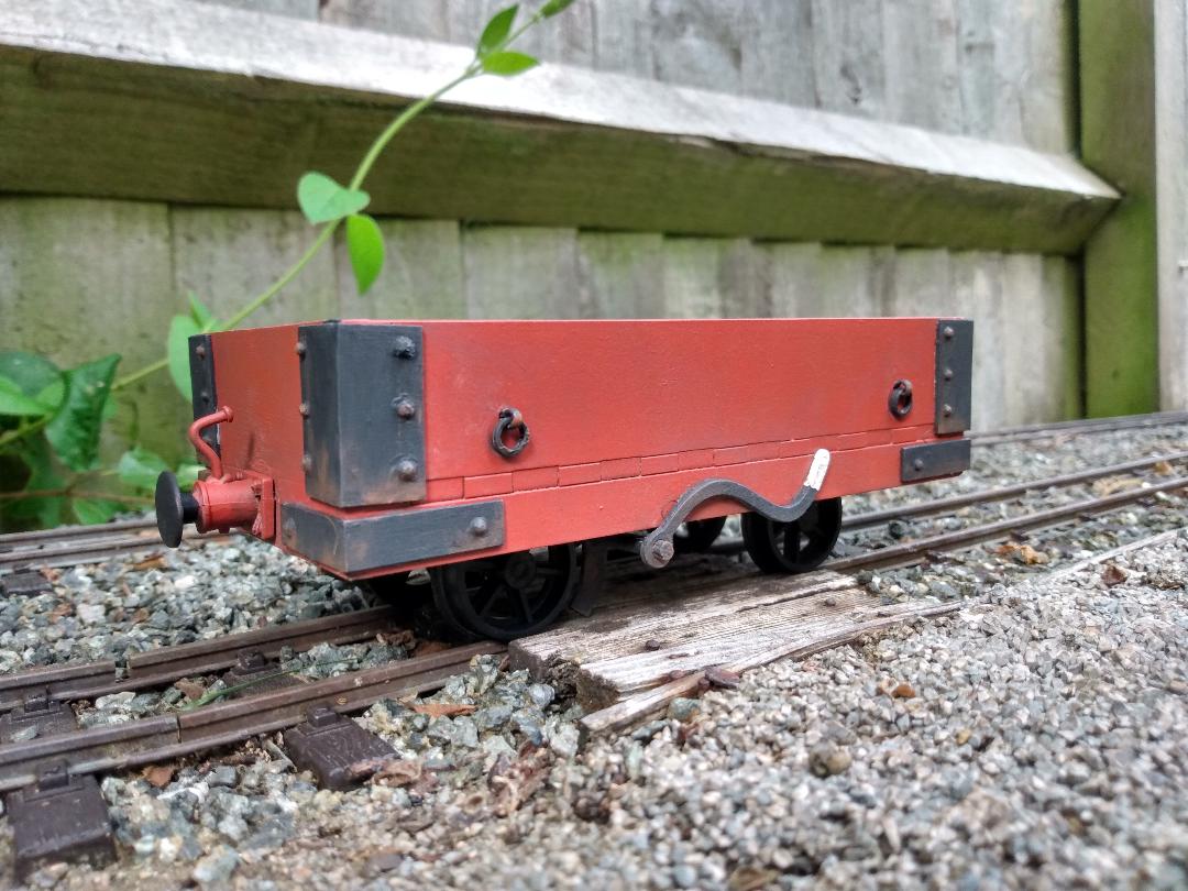

Hello again,
I've just finished the last of the trio of Phil Sharples wagon kits I purchased, the Ffestiniog 1 plank "beer" wagon:
It's awaiting a FR-style number plate, which I'll order in due course. The kit came with a curved wooden buffer, but the real thing sports a more conventional buffer, so I modified the ends, which, in turn, meant creating new strapping, using the original as a template. I reckon a test run is called for soon...
These inexpensive kits have are very well designed (I love how the tabs and slots of the floor and sides combine to form the plank detail, for example) and great fun to build and modify - highly recommended!
