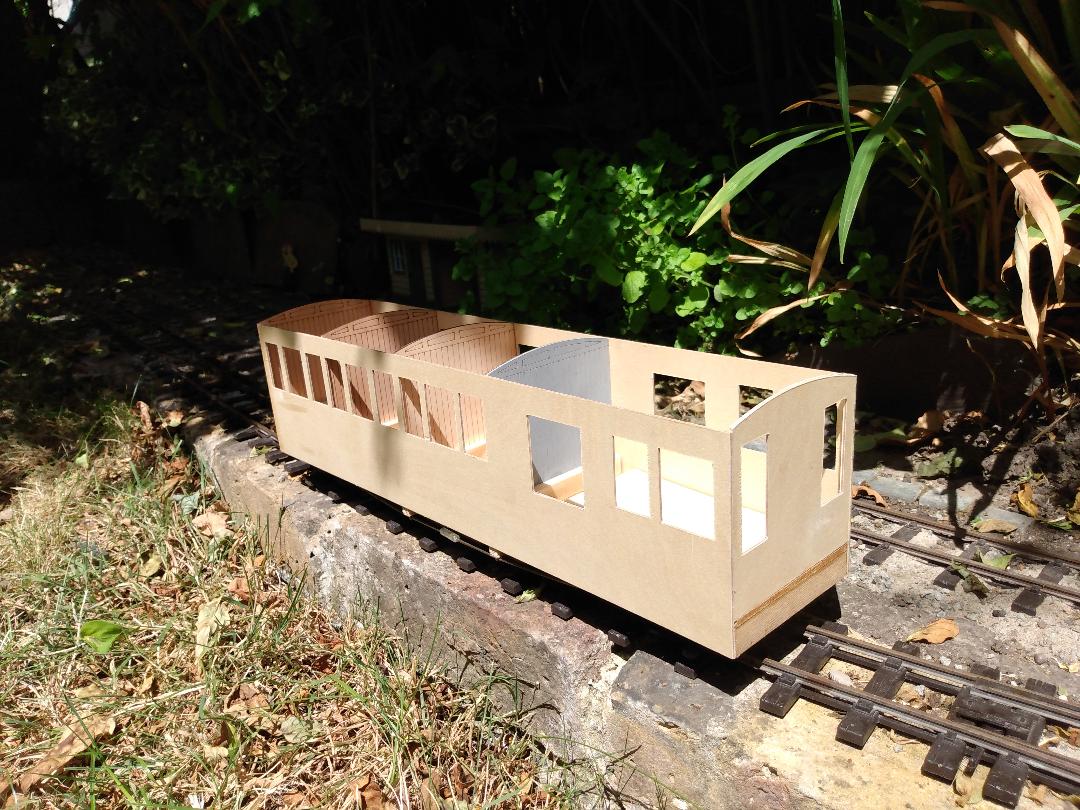

Re: (WH)WHR Rolling Stock
Afternoon all!
A little progress to report on my model of FR Van 4...
The model uses 7mm NG Association drawings, which I had the (rare) foresight to photocopy up to 16mm scale before work closed down. They're very good, but inevitably small inaccuracies become much larger ones when you enlarge the drawings, so care needs to be taken. Anyway, I stick 'em on to 1.5mm ply with re-positionable artists' mount spray, then get to work with the Stanley Knife:
I only had to cut the sides,thanks to Peter B, who I'd contacted for the measurements of Lineside Hut carriage partitions - he's the only person I know with LH carriages, and I wondered about using the partitions to speed up the build process and ensure accuracy, never my strong point. As it turned out, Peter was not only happy to measure them, but also had a whole load of spare ones left over from his build which he kindly offered to send me - thanks Peter!
So here are sides and ends glued together into the basic shape of the carriage:
The big openings in the sides are where the duckets will go, and the ones in the end are recesses for droplights - these are only internal end walls at the moment, so I've managed to put off cutting the curved windows for a little longer...
Outer ends will be the next job, then there'll be a pause for a stock take. I need some 0.5mm ply for this and another project, which will have to be purchased online at the moment - the postage will be high though, so I want to order anything else I need at the same time.
Anyway, so far, so good. It's a nicely sized and proportioned carriage I think, perhaps surprisingly so considering the real thing started life as a full brake and was only converted into this configuration nearly 50 years after it was built...

Looking good so far Andrew!
It'll be interesting to see the next steps.
- Posts: 5715
Excellent start Andrew, I always think cutting through ply is a risky business, but as long as you still have the correct number of fingers that's OK.
Looking back at the black/white photograph you posted there is a lot of hardware on there..... handles, grab-rails, window bars, hinges, brackets, step supports etc.... that is a full three course meal of a model to make but it will look superb.

You seem to have a really good hand and eye. Those coach sides look very crisp and clean-cut.
- Posts: 1890
I agree with Rik, it's not easy to cut out windows and have them all as even as yours. Great work.
A masterclass on cutting ply Andrew. Looks like another fantastic build coming again from your workshop.

Thanks chaps, glad you approve of the work so far!
I'm afraid I seem to have chosen a very flattering angle for the photo - if you were to look closely you'd see all sorts of wonkiness! I like to think it adds to the light railway charm...
