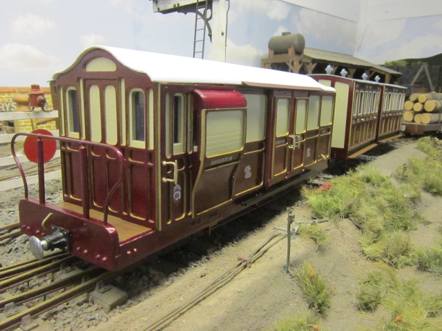

Andrew, I highly recommend the 'Lineside Hut' CRV. It is cut from high quality material, is very well designed and constructed and is good value for money. You do need to supply bogies yourself, but that can be to your advantage......
Re: (WH)WHR Rolling Stock
The picture sells it Peter! Your version is stunning...Peter Butler wrote: Sun May 10, 2020 10:20 pm Andrew, I highly recommend the 'Lineside Hut' CRV. It is cut from high quality material, is very well designed and constructed and is good value for money.
Whenever I get round to it I'm afraid mine will be in plain old "Kentish Green" with brick red ends, like most of the FfR's carriages back in the 20s! Still, it'll be quicker and easier, I guess...

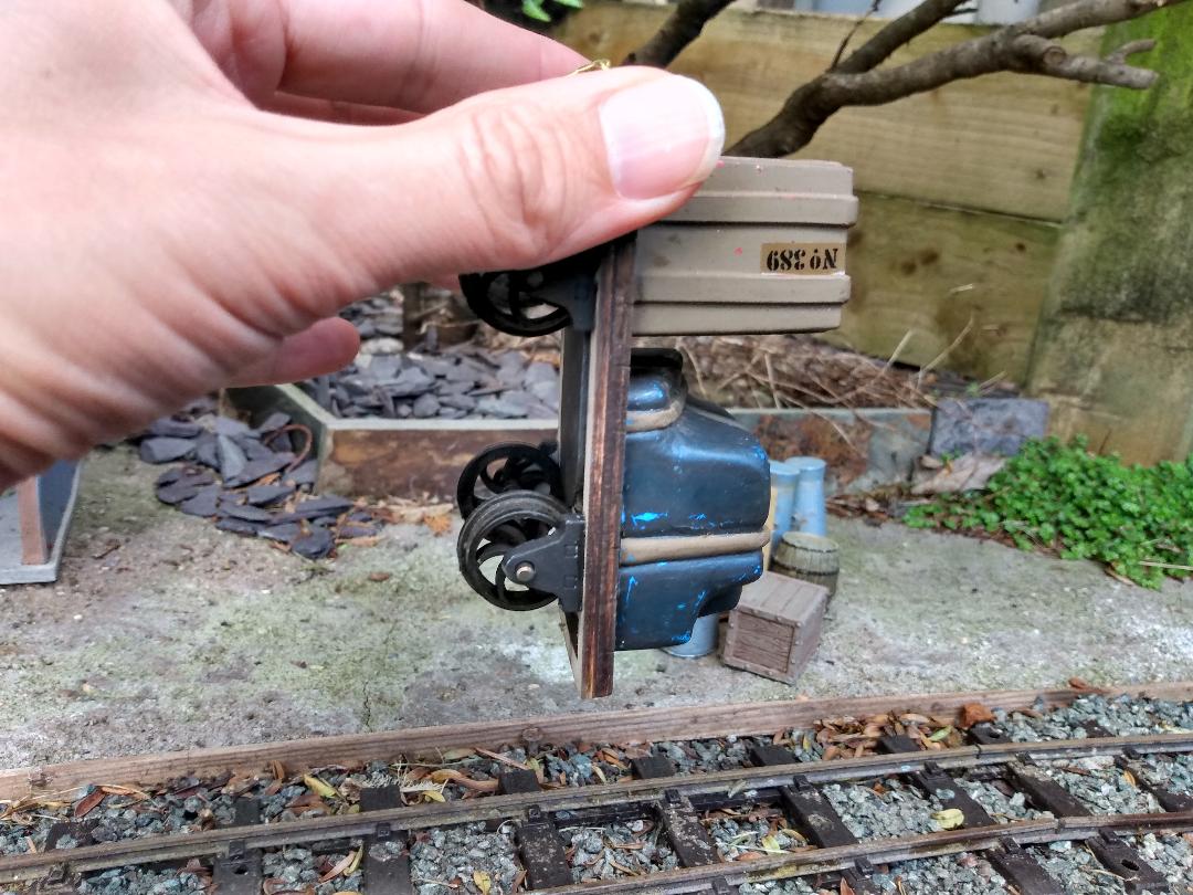

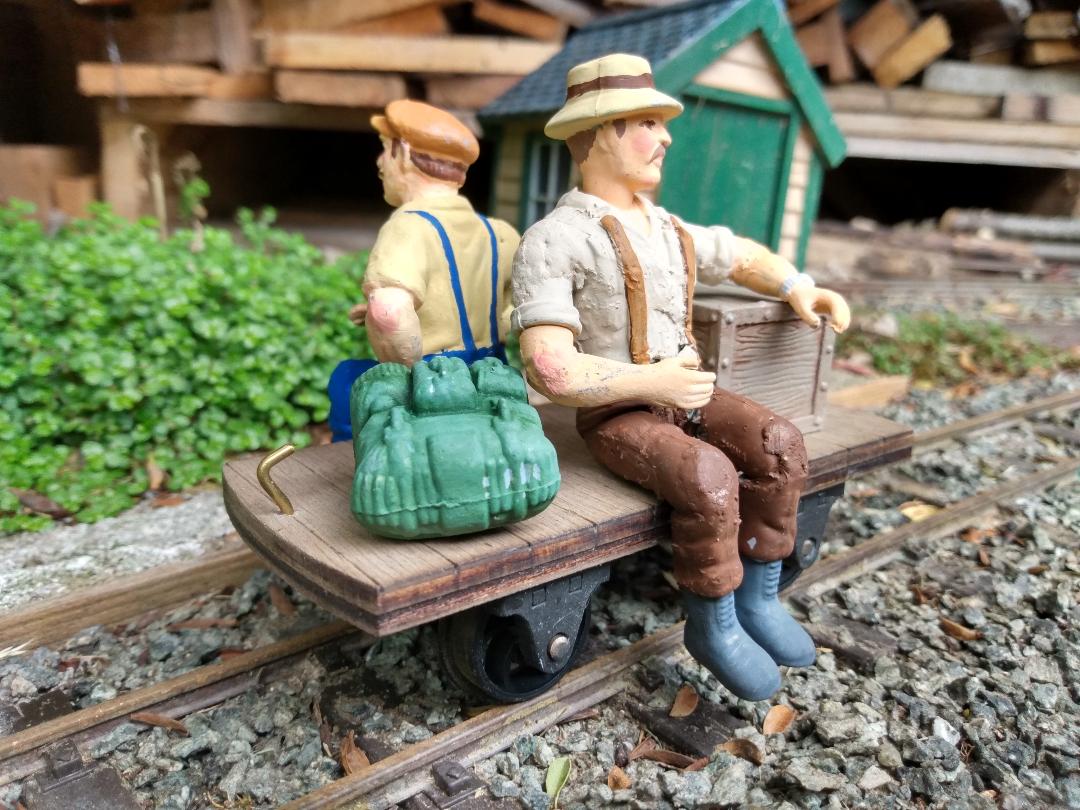

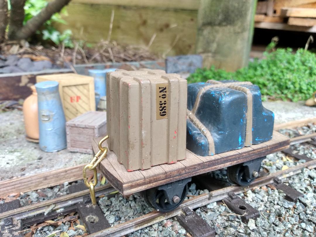

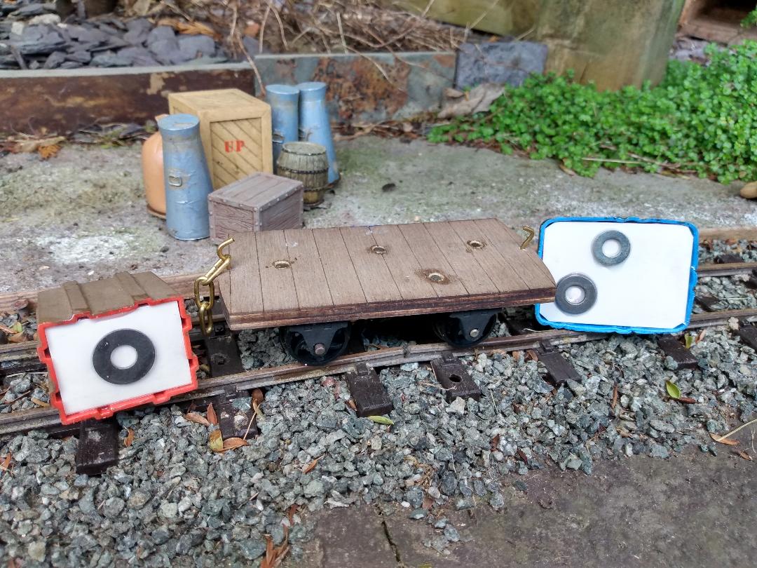

Readers of the Inspection thread will have seen a new addition to the (WH)WHR's rolling stock - a Permanent Way trolley. The old WHR seemed to have a number of these, some powered, some hand propelled, which were attached to the back of trains to enable the PW gang to reach their work site - there's a great 1935 photo here: http://217.34.233.120:8086/zoom-item?ke ... joVWgA/852
The trolleys feature in a surprising number of photos and accounts, and seem to have been such a feature of WHR life that I've been thinking for a while that I ought to model one. I had planned to scour every photo I could find so that I could produce drawings for an accurate model, but the impending arrival of the inspector (who I thought would enjoy a trolley ride!) encouraged me to temporarily shed my rivet-counting tendencies and purchase a quick and easy Lineside Hut kit for about Β£6.
The figures are toys from my People Box, hacked about and glued back together in a seated position, and the crate (no doubt containing some essential PW supplies...) and rucksack (probably containing the gang's lunch...) come from the same source.
I thought it would be useful to have the option of the trolley as a small flat wagon too, so made an alternate load as well. I've had these since I was about five, when they trundled around the carpet behind a battery powered engine on red plastic track! They could do with a coat of paint - they were last painted about 30 years ago, and the coloured plastic's beginning to show through.
The "loads", including the people, have washers glued underneath, which affix to strong magnets set into the surface of the wagon - I'll probably paint them at some stage to disguise them a little.
They're pretty powerful:
The figures don't stay put so well, so I think I'll need to swap the washers glued to their posteriors for some stronger ones - there's no dignity if you're a member of the (WH)WHR PW gang!

What a great way of fixing non permanent items to a wagon, much better than glueing them so you're stuck with them (no pun) to the rolling stock. Amazing where you can find things to add to builds, makes the saying "You never know" all the more worthwhile...

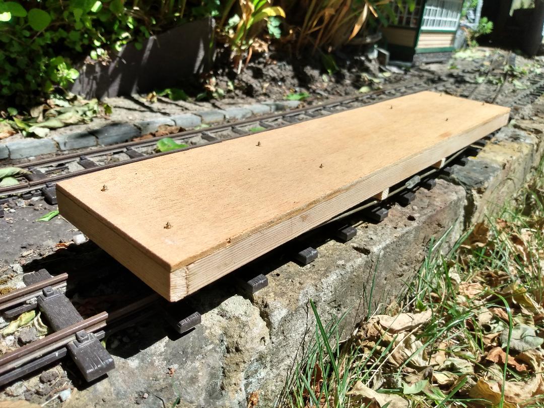

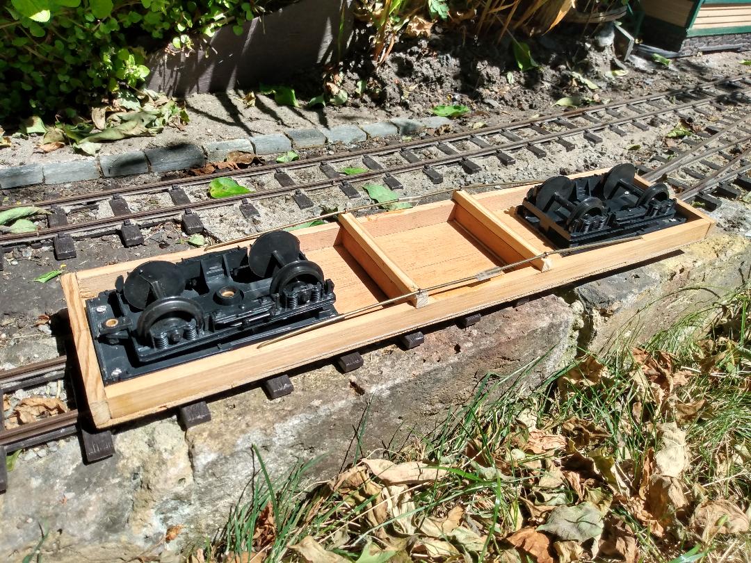

Well, the next rolling stock project is underway. I think it's possibly been 5 years since I built a carriage, so it's time I did something about that - I've started work on a model of Ffestiniog Van 4, rebuilt from a full brake in 1928 and seemingly used quite a lot on the Welsh Highland, so it should look well at home in whatever rake of carriages it runs in.
Here it is - quite a characterful vehicle, I think?
And here's the first stage of my model - I haven't got very far yet!
The floor's from an old drawer, with running gear courtesy of a Big Big Train carriage, like most of my coaches. Big Big stuff is still available relatively cheaply from time to time, I find it runs very nicely, and the obvious inaccuracies are largely hidden under the carriage. The pay-off is that the floor comes out slightly high inside the carriage, but that's barely noticeable on a small-windowed compartment carriage like this one.
Sides, ends and compartment dividers next, perhaps over the next week or two, although life may get in the way...
PS The drawings show that the bogies were arranged asymmetrically, with the one at the brake end further in by several feet. I think that would've been because the original van had a balcony, incorporated into the body of the carriage during the '28 rebuild, with the bogies arranged under the former body bit rather than under the balcony. I've gone for a more conventional arrangement for a smaller overhang and so better running round my sharp curves - it'll take an eagle eye to notice!

Good luck with that one Andrew, you have a challenge on your hands with the rounded windows and panel overlays. I'm sure it will be superb when complete. Then, and only then, can we bring up the subject of bogies!
