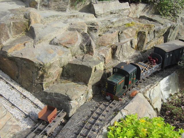

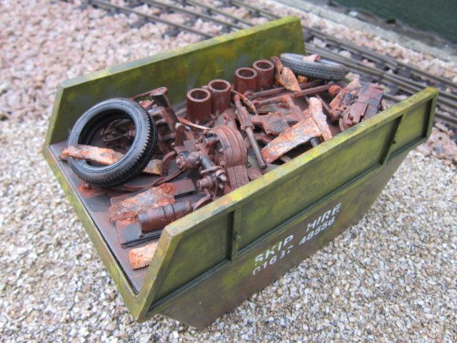

As the weather is fine, for now, I have been laying more rocks to form the backdrop to my quarry scene.... no pictures at the moment but will follow when I'm a bit more advanced. This area will also include new planting which I have decided needs a re-think as some areas are completely hidden from view, and they are the ones I like best!

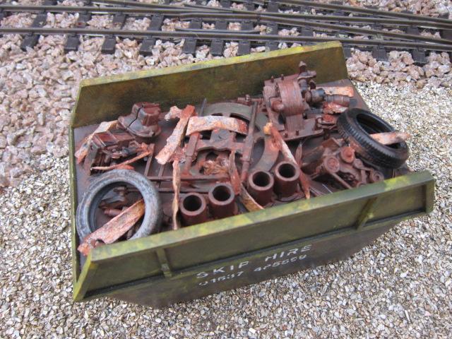

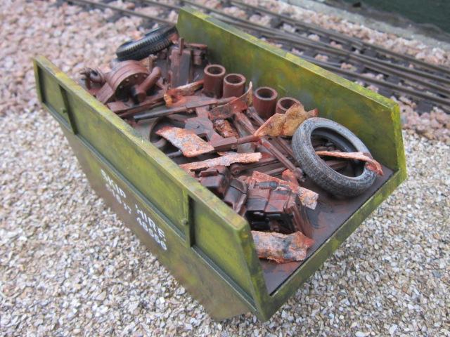

However, I have given my little people an opportunity to tidy up the railway by supplying a skip..... they have been busy and put all the scrap ready for the lorry to take it away.
The telephone number is just a random selection so sincere apologies to anyone who has such a number.

ge_rik:111682 wrote:That rusty stuff looks spot-on and the skip itself looks well (ab)used.
Thanks Rik, the rusty stuff is in fact real rust.... I put some steel scraps in water and left them for a couple of weeks. The resulting lumps were then put on top of other assorted plastic junk and sprayed with matt varnish.
The skip itself was a purchase from The Works where it was sold as a holder for pencils, erasers etc....

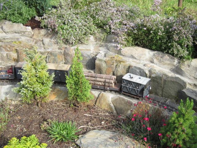

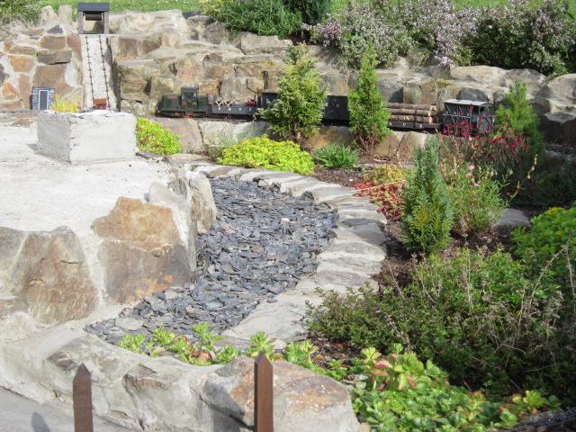

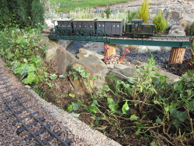

Following on from my previous posting when I said I was having thoughts about my planting....... drastic measures have been taken and several established plants have been re-sited so that new vistas are opened up.
It seems some plants become so familiar that we don't notice how intrusive they become. I only just realised how little of my railway I could actually see from certain viewpoints and they are the ones which give some of the best overall impression.
The rear of my railway, above the quarry, was shouting out for planting so I decided to move some of the plants to new sites. Whether they will survive the move only time will tell!
I know they have to be well watered, so I'll let you know!

I really like your landscaping, Peter. Personally, I like the way vegetation grows up to obscure the railway so that you get occasional glimpses of the rolling stock as it wends through the landscape. I see you've got some conifers adjacent to the track, I think they'll grow up nicely to achieve this effect.

I think your efforts have paid dividends. The views in the photos are interesting and full character. I love that inclined plane. As Rik rightly points out, the confers look good and will grow to give ever changing aspects, that's one of the joys of a real railway in a real landscape. At the same time it can be one of the chores if gardening isn't your bag.
I hope to try some bonsai on trees when I (eventually) get my line out of the ground. I'm not sure how successful it would be with conifers. I've bought a book on the subject but not started reading it yet - planting out is not that close for me at the moment!
Some of your plants seem to be what I've heard experienced gardeners refer to as 'ground cover', meaning it spreads like wildfire and stifles all in it's path. It's grand stuff for weed control and quick greenery but does need some robust trimming on a regular basis (maybe a couple of times a year).
Please keep the pictures coming, your line is a real joy to admire.

The conifers are there for just that reason, to create scenic breaks and some visual blocks. Tall plants at the front of the railway cause too much of a problem when trying to view some of the more interesting aspects of the line. Remember I am at eye level when the line leaves the shed so my trains disappear from view and much of the scenery is lost.
Having removed the tall plants to the rear now creates open space at the front which will be planted with 'ground cover' plants. When these spread they also act as weed repellents (I hope!) so should make maintenance simpler?
I'm sure there are many books on the subject but every situation is different. I bow to my wife's superior knowledge on this issue.

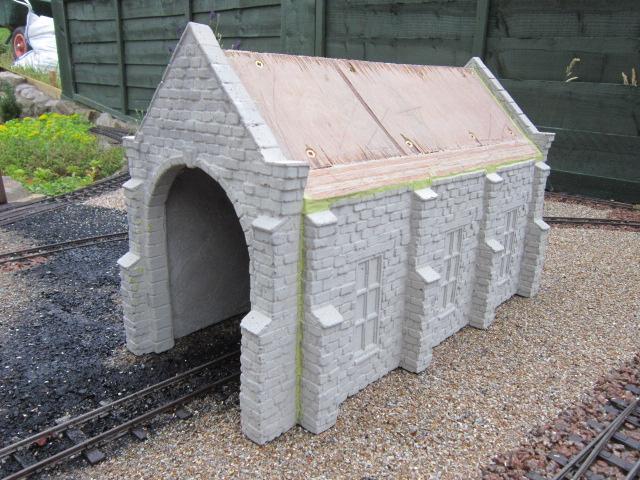

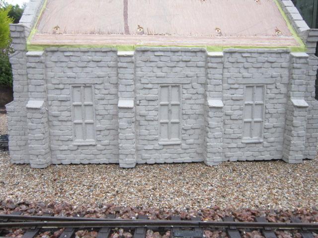

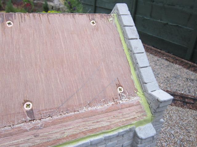

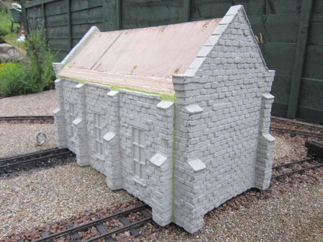

Phew!!!!! firstly the day was too hot, then too wet to work outside, so I began to build my recently purchased Cain Howley engine shed.
The four cast concrete sides just stick together. I used Gorilla glue for this, although alternatives such as car body filler can be effective.
Gorilla glue works well although expands and has a tendency to push surfaces apart, I made a clamp to keep everything in place and then cut and sanded off any excess glue which squeezed through.
When set I filled any gaps with Miliput.
A cast corrugated effect roof is available to finish off the building but I want a slate roof on mine which will be made of Plasticard (of course!).
To support it and give extra strength to the structure I have fitted a 20mm exterior plywood triangular roof, again stuck with Gorilla glue and edged with Miliput to prevent water ingress underneath the Plasticard .
Finally I painted the interior off white and will apply a base coat of exterior paint on the outside tomorrow. This will be a primer to show the mortar lines before picking out individual stones.
More to follow........
